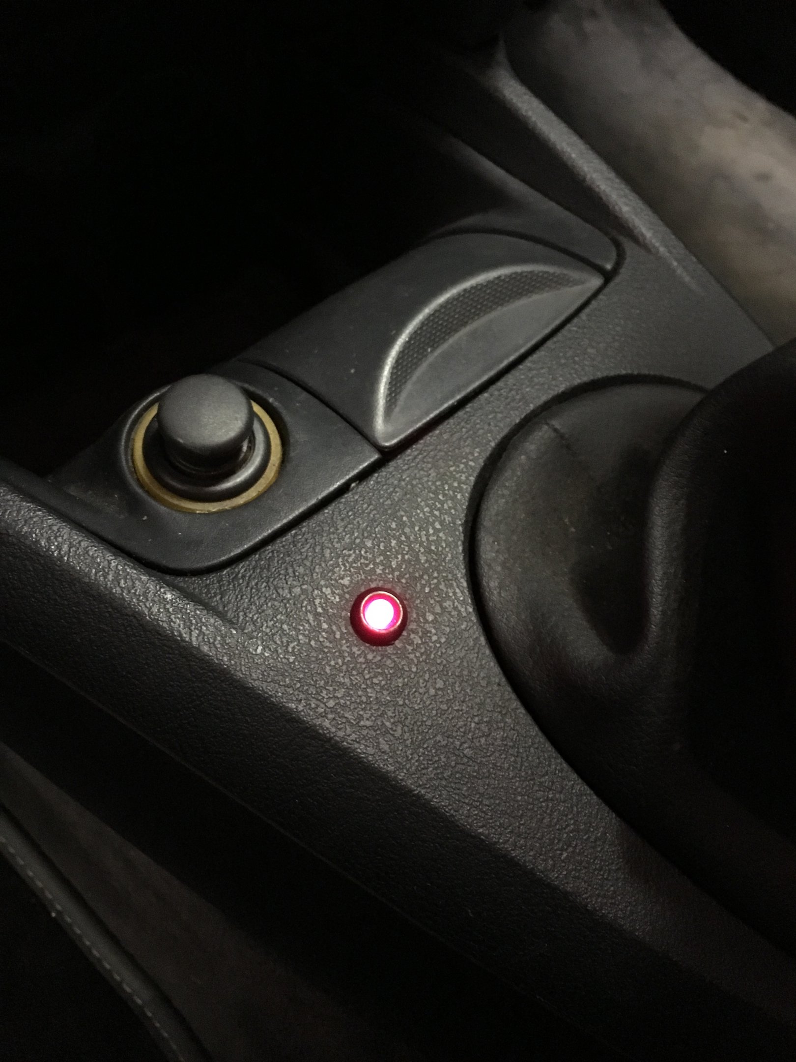

Hi,
When I got my car I noticed the alarm LED on solid. The scuttle drain near the siren was blocked so it has been wet.
When I lock the car with the bonnet open it doesn't do the high pitched whine.
Anyone had this issue?
Cheers,
Rick

The centre drain was blocked in the scuttle and I assume the siren was drowned and this is the result of that. I bought the car like this so I’m not sure of the history of it.
It runs down the battery slowly with the light burning solid constantly.

Mine is staying on even with the engine running etc. Was this the case with yours?

Having done this numerous times since I started driving the car the alarm led is still on solid all the time. Even when driving.

Hmm I’m going to have to have a look. The led burning all the time will run the battery down. I might end up snipping the wires going to it but don’t want immobiliser problems from it.

Going by the installation instructions for this alarm the LED is listed as optional so disconnecting it shouldn’t be an issue.

It might be that the alarm was causing problems for the previous owner so he disconnected it and wired up the LED to be permanently on to deter thieves. It won't drain your battery because the LED is normally on when the car is locked anyway
If you want to totally disable the alarm let me know. That's what I did when mine started playing up
I think it’s an issue with the alarm too. Alarm flashes, makes no noise and does drain the battery, obviously.
I read it’s the alarm box under the passanger scuttle somewhere, water gets there and fooks it. Getting rid of the alarm box is what I’ve read. Solid red light on the dash but does start abs drive etc.
