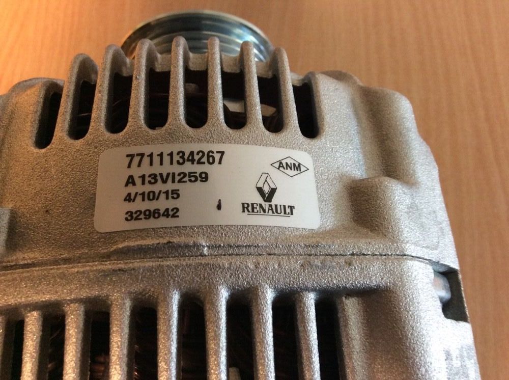

This is all the info Ihave for 182 Cup / Trophy
If you look below at the A13VI259 it matches it from the genuine one

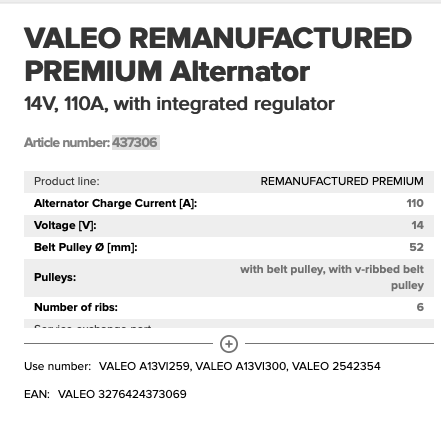

So I would suggest that you need the Valeo PT No of VALEO 437306

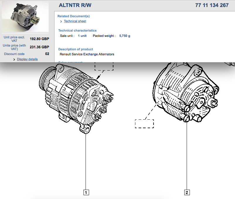

Think that looks to be a refurbished version of the same one as opposed to brand new-
I'd also read a few things about people saying to go brand new over a refurbished unit to guarantee no issues. Looking at the price differential I think I would.
