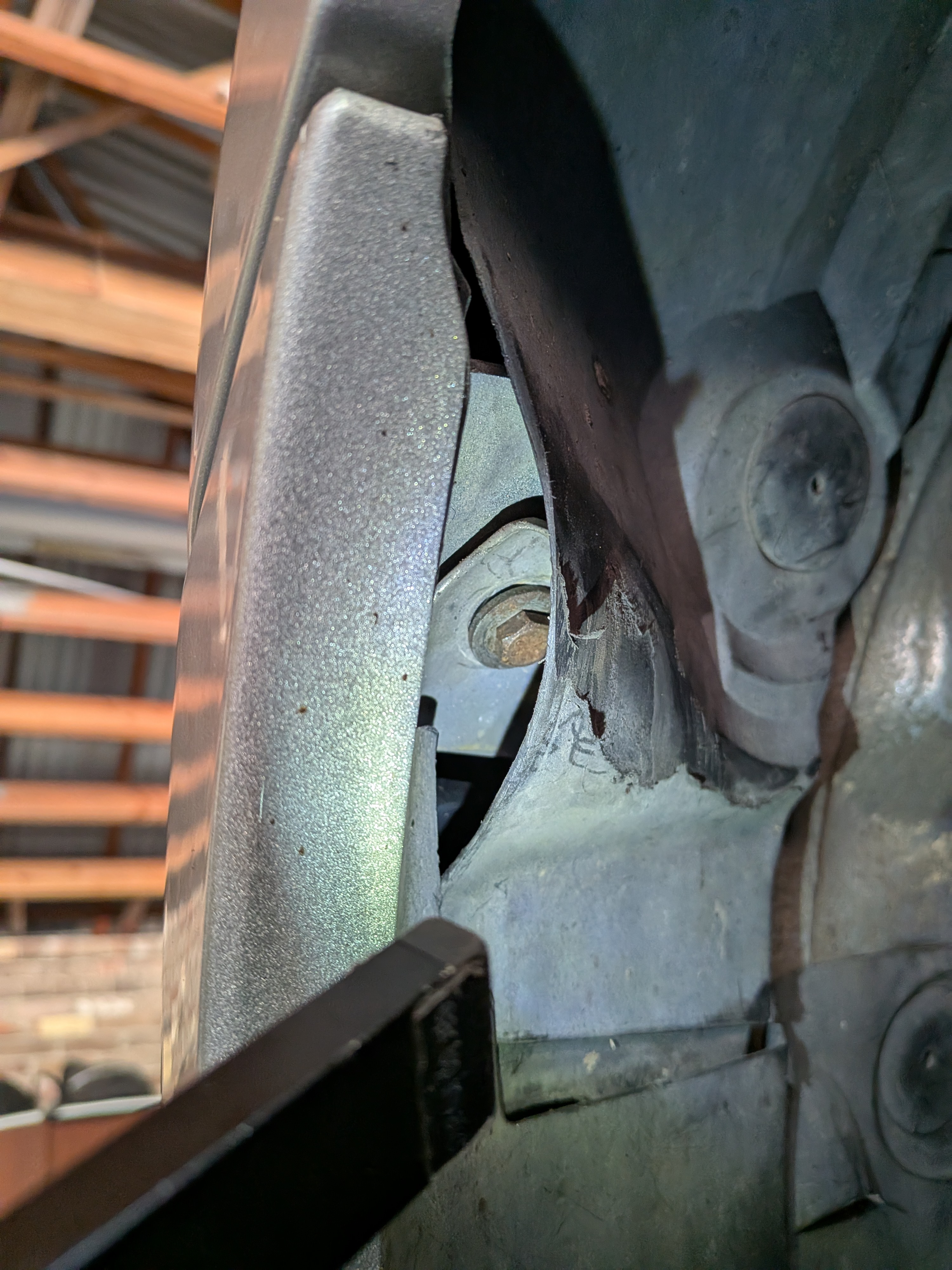

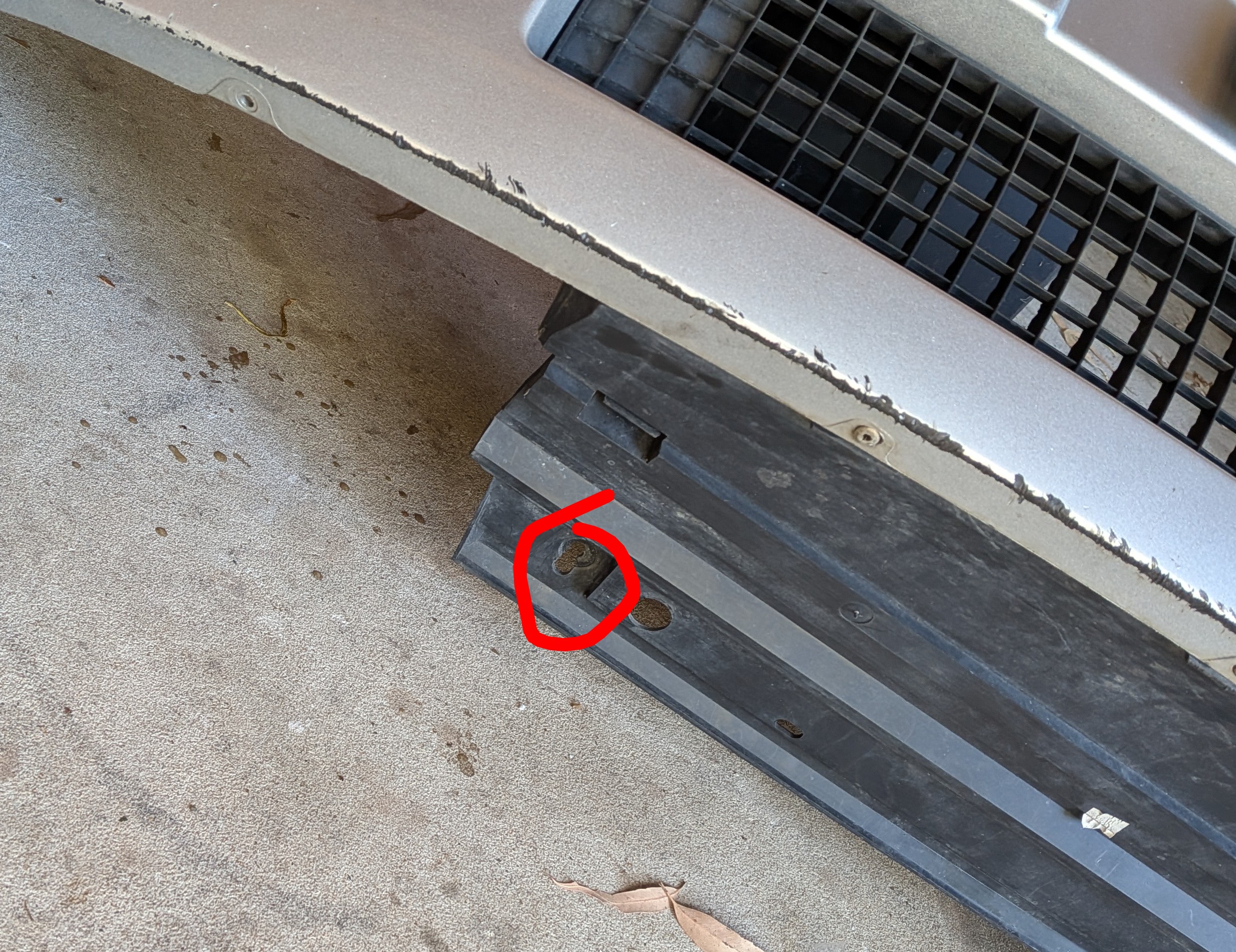

1) Remove front bumper - this is surprisingly easy since there are only 4 bolts to remove it. 1 in each wheel arch an 2 underneath the car (see pics below)
I suggest that you also remove the driver's side front wheel and inner arch liner since it will make the aux belt replacement easier. On the passenger side you can just move the tab to access the bolt seen in the first photo 🙂
When removing the bumper you will need to disconnect the fog light clip and headlight washer pipes on the passenger side (if fitted). Store the bumper safely so that the paint doesn't get scratched.

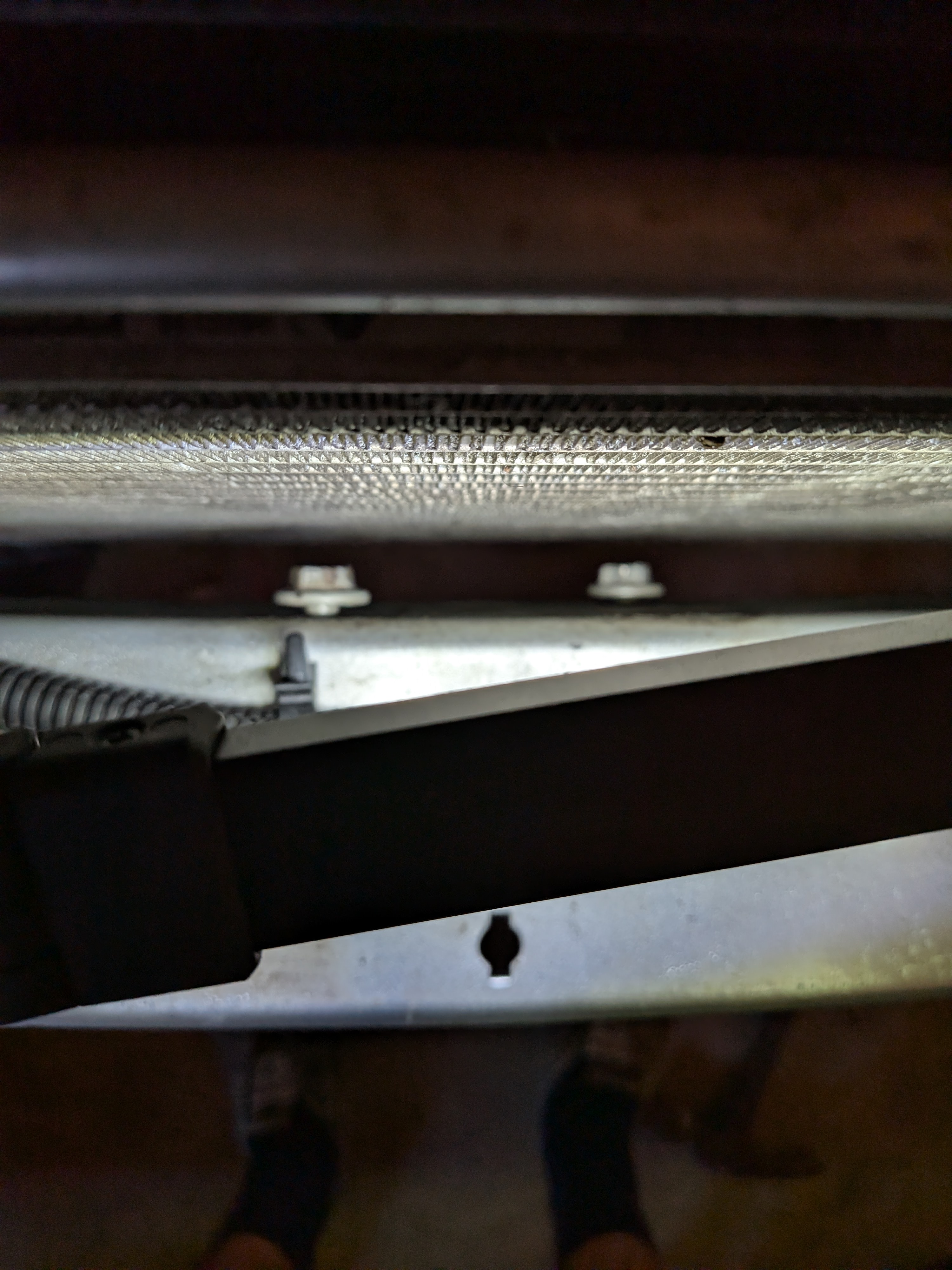

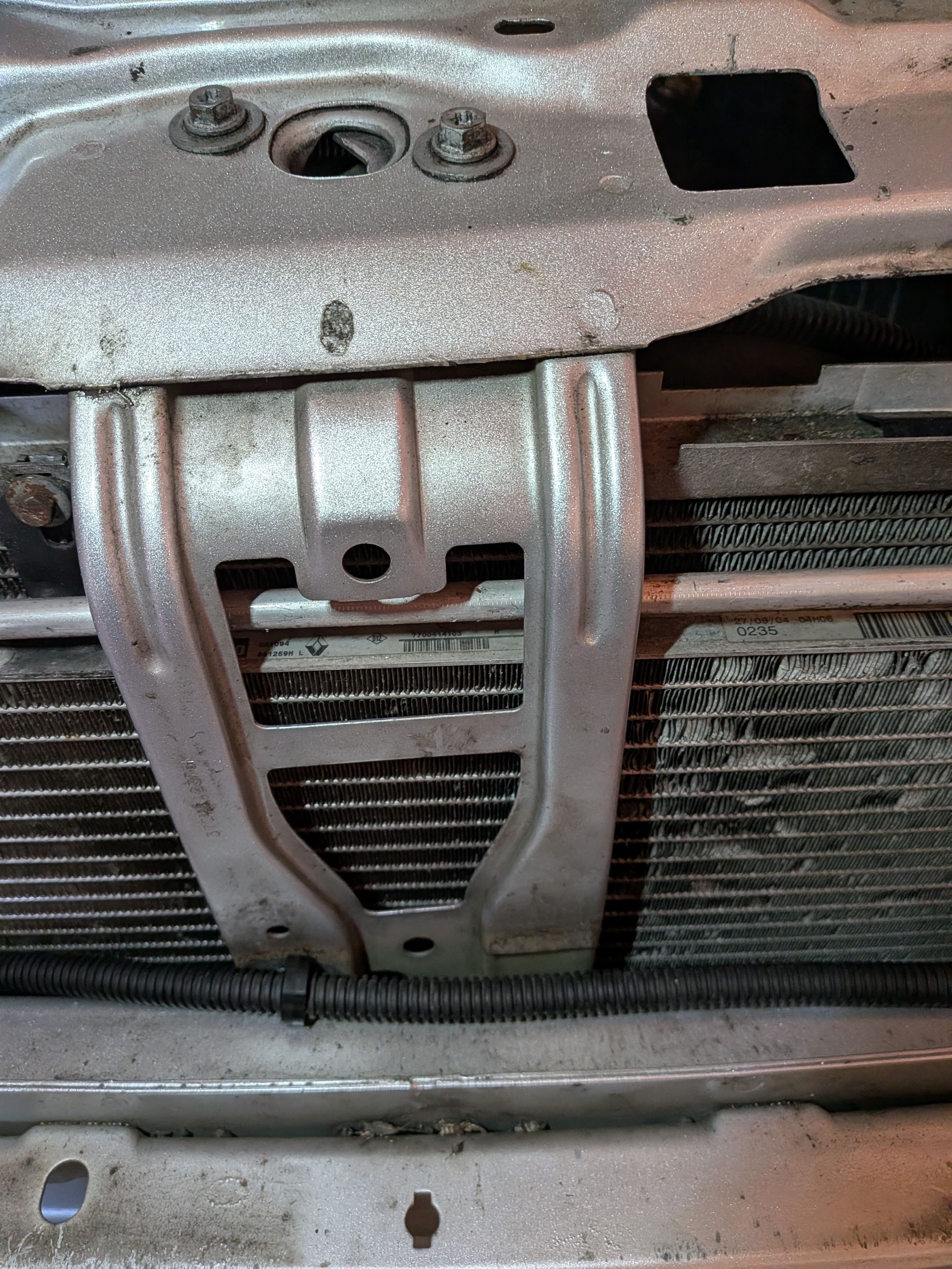

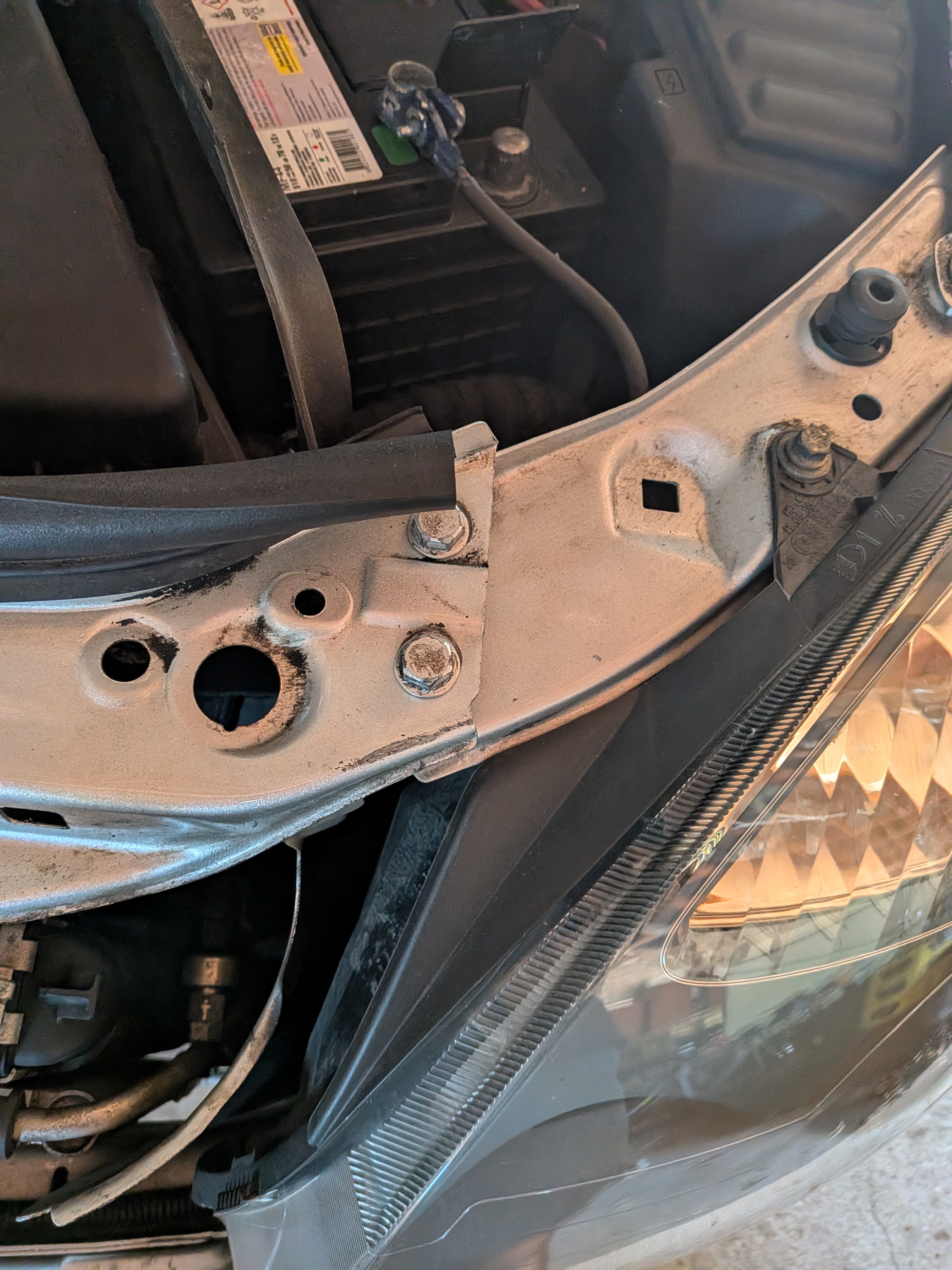

2) Remove top slam panel - remove 2 bolts either side as below and the 2 front bolts above the radiator (sorry nuts removed in 2nd pic.

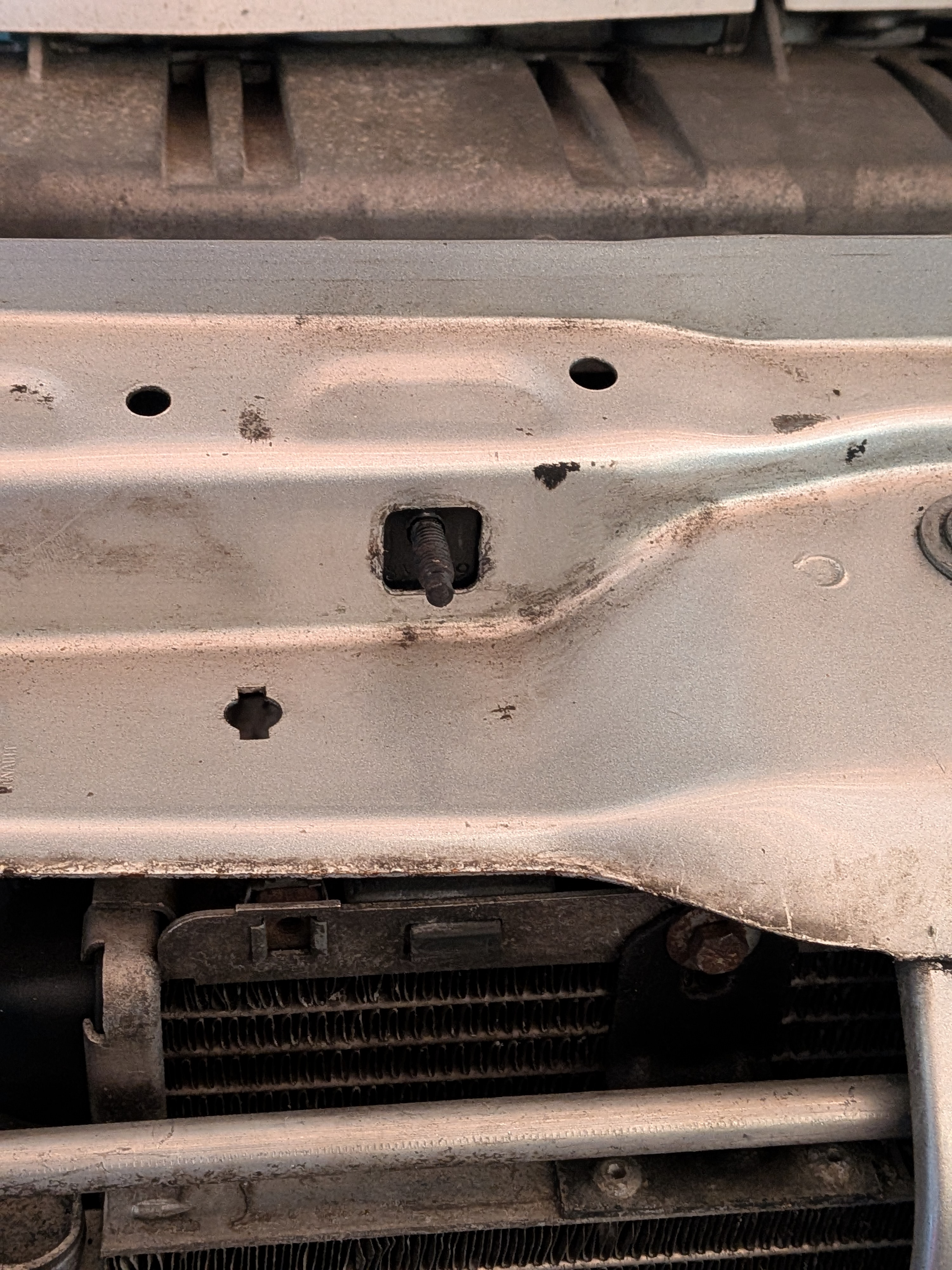

There are also 2 x 13mm bolts at the base of the mid support (not the bolts you see on top of the support).
Trying to remove these 13mm bolts in front of the radiator with the bumper in place is a total PITA. I know since it's 2 hrs of my life I will never get back!
Here's a pic of the bolts which you can see with the slam panel removed. You only need to loosen these bolts so you can lift the slam panel out with the top 4 bolts each side removed.

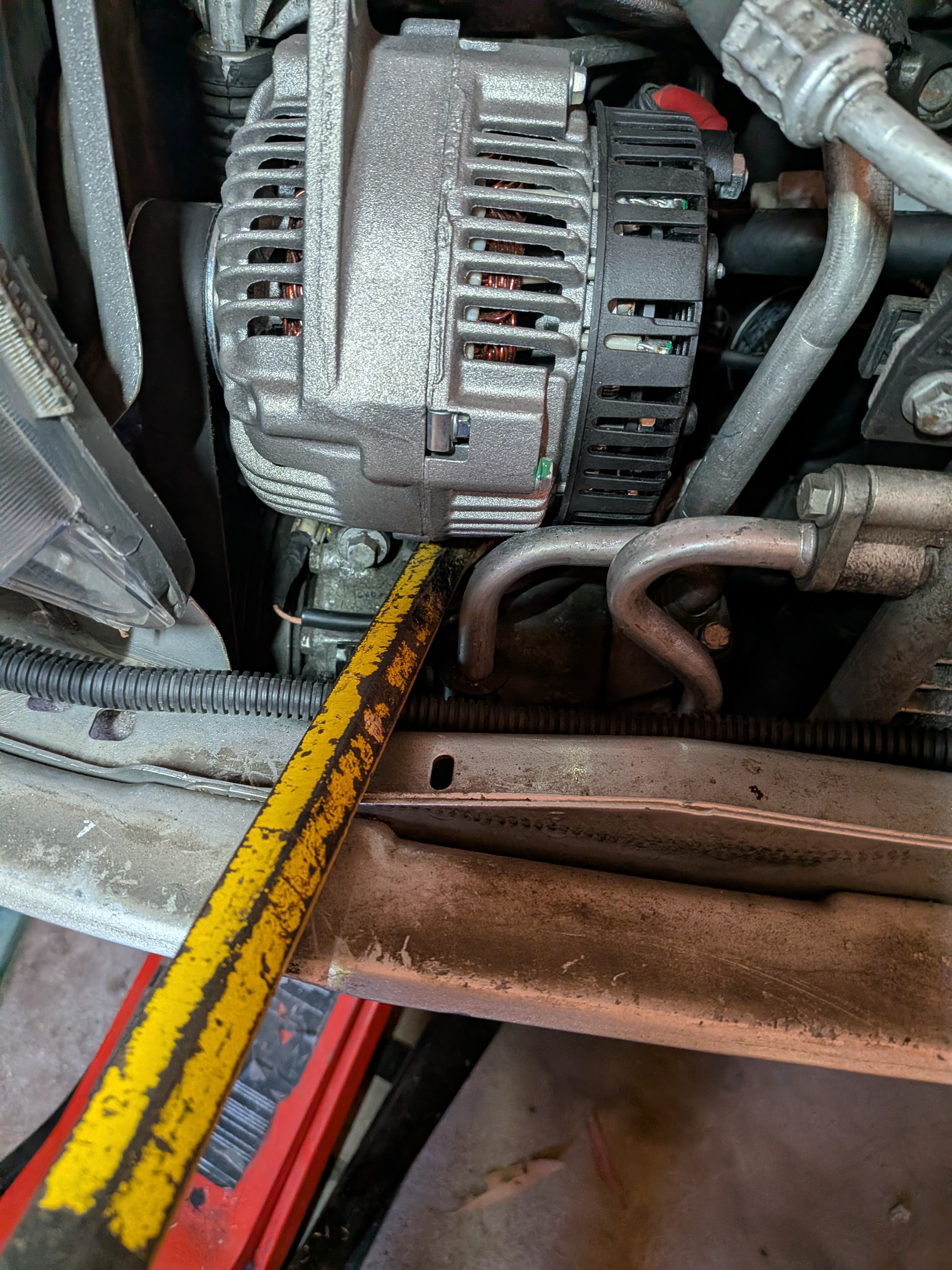

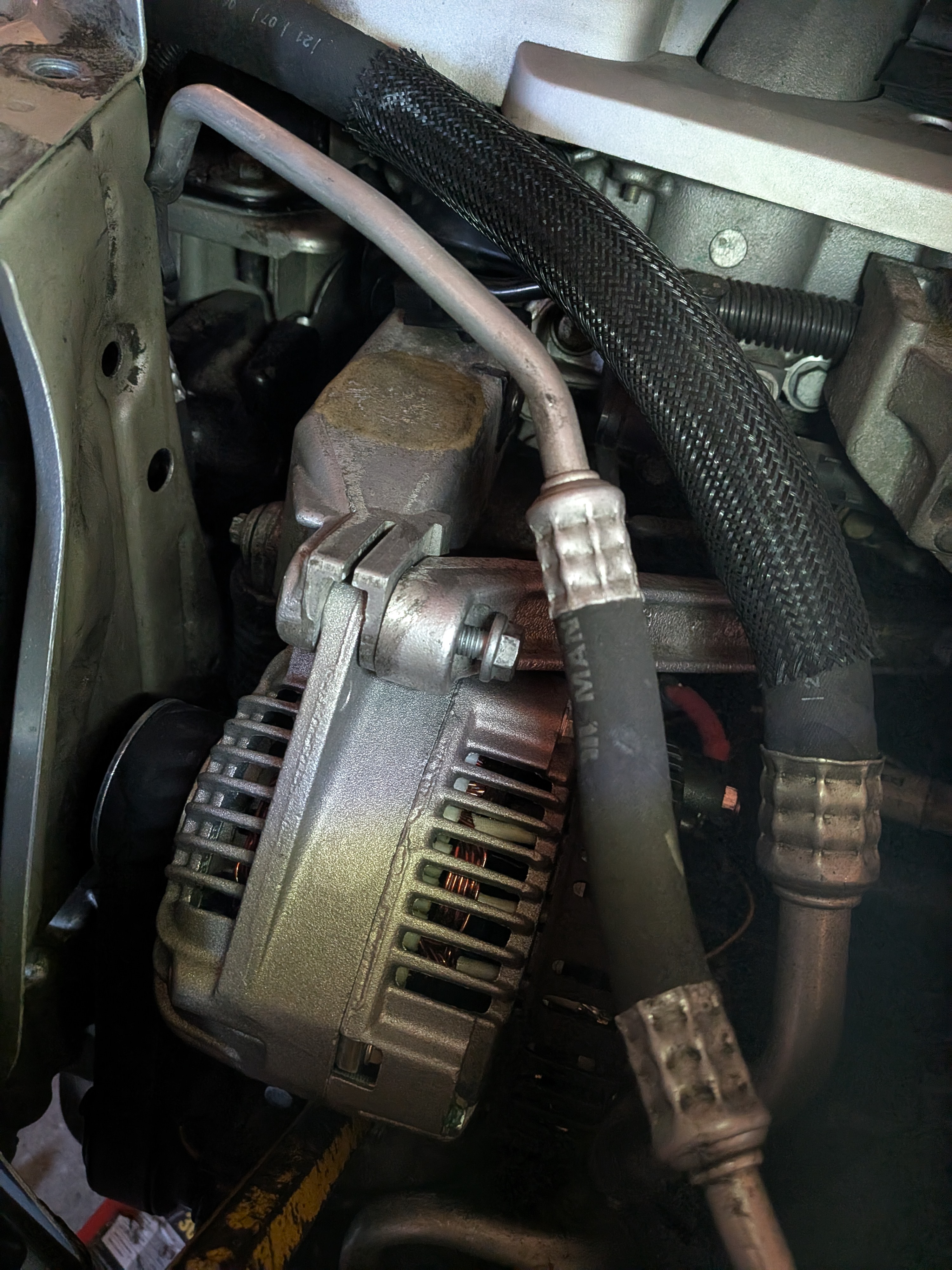

3) Remove alternator and aux belt. Disconnect the negative terminal on the battery. Remove the top 13mm nut on the alternator and loosen the base 16mm bolt. Then place a crow bar or similar lever between the top of the air-conditioning compressor and base of alternator to take pressure off the top bolt.
You can now remove this top bolt and lower the alternator by prying forward to remove tension on the aux belt. God knows why people use a jubilee clip on the belt tensioner since I wasted 2 hrs trying that method 🤷‍♂️
If you can't get the aux belt off remove the long bottom bolt from the alternator and move it sideways. Remove the power out bolt and clip off the alternator before removal.
The alternator will come out easier if you rotate and have the pulley facing forwards.

Also if you have aircon make sure that you order the correct alternator since some have the power out bolt touching the front air-conditioning pipe which will create fireworks 🎇

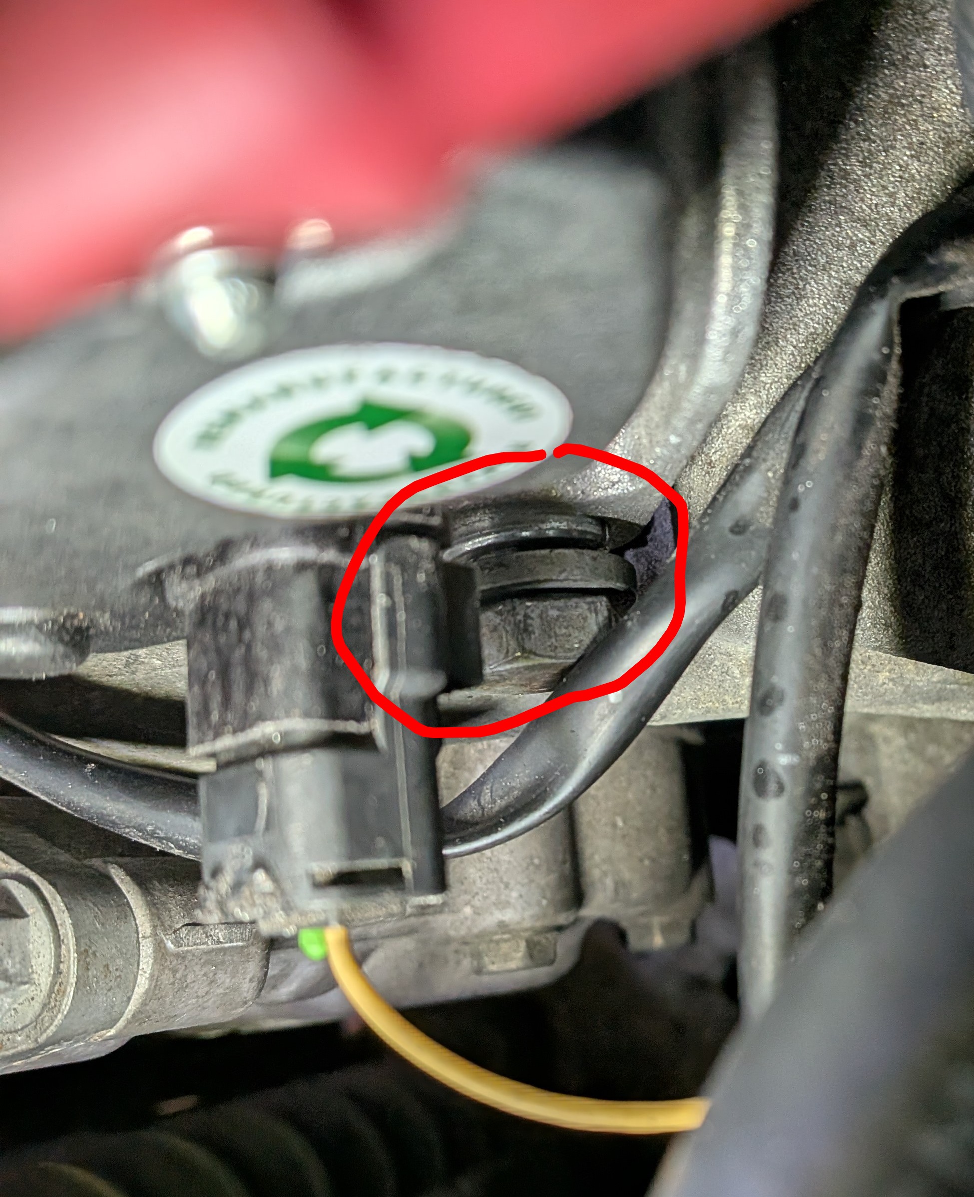

A lot of people, including myself have issues with the tensioner seizing where it fits to the engine. I had to fit the alternator twice (hence the new alternator in the pic) since the first time the power steering squealed on full lock since the tensioner was seized so the belt was not tight enough. I bought a new belt tensioner but the issue was actually where it joins the engine, so I sent the tensioner back. It would be very difficult to remove the tensioner since the pulley bolt is almost impossible to get to with such a tight engine bay.
I used WD40 to free the pivot and used the crow bar to pull it forward to create more tension. Do this with the alternator out.
I have marked in the pic below where this joint is that needs lubricating. Put a cloth below it to stop any drips going onto the belt pulleys when lubing. I couldn't find anything mentioning this on the Internet, so make sure you free the tensioner joint and pull it forward before fitting the new alternator.

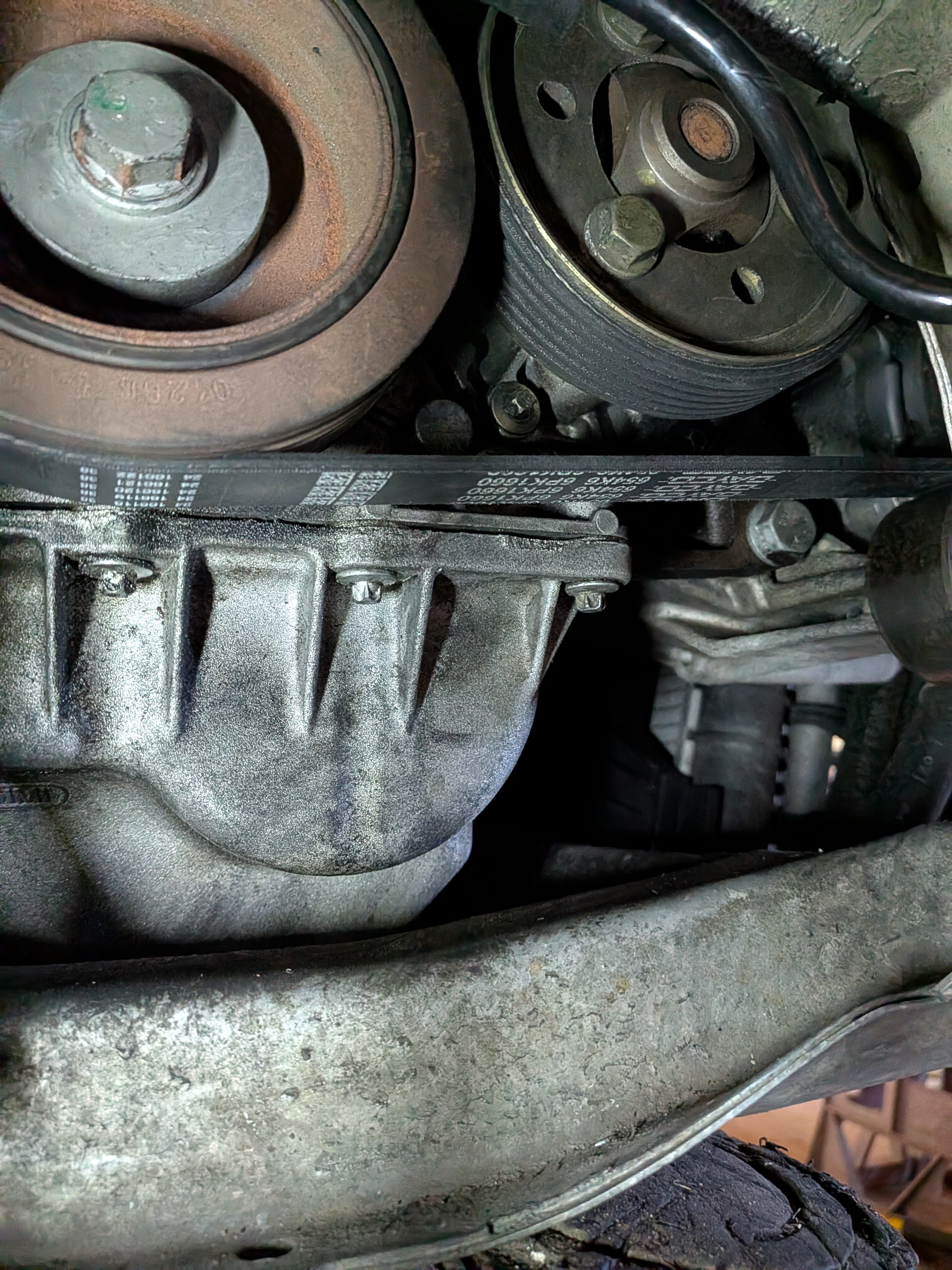

There are lots of diagrams on the net for aux belt routing but you can see in the pic below that the rear pulley belt top routes down and under the next pulley. You can also just see on the far bottom right the belt goes on top of the bottom pulley before routing to the aircon pulley.

It is much easier to get the belt over the alternator pulley before fitting the bottom bolt. Once you have checked that the belt is properly aligned fit the bottom bolt so the thread catches and hand tighten. You can then use the crowbar the lift the alternator to tension the belt and fit in the top bolt. You may need to guide the top of the alternator bracket with a large screwdriver to the right at the same time as levering below if the belt is tight to get it into the top engine mount.

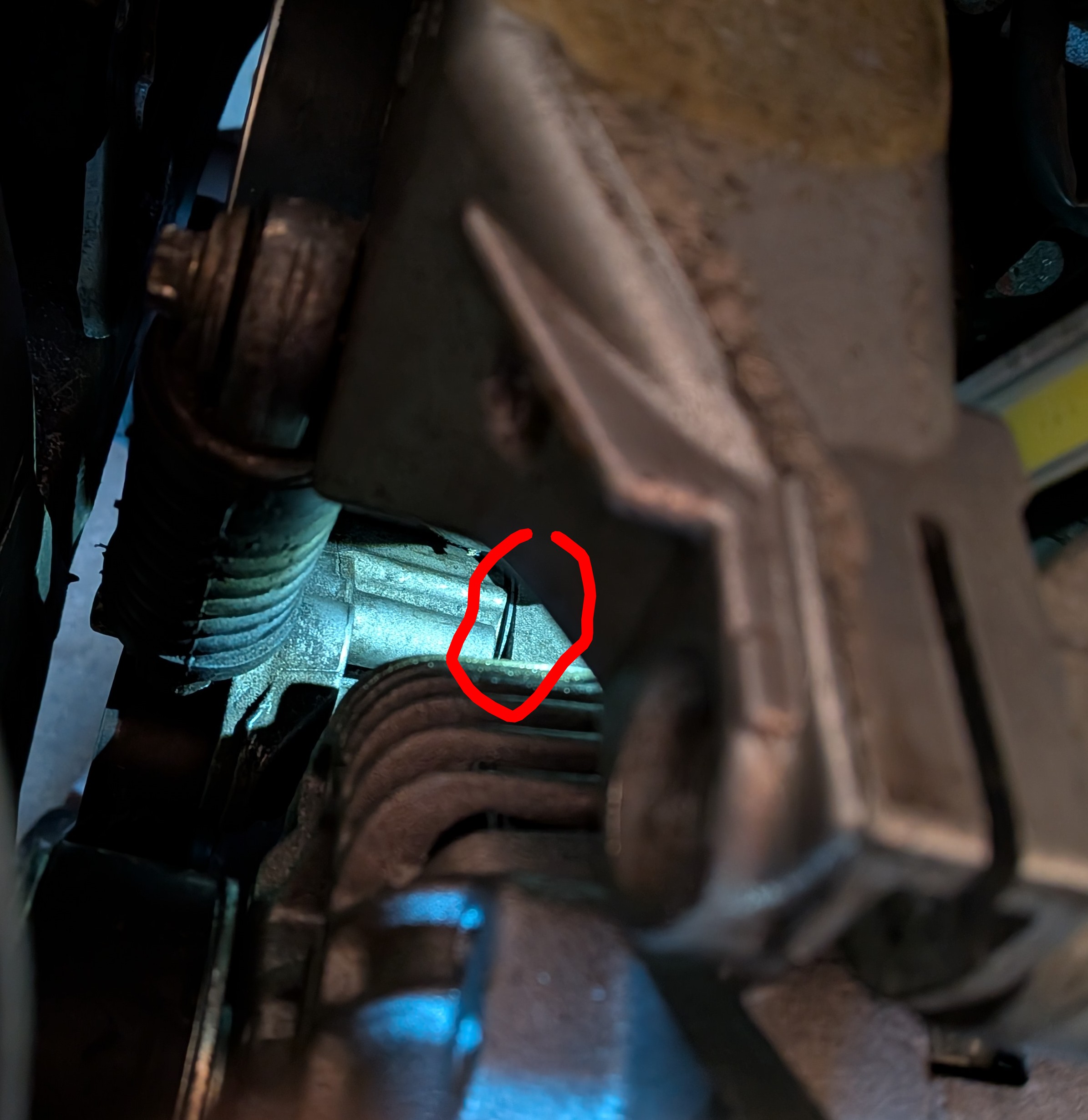

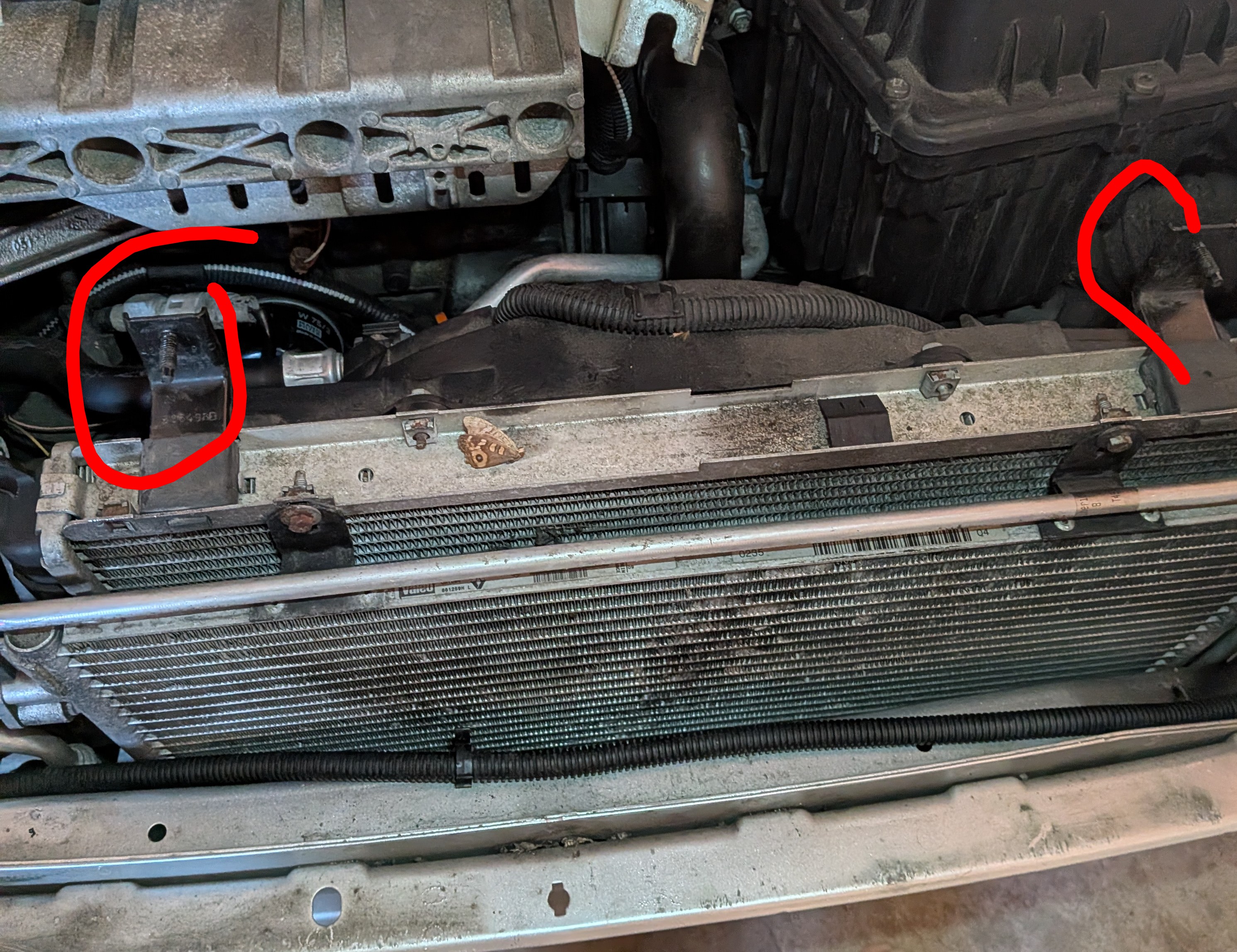

When refitting the slam panel be aware of the rubber brackets since these will probably pop out of the top radiator housing. See pic below highlighted in red.
With the brackets in place you can refit slam panel by sliding the base in carefully and tighten the 13mm base nuts.
