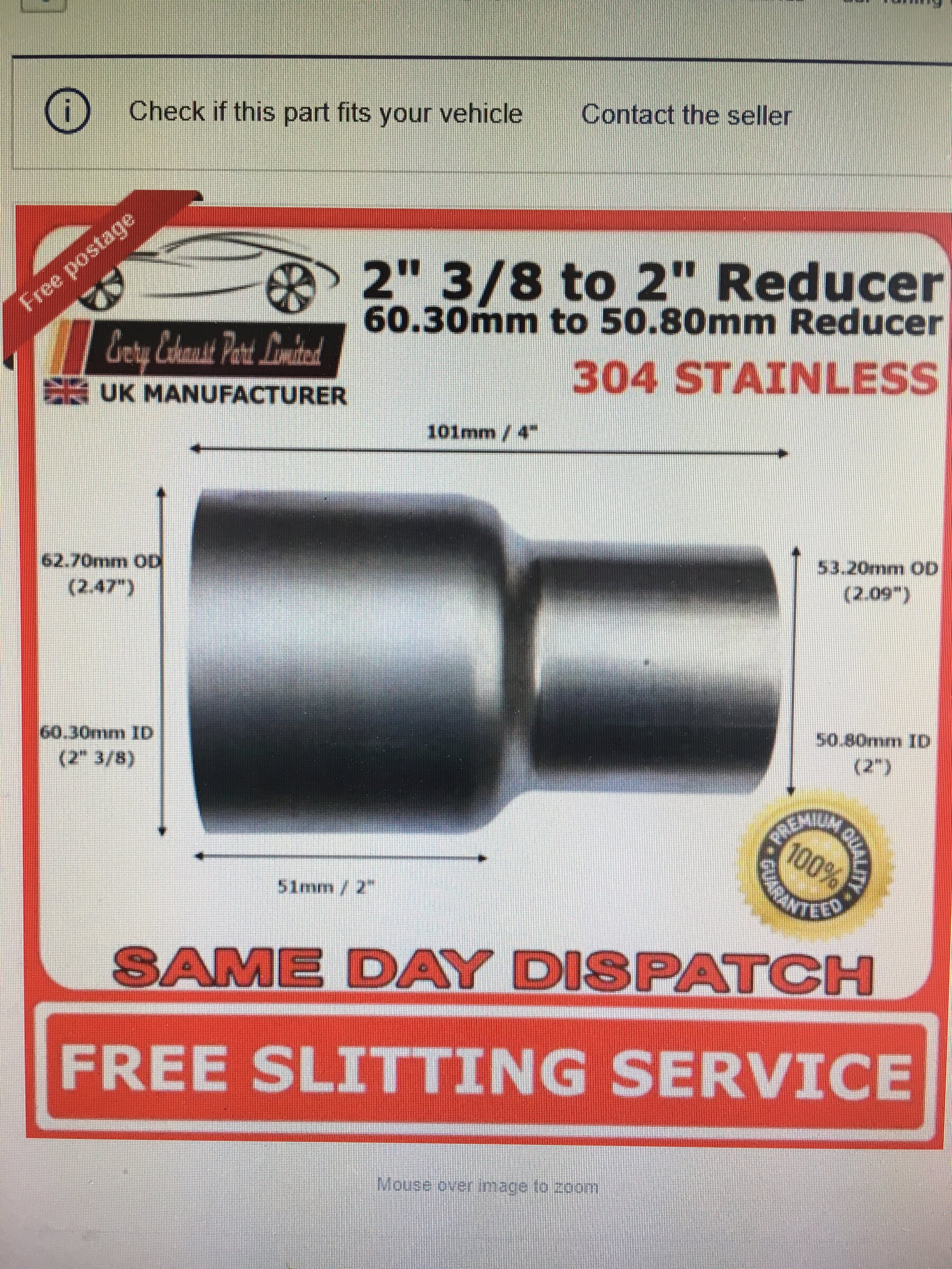

As my system is only 2.25 inch i needed a reducer too. But all in it'll be around £170.
There wasn't any options available with a sleeved 2.25 inch joint though, and i didn't want to have to use the olive connection.

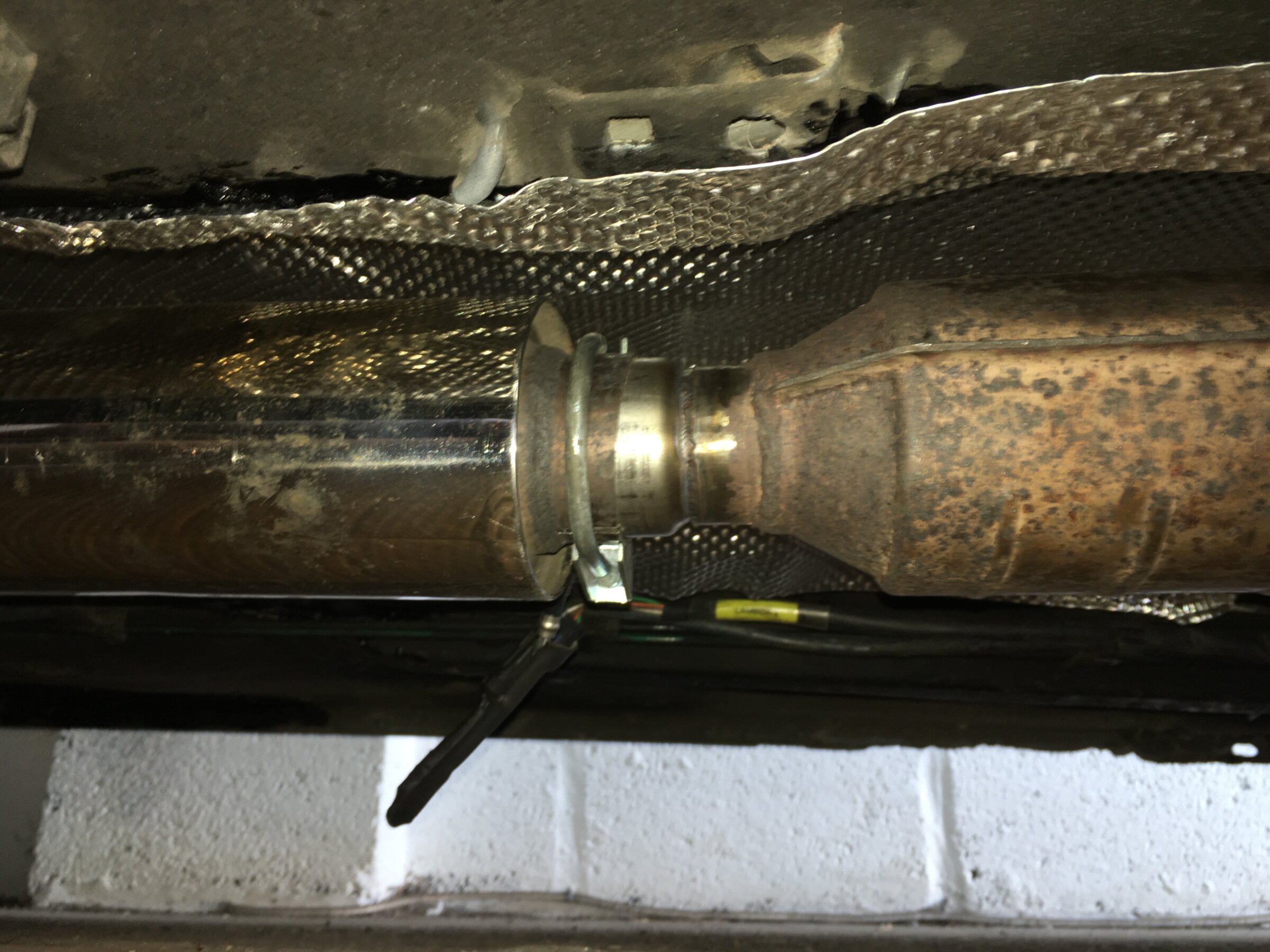

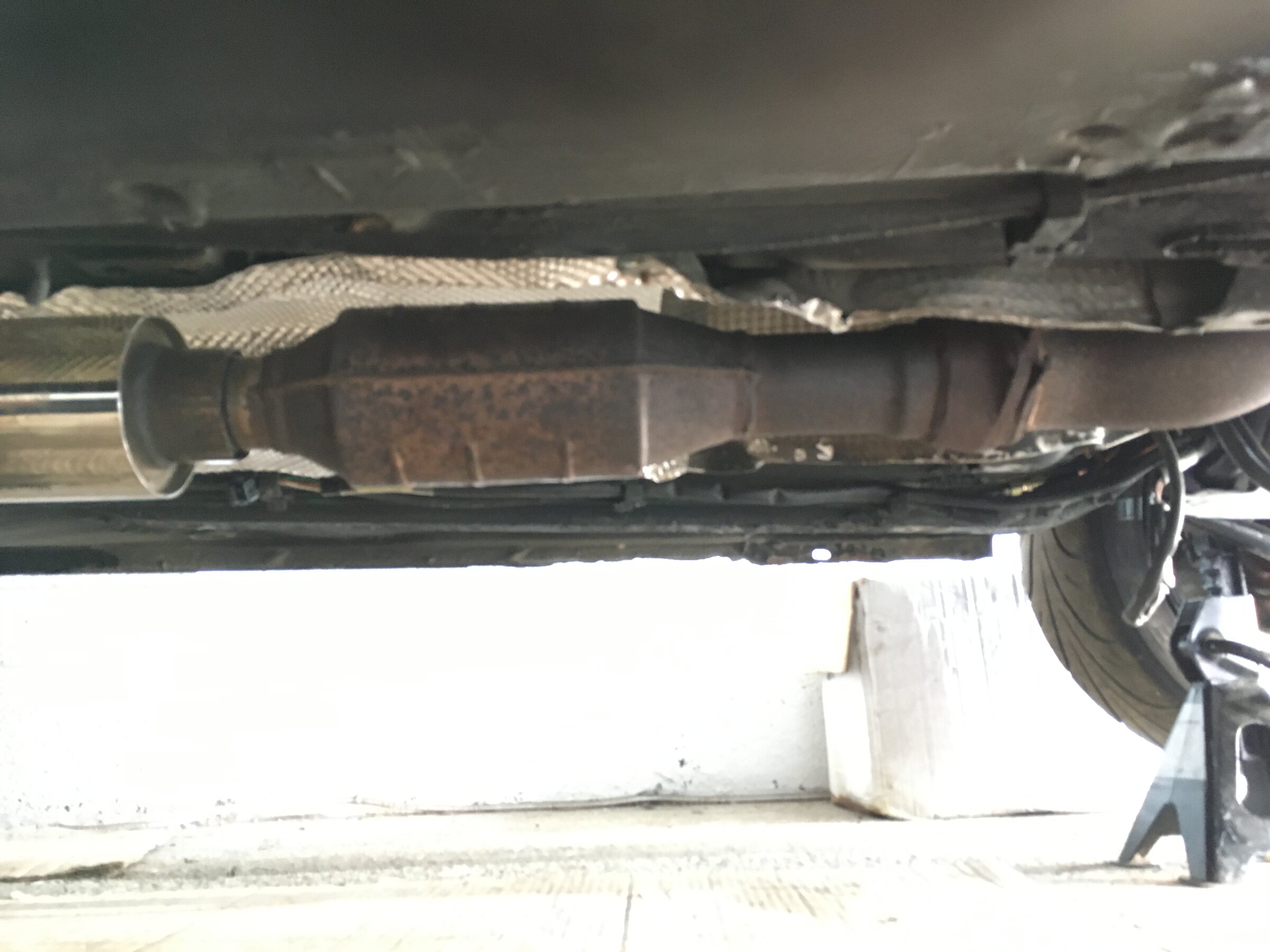

I have the first one. Used it on a 54 plate 182 with a standard Renault exhaust, an original resonated Scorpion and the later flexi centre section resonated Scorpion RS192.
The cat was fine, it’s everything behind it (heavy centre section without much support, a flexi to let it droop even more, backbox mounts which are either made of OEM cheese or aftermarket concrete which probably contributes to all these cracked welds) which is the problem IMO.

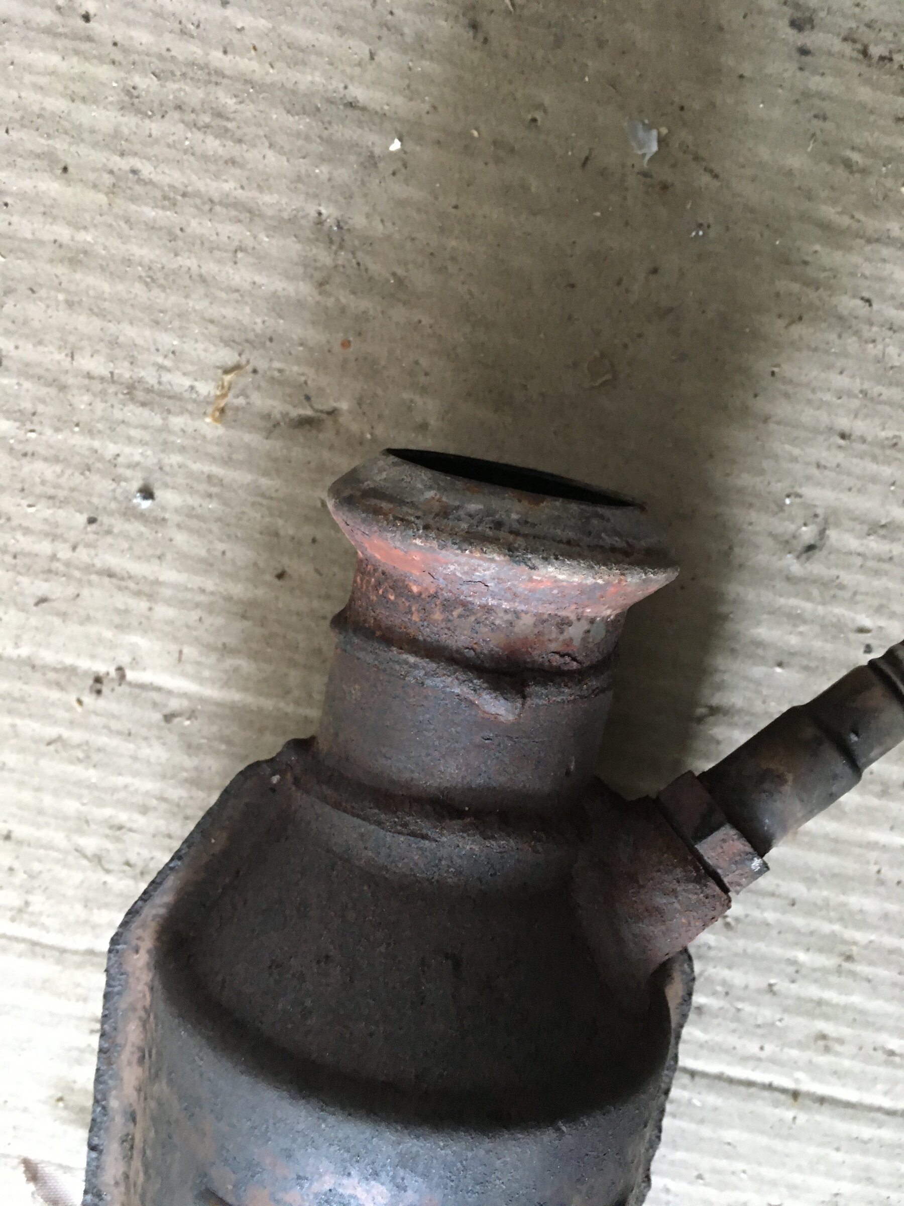

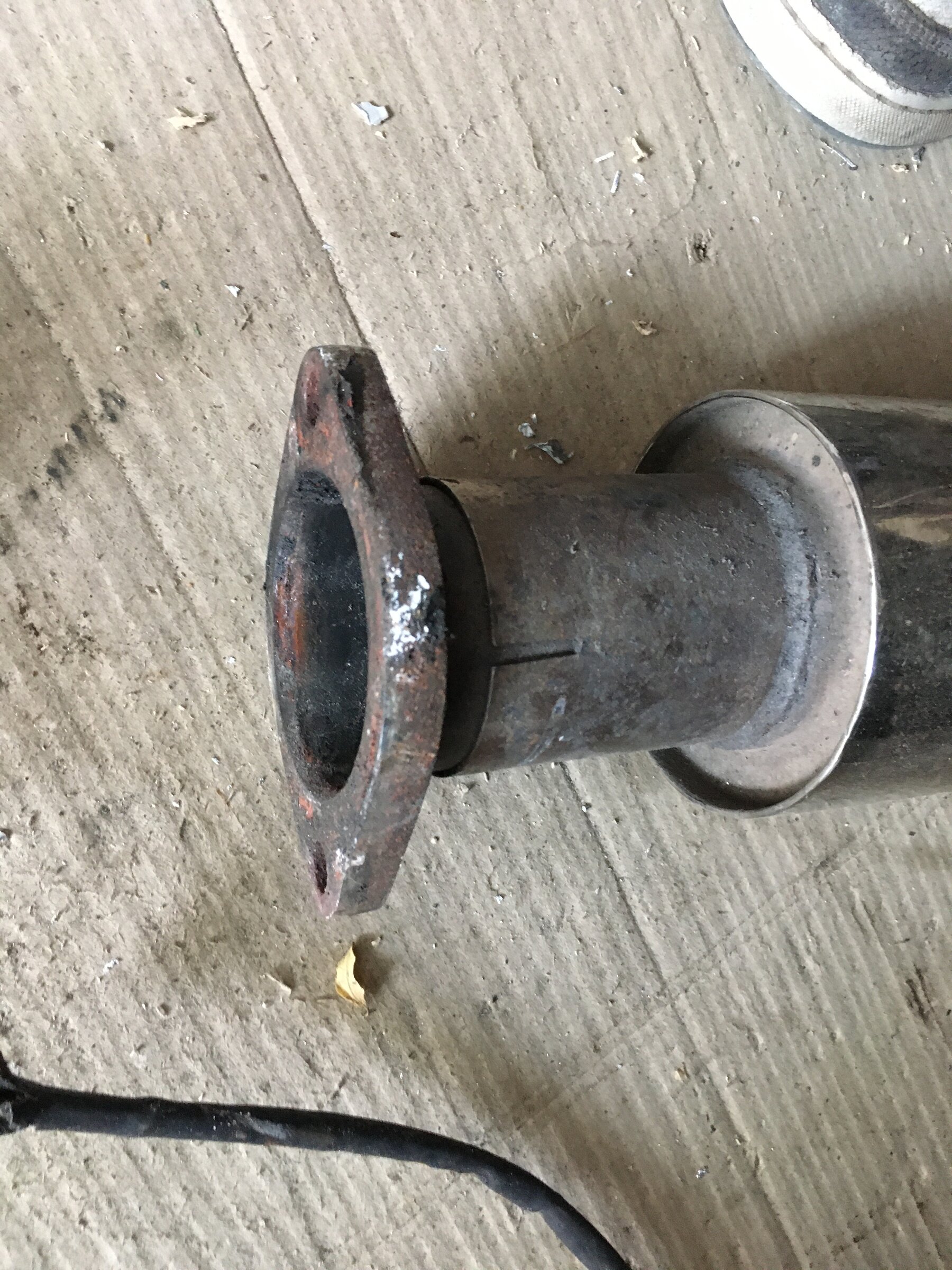

I wanted to fit a 172 exhaust which has a different length centre & a flange:
Which is too long and obviously not compatible with the olive joint:

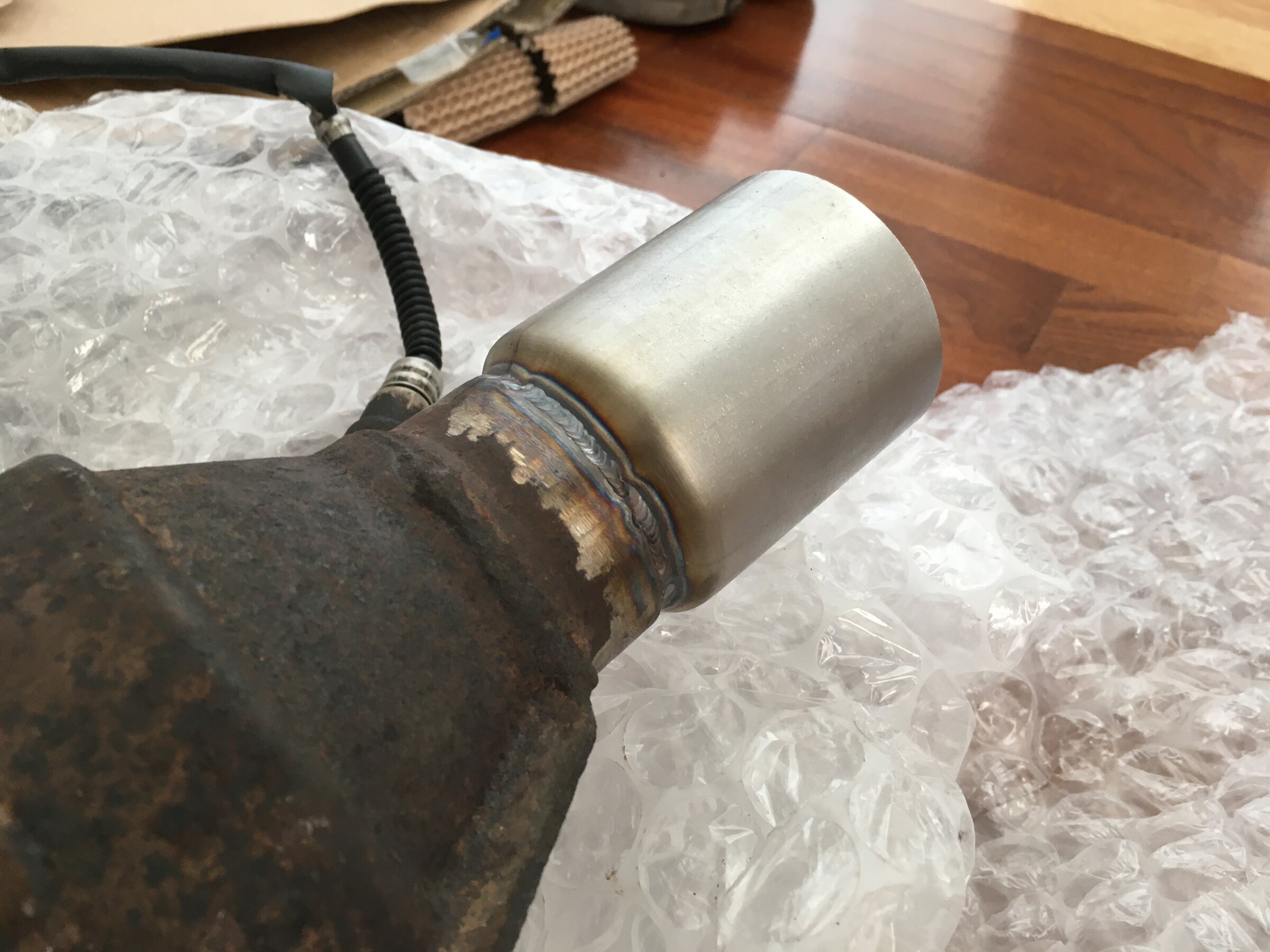

Chopped olive joint off, bought one of these in a custom size (not the size shown):
Slides down the inside of the cat so ensures it’s on straight, and welded by @dann2707
Then that slides into the centre section which was cut to length at a dodgy angle, slotted then clamped.
