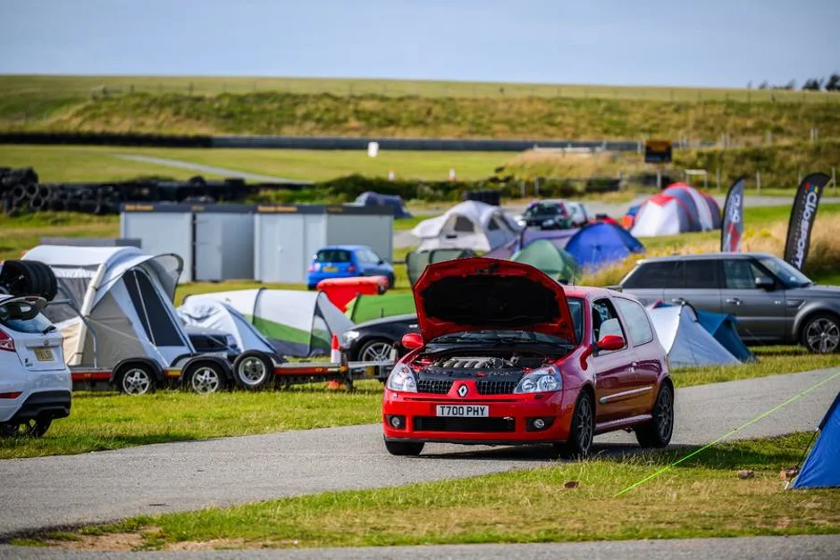

[July 2025] ClioSport Festival, Anglesey​
It was the first ClioSport Festival for both me and Joe (Clio Silverstone Edition), and our first time at Anglesey.
We pitched up late at night in anticipation of the track day ahead.
We had an absolute blast, and it was great meeting everyone, new and old. The whole event caught us off guard; we had no idea what we had been missing. It is yet another perk of ClioSport ownership.
Having seen the track so much in car media, it felt like I had already been. After chatting to one of the MSV guys, it turned out he was the one providing tuition to anyone who wanted it. No one had booked, so I took the opportunity. It turns out this helped a lot with getting up to speed. Joe later booked a slot, but trouble struck. His starter motor heat shield bracket had cracked again, shorting out the starter motor fuse. A quick pit stop and a drive up a kerb to remove it, and he was back out again.
We had some mega track time and great Clio trains running round all day, which mentally took its toll.

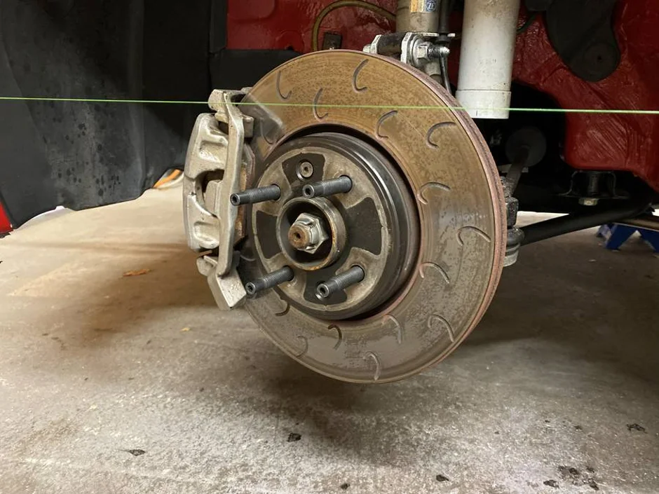

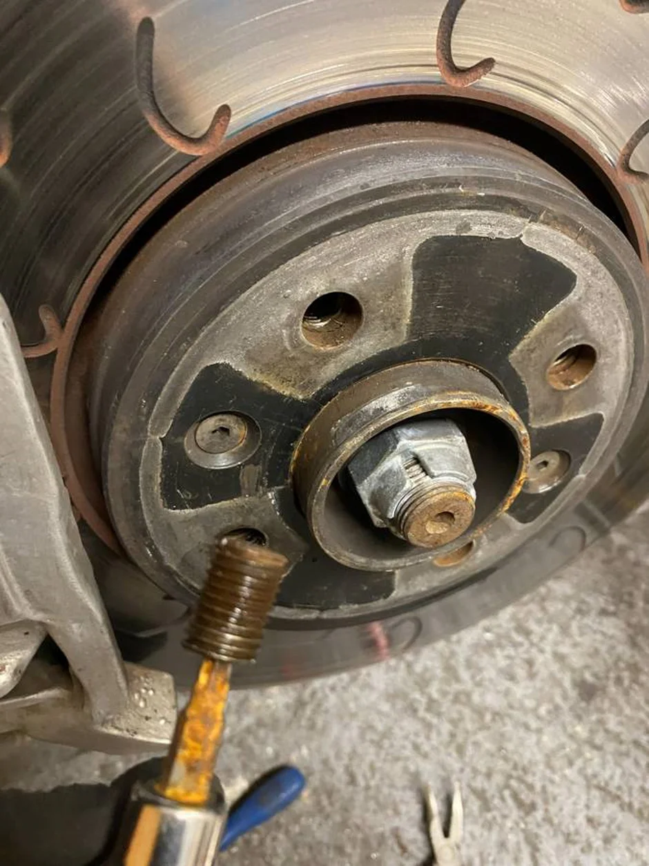

Towards the end of the day I noticed a vibration under braking and coasting. I assumed wheel weights and came in. I could not see anything obvious, wiggled the steering and found nothing. I looked it over and then thought it must have subsided. Back out I went, and back came the vibration. Was it a driveshaft? This time it was getting really bad, so I came in again and decided to call it a day until I could figure out what it was. I rolled round the pits and nothing was standing out as wrong. I then waited for Joe to finish and got him to wiggle the steering while I watched.

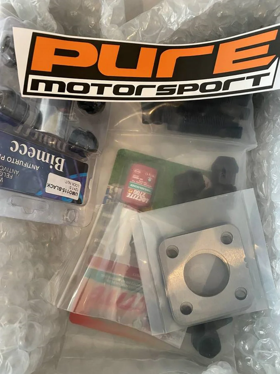

Er, yep, I saw what it was. The wheel bolts had all come loose and one of them had snapped. Eek. I cannot believe I did not spot it sooner. Thankfully, luck was on 007’s side.
We limped home with three of the four bolts intact. A PMS stud conversion was ordered promptly.
On return, the remaining nugget was extracted, I did a fresh alignment, and I shimmed the rear axle.

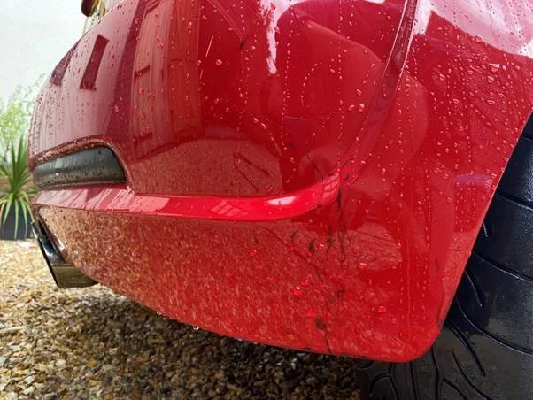

During the clean-up I noticed the rear of the car had sooted up a bit. I knew it had been running a little rich from the smell and the MPG. Figuring out the cause would be harder than I thought.

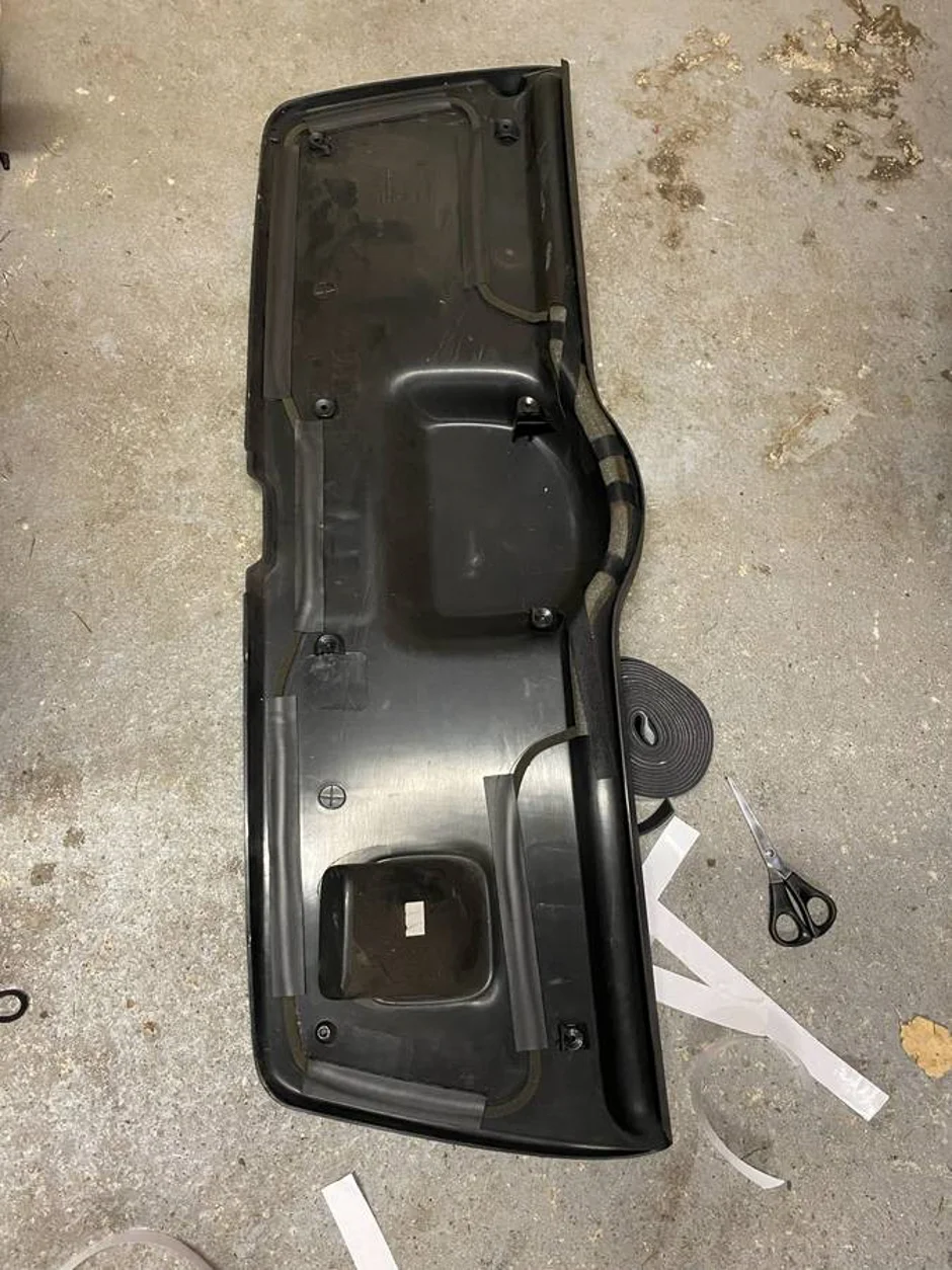

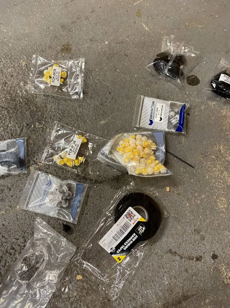

[August 2025] Interior trim rattles​

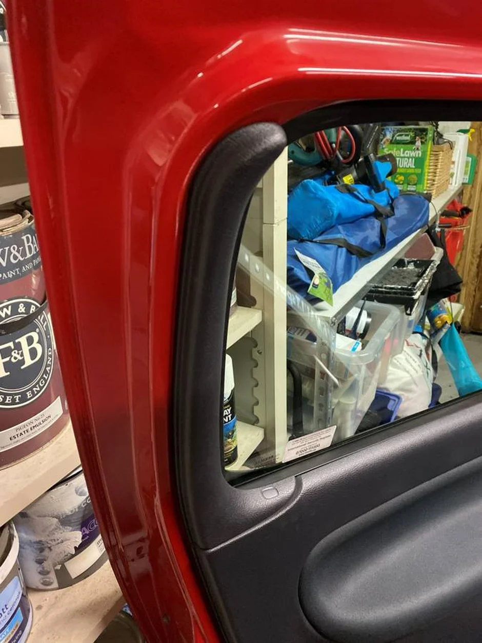

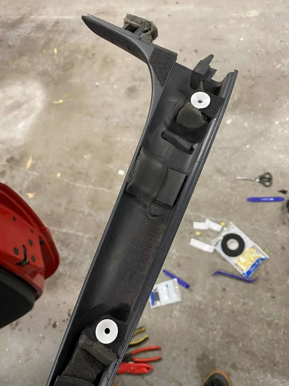

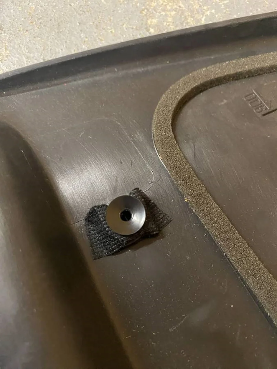

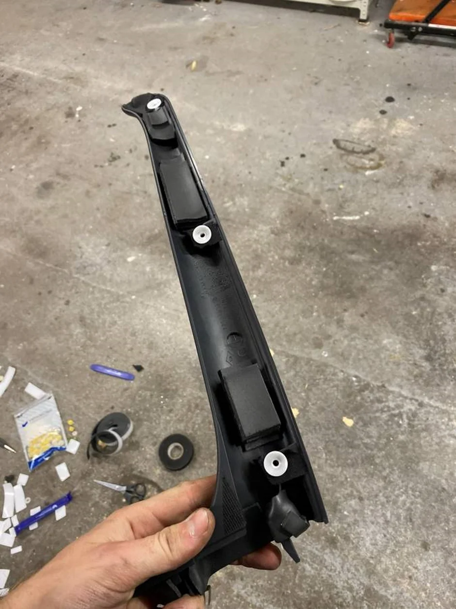

Later in August I spent some time solving one of my bugbears with the car. The rattling trim since the respray had been driving me potty. Eventually, something had to give - and it did. I was driving along a dual carriageway with the windows down when the interior window trim flew off and was caught in the boot.
I bought replacement clips, harness tape and foam, then carefully insulated all the clip areas. Safe to say it now sounds like a Rolls-Royce inside. Well, by Clio standards anyway.

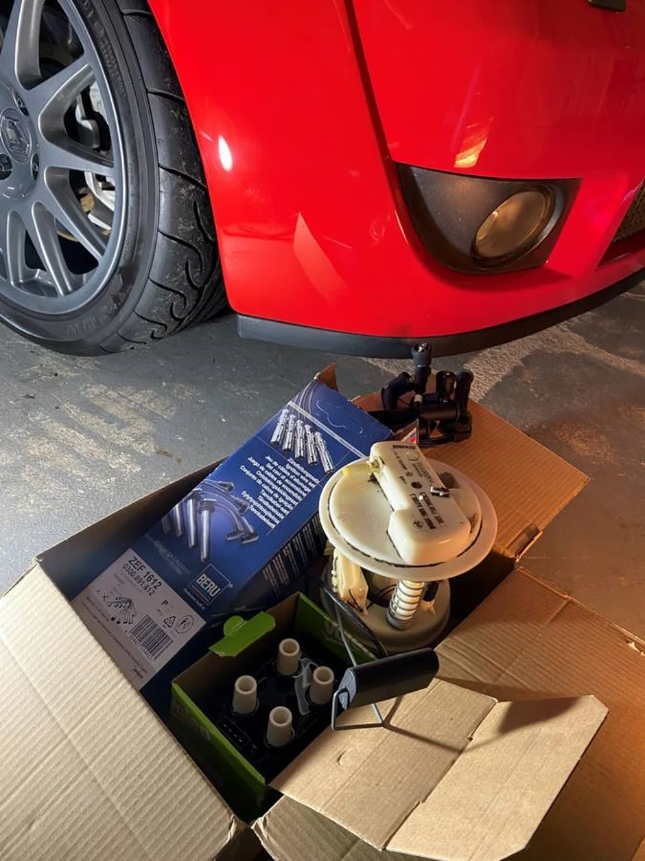

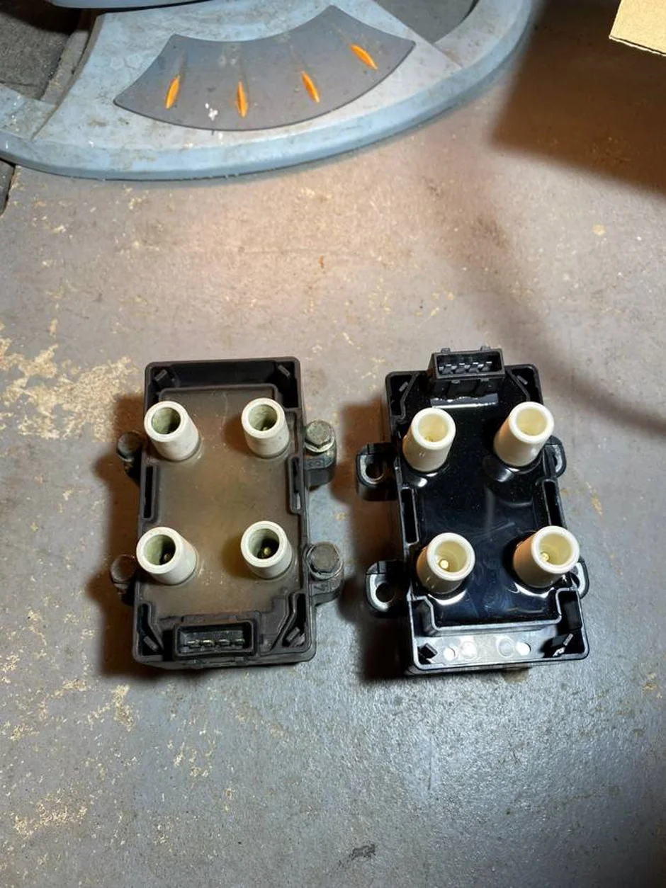

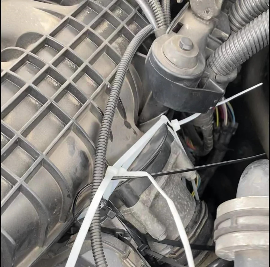

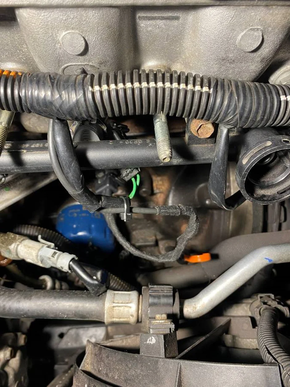

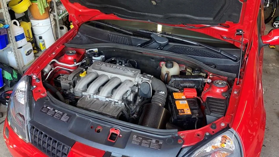

[September 2025] Rich running rabbit hole​
At the time I also revisited the rich fuelling issue. I ended up throwing parts at it, but still no bueno.
It did make the engine bay look nicer at least.

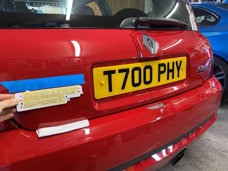

I also fitted a Renaultsport badge that had been missing since the respray. I know it is the newer style, but finding an older one at the time was troublesome.

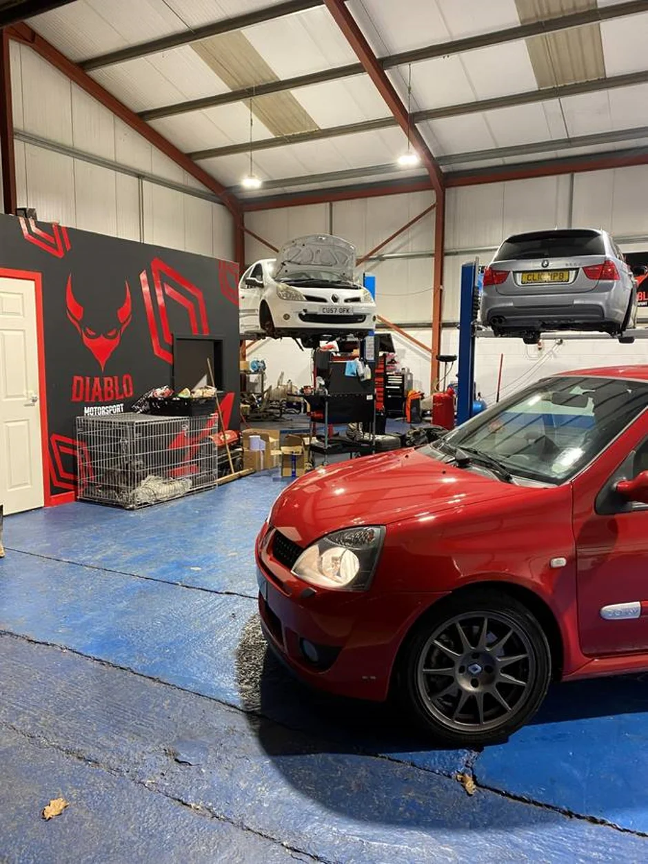

We spent an hour or so checking all the usuals until the only question mark left was the timing. Mick whipped off the cam covers and there it was: the timing was out of sync.
With the Trophy downing fuel like a football hooligan, the timing discovery at least made the rich-running issue make sense. The car was already booked in with Floyd the following week for its long-awaited gearbox rebuild, new clutch and Quaife LSD.

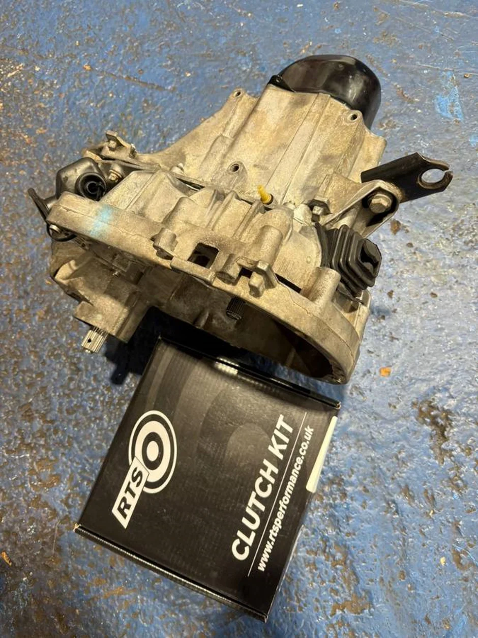

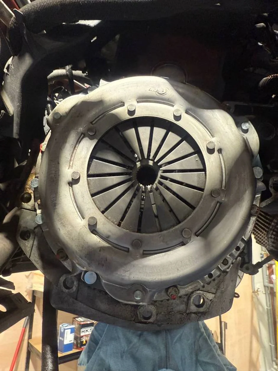

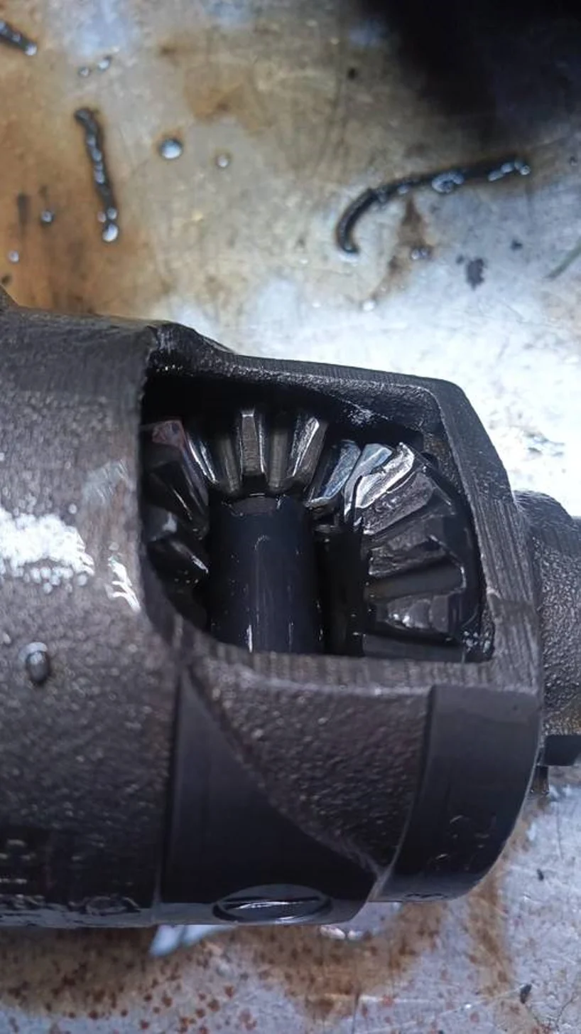

[Autumn 2025] Gearbox rebuild and Quaife LSD​
Rather than setting money on fire with power mods, I thought it would be better to make the most of what the Trophy already has. All 182 of them. So, LSD it was. I was hoping it would get rid of the one-tyre fire and make the car feel a bit more multidimensional through corners, allowing earlier throttle application and making corners feel less like brake, corner, wait, go and more like brake, corner, go.
Also fitted were a power steering switch and a new sump gasket. I think the one I installed prior to CSF was not right, as the leak persisted.

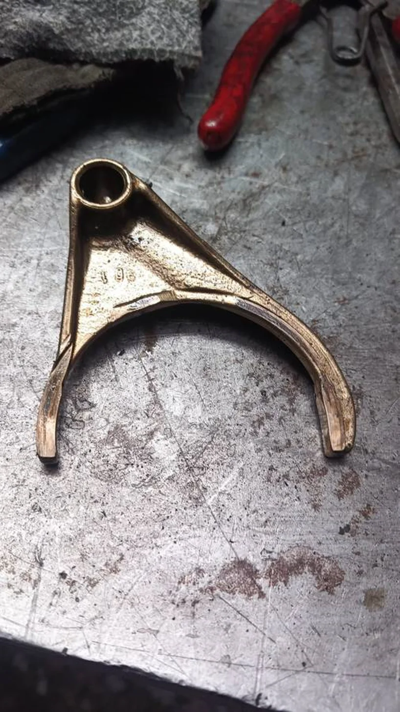

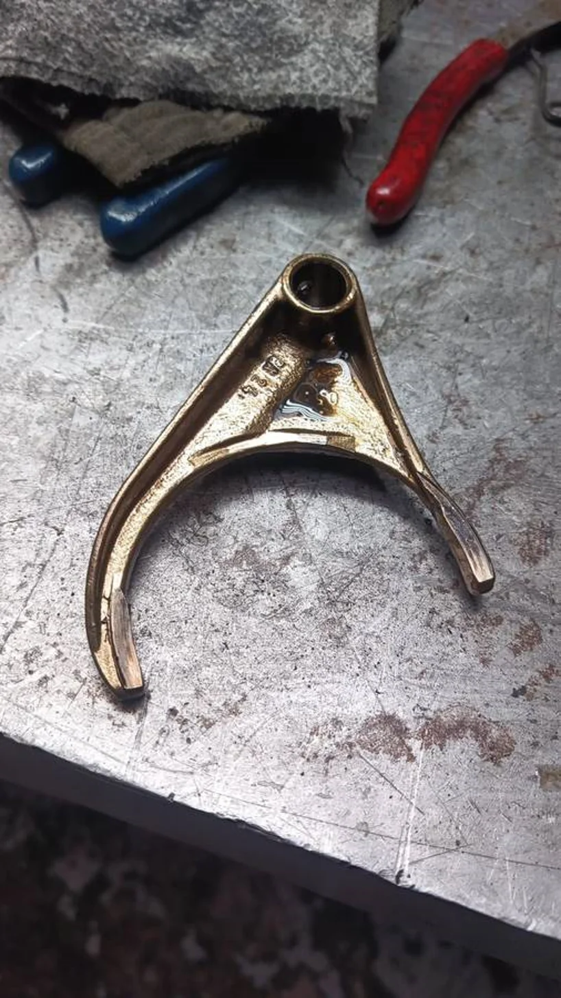

I thought it was just an upgrade and not strictly needed, but I was shocked when Floyd showed me the pictures. The original open diff had some nasties and a bit of tooth decay, so it was a good job it was getting some fresh new dentures.
The selector forks had also seen better days.
I picked the car up a couple of weeks later. It ran so sweetly on the return trip home. However, by November, with sub-zero temperatures and salt being spread, it meant putting the car away before I could properly test out the diff. Talk about an anticlimax.

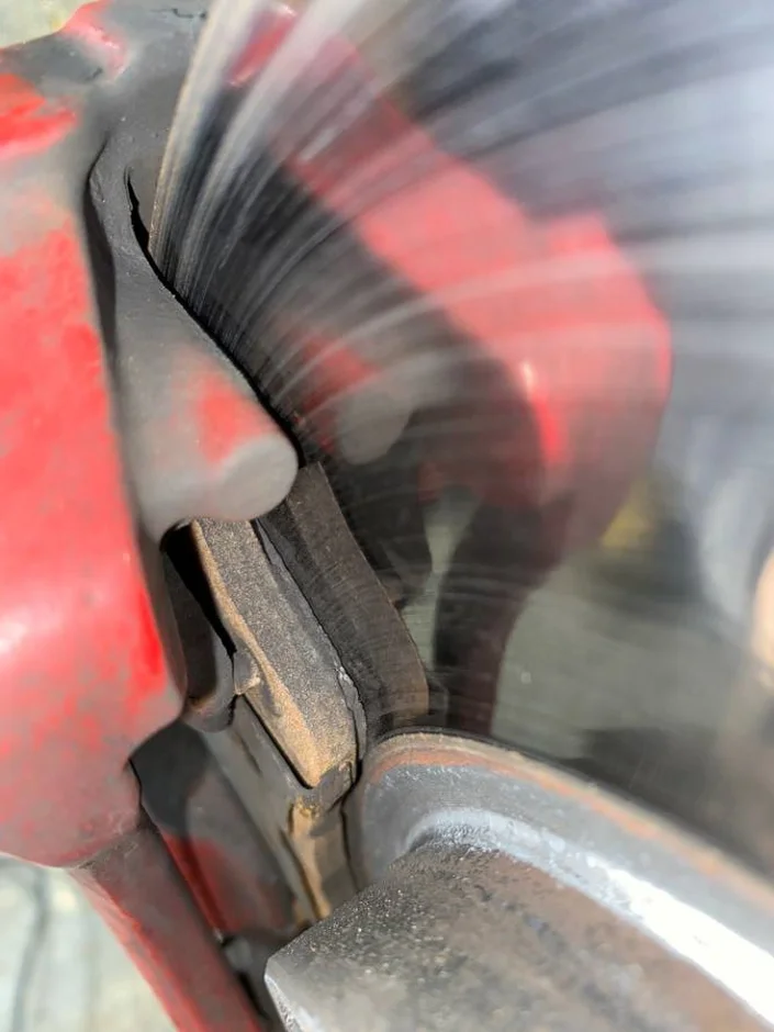

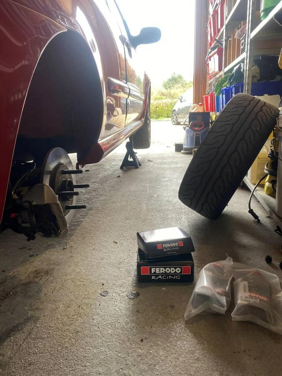

However, once again, so did its brake pads. These were new at the start of the track day: EBC Bluestuff.

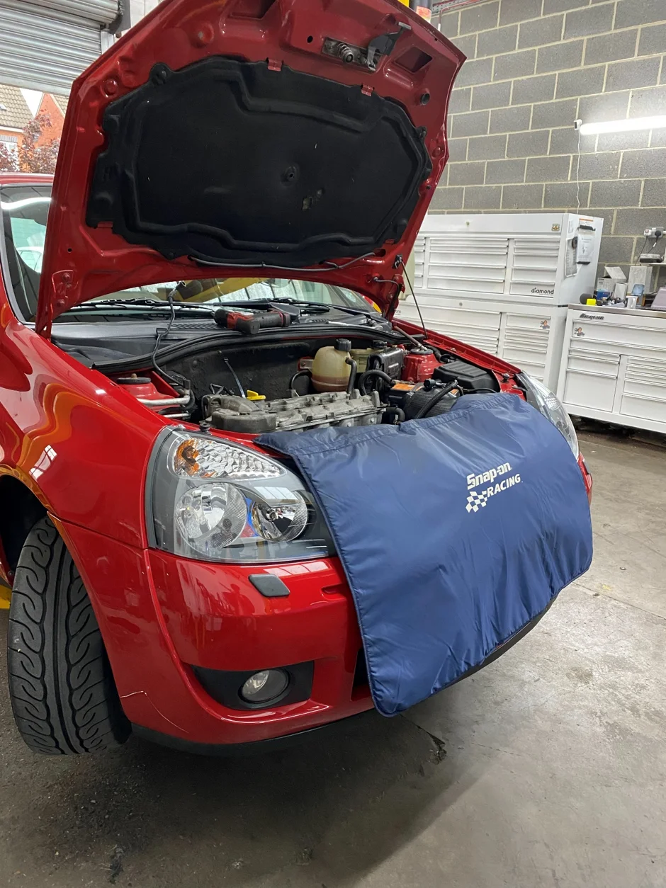

[June 2026] Back at Mick’s - what this time?​

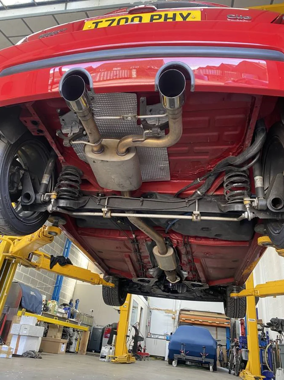

While at Mick’s, it was a good opportunity to see how the underside was faring six years on.
Not bad for six years.

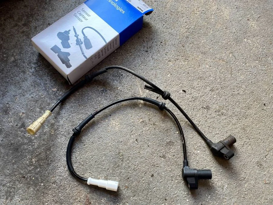

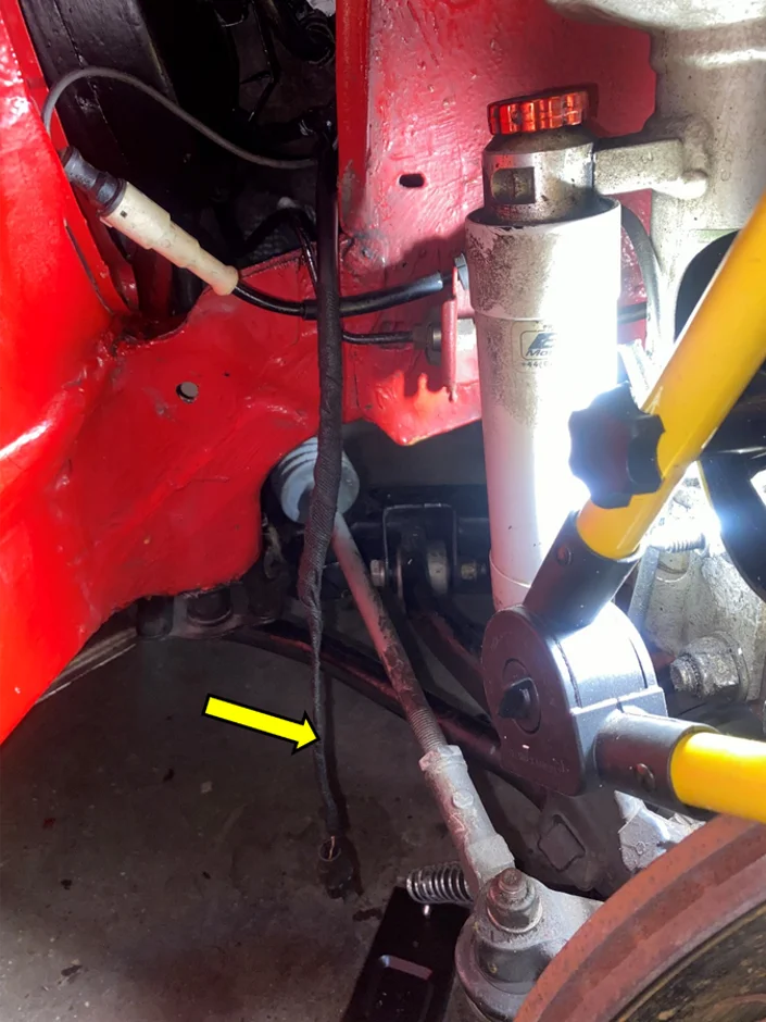

In the end, the likely cause of the fault was a faulty ABS sensor, but while there Mick spotted that the 197/200 master cylinder and reservoir attached to the car was trying to detach itself. A small mark was forming where the engine was hitting the master cylinder under braking or acceleration. Oh, hot brake fluid plus exhaust manifold? Not good. From then on, the car was grounded until I could source an original, slightly smaller 182 reservoir or do something more adventurous.

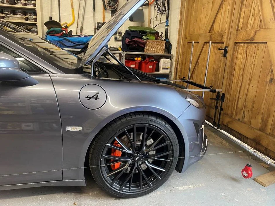

[June 2026] Life110 alignment​
I did an alignment and went with the most aggressive specs I could get camber-wise, then used toe settings similar to Life110. I am glad I did, because the rear was on 7 mm toe-in. No wonder it felt a bit reluctant to turn in.
Er... is this safe?
The answer was no, not as a long-term solution. I was also the only Alpine at the MTB enduro race.

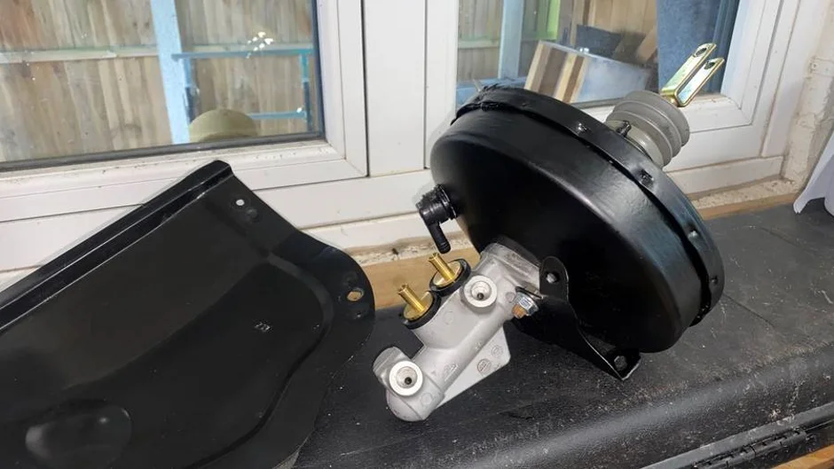

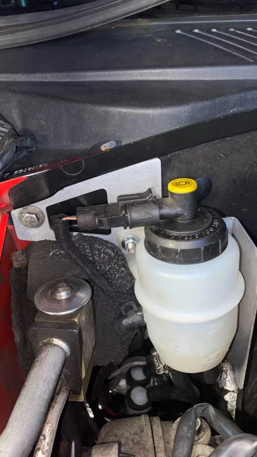

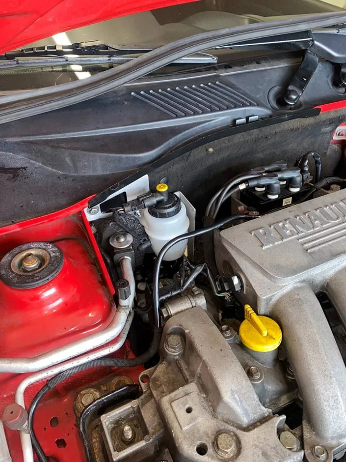

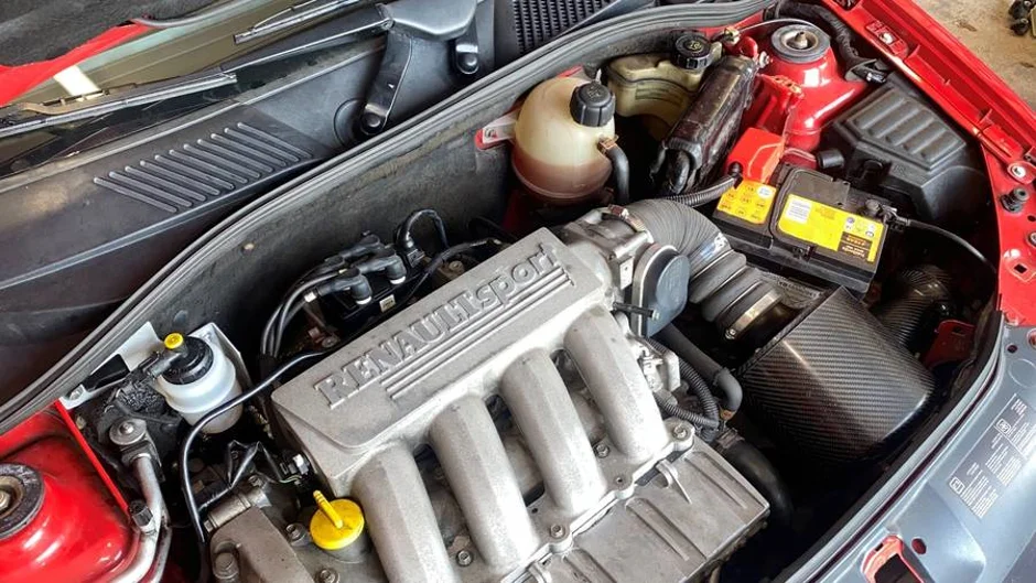

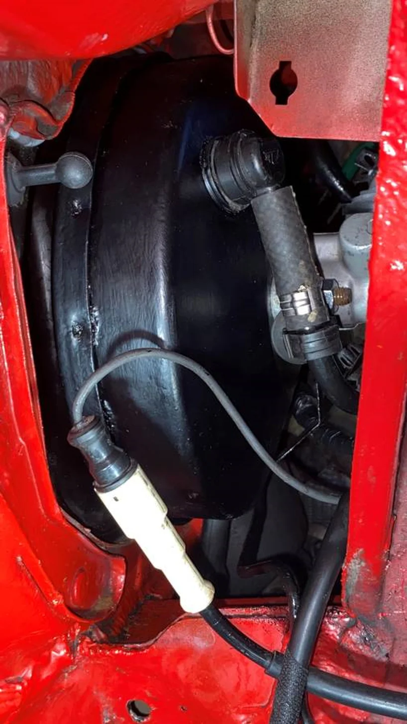

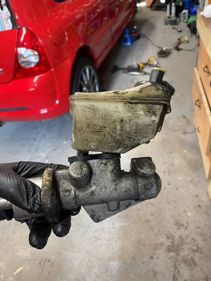

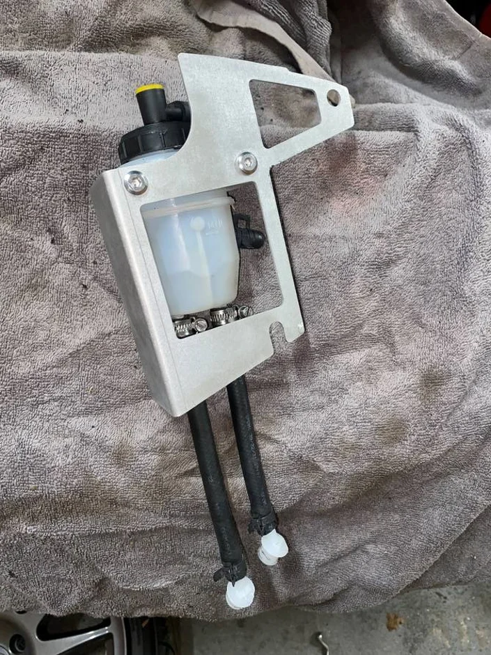

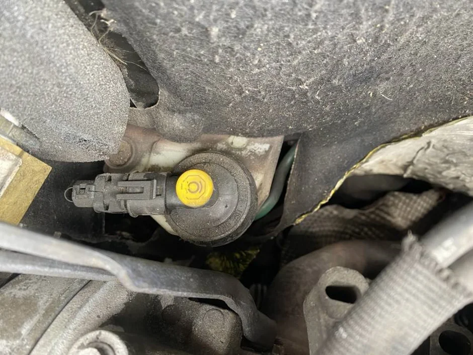

Back to the Trophy. I was on the quest for a 182 master cylinder and reservoir. No luck. At this point I had bought three used ones, and all of them were 197/200.
Crunch time. Either the car becomes a static piece of art in the garage, as I did not fancy making the first Inferno Red Trophy, or option B: I make my own setup.
I went option B.
Luckily, work gives me access to a few things that make the process easier.

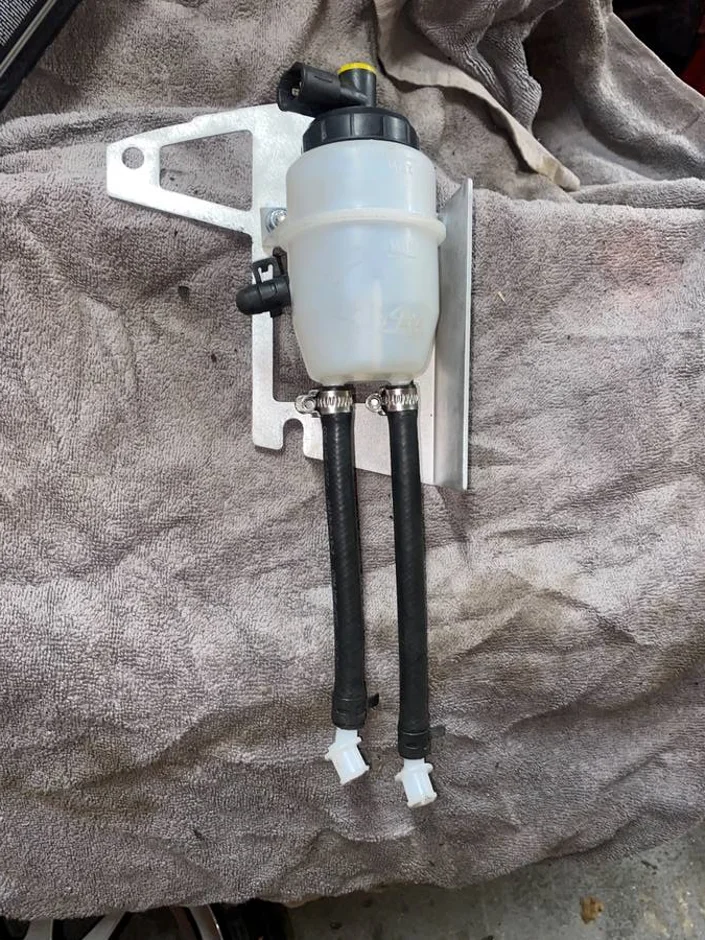

I found a suitable reservoir online: an ATE unit used on older BMWs. Another Trophy owner had used one to make a remote reservoir, and the cap and sensor are a straight swap.

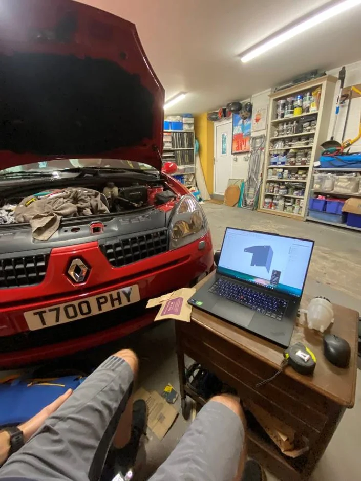

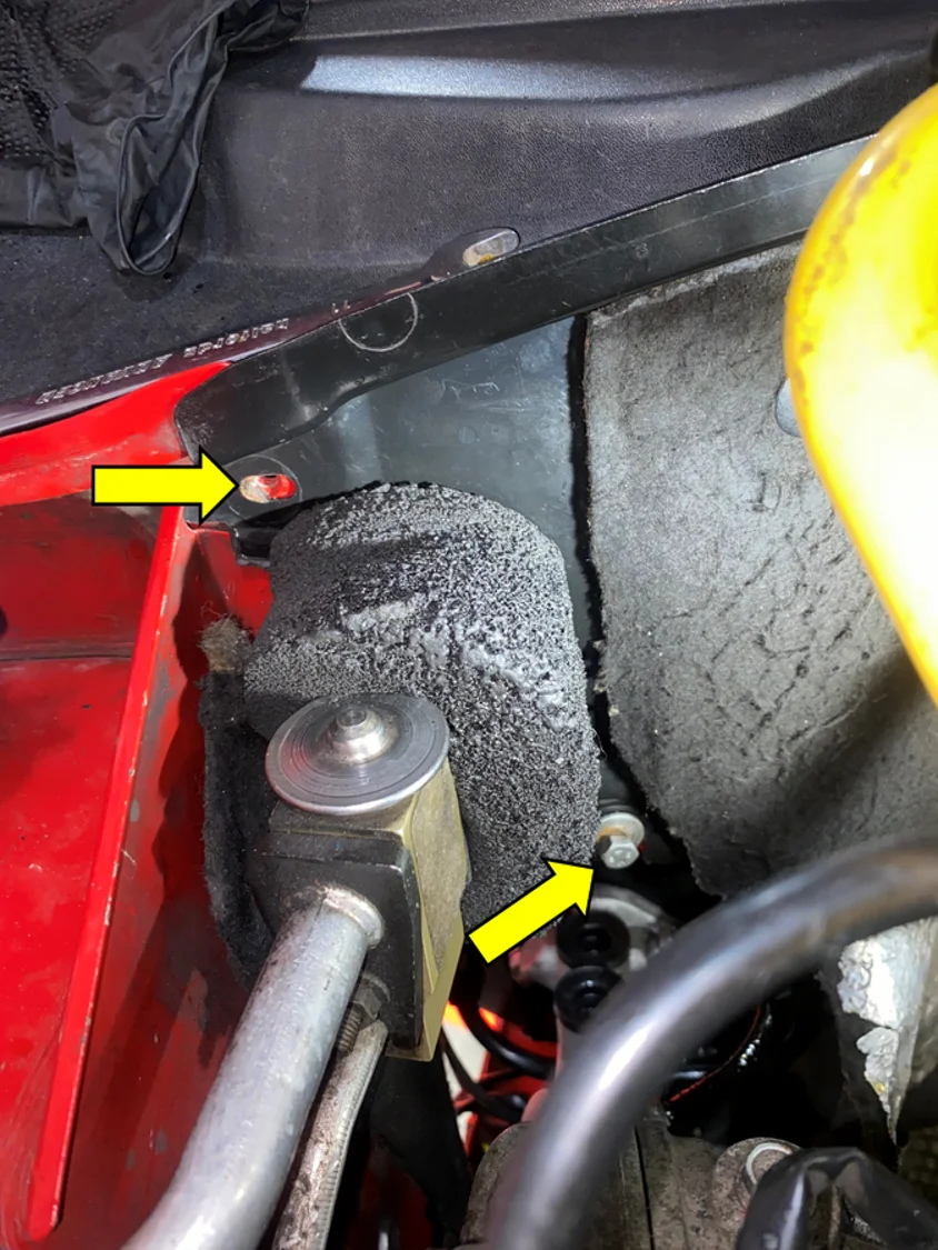

I ordered a selection of fittings and hoses, then set to work designing a bracket to mount the reservoir using original mounting points.

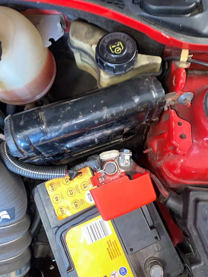

This is the area I used for mounting the reservoir. I used the two fasteners on the back engine bay panel.

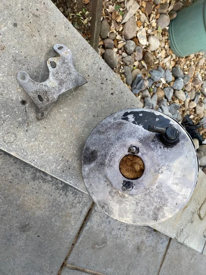

I am glad I went for it, as when I took the current master cylinder and reservoir off, the reservoir was probably one hard road drive or track evening away from relieving itself.
It took a few templates and design revisions, but eventually I got to the point I was happy.
In the end I used Xometry to manufacture the brackets. I was really impressed. All I did was upload the SolidWorks file and PDF drawing, and within seven days they had been fabricated and shipped over from Poland ready to fit to the car.

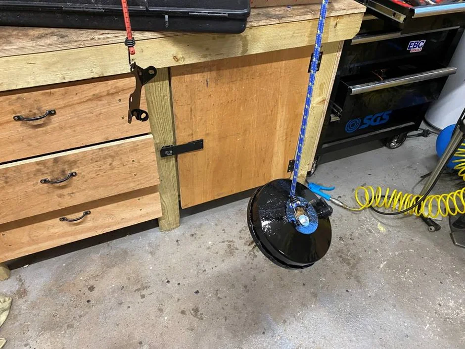

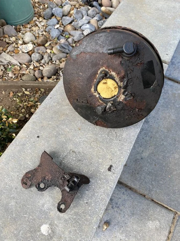

I could not bear the sight of the servo. Very crusty and nasty. That came out and had a spruce up. Same system as before: POR15 products with a topcoat.
There was a bit of trial and error in finding the best fittings to use and the best assembly order, but eventually I was happy. I did not end up using these Ford Sierra fittings in the end. Their sealing was not great, and the position of the reservoir favoured some angled plastic ATE fittings.

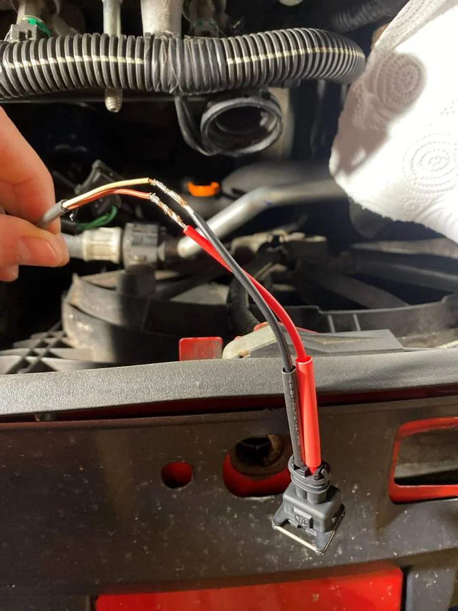

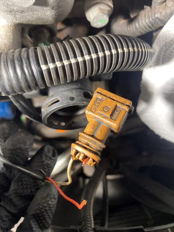

The new reservoir position also meant the wires for the level sensor needed extending. I soldered in some extra wire and wrapped it in harness tape.

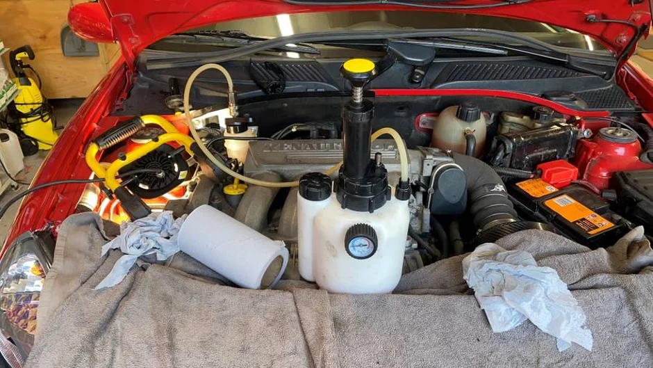

Bleeding the brakes took a good amount of RBF700, but they came good.
Getting to the reservoir and checking the fluid level is now easier.
Really happy with the results.
This is the bracket setup. I would have liked to use all black hose clamps, but I ran out of time to order some before CSF.
The flange on the left is for stiffening the bracket and acting as a heat shield.
To assemble it, connect the hoses to the master cylinder, loosen the lower fastener on the engine bay back panel, slide the bracket in, fit the top fastener and tighten the lower one.
Another detail I fixed was the battery terminals. They were a bit close for comfort to the ECU bracket, so I ordered a Renault battery terminal cover and made some little brackets to fit the wires underneath it.
I also changed the suspected faulty ABS sensor. The quality is not like OE. This was new six years ago, and already the rubber on the grommets was falling apart.
