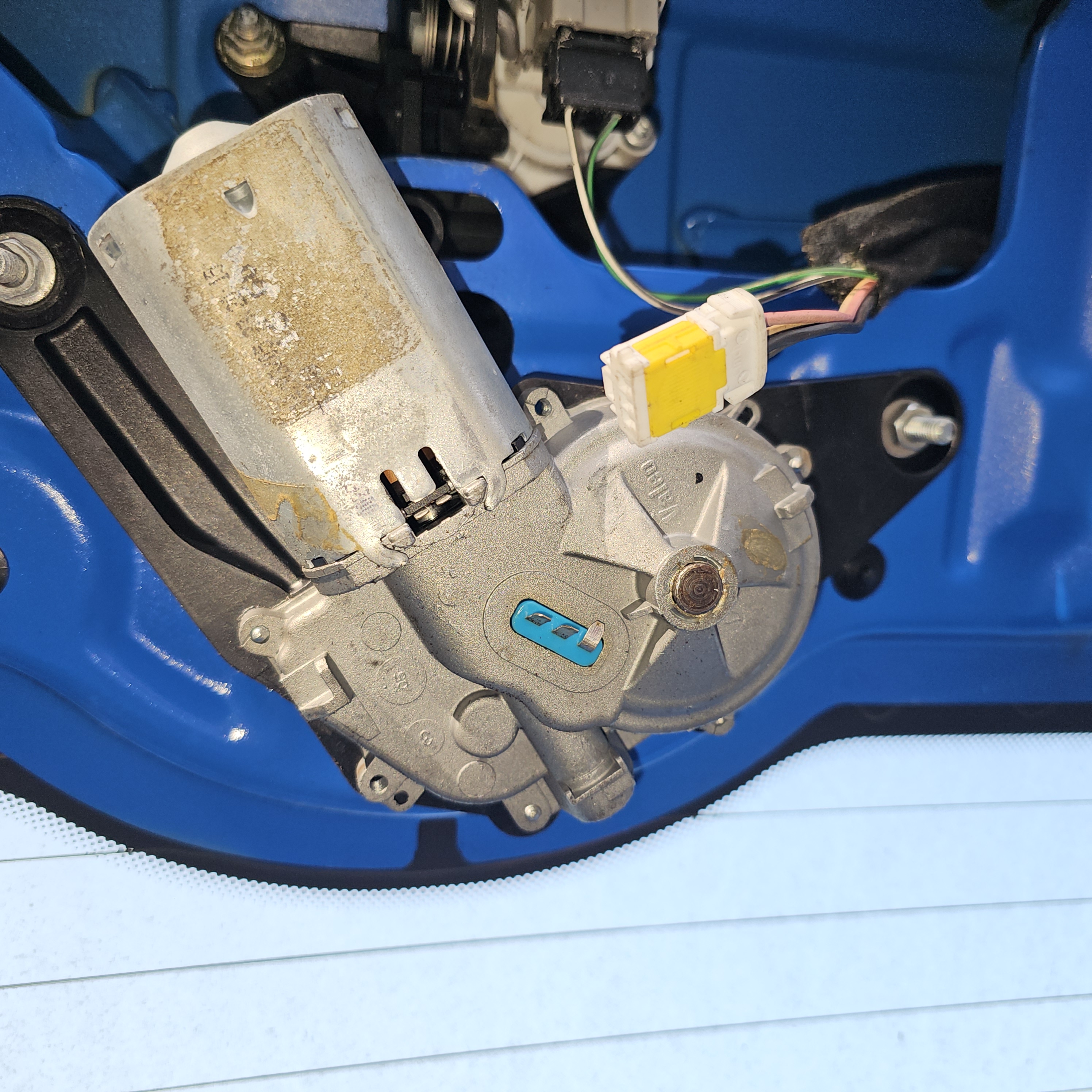

I've pulled the rear trim to investigate why rear wiper not working and found some disconnected wires see photo please any advice
Part of the motor is missing that the wiring plugs into, see pic below.
Its either been ripped off by accident or due to wiper going all the time due to faulty uch. Only one way to find out

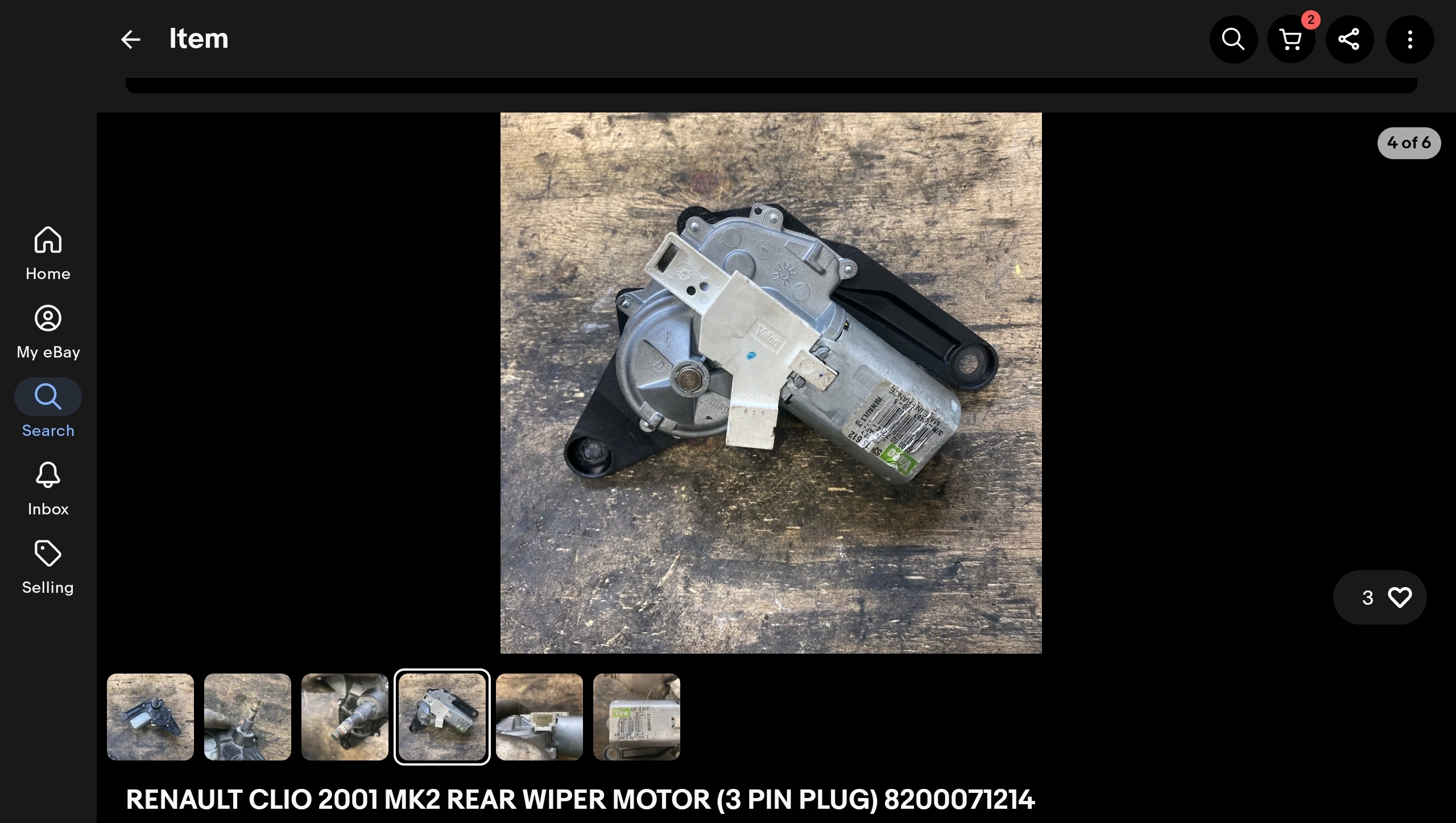

the rear I have managed to remove my old one with the wiring/plugs and missing bits, that was very easy to remove once I realised the correct way of removing rear wiper...... hacksaw on shaft now need either shaft out wiper arm or new wiper arm, but as luck would have it once I have mine out someone has removed the sticker with the part number so I have checked it against the image Brigsy kindly supplied and have just ordered one on eBay.
thanks again for all your help,
Sean-f
Success, new second hand rear wiper motor works new new wiper arm and blade fitted all good hopefully no need for UCH, my grommet for washer pump has disappeared in the post so need to get another then I do think I'm onto the cosmetic side of things,
