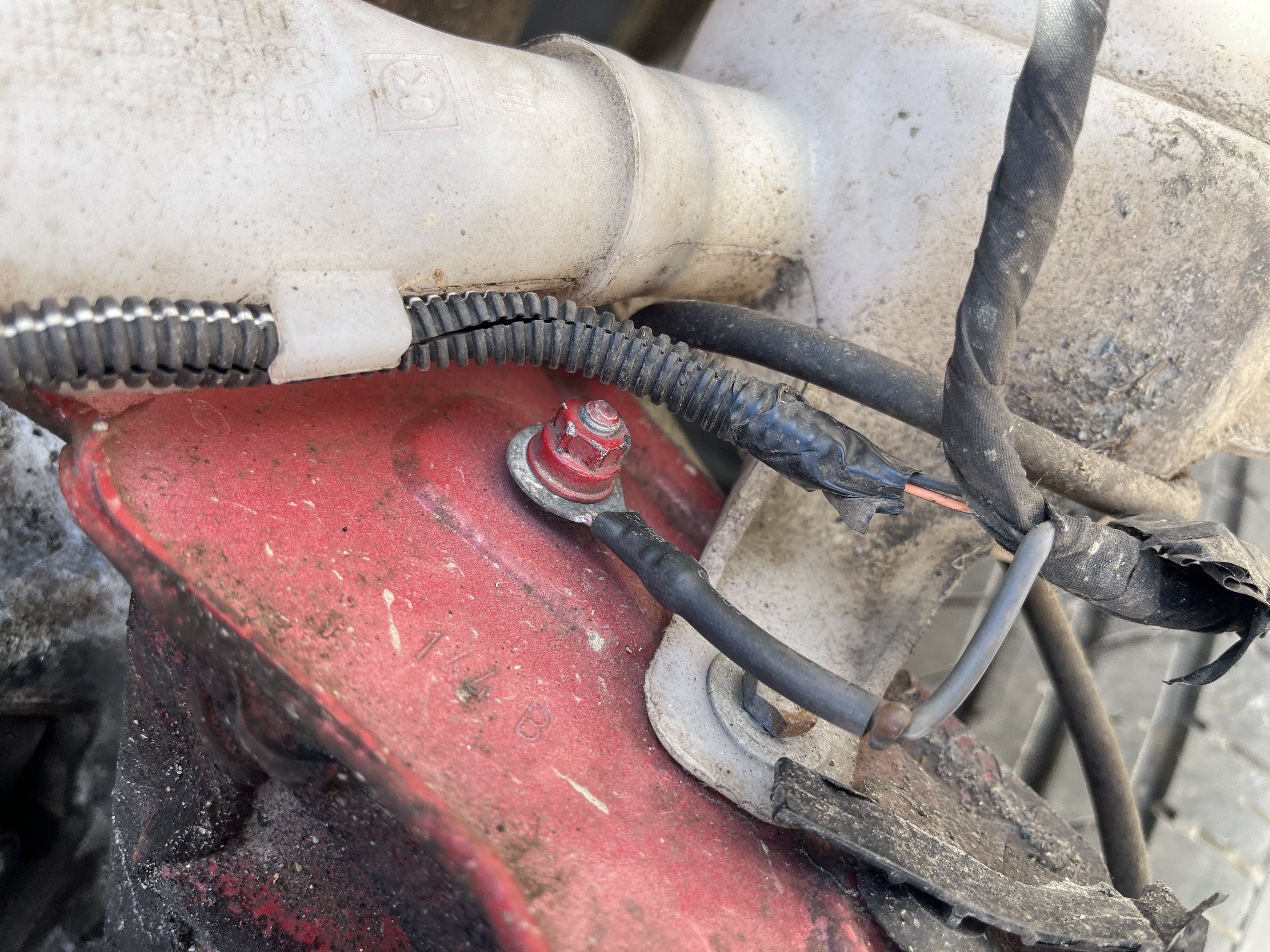

hi i have a 2010 renault clio mk3 1.2 recently got into a crash on the OSF and now i have some very wierd electrical problems such as ;permanent dipped beam(no high beam and can’t turn dipped off) rear wiper constantly going , no front or rear washer and to turn front wipers on i have to position the stalk where i want it then put the rear washers on and that turns the front wipers on for some reason, also when i turn the rear washers on it turns my lights off momentarily checked the relays all look good replaced the light stalk , no change any help would be much appreciated my next though would be maybe broken earth somewhere
took bumper and headlight off earth behind osf headlight seems okay
