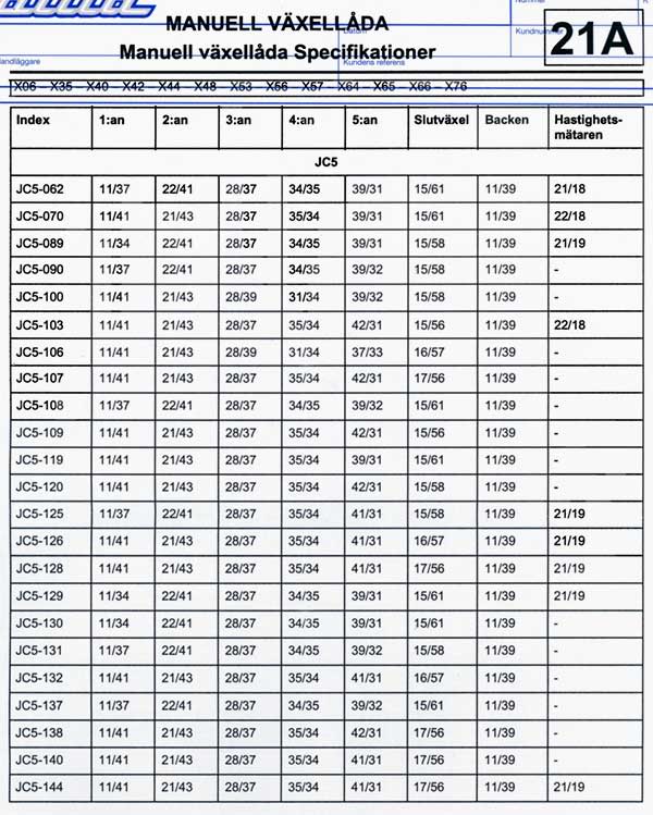

If you have MY2003 172 with cruise/ESP then a 182 JC5-130 is the correct box.
If you have MY2002 172 then a JC-129 with speedo drive from Ph2 172 or 172 cup is what you are after.
If you would like a higher final drive ratio, you can use a JC5-089 from a PH1 172.
The gear ratios themselves are the same.

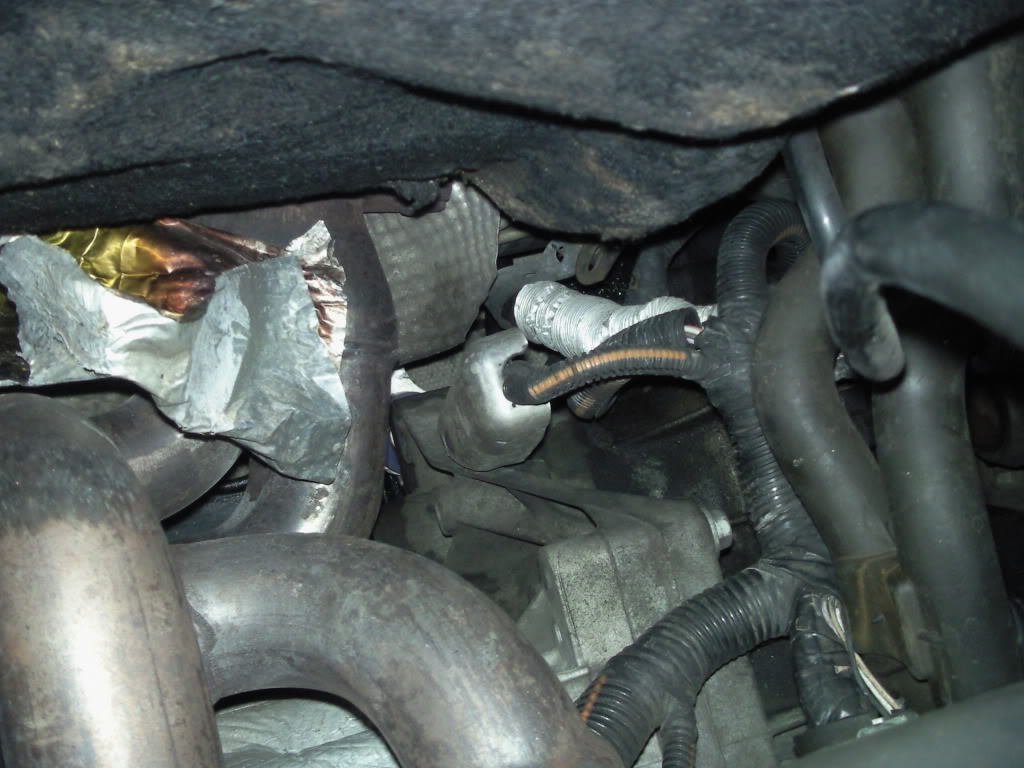

Best way to know is have a look at the box your car has, you're looking for this, or lack of it.
The orange stripe wire with the little metal heat shield, it's the speedo drive, as said if you have one you'll need a JC5 129.

I have a 52 plate 172 and don't have a speedo drive so I always use JC5 130's.

Sorry to hijack, but your pic indicated that I'm not the only person with the tin foil heat shield fallen of the firewall and melting on the headers.
Any way to fix it?
