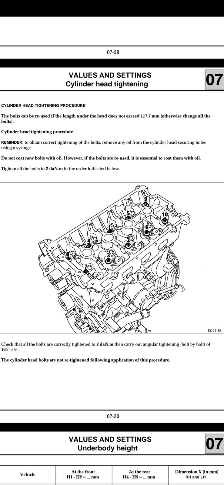

Hi guys
Flicking through and i keeo finding contrasting comments on the torque spec fornhead bolts on a clio 182.
Has anybody got an up to date definitive answer,
Thanks,
Jamie
Sent from my VOG-L09 using Tapatalk
Would it be any different if using ARP assembly lube on the bottom of the head cap and thread?
