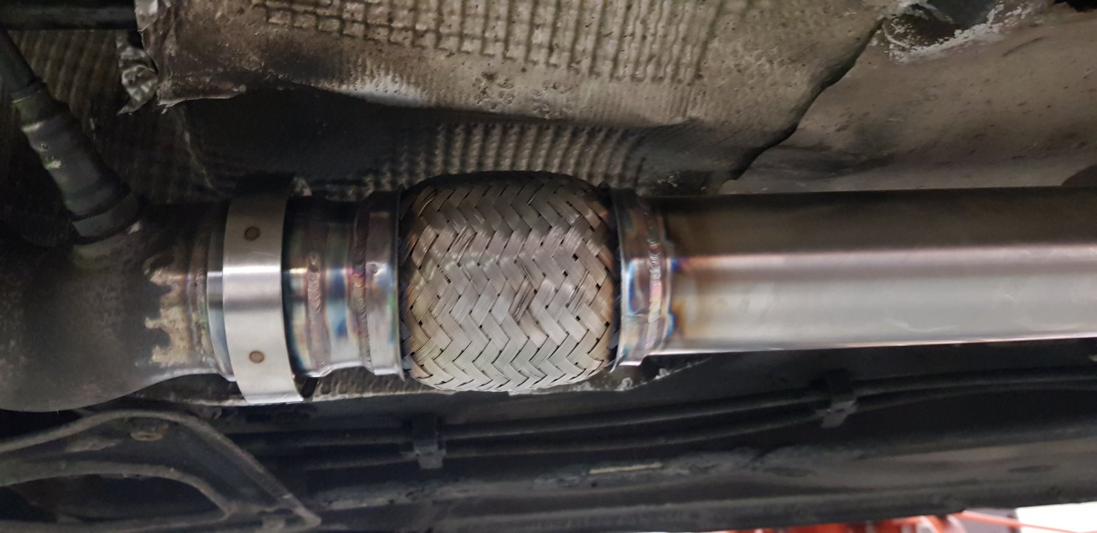

I had a vband fitted with the manifold on the car. Obviously easier when off but totally do-able

But if you wanted to change a decat / cat etc you'll need to weld the vband on so swings and roundabouts depending on future plans. I've had to use an aftermarket cat which I know will be an ongoing pain so it's the simplest route.

Vband all the way. Spend the bit extra and do it right once. Also easier if you plan on swapping a cat for a decat come MOT time
  Mondial Blue 172 Cup
My 172 has v band on the 182 manifold and a link pipe with a flexi. It's the best thing ever!

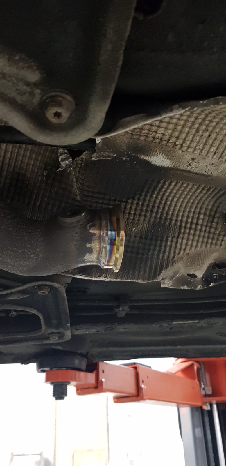

Sorry to hijack but will the 182 manifold come off without dropping the subframe? I really don’t want to have the chew on of doing it. More than happy to get the grinder out to chop it if needs be cos the turbo downpipe should fit with the subframe in situ I suppose?

Itll probably come out with an angle grinder, definitely wont come out without removing the subframe in one piece. A reciprocating saw might be better imho
Turbo downpipe fitting depends on who made it. Shouldnt need undertray removing.

To be fair, the subframe might come off without too much bother but given how lovely the bolts look I’m not hopeful! Recip saw it is if it all goes wrong 😎
