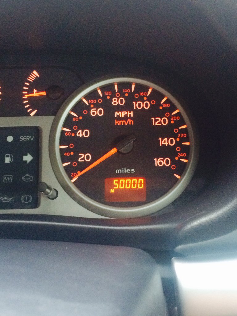

indeed mad money! seems worth it tho if you do have the money! i luckily hit 50k the other day so have plenty more miles left! :)
