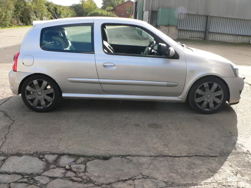

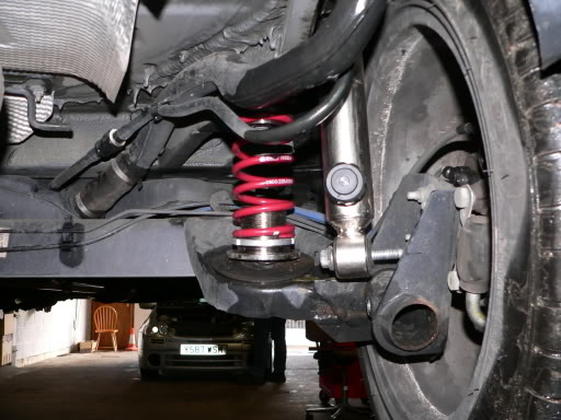

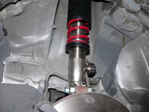

I would say about an inch at the back and the liners had to come out at the front as it was rubbing.
It catches on my driveway now so definately lower. As Andy says it was to make it handle better not to deck it. They are as low as they will go on the back anyway.
They retail at about £1250 ish but the group buy Gary organised got them down to £900. I think Gary can still get them cheaper.

at the end of the day a cupped clio is a still a compromise. I think The ledas are much harder but still supple enough not to be harsh. This gives much better body control in corners and when braking. The car feels much sharper with more feel.
Looking at the Leda against the OEM they are in a different league in terms of quality plus the twin tubed shocks with adjustable damping would be too expensive to put on a car in this price range as standard.
The cupped clio handles well but IMO the coilovers make it much much better

Not at the back with the 6" springs it uses.
You can get 5" and 4" springs but the minimum rate these come in, from leda, is 300lb which would be too much for me.
The dimensions of the rear spring are a standard size which you can get easily, unlike the balooned out spring you usually get on the rear, so it would be possible to go lower with a diff spring length.

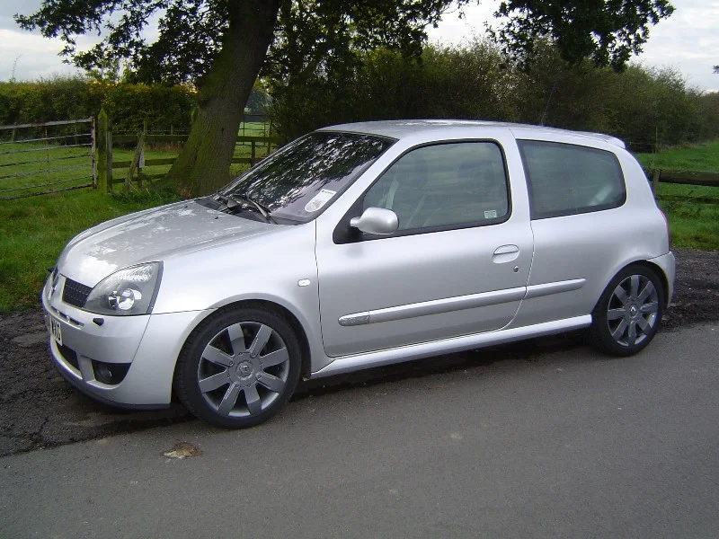

I know it's all about the handling, and not how low it goes, but to be honest I think that is the perfect level of lowering anyway. I think any lower looks daft, especially on standard rims.

I have got a more road biased setup with 200lb front and 250lb rear springs which IMO is fine for the road.

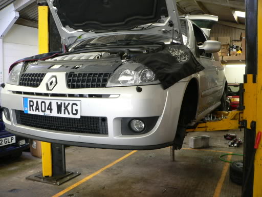

Thanks to Andy for fitting. I even got some chips for my dinner although I did have to make the tea!
There were some very nice Renaults being fettled in the work shop a couple of 5 turbos a V6, valvers, mccardel's 182? with brembos, recaros and half an engine! a silver ph1 172 (nice motor) being setup and a couple of Audi S3's and to round it all off the demo car which was a very very quick car. If you are into your Renaults it is definately worth having a look around (you should start organising tours Andy).
