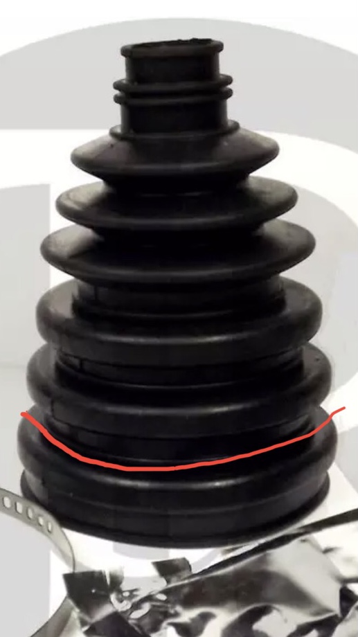

So I’d need to cut along this red line for it to fit correctly and not foul on the engine block tab
If your inside boot failed it's been rubbing on tbe block tab. Block tab needs cutting off, the cutting a rib is only for the outer cv

Well, now I am confused? 👆
Outside CV to me is the boot at the end of the driveshaft where the ABS ring would be going into the hub.
So it is my drivers side that has split and has a very small nick just behind the metal clamp of the fat end.
Youd never said which boot mate, I'd just said on the JR it usually splits inner boots.
For the outside cutting off a rib would be fine.
Along the red line in the pic I posted?
I need to take the tab down on the engine regardless because I've always thought it looks rather close to moving parts
