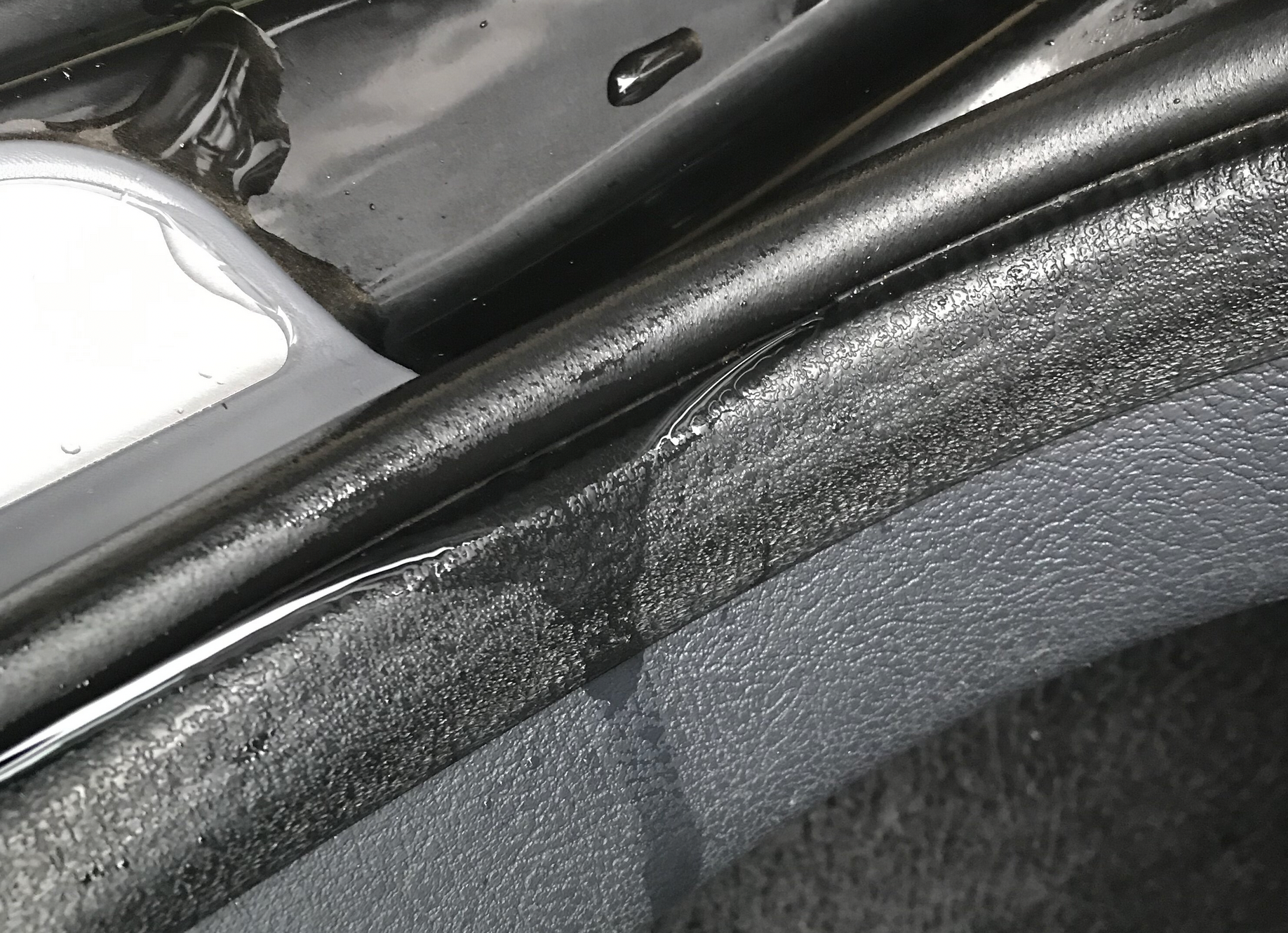

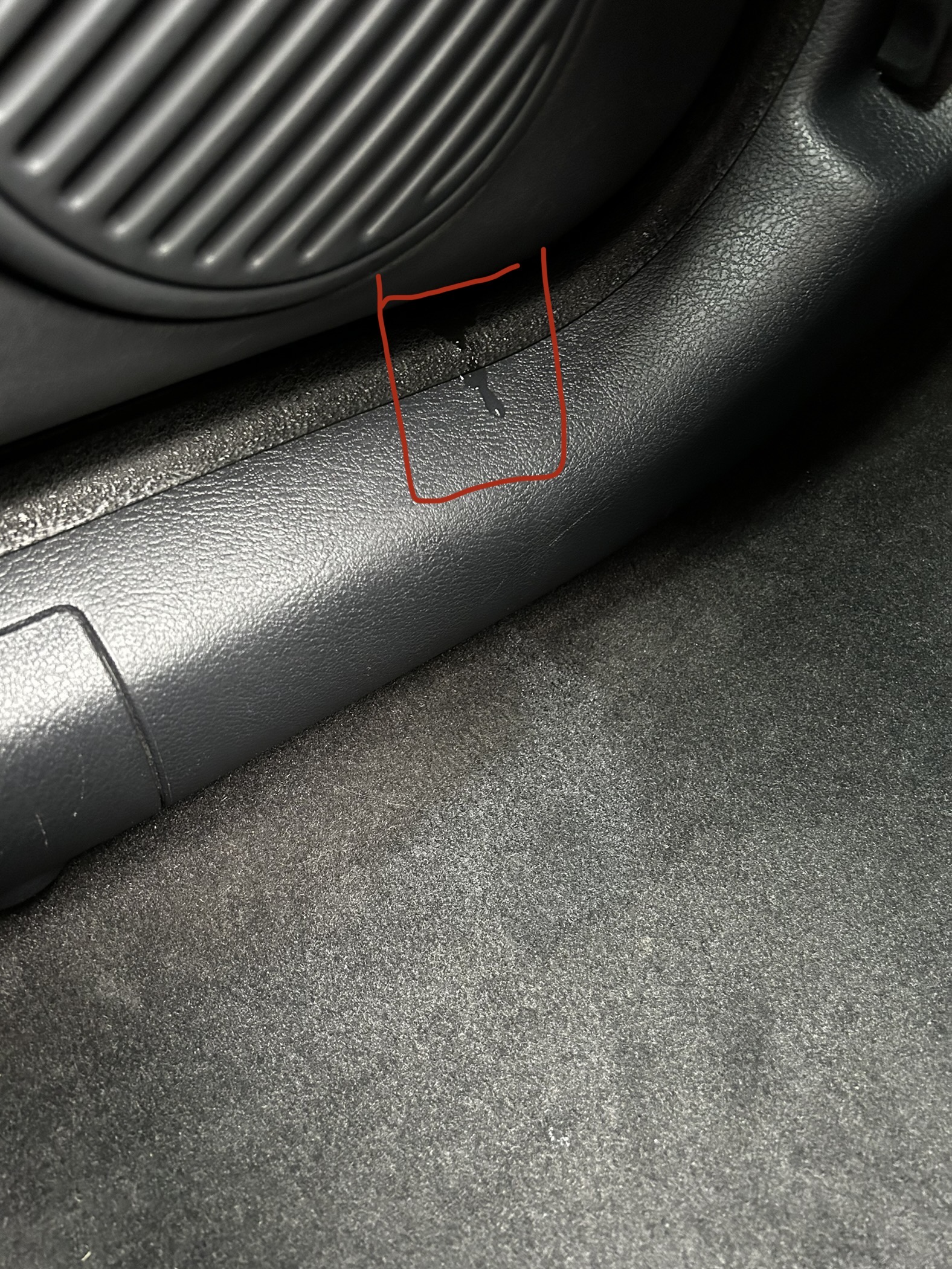

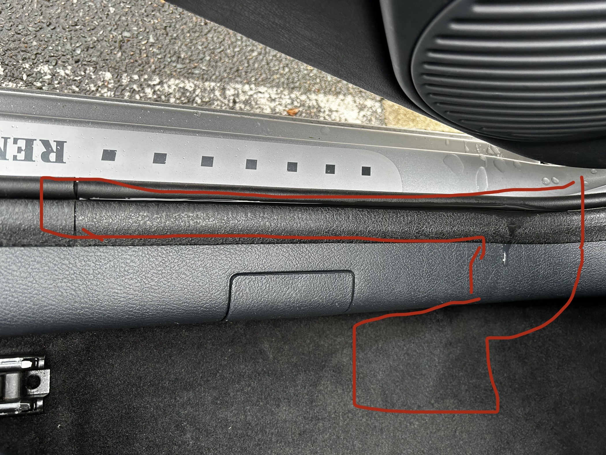

The issue I’m having might have been covered before so apologies in advance, with all the rain we’ve had I’ve noticed water pooling on top of the passenger door seal towards the front of the car and eventually trickling into the footwell. I’ve included a couple of pics. The carpets aren’t wet anywhere apart from the small area circled on the pic. Could it be the door seal or other drain holes else where?

Basically you need to take the door card off and redo the seals.

100% door card seal. Door card off, Butyl Sealing Tape (tenner on Amazon), jobs a good un.
