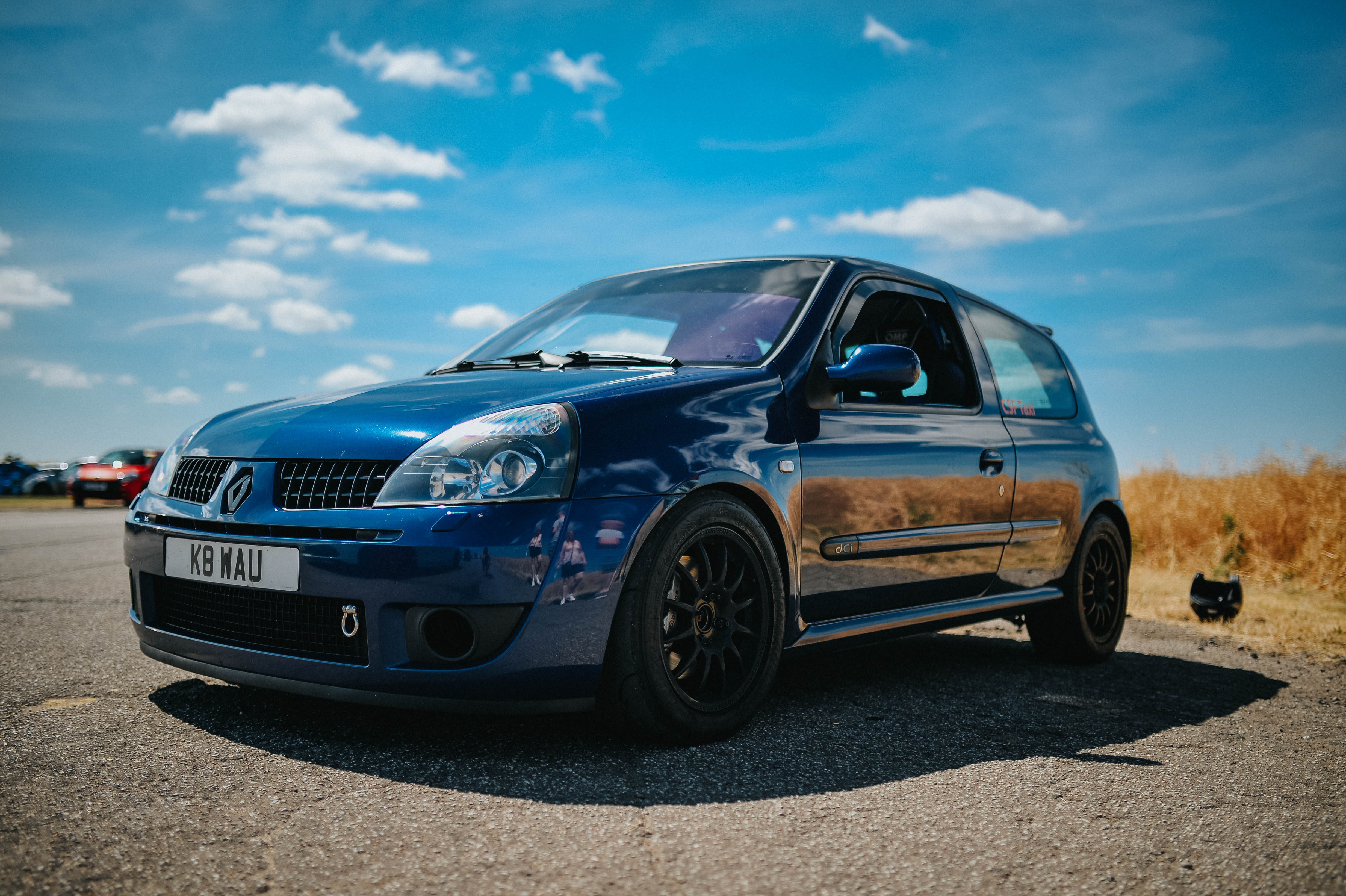

Pic of mine on coilovers and 15s. Think 16 would rub
Width the right offset, and maybe a little bit of trimming. You could do 225/45/15 or 215/45/16.
Also with track tyres the tyre can be wider than the advertised profile and varies between manufacturers.
