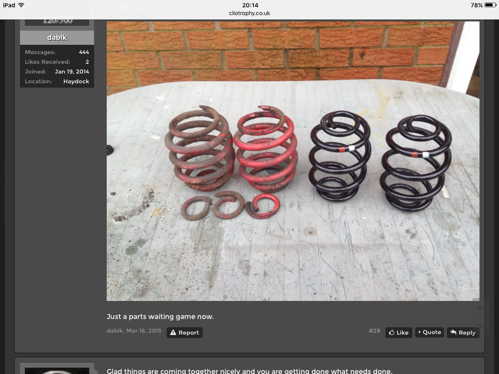

I've just had an MOT failure due to a broken rear spring. I'm just hunting around the net to find a replacement or a pair of. Mine have a red and white stripe on the top coil. There seems to be a mixture of these and some with just a white stripe. What is the colour coding meaning. I'm still trying to figure out if the Trophy rear spring is the same as the standard 182 or the cup version.
If anyone can help with answering this or has a pair of springs that would be helpful
Pretty sure they are just 182 Cup rear springs, they have red and white markings.
Same as cup with red and white dots.
