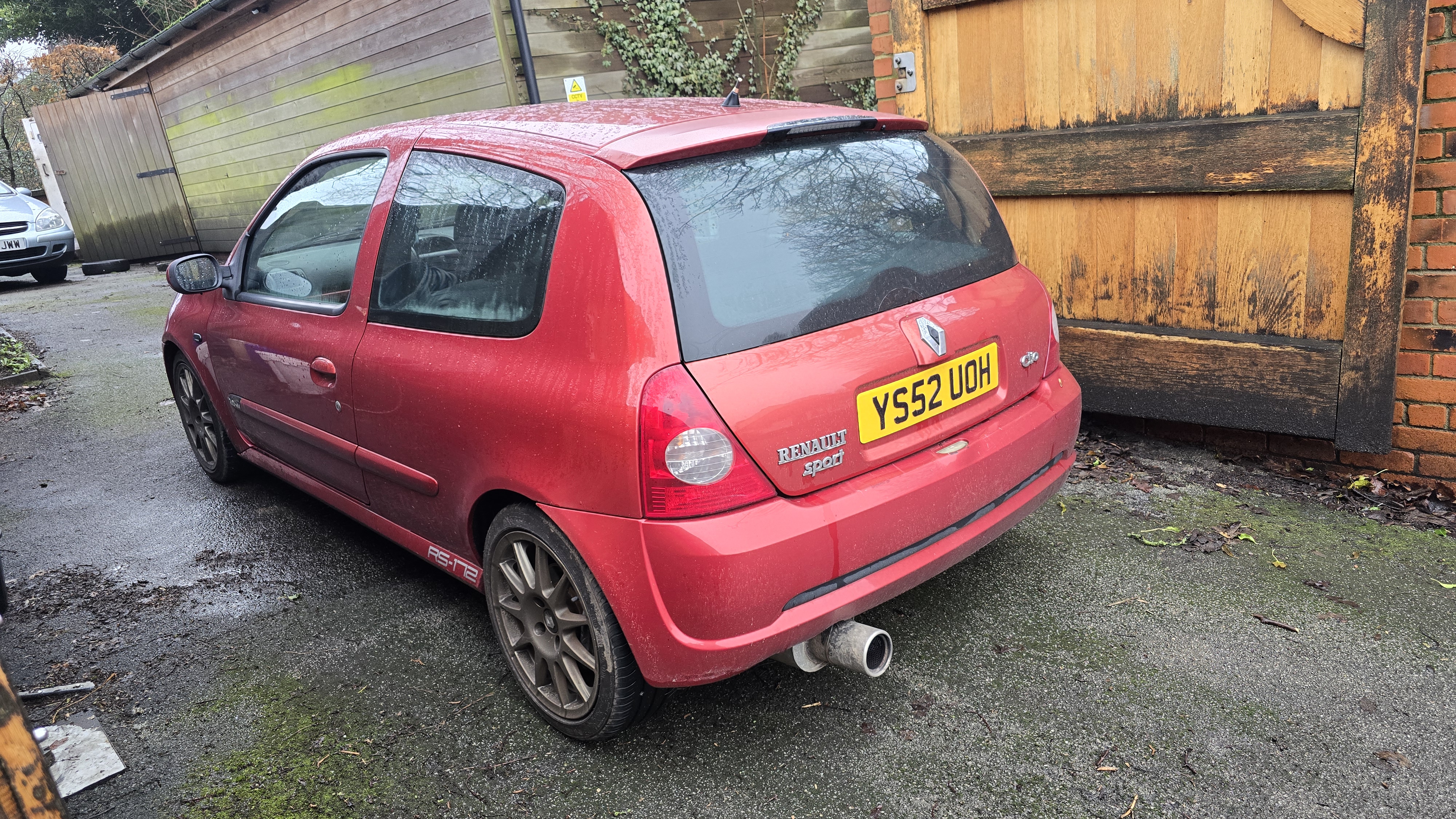

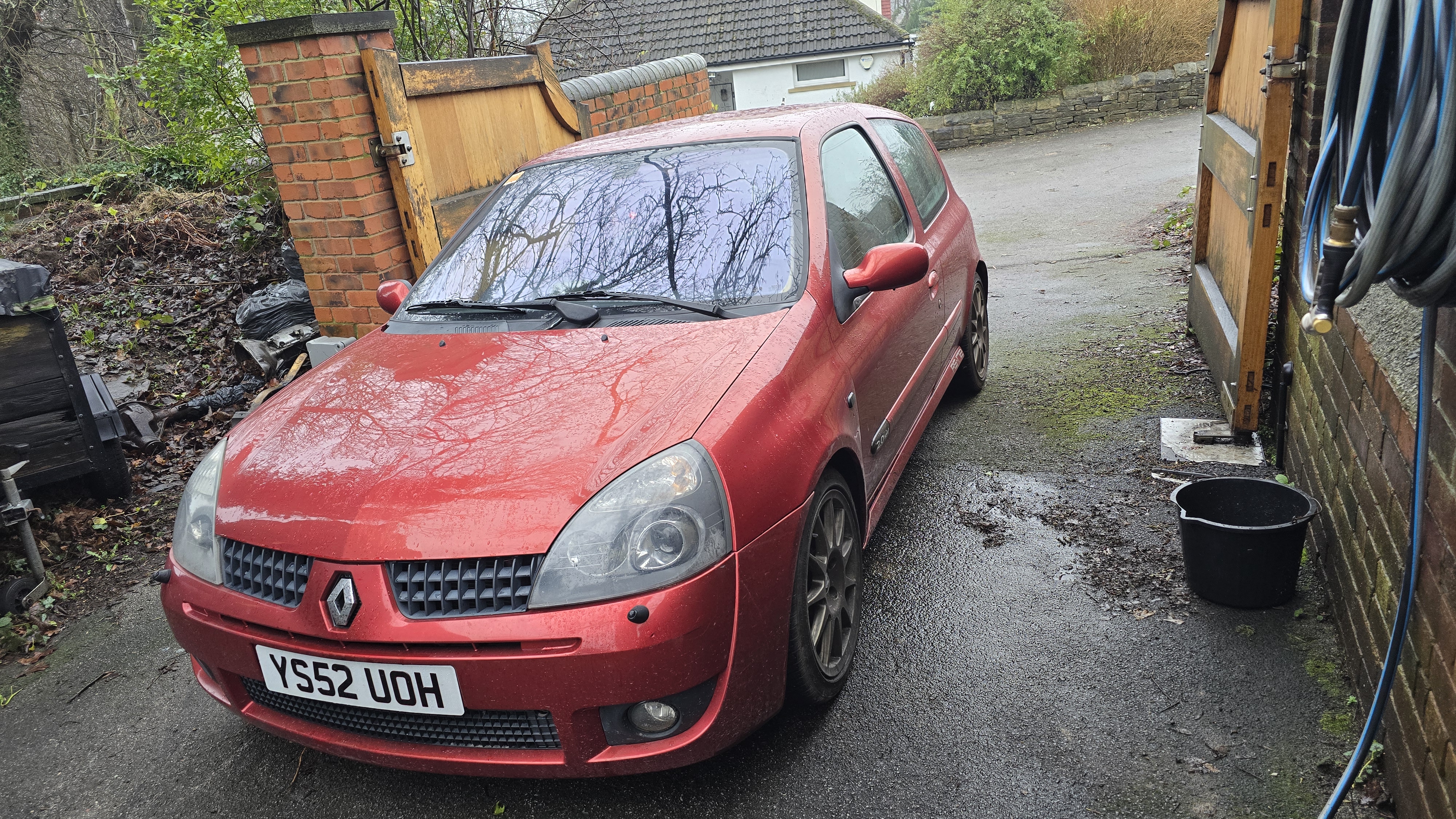

Hey everyone and welcome to the ramblings/progress of my 02 flame red clio 172! first time owning a fast clio myself I've had multiple friends own them but never myself. ownership got off to a roaring start where not even 24 hours into it a very strange failure happened, loud bang and loss of drive yet we still had engine braking, so i had it for 1 day then it was trucked off to beaniesport because it also needed belts, and a host of other things before i wanted to use it road side.
but on re emerging we have this! its got some history for sure, i was told by the previous owner that it had been engine swapped, this i believe is correct because of how many things are just wrong mechanically, the car itself lovely condition, the quality of the work thats been done to the mechanicals. questionable.
but the price was good and i can do mechanical things, i just dont like doing bodywork constantly having had a long spell of rusty volvos buying a not rusty clio as a weekend toy seemed a good plan.

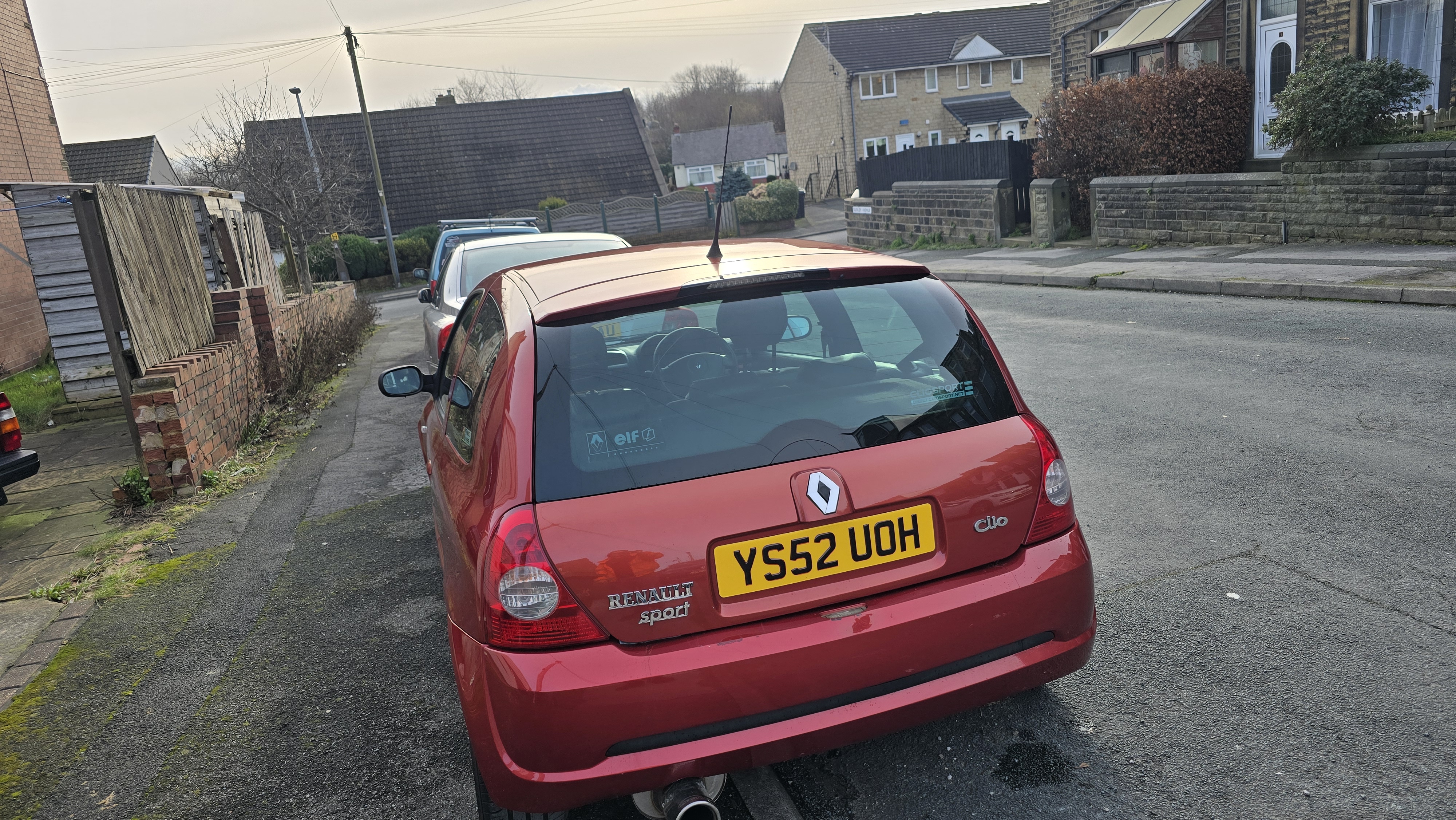

How it arrived back from bedford, rather dirty and the exhaust fell off on the way home because the hanger is made of cable ties.
no seriously, but its fine because its got a safety cable, so its clearly not its first time falling off either, quality
front end is usual age related issues, headlights a bit fuzzy, grilles a bit faded, plates are stupid gell
glitter things that will be going in the bin asap, you know, normal yobbo car things.

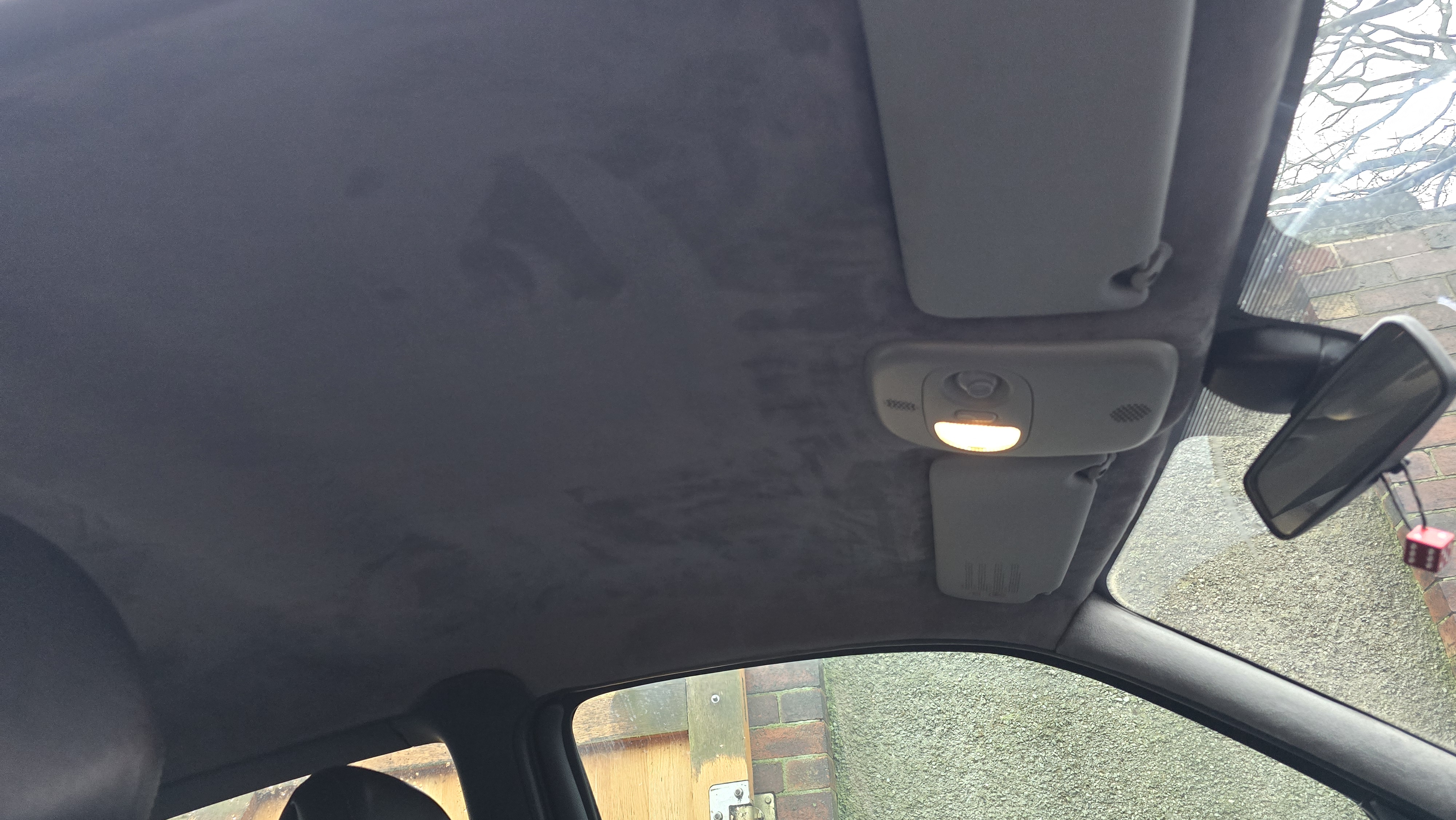

Another touch to show that once this really was a well looked after clio, full alcantara headlining conversion, and with how the A pillar trims have faded
this must have been done a while ago, its a very neat job and none of it is peeling at all, its just had the sun bleach it but i may re-do the A pillars and then
it matches.

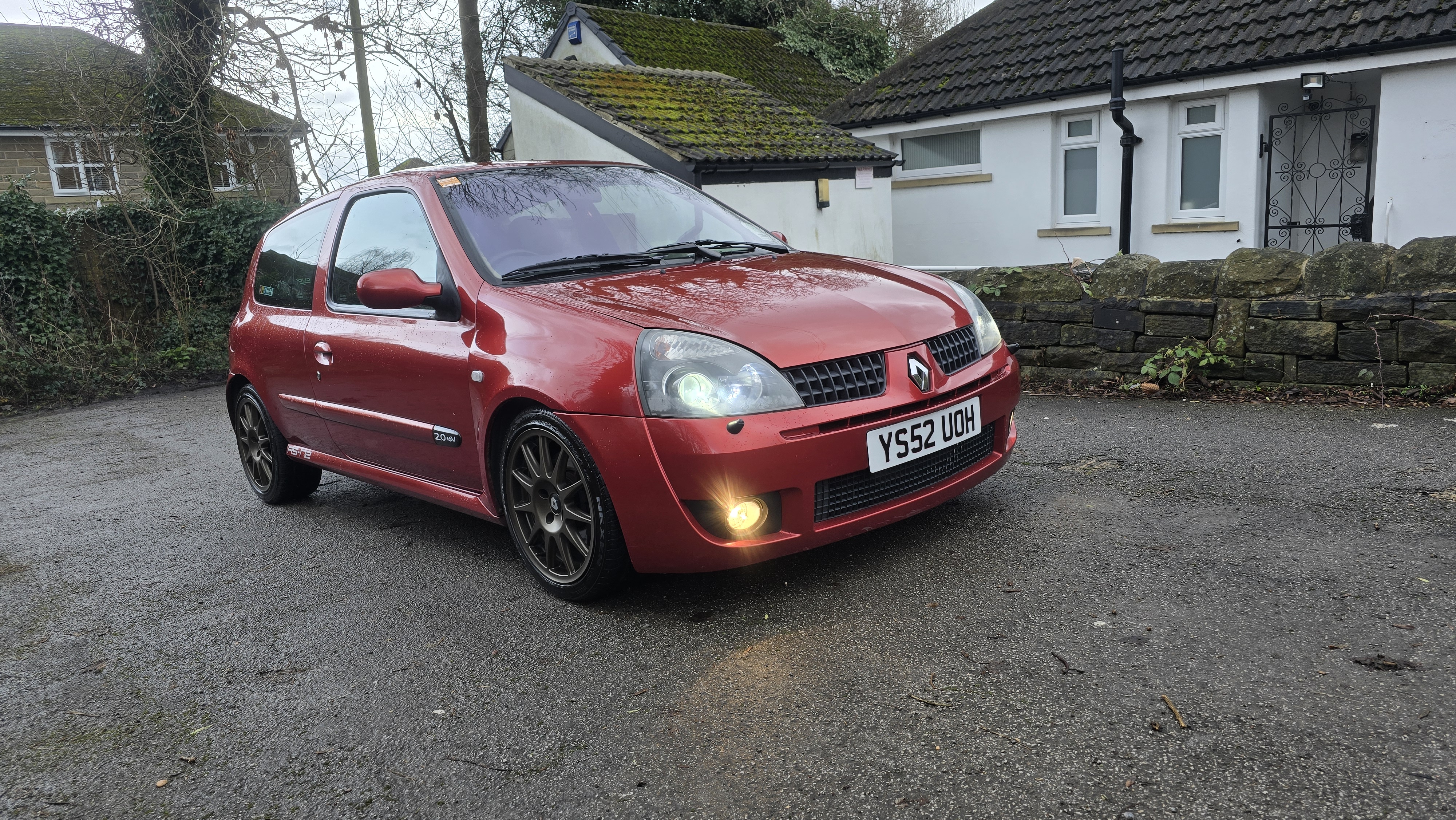

this is where it goes slightly downhill, from what i can gather, a 182 block swap with 172 head and its original box, but its a lot of missing shields, damaged wiring, stripped self tapper holes (power steering hose for example) the pvc anti spark device by the ecu that is free floating because the brackets busted, the cone filter that's too big so it is actively eating through the battery and the numerous oil leaks, but hey, it runs and drove back from Bedford so, great success.
Overall paintwork on the car is alright, the bumpers are scuffed to hell, but that's fixable, the only bad part is the spoiler and the 2 channel cover trims either side.
also dont worry the gold and fake carbon stubby will be going straight on the bin asap.
And the first big parts run in the clio to give you a vague idea of the future also you can just about see, the car comes with a BAF K brace thingy, a nice touch i suppose, if it wasnt covered in rust from i assume being stored in the ocean.

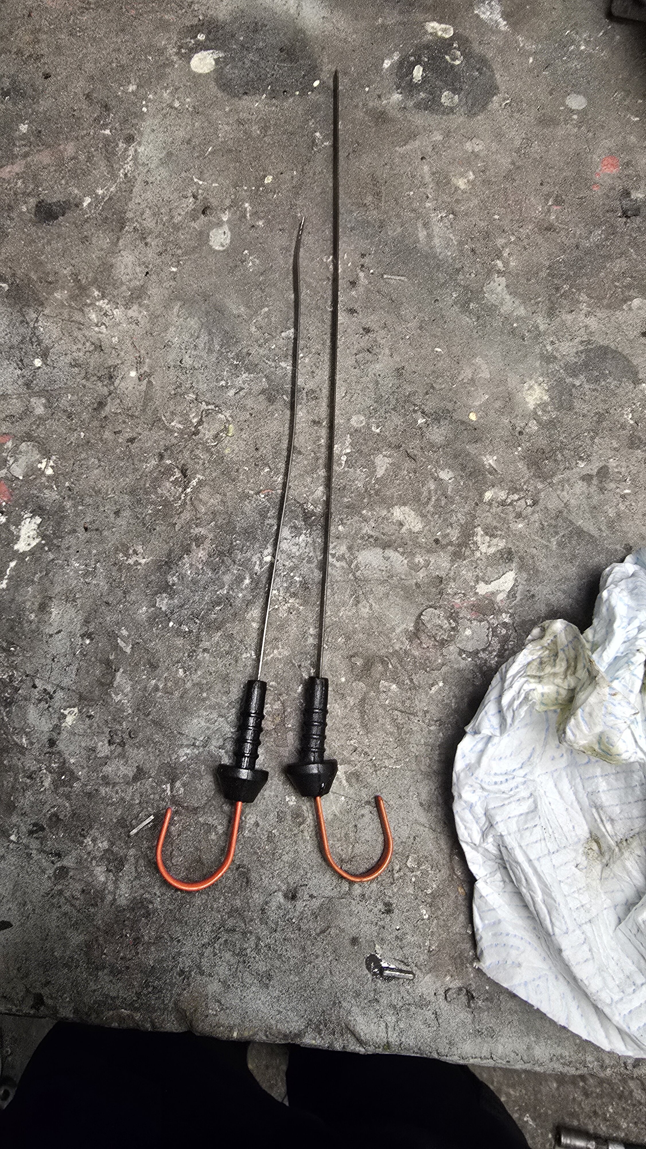

the dipstick tube being broken meant he had shorted the dipstick, but not enough, you could feel it hitting the sump bottom and not once, not twice but 3 times this blew the dipstick out while driving and showered everything in oil, i ended up fixing this by cutting it shorter and then i had to make a seal as the dipstick is smaller than the block bore, so its 2 rubber through hole grommets carefully shaved down to make a tight seal.

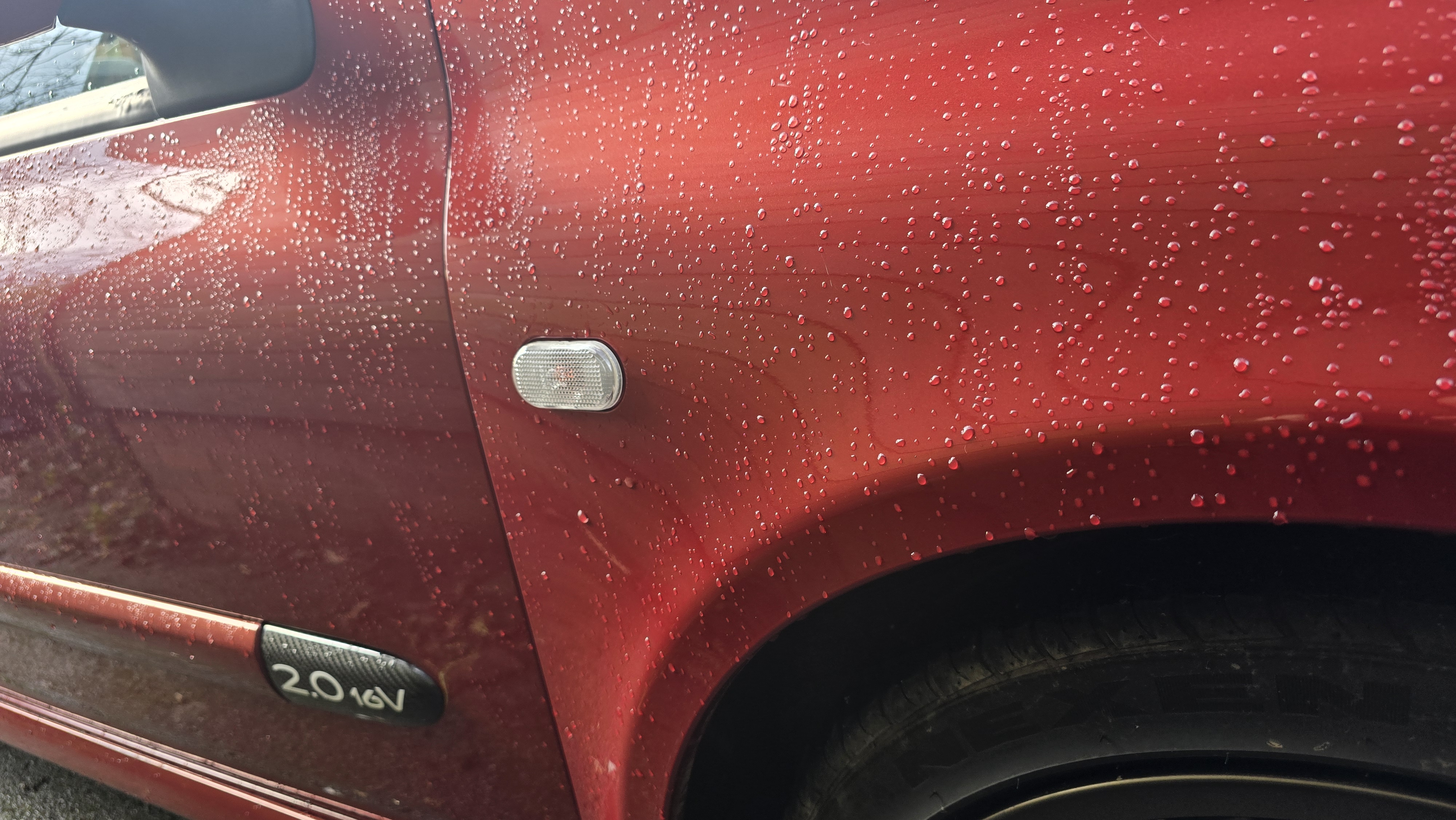

after that it was mainly its first proper bath, some stickering up, some original bullets, side repeaters and correct antenna to get rid of the boy racer tat and the covers being finally re-instated.

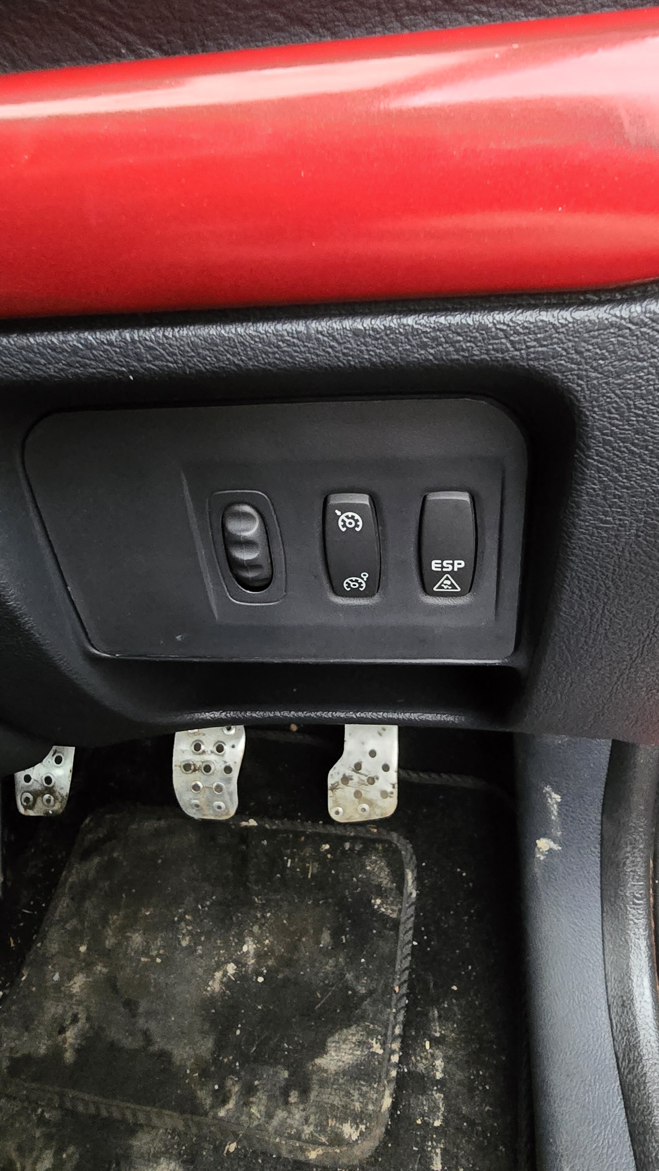

new panel fitted, thankfully it recognising cruise control means it will eventually get it i just need to find the squib now.

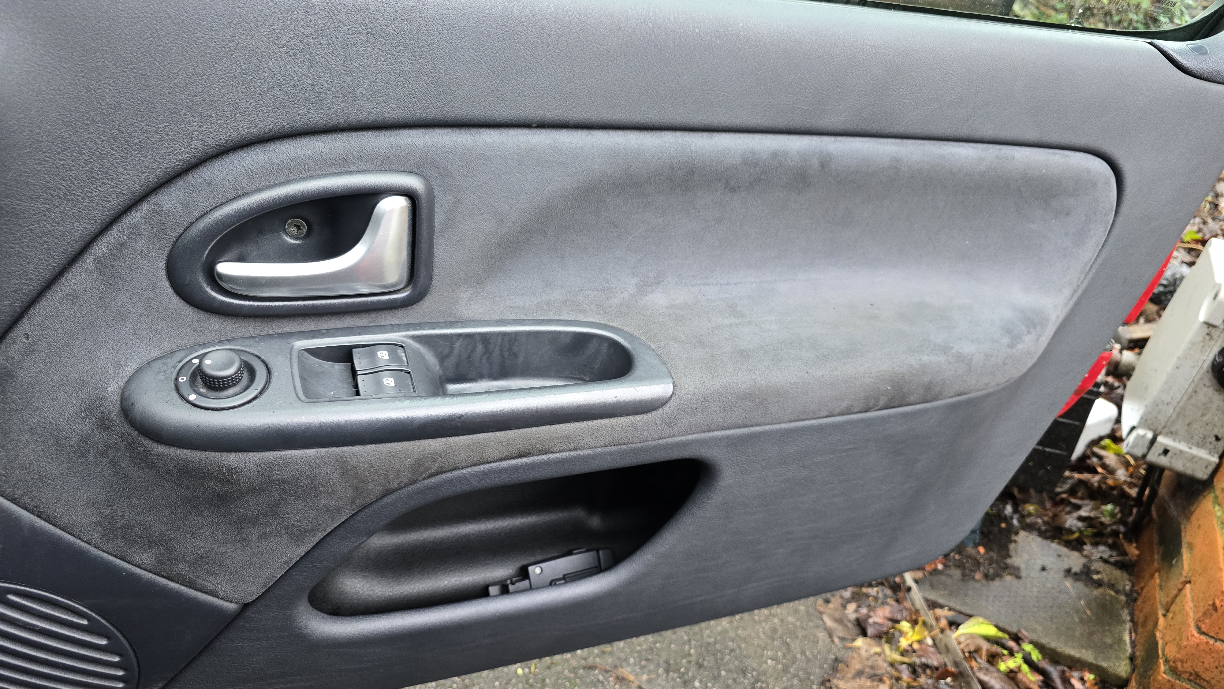

door cards held up pretty good vs a lot i see with horrid arm rest damage
this is when i discovered that yep, that dipstick wont work

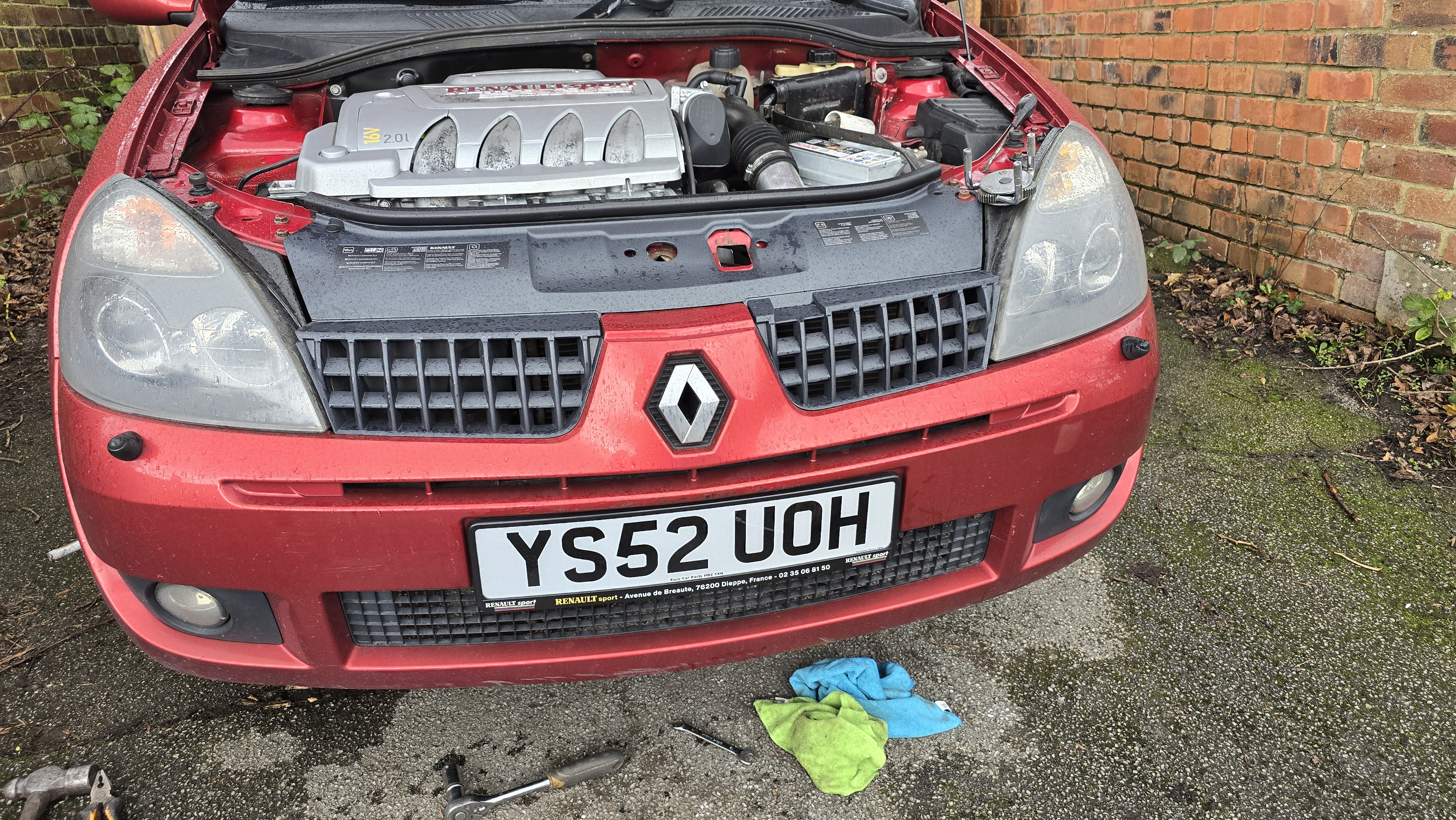

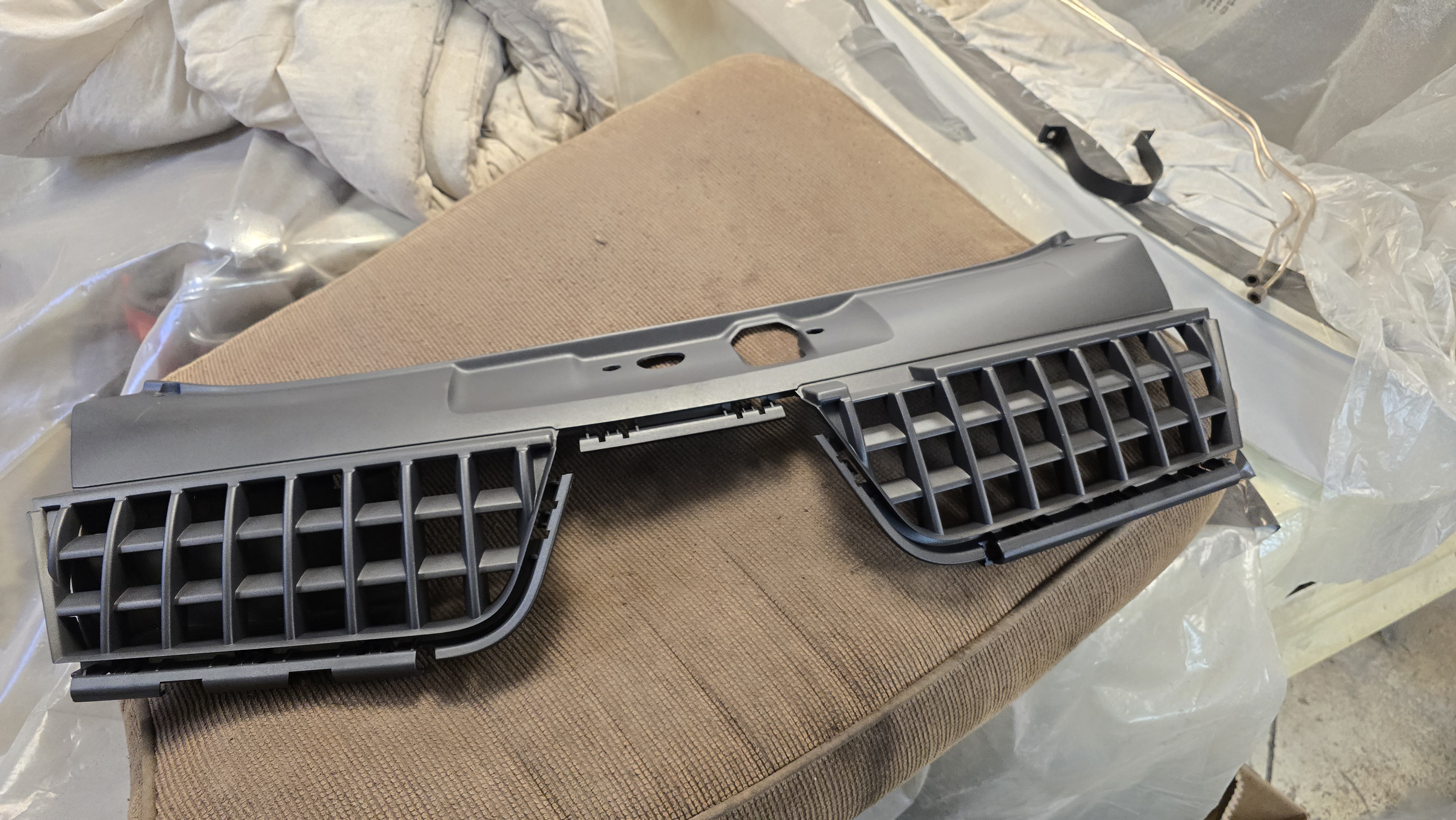

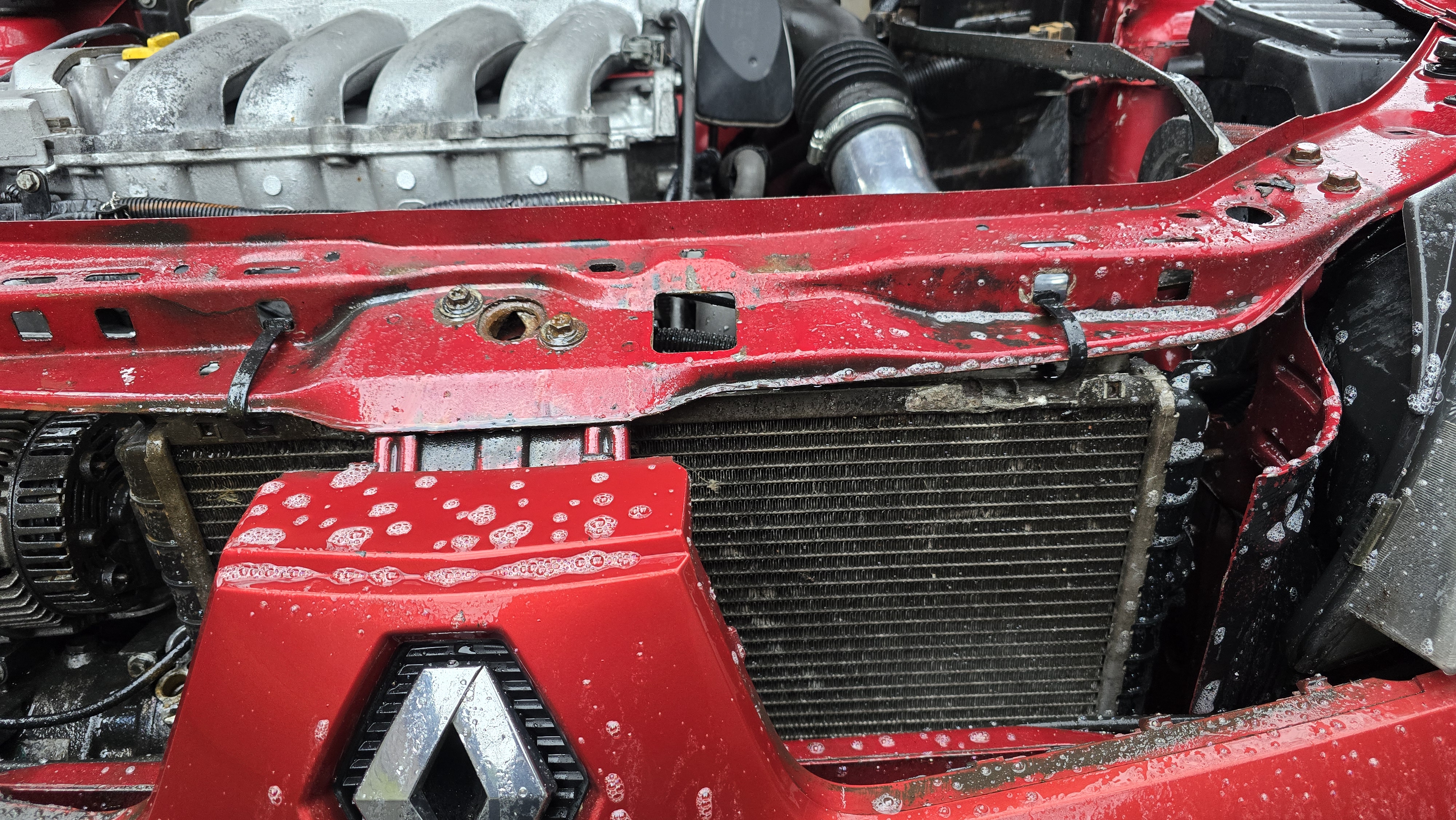

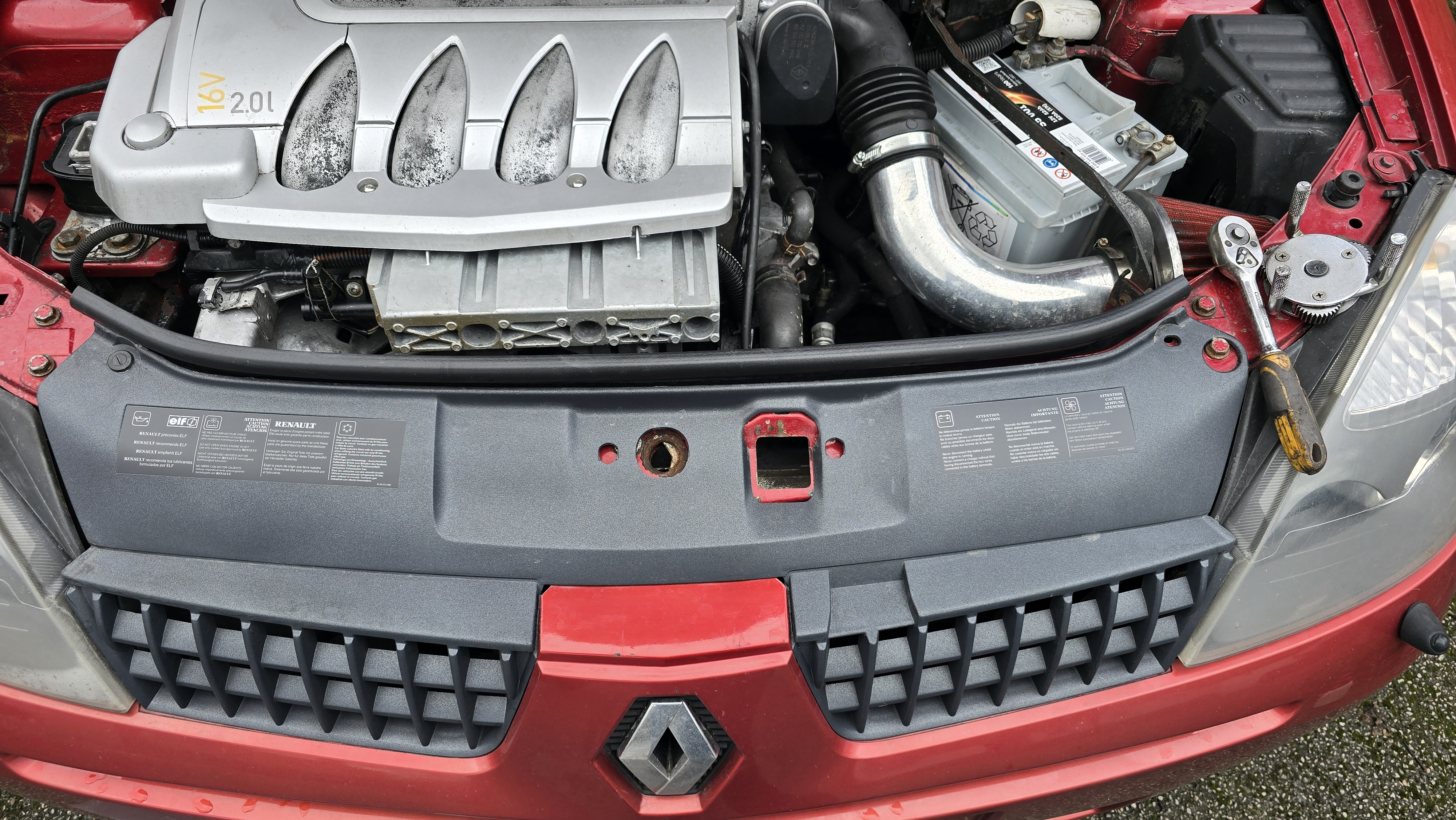

while swapping the grille is when i discovered this lovely bodge, cleaning off all the gunk but it needs a new rad as its pretty beaten, can also see the previous owners "ac delete" aka Ive removed the lines, and the condenser and that's it, good job, that'll be getting re-instated and a new pump
brand new grille and swapped over the old alternator shield as there was nothing wrong with it
new grille all fitted up, i do have the repro stickers for it i just need to stick them back on, during this job aswell i discovered the bonnet latch was not tight, at all, glad it was still working! so we had a few times of adjustment with the grille out of the car before it operates happy. just everything to do with the mechanicals/engine swap area of this car has been ruined.

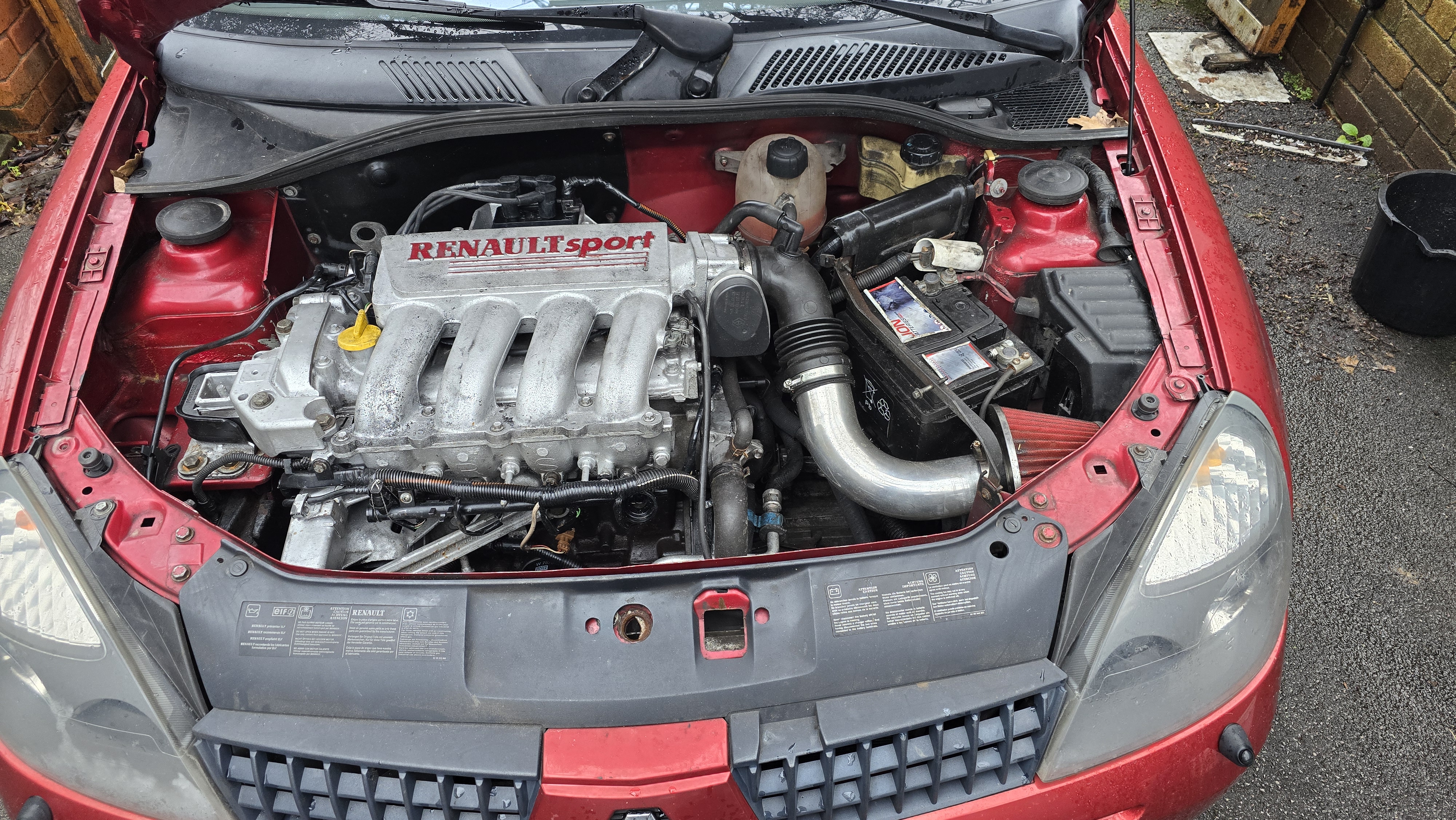

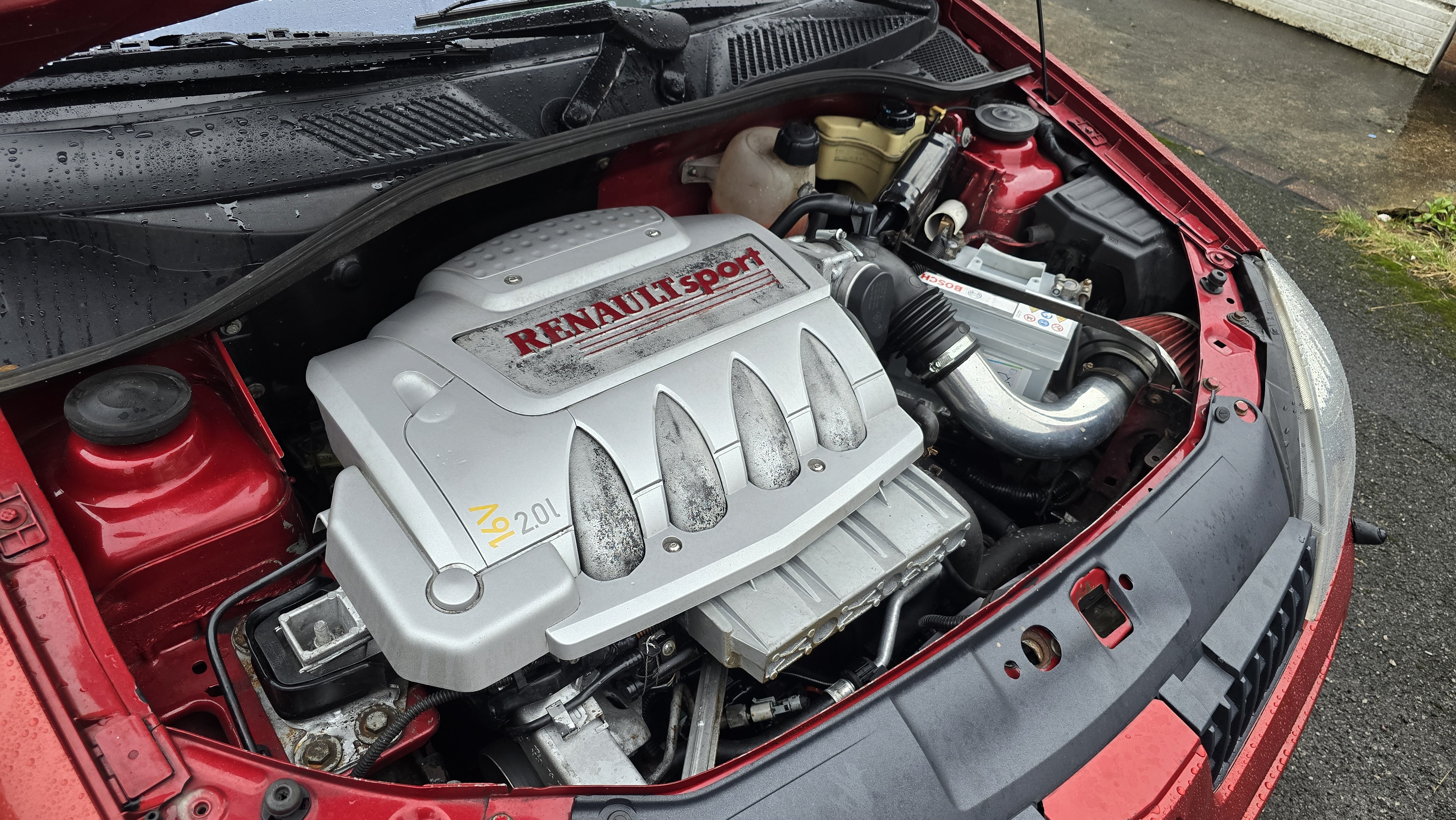

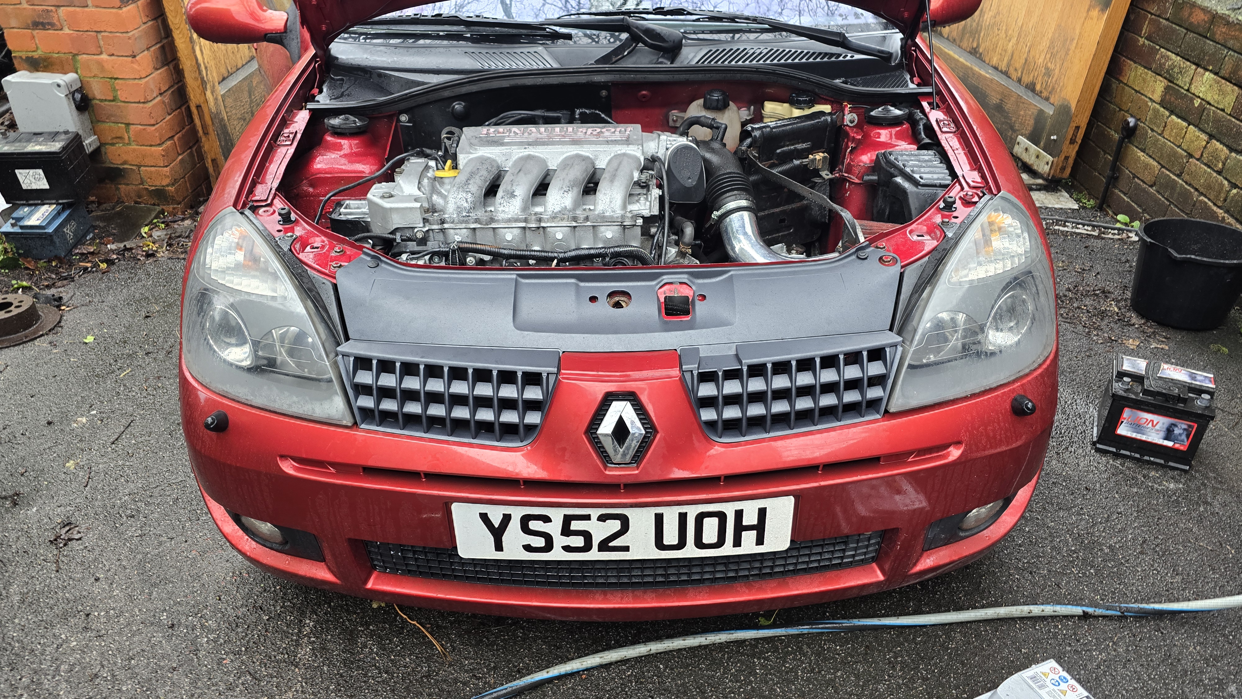

engine bay after initial cleaning and re-fitted the injector shield

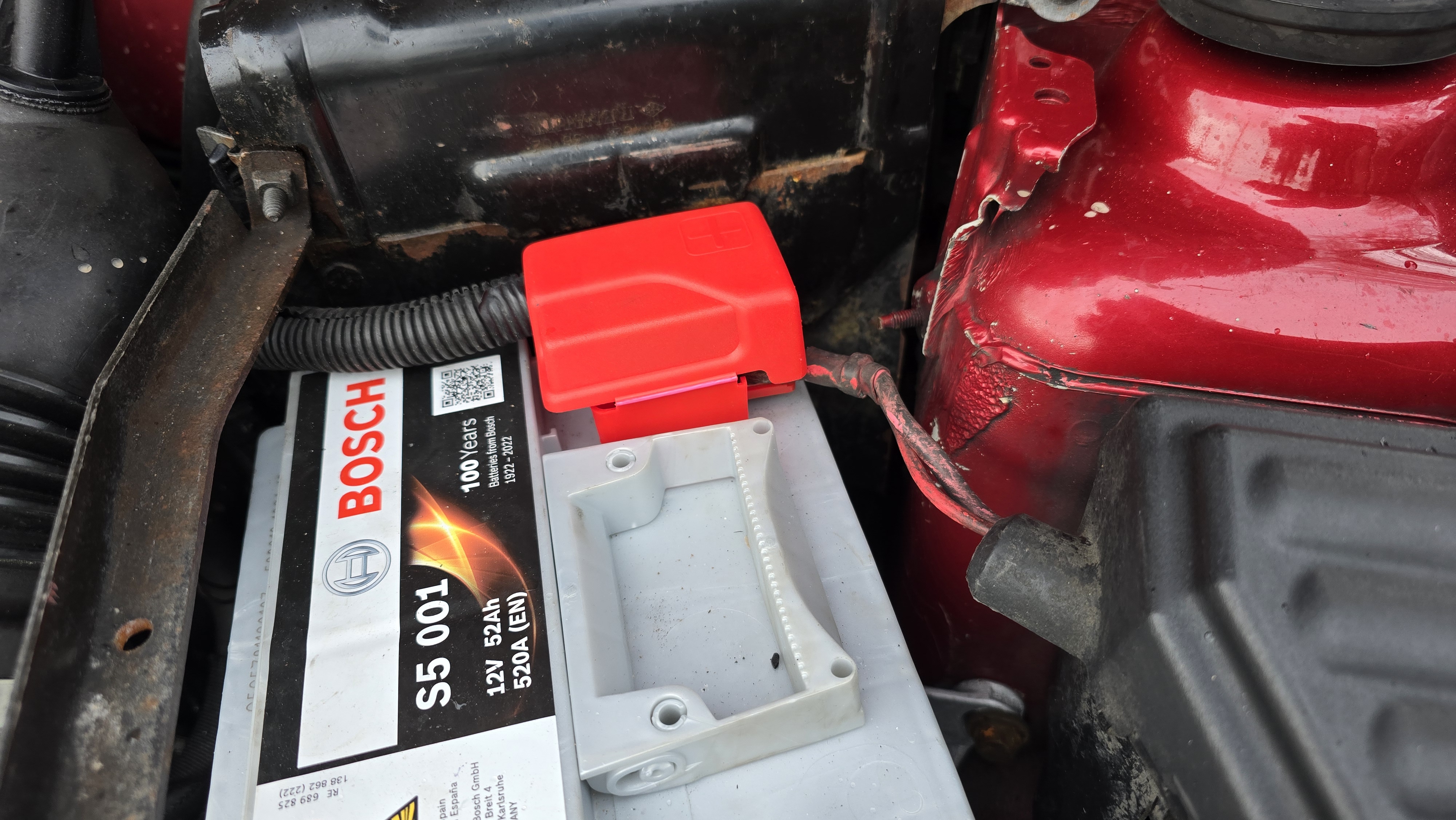

New battery + hold down clamp for it as that was also missing, im waiting on the original style battery terminal/cover to arrive but that order got put in late so wasnt here in time. though this horrible intake system will be going soon, i also want to re-do that earth cable a bit better as its quite home bodge job

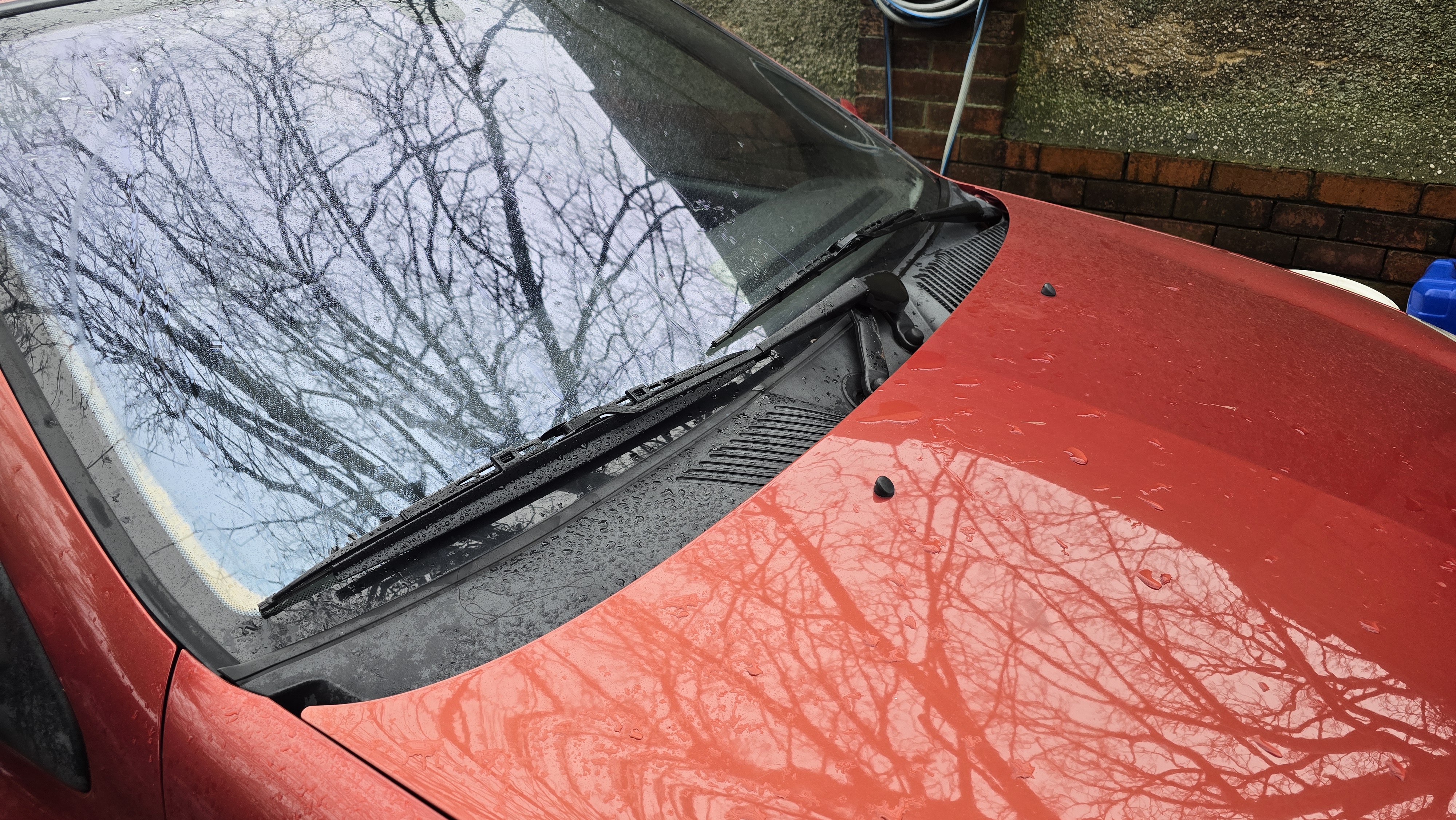

went for 22" wiper blades to remove the small triangle that the sweep never got, also the old wipers were absolutely fubar

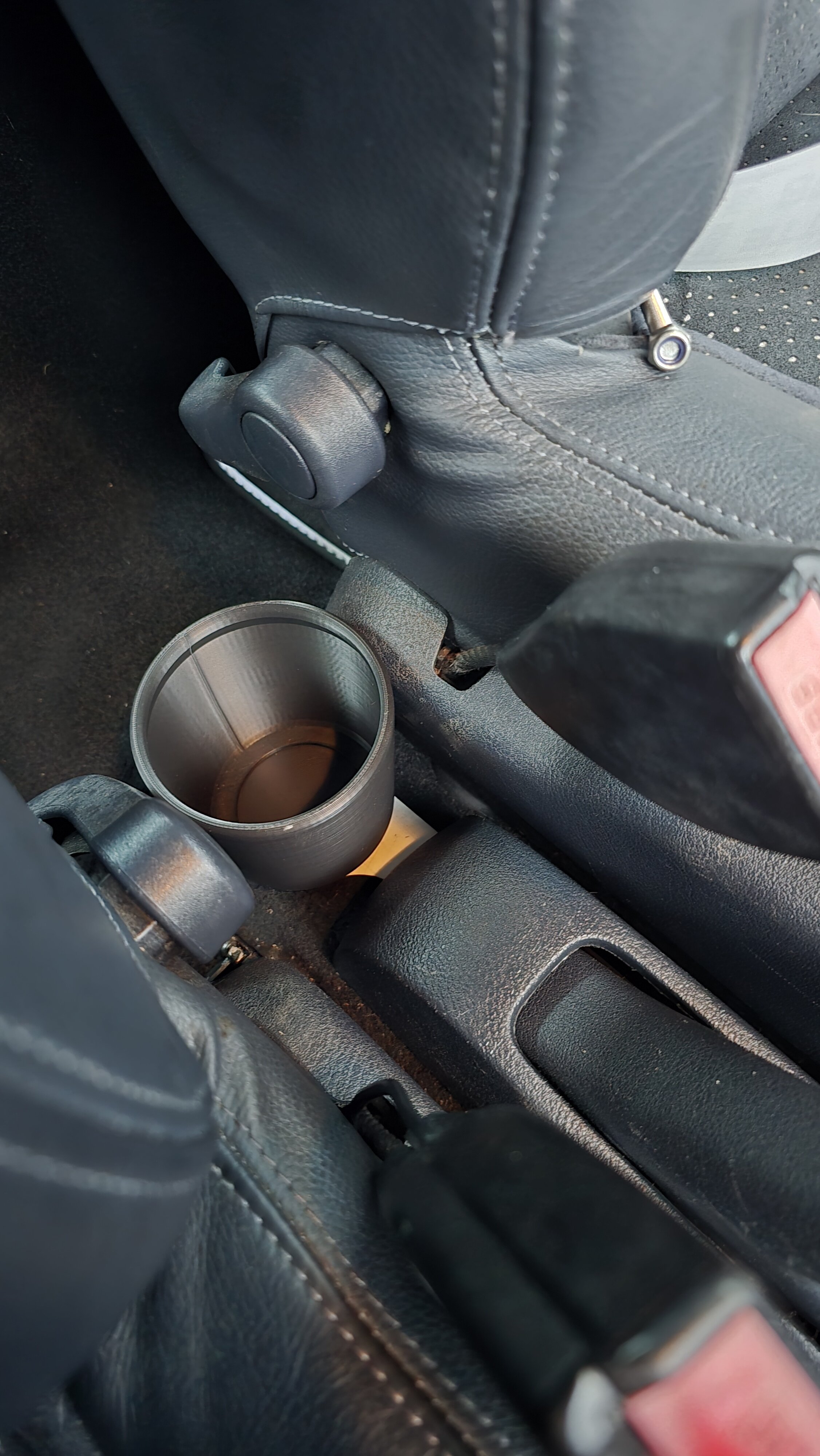

Fitted a nice 3d printed cupholder i got off ebay because those original holders are absolutely useless for me with my huge thermo mug!

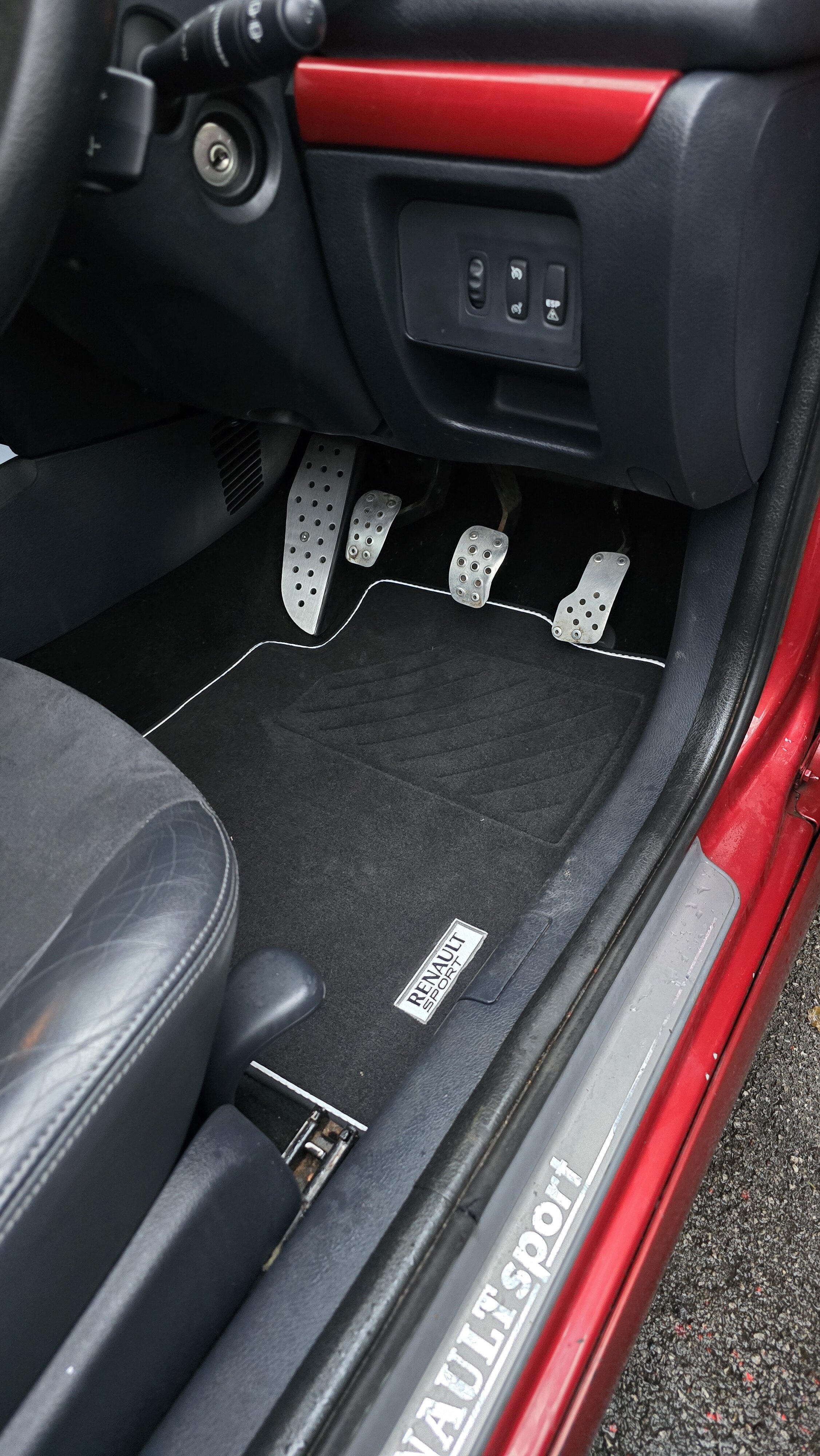

Genuine renaultsport mats in and added a steel footrest so now all the pedal area matches nicely

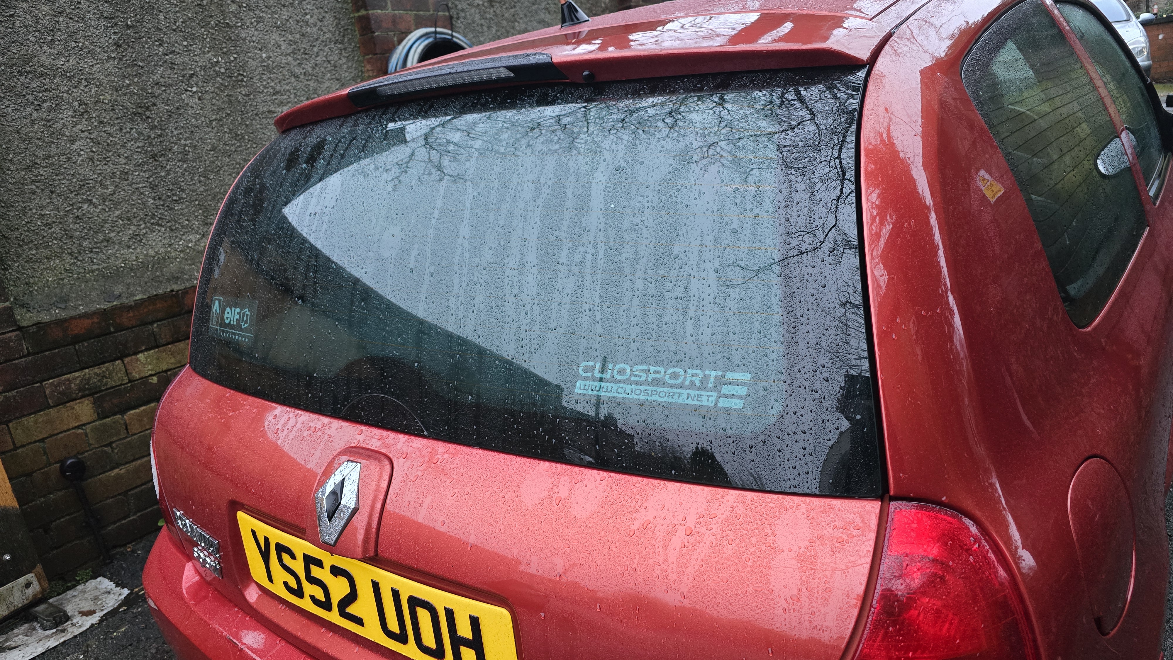

got the cliosport and elf stickers back in the rear window

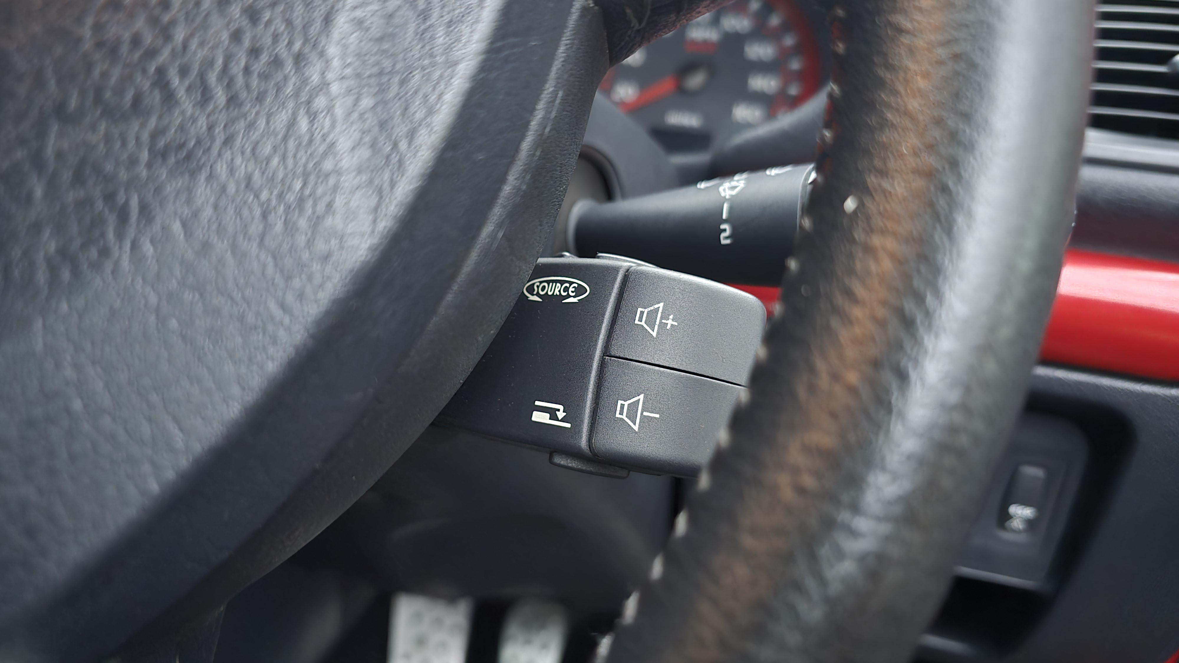

original radio controls re-fitted, I'm waiting on a connect 4 box to make these work again but its better than the connector hanging out randomly

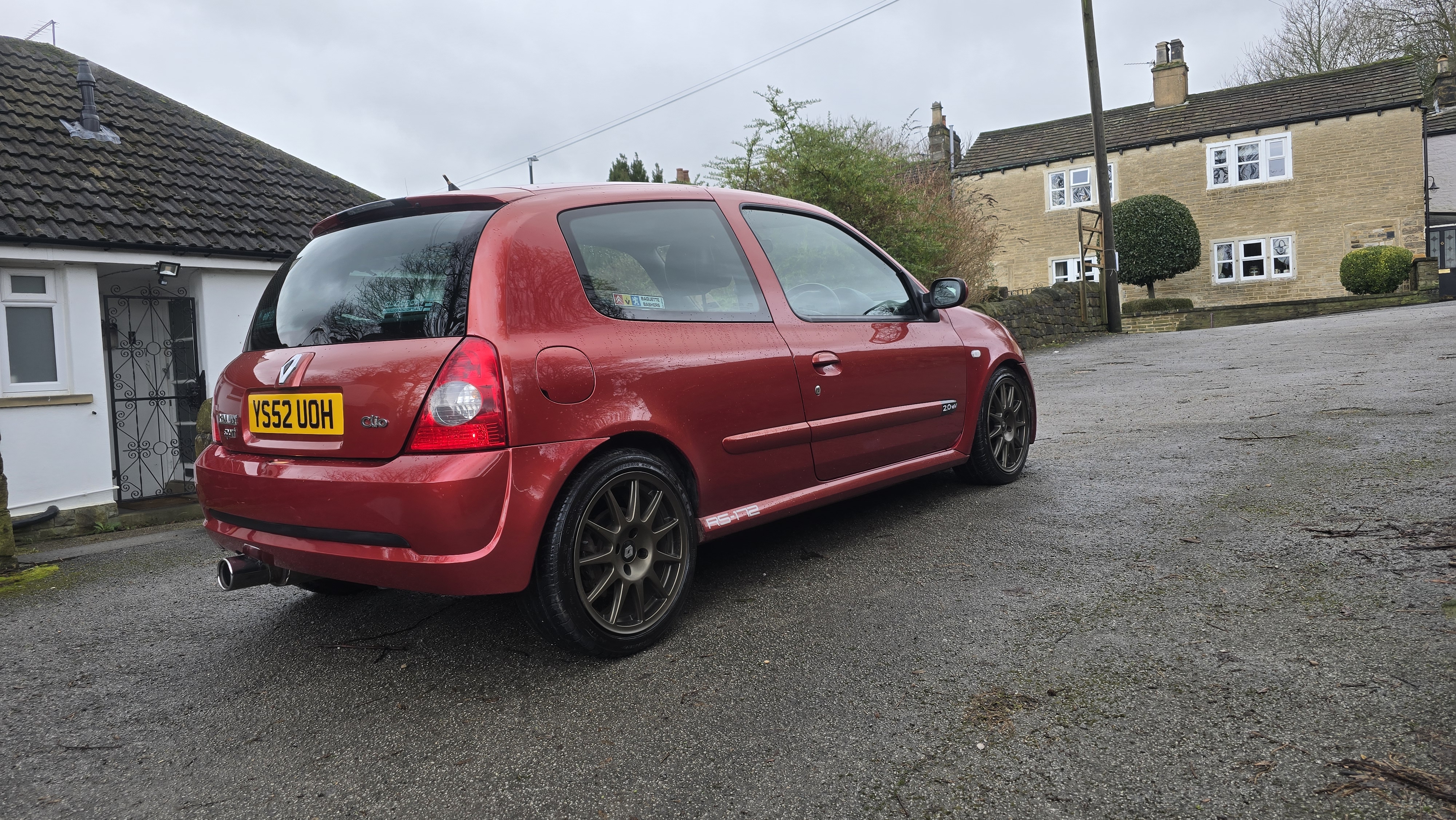

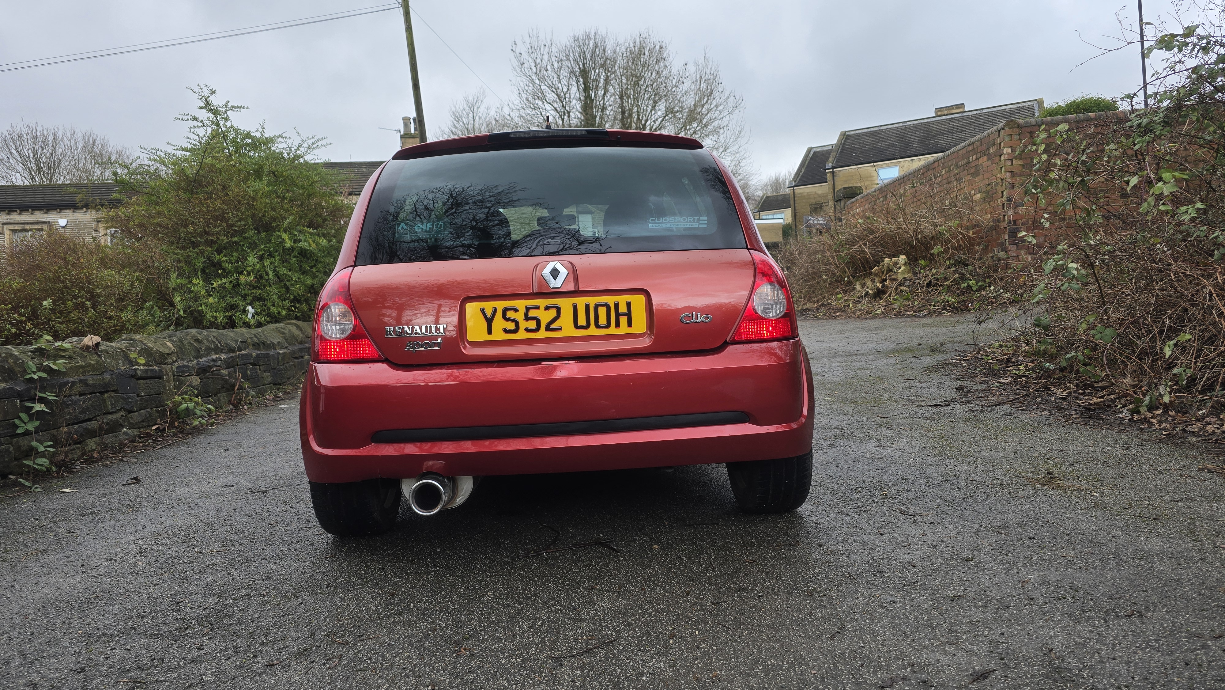

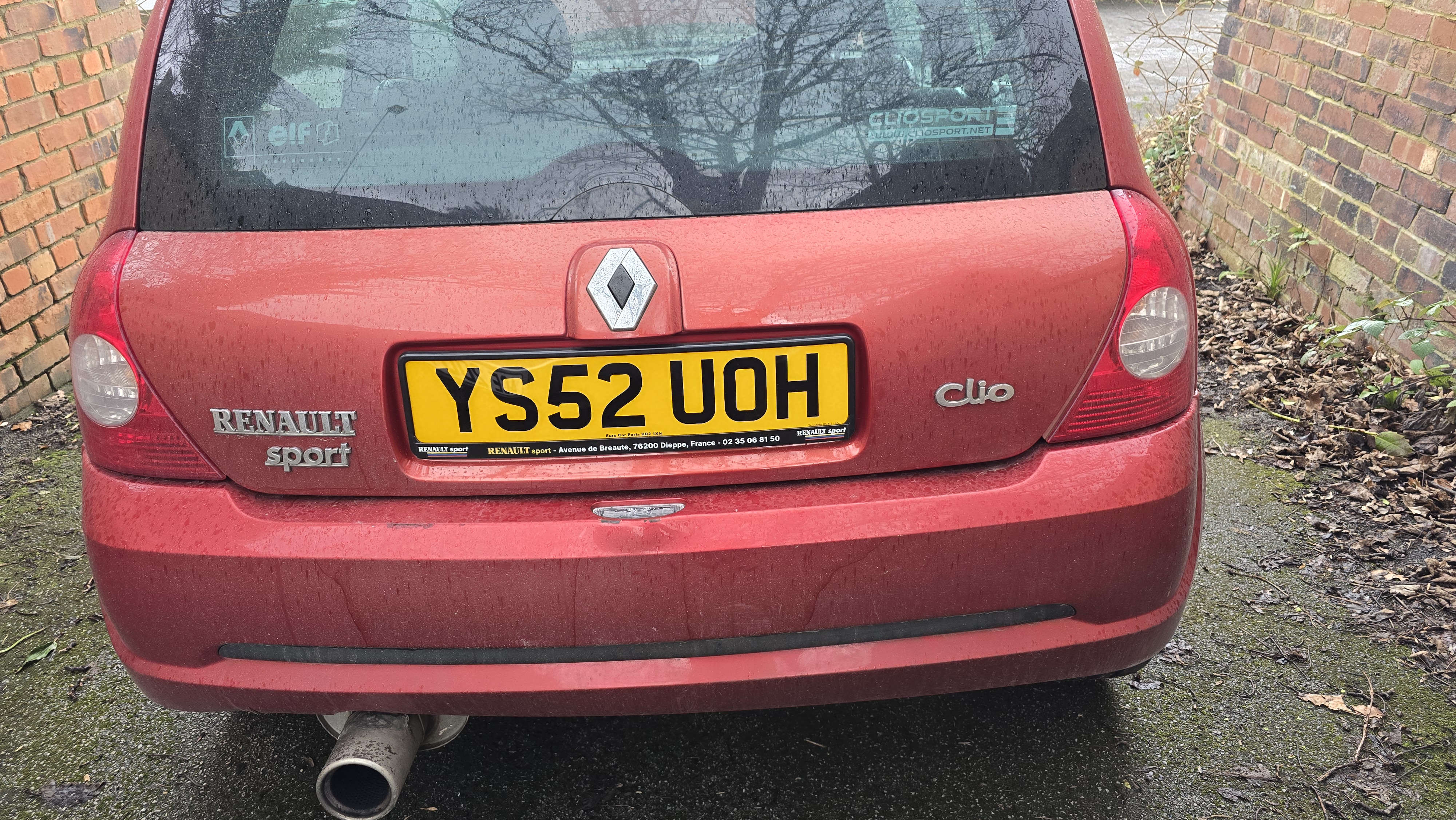

made the exhaust fit a bit better, its quite the lash up, the original mount has gone soft naturally so that needs replacing, but there's nothing to hold it into the mount, he then tried to weld a nut to the stainless (unsuccessfully) then there was some random L shaped thing, 9 cable ties (not even kidding) a hole drilled through the boot with a hook hanging through to try give the other side some support (deleted all that) and a safety wire round the end with more cable ties because naturally, it falls off a lot, the safety cable for now stays but a Ktec or PMS is in the future

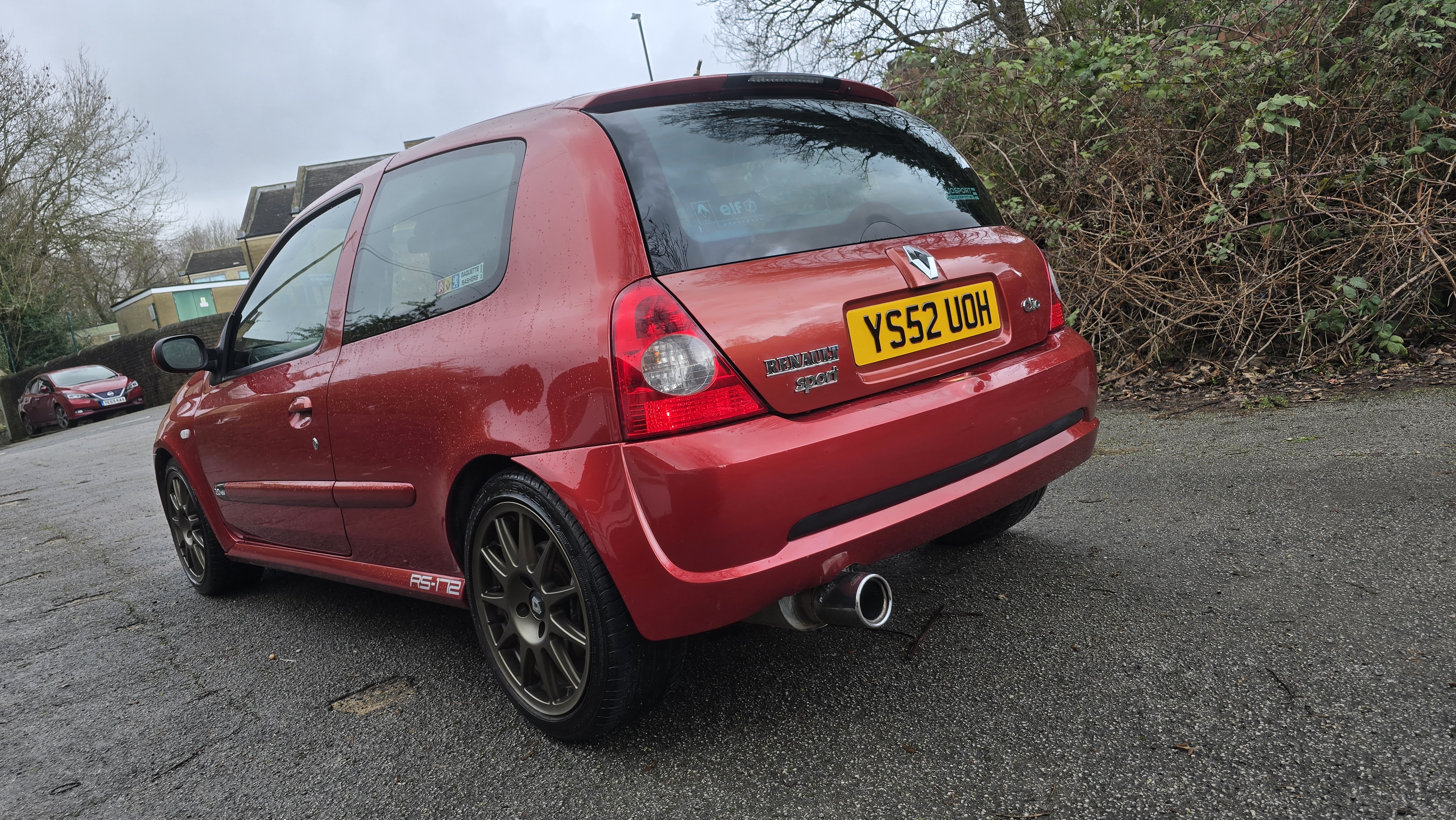

Continuing photos, this is after its first proper wash, there's a lot of paint correction still to do but I'm waiting for summer to arrive for that, mainly on the front bumper area is quite bad, also after a rear wiper has been re-added, the exhaust fitted and the horrid gel plates removed it should look good from the back

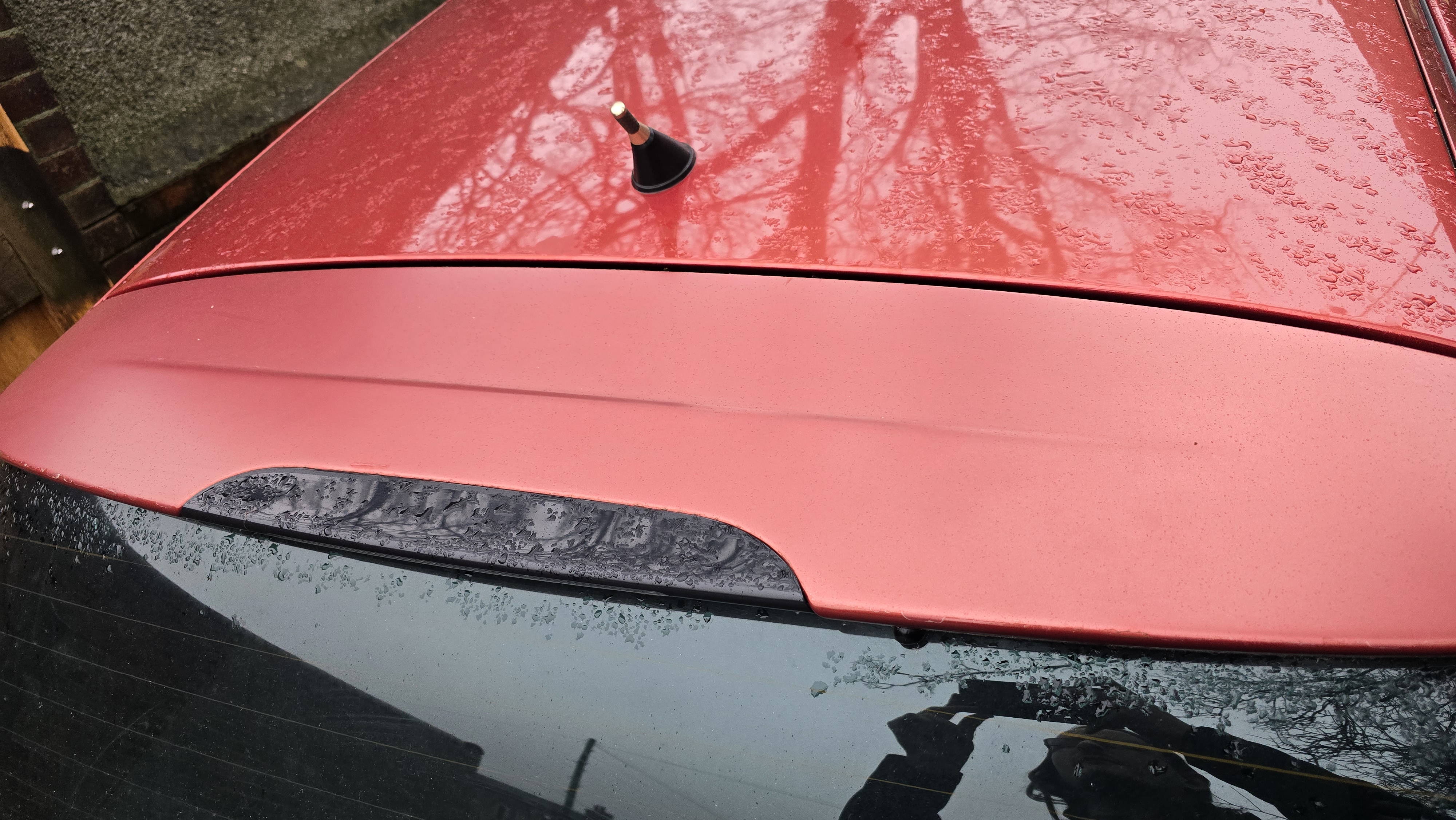

original Renault antenna re-fitted
and finally the engine cover can go back on after I ordered the correct bolts because the ones I ordered wouldnt fit down the small recess

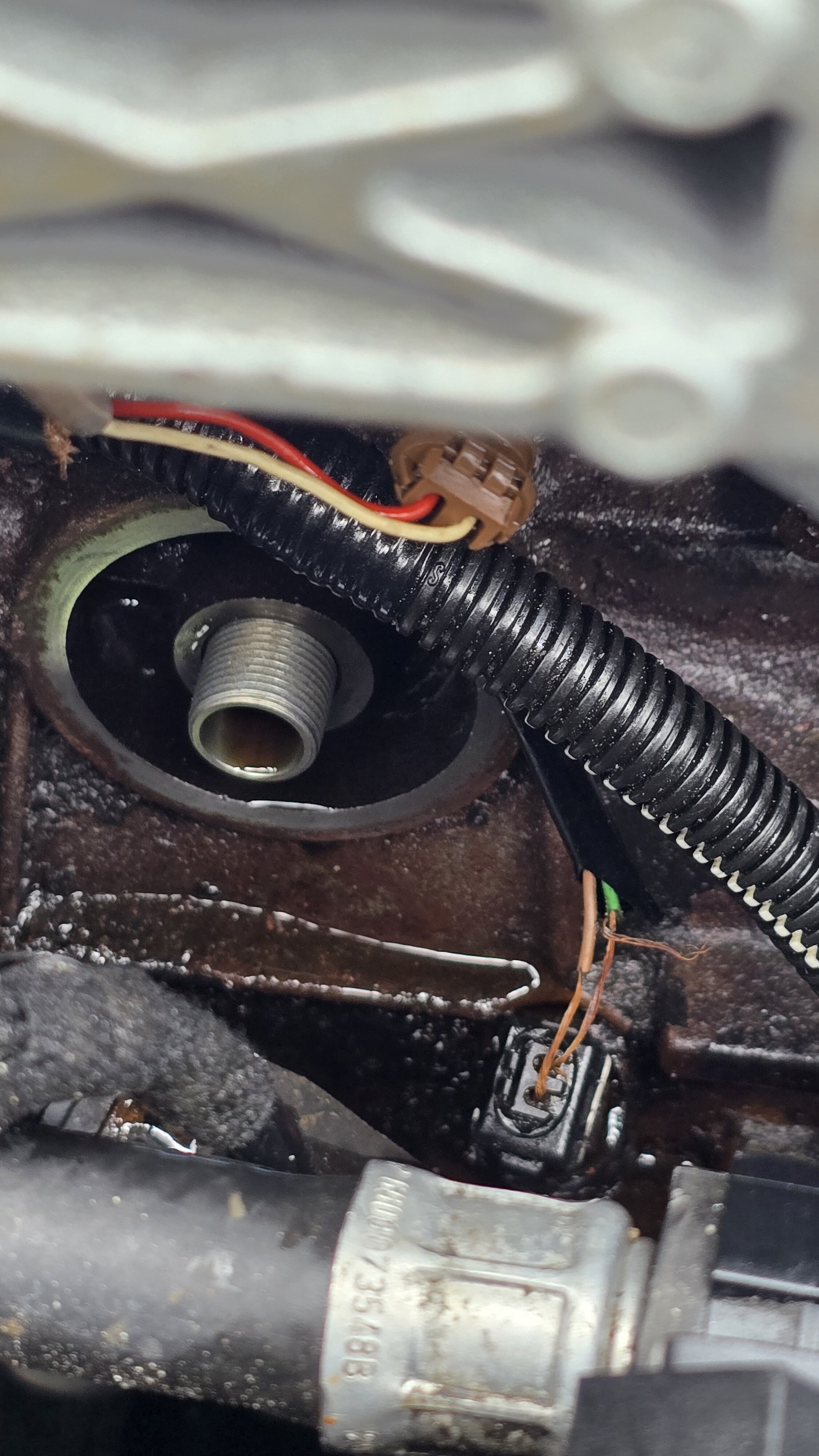

Anyway, did a oil and filter change after quite the faf to get the car jacked up as the sill jacking point has been mangled, and the strengthening cross between sill and chassis leg has 1 been stoved in, and two is very rusty, jack went up, car stayed still, decided this was not the method and its now another thing to add to the list of summer jobs, so created some run up ramps out of wood that worked ok enough.

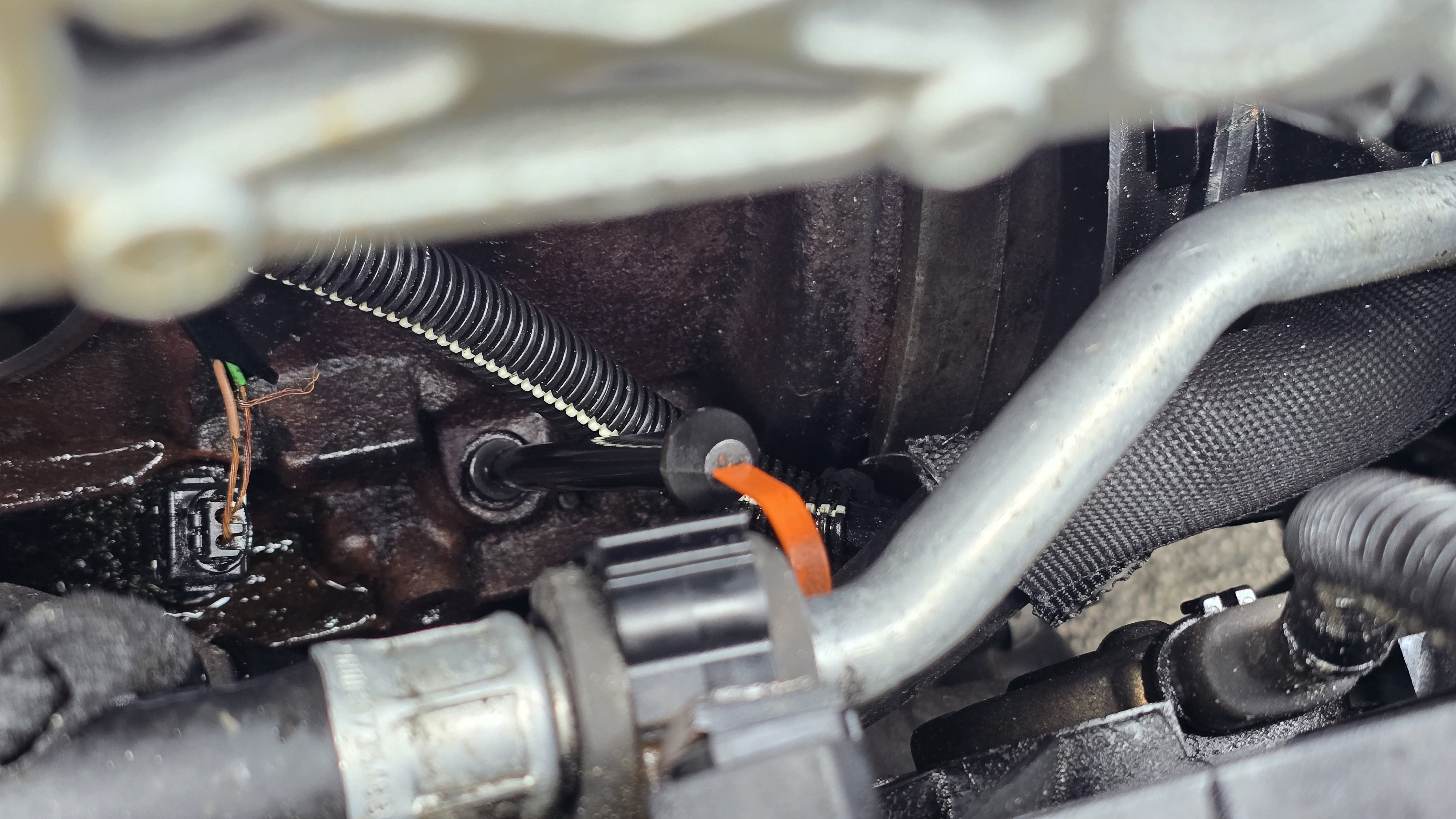

found out the prior owner has absolutely mangled the oil level sensor wires in doing a filter change sometime but it somehow still functions, so once again into the list of jobs to re-do properly it goes, there was a slightly scary amount of brass that came out but this oil was VERY thin and petrol smelling, threw a Renault filter on and after seeing the brass, decided instead to use some full synth shell 5w40 I had laying around and keep the millers for later, the new oil made a notable change to engine sound and that's never a great start, going to do a few changes and monitor.
managed to fit a new dipstick I sourced from a helpful member by freezing it and when the engine was hot driving it in so now we have a proper dipstick again so that's nice, replaced the cabin air filter that was installed backwards, dated 07, and looked like it had been in a boxing match but unless someone's had it out and then not replaced it, potentially that's a dealer? Although with the way of fitting being, smush it in i can see how it happens.

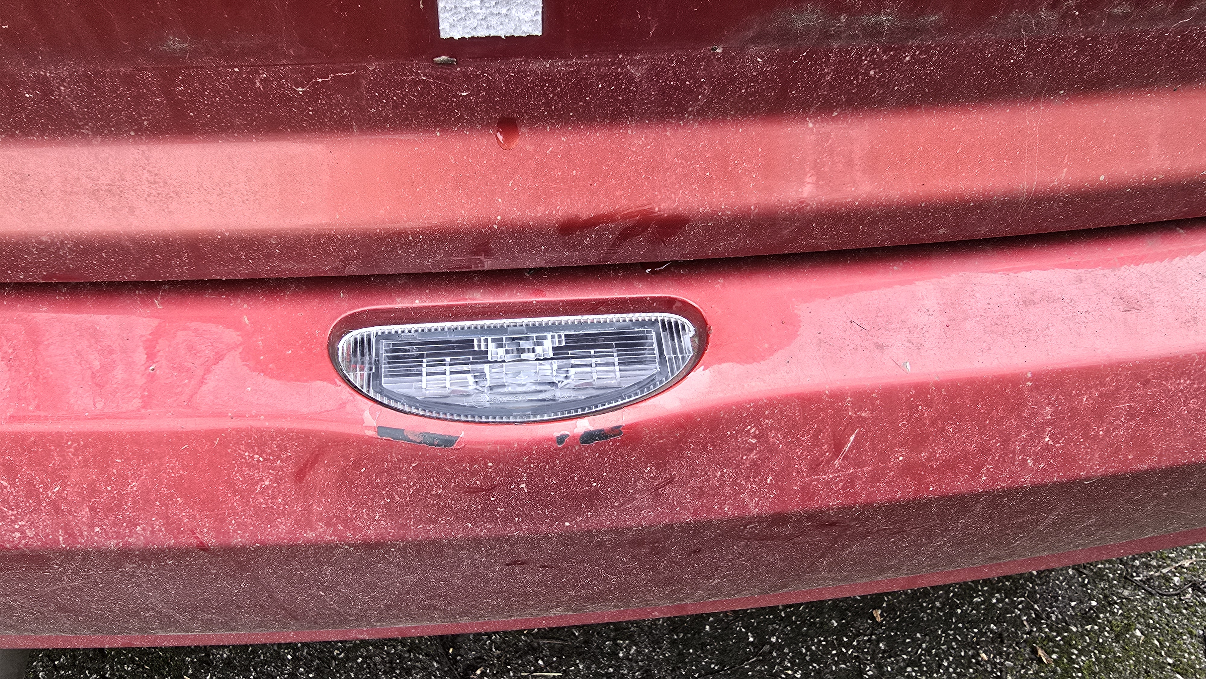

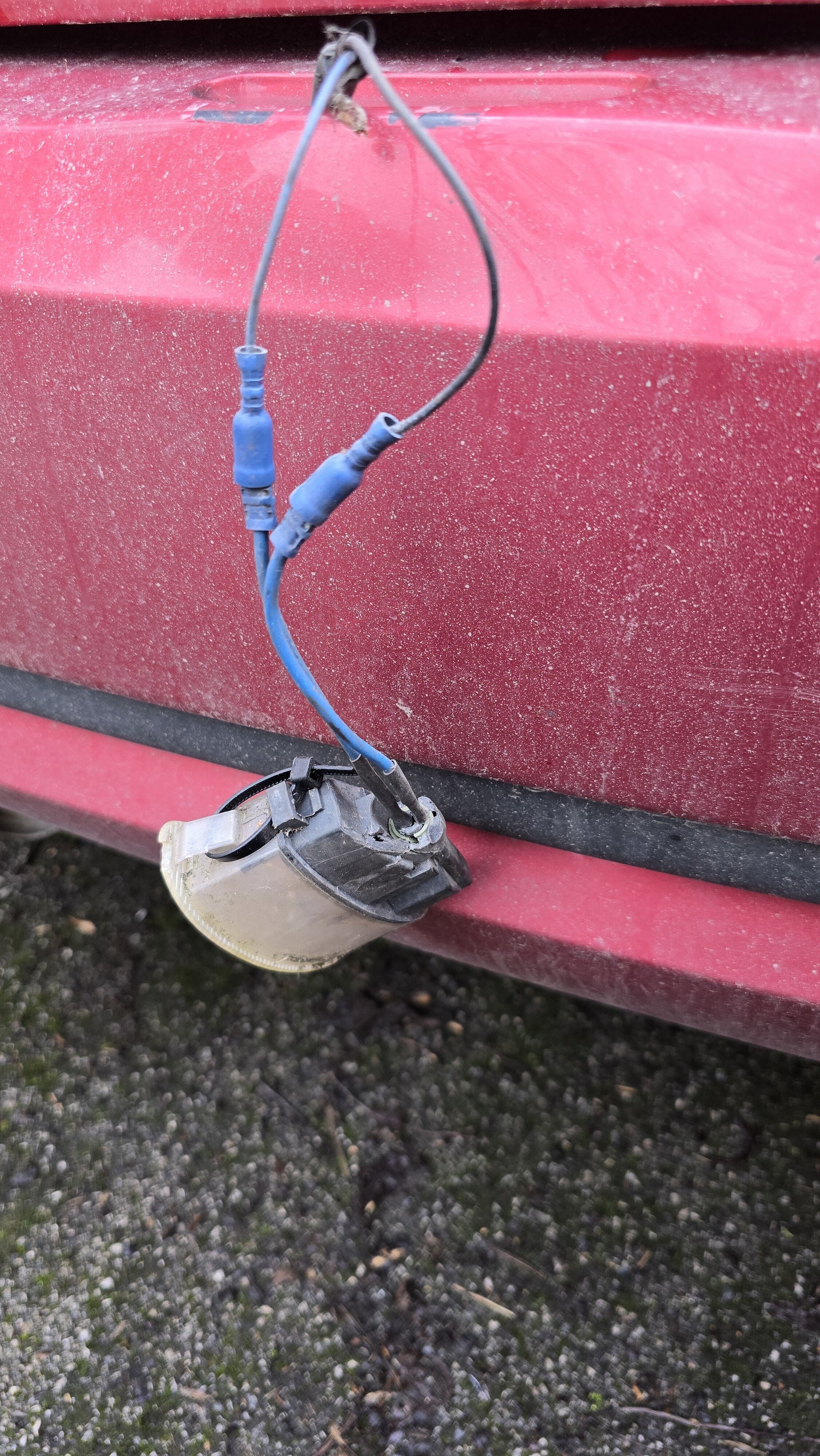

fitted a new number plate light and discovered even that has been buggered with so once again had to re-do the wiring as a temp better fix than the prior idiot and ill harvest a proper plug off a breaker at some point in the future but for now its looking better also finally got the old stupid gel plates off and in the bin, decided to fit some plate surrounds with the renaultsport factory address on them, Ive always liked plate surrounds but maybe that's from years of having them on my trucks

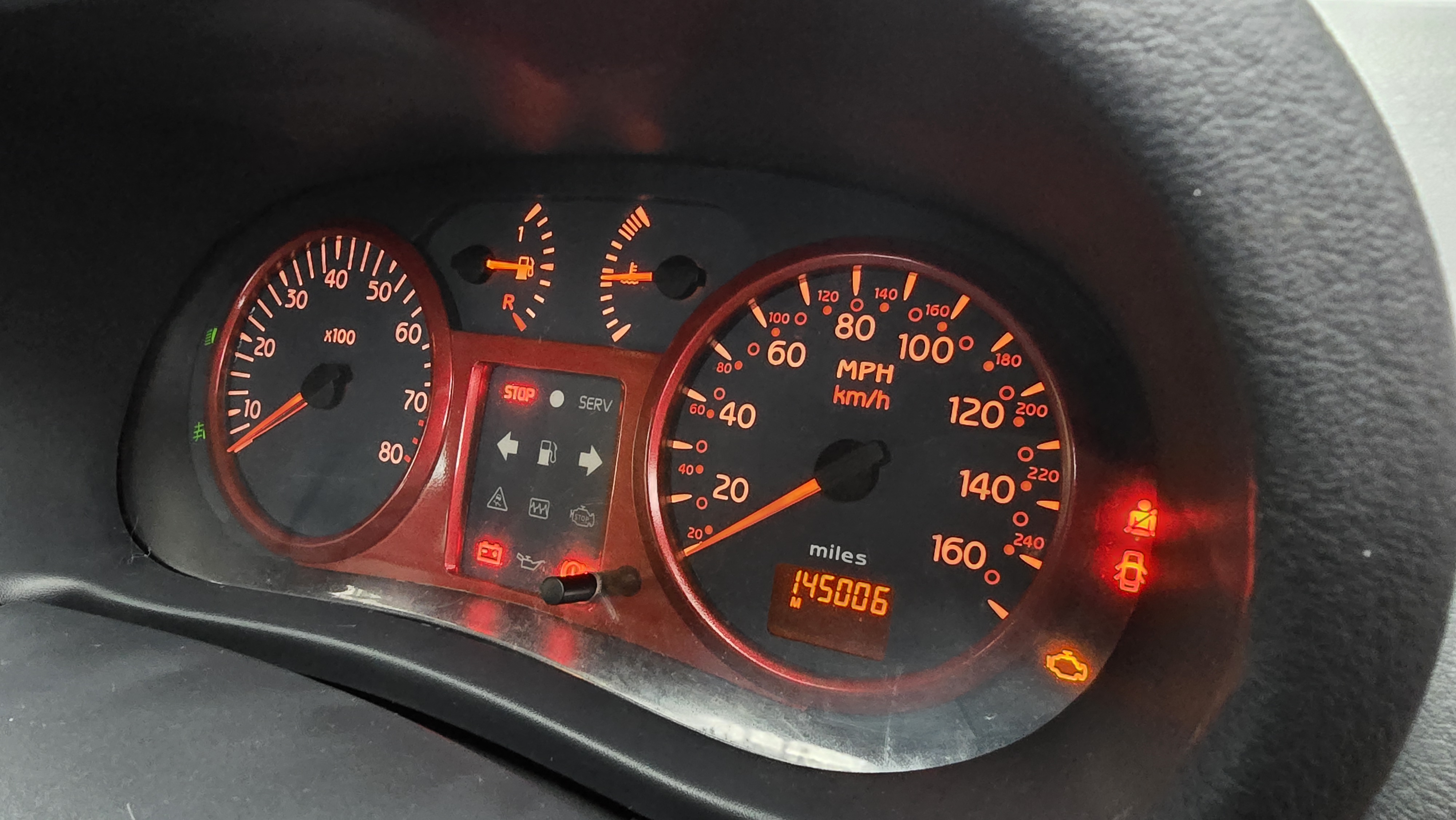

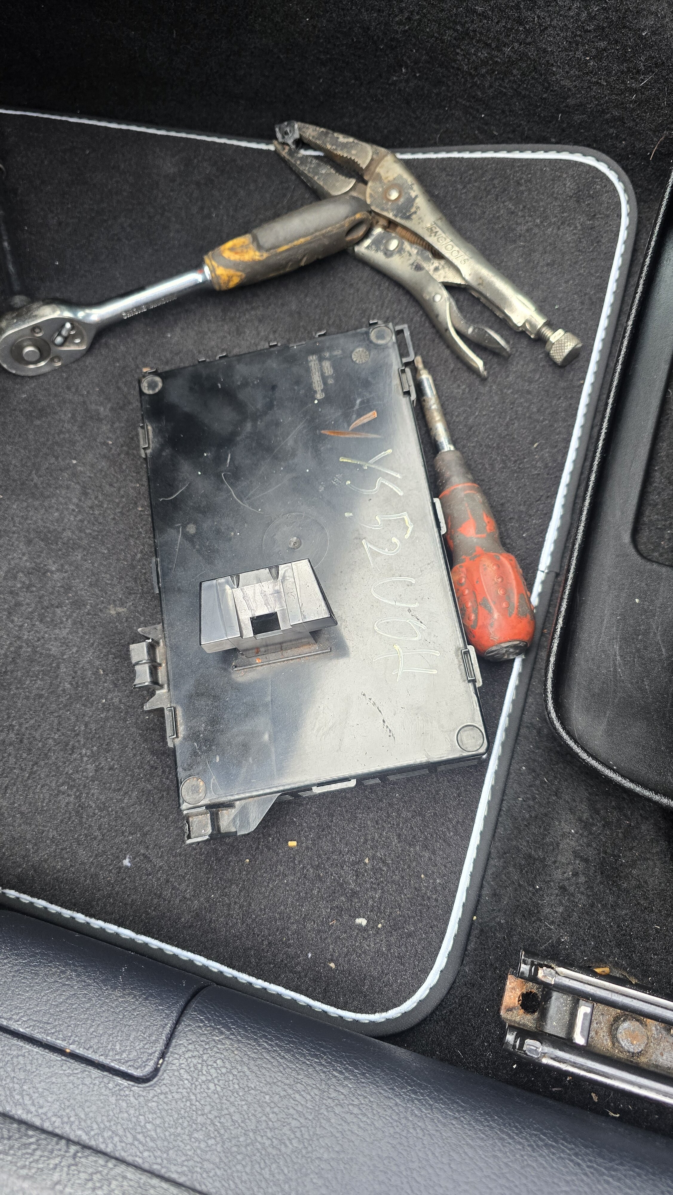

then the car hilariously treated me by having complete uch failure, very cool, was sat idling, closed all the gates, turned the lights on car dies, dashboard freaks out, central locking stops working, the hazard switch turns the interior light off, the lights make a horrible buzzing noise in the footwell, very cool thankyou car, so a mission in my mates spare car aka the German taxi 22 plate merc to go get a matched ecu and uch, this was a b**ch of a job as i discovered, but also someone's been there before, broken clips, wrong screws, but it did fire back up and is now driving pretty well as a daily as my S80 is being stupid, sadly I've lost my cruise control capability so the original uch will need fixing but that's not the highest priority.

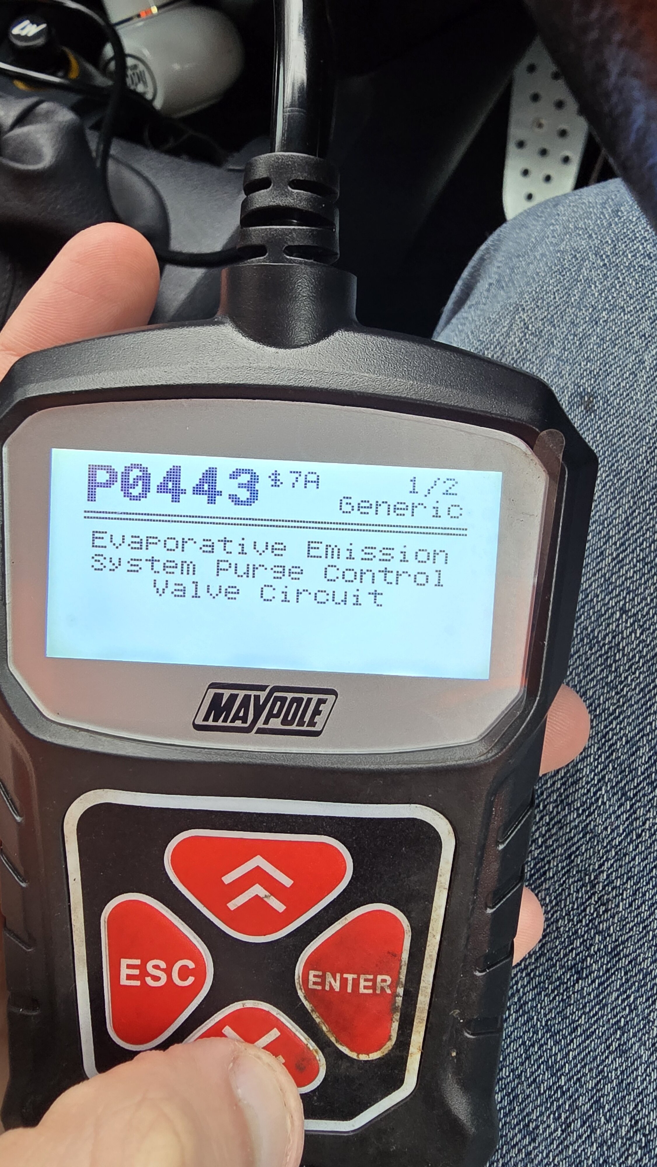

other than that, i did investigate why the engine light was on, one for the charcoal canister, had a poke around there, couldn't see anything wrong, other for a o2 heater, but live data was showing it functioning at that moment, cleared both codes, light has stayed off so, great success, also not on photos I threw a better ramair filter on it as that horrible eBay special 1 was covered in muck, and 2 was eating through the battery casing because he's not sized it correctly and cleaned up the rear tail light connectors, as they were completely full of rust that wasn't helping brightness.

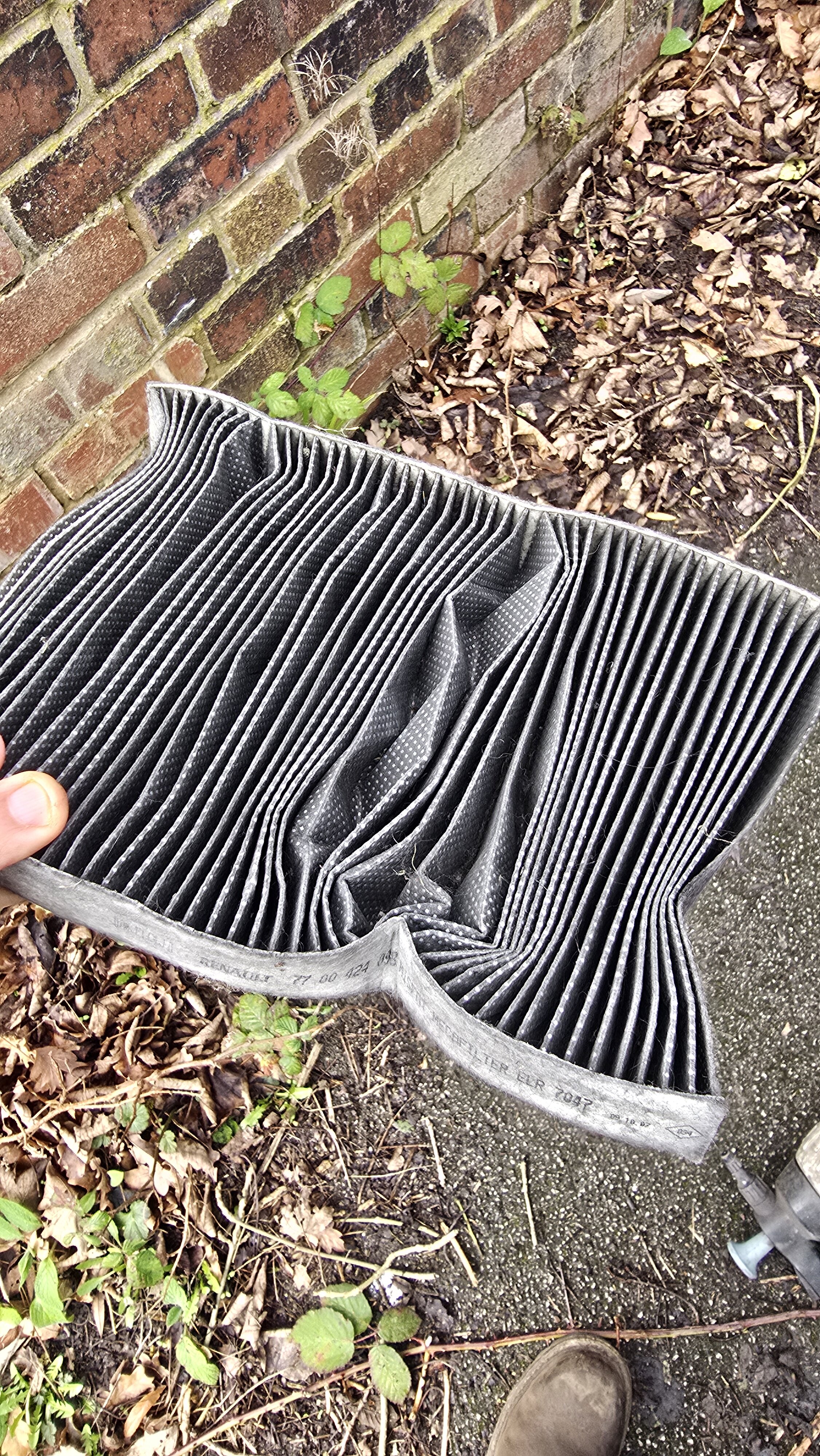

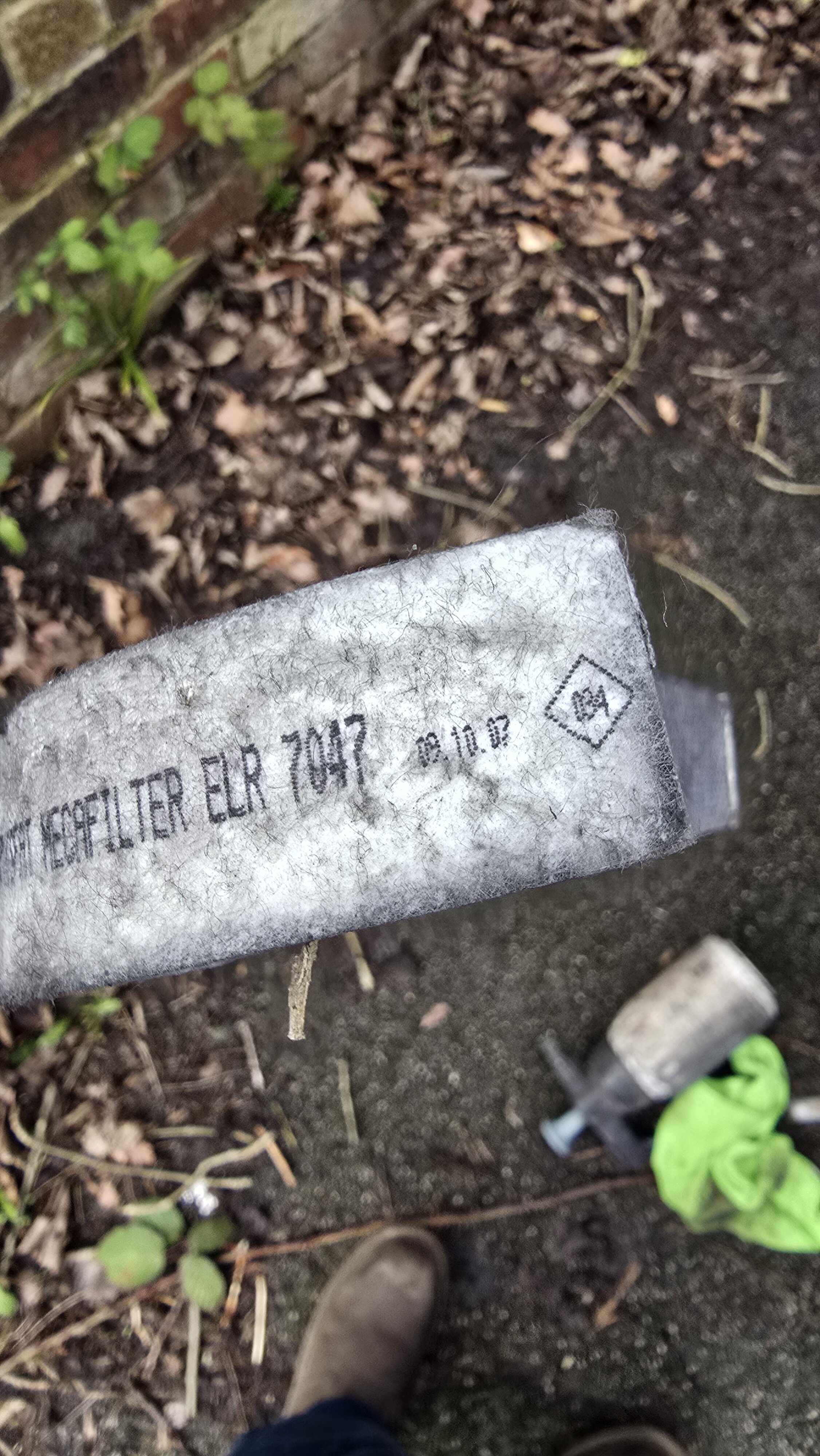

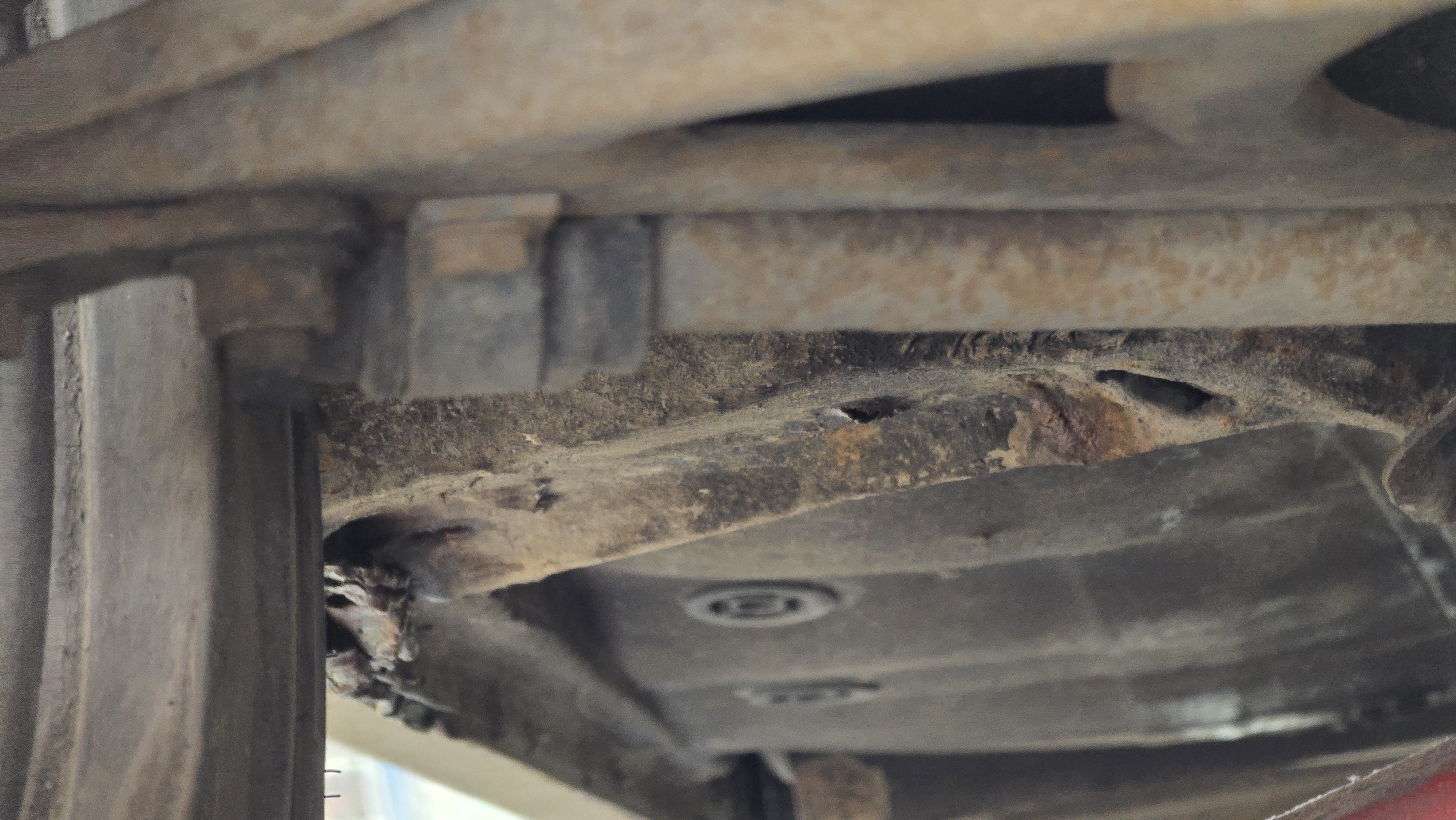

was a small head scratch what had happened here untill you go to remove the filter with a tool, and realise that if you don't pay attention you grab the wires and ruin them, also a bit of a daft design as the only way is just pour oil down your block?
can kind of see here the rust and how the sill has been absolutely mullered, but apart from there the rest of the sill is actually pretty rust free so, we can deal with that.

dipstick back in finally we have correct level readings again!
09 10 07, I think that may be past its due date

quality repair a cable tie, some epoxy, some bodged wires, and the stripping job on these were absolute dog spit, so it all got cut back and re-done properly
there we go, it now actually illuminates the plate correctly!

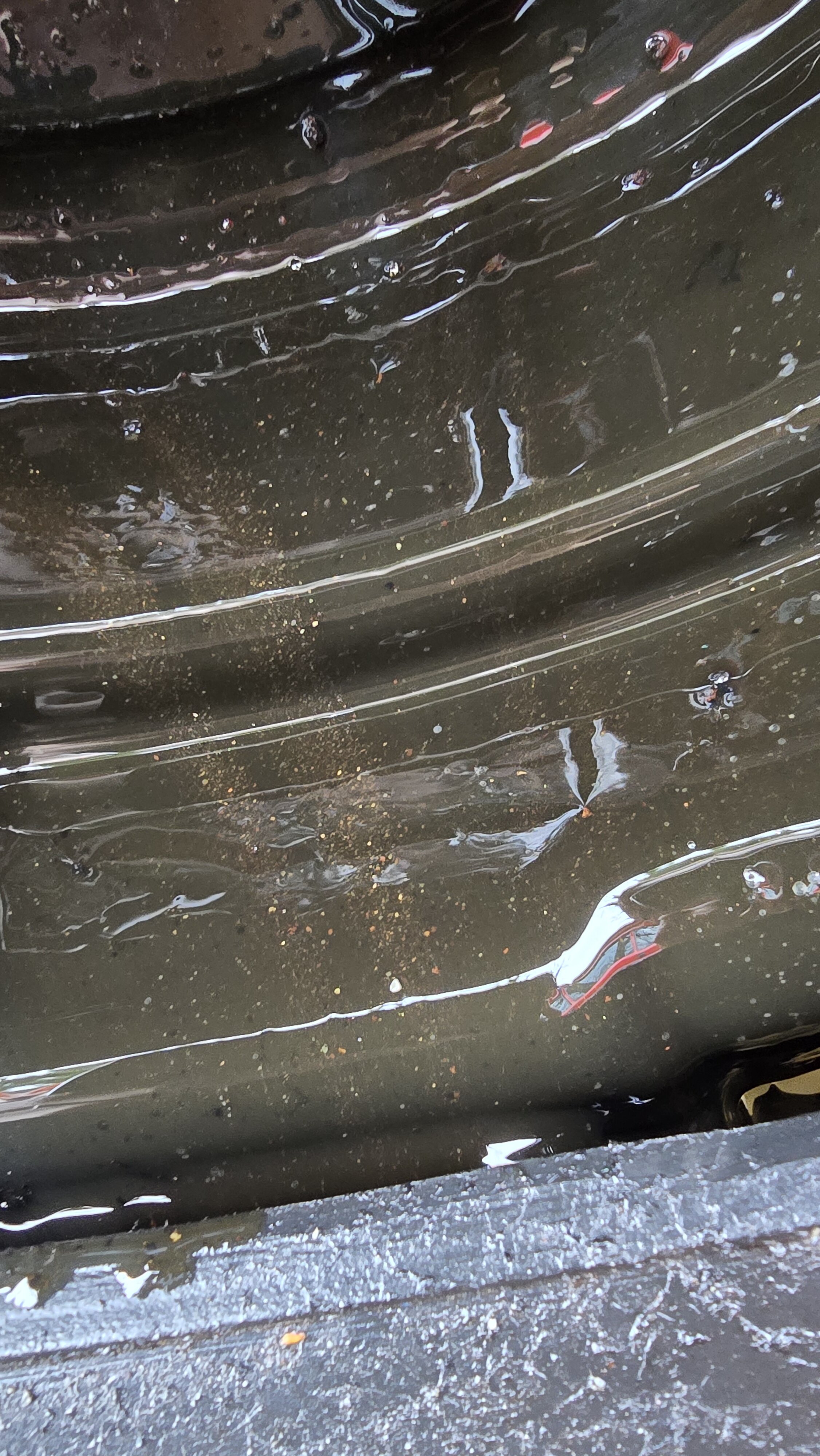

this was the brass I found once the oil had drained back, now we use this pan for a lot but I know there wasn't THAT level of brass in there before, but there is a plan, buying a spare engine that may become the main engine sooner rather than later, that "44k mile trophy engine m9" may be a load of sheeet me thinks.
gell plates be gone, and some surrounds now fitted

nicer cover fitted because i dont fancy either shorting the battery out or having a cut piece of plumbing as a "cover"

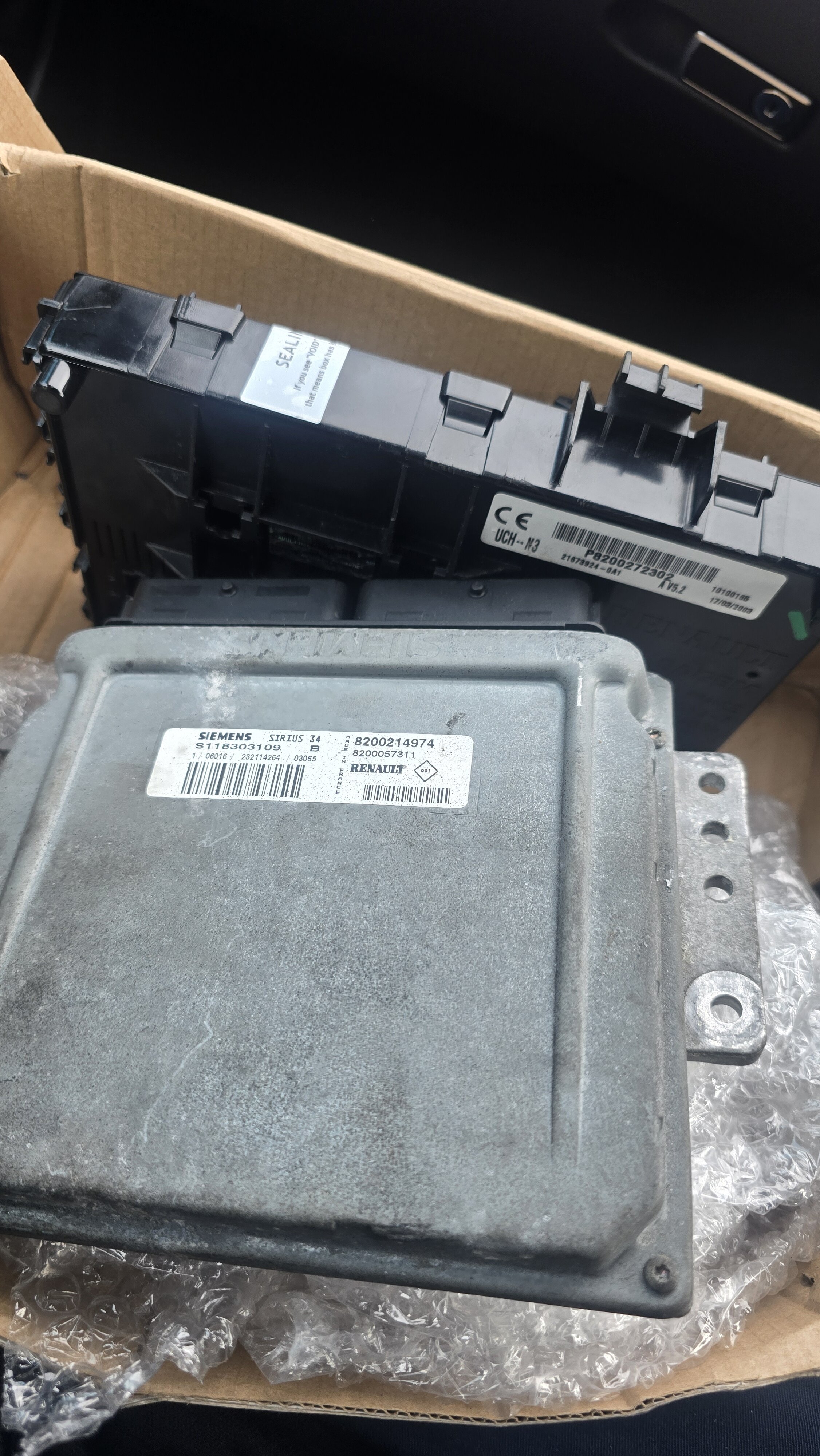

rushing back with a better pair of ecu's, this one being all original factory sealed and not rust covered gave me better hope
will keep mine and see if its repairable, also notice on the bottom corner the mounting screw tab thing is just, gone

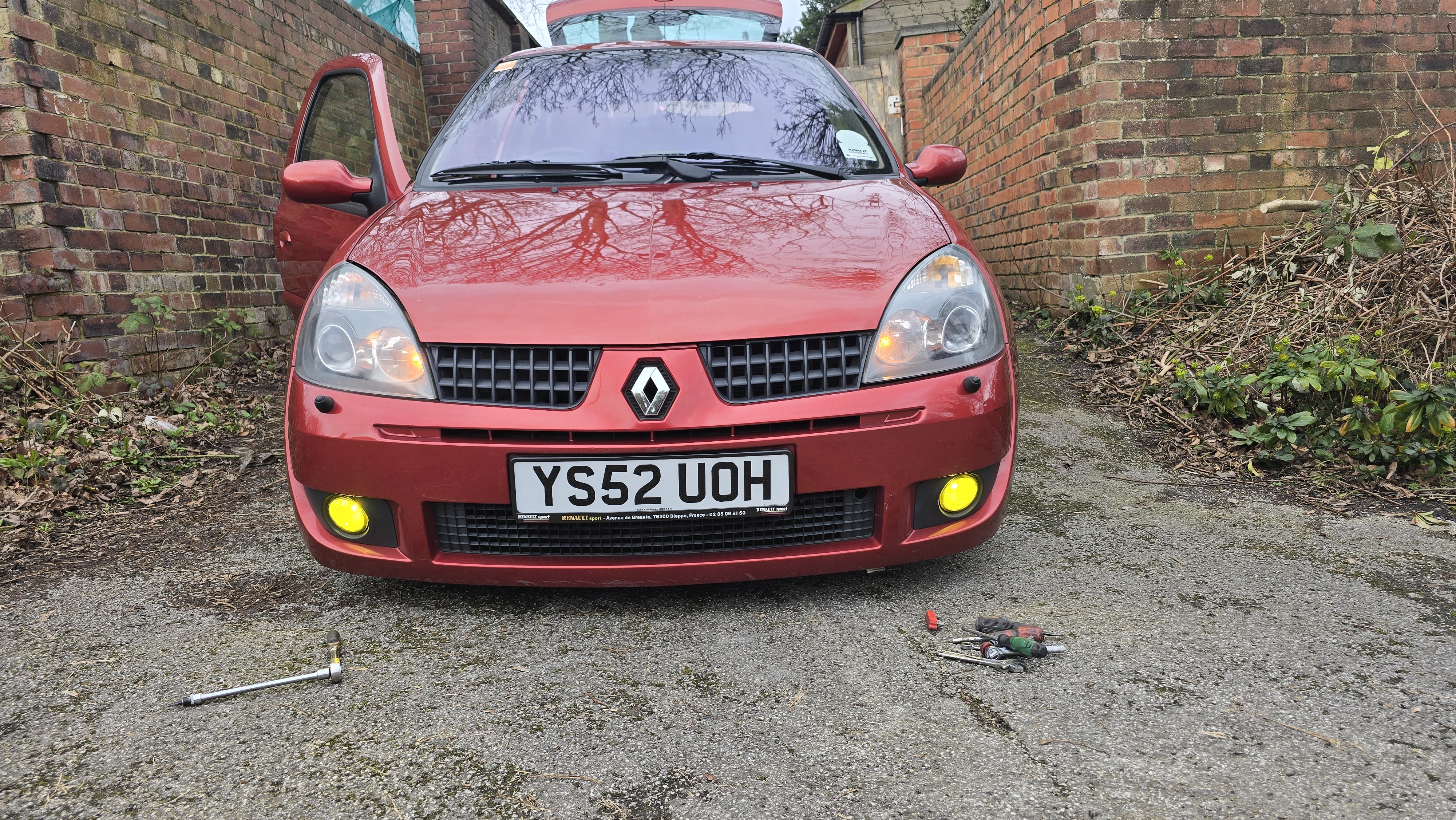

Yellow bulbs fitted, ignore the orange sidelights this was still in my seeing what wiring is dead testing phase

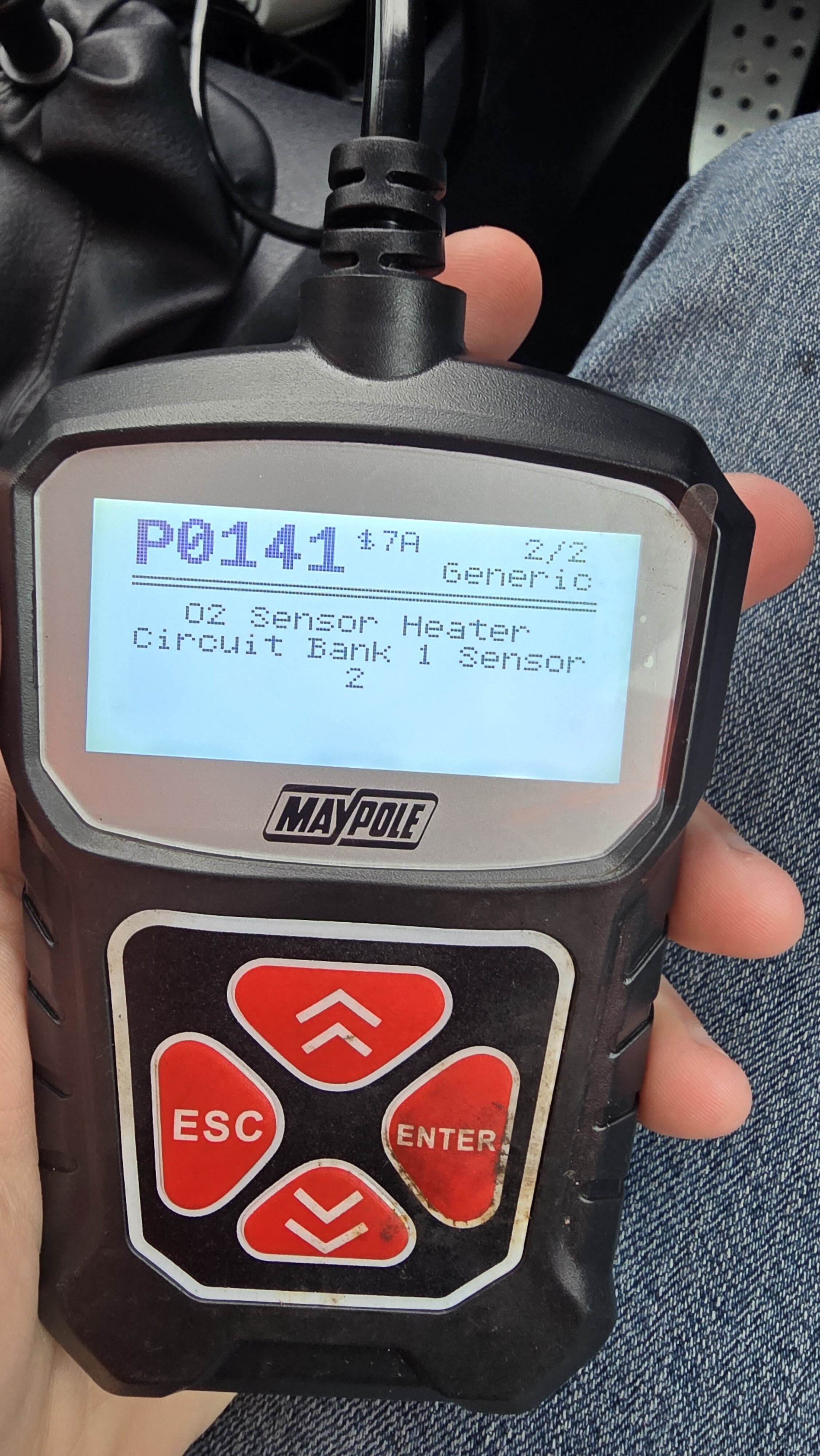

sensor 2 should be the downstream of cat sensor id assume, but I sat and watched it heat up on my actual tablet so, maybe its just had a unhappy moment
and unless once again I'm wrong on a Renault, that should be the charcoal canister valve? but that also appears functional and I couldn't find any wiring faults so, cleared and keep a eye I guess.
