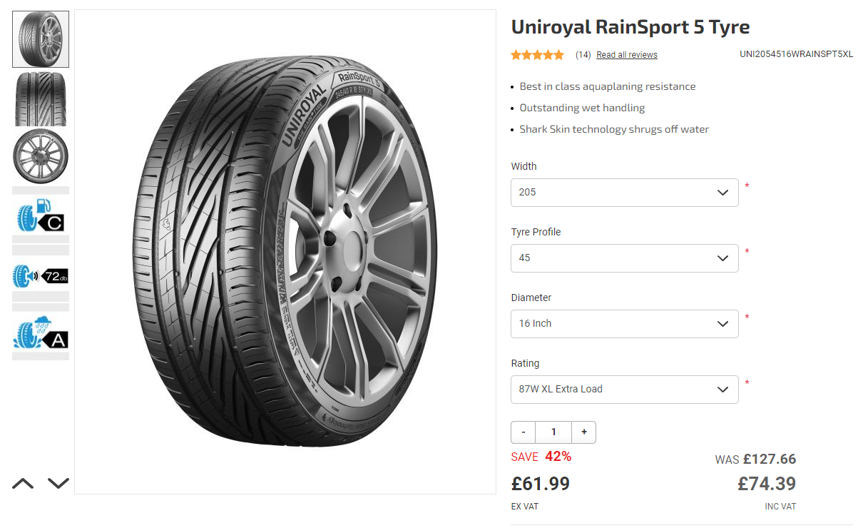

Rainsport 5 are decent in that size as they come in XL. I have this size on the rear of my MR2 for road and wet track days and they really do impress. My fronts are 195/50/15 and they have a much softer sidewall than the 205/45/16 XL rear.
Dry handling good, wet handing close to an entry level full wet slick IME. Only gripe on my car is the steering feedback due to the soft sidewalls of the 15" fronts, but as my track car is super stiff (fully poly bushed, stiff coilovers, fully braced, 6 point roll cage etc) the sidewall's are the first thing to flex. I think most road tyres would feel like this on my car TBH.
Buy Uniroyal RainSport 5 Tyre | Demon Tweeks (demon-tweeks.com)

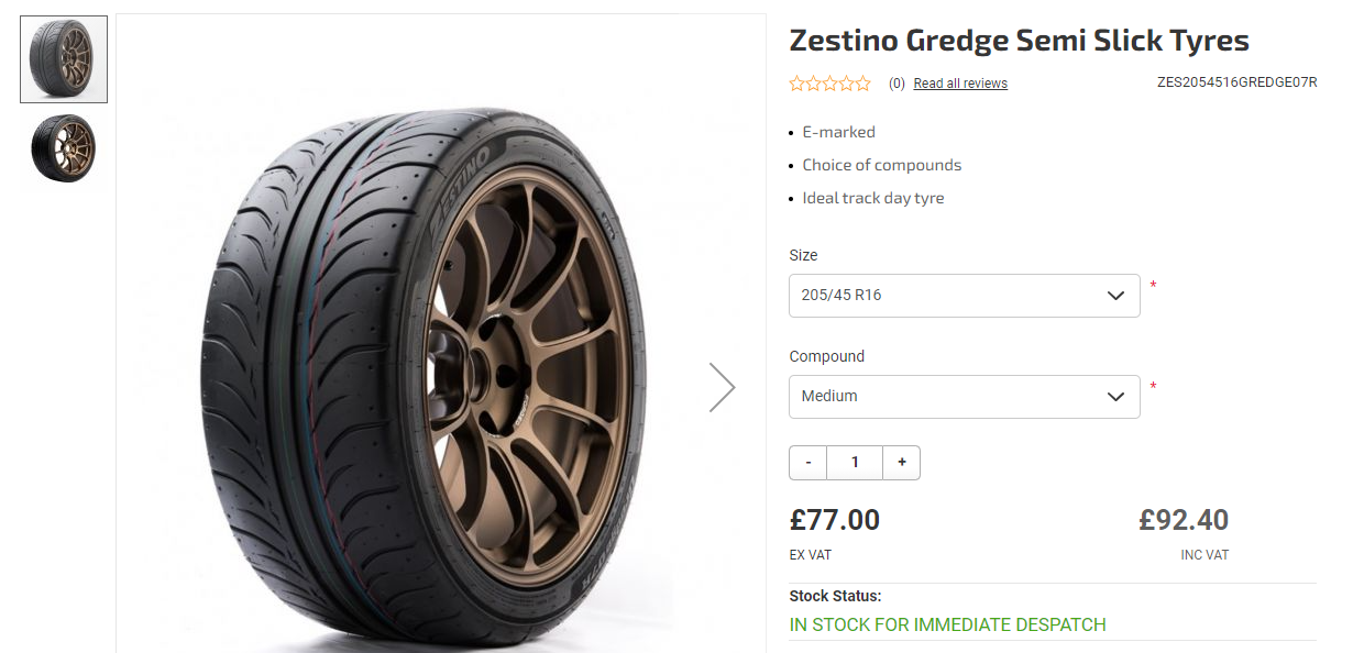

Another option for you is the Zestino Gedge. These are starting to get very good reviews and are under £100 a tyre. People who I have spoken to regarding these state that they are on par, if not better than the now discontinued Yoko AD08R.
It all depends on what you use your car for though, and if a road/track tyre is actually necessary.
Buy Zestino Gredge Semi Slick Tyres | Demon Tweeks (demon-tweeks.com)
