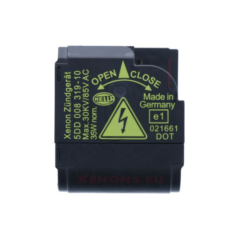

The Hella part number for the Igniter is 5DD 008 319 10 and they are £38 new from HIDs-direct.

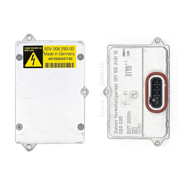

The Hella part number for the Ballast is 5DV 008 290 00 and as you can see from this eBay listing, they fit a lot more than Clio`s if you are looking for a used item.
