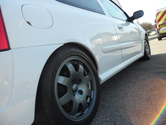

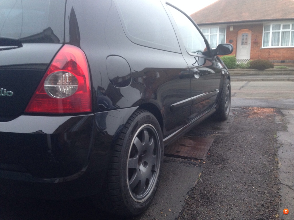

15mm with 1 degree camber on the rear. 20mm on the front. Slight scrubbing on the front with full lock, bit on the rear when car fully loaded. Running on Cooksports.

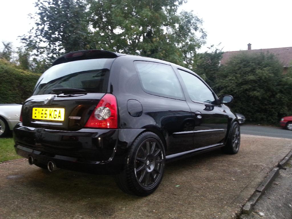

I'm running cooksports and cup turinis and I'm pretty sure I'm gonna go 15mm front 10mm rear.

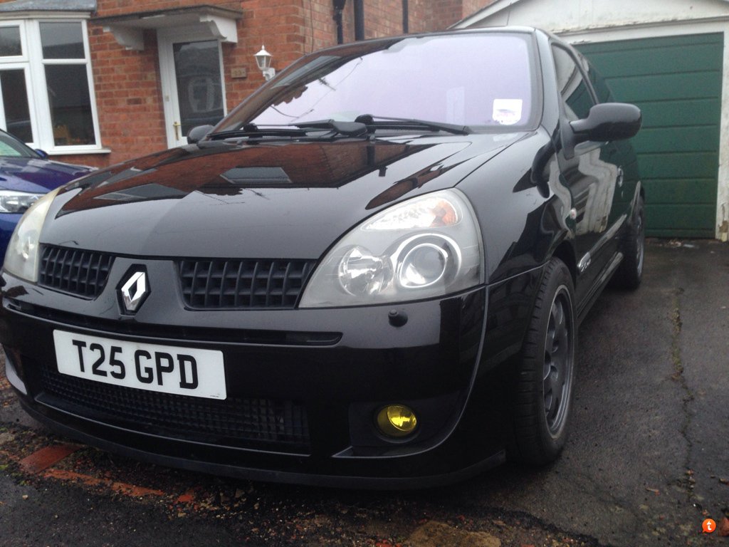

That's the spacer options I'm thinking of going too, I think 20mm might scrub lowered with coilovers at the front and no real negative camber

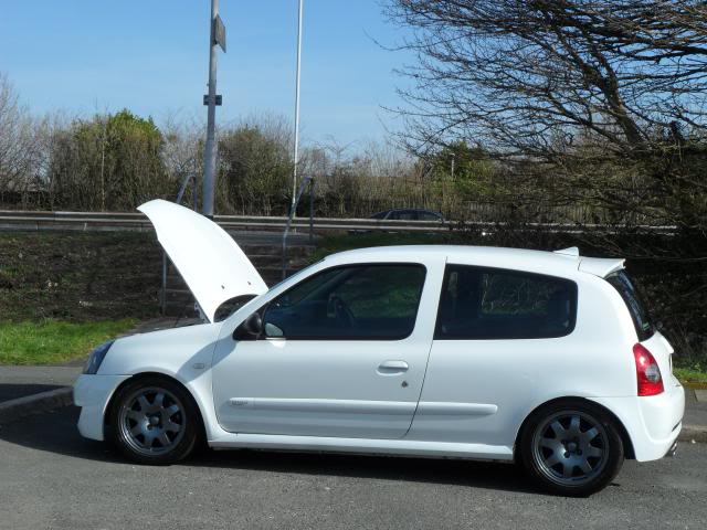

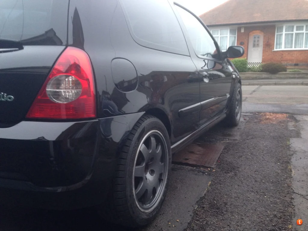

I'm on 10mm rear, 15mm front and standard camber.

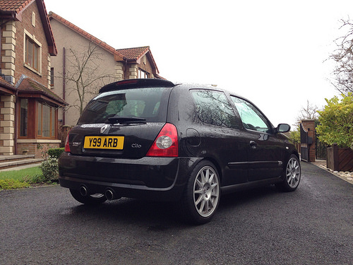

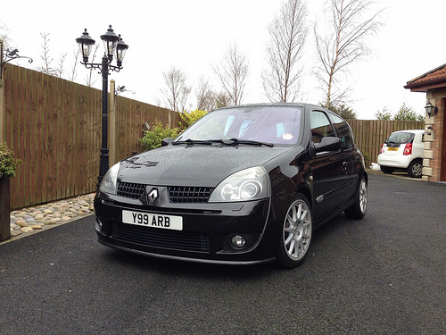

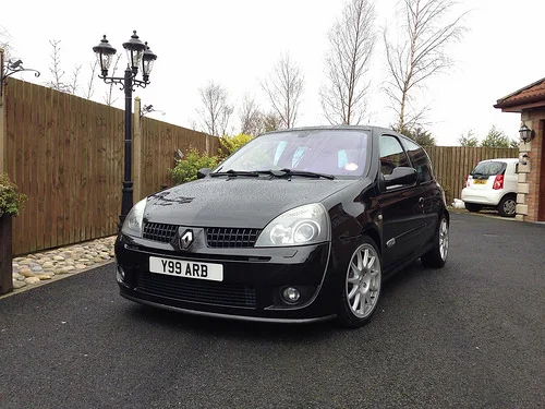

25mm front 20 rear is perfect. I have 25mm on the back and they rub (but cause no damage) if i go over a bump. I can only have one person in the back aswell lol
