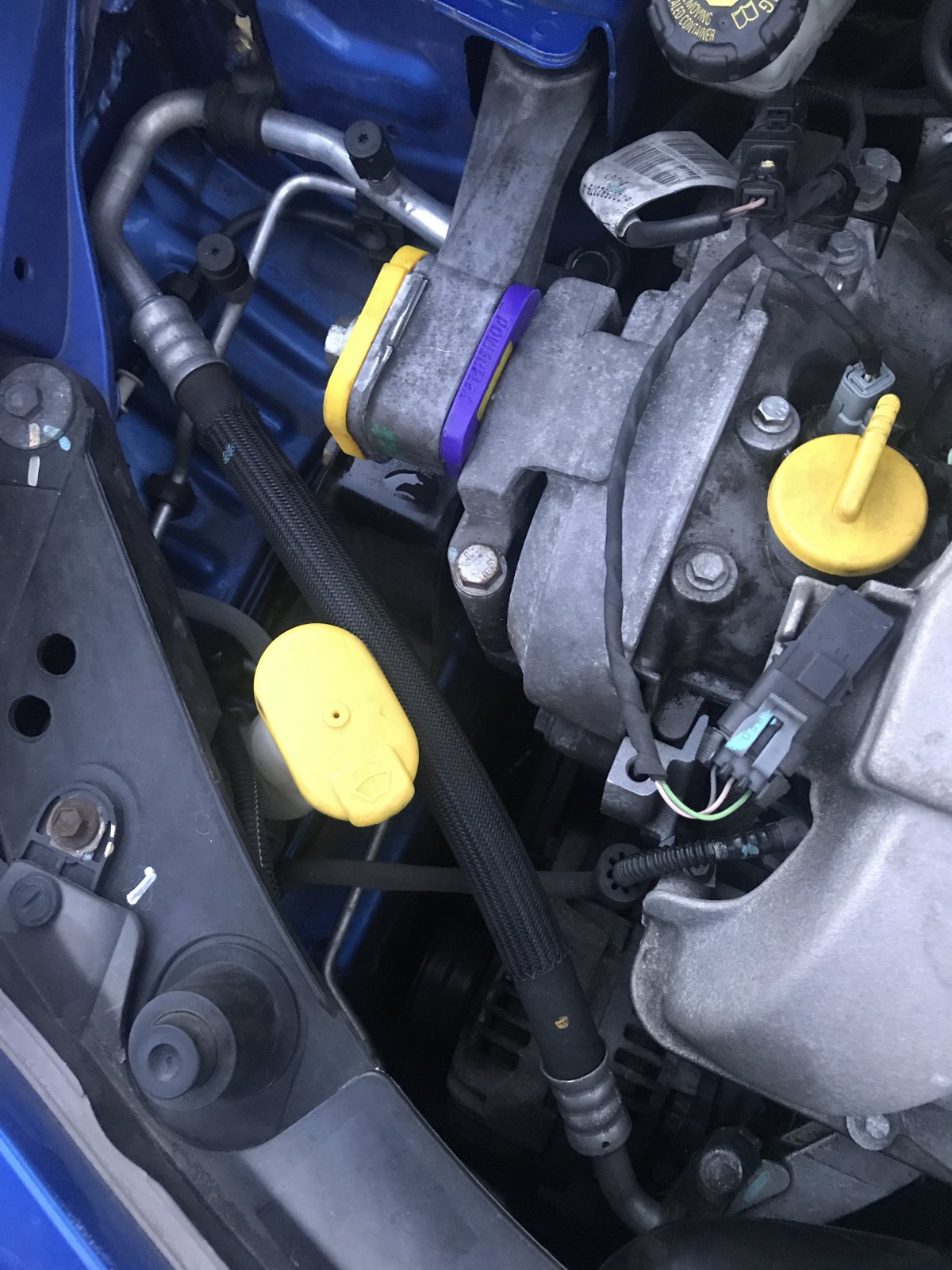

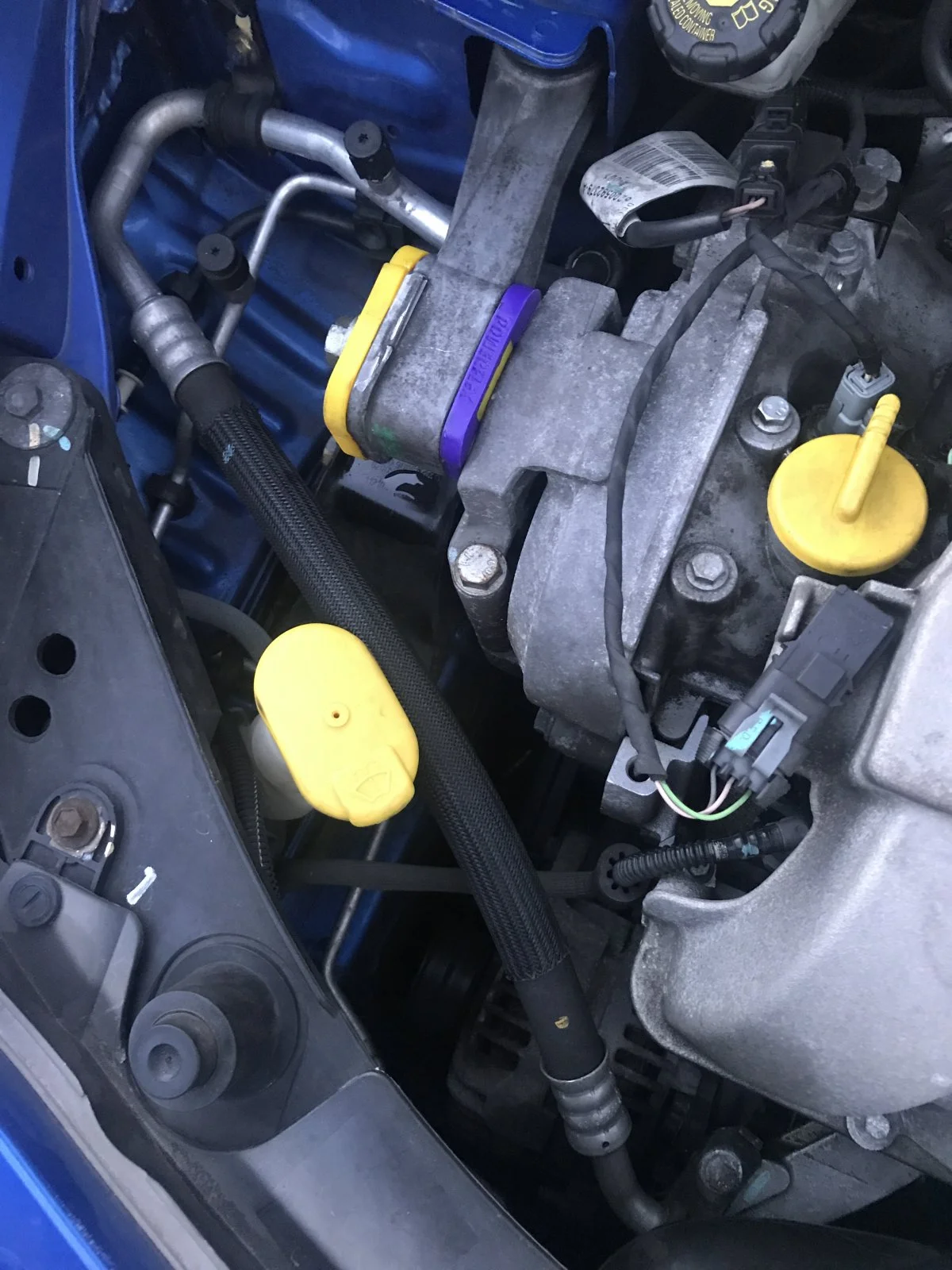

When I come on and off the throttle you can feel the gear stick moving a little bit. What causes that?
Gaz_
  Extreme mode
Noting to worry about, but a new dog bone mount will help tighten it up

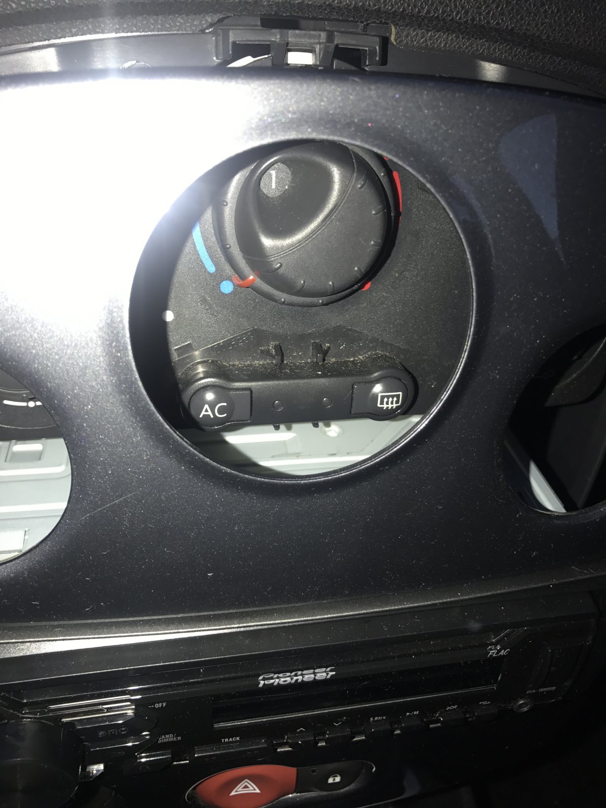

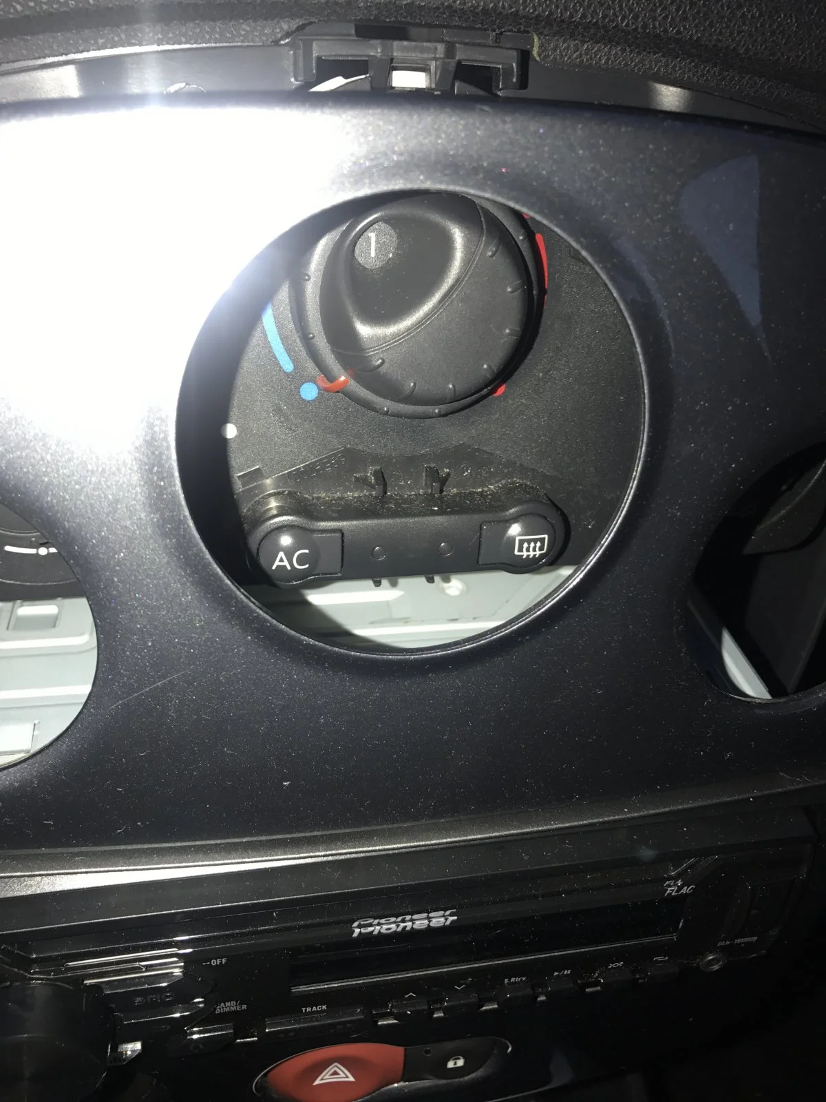

That's the dash

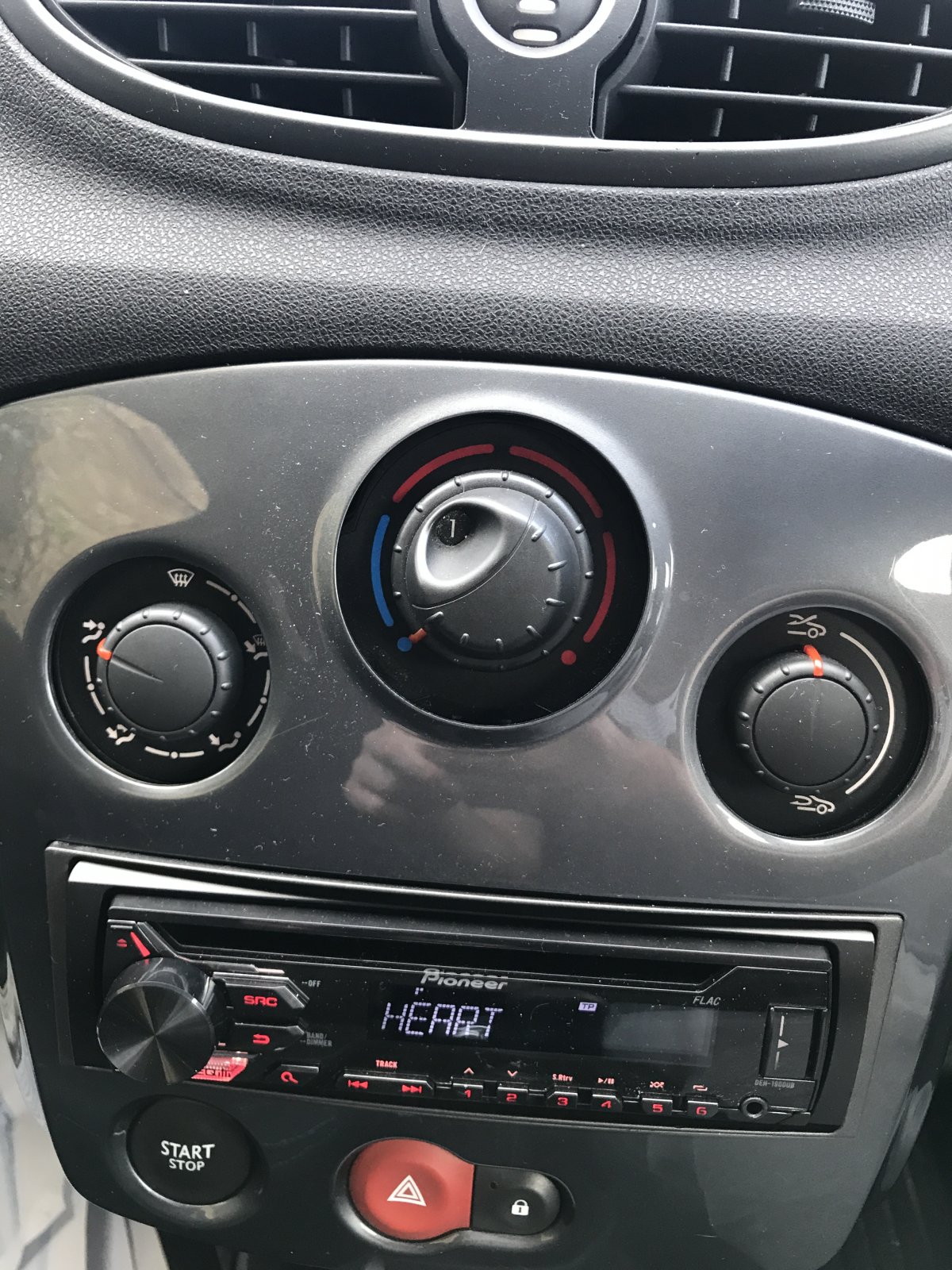

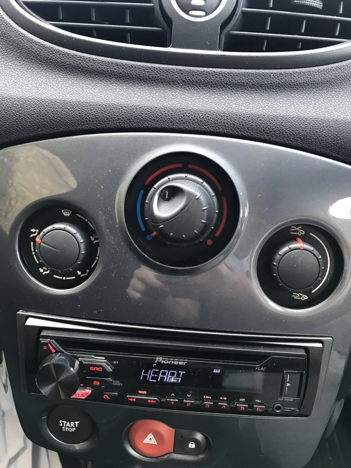

That's no right
All 197's had AC/Climate unless it was a cup. Yours isn't a cup as it's albi blue

It's had a different front fitted for some reason
Going to hazard a guess. Rear window doesn't work, nor does the aircon. Hopefully wrong
  clio
Well I took the Facia off and put the air con on. Ice cold!! So the last few days I've been roasting. I could of had the air con on!! As for the rear screen. I'm not sure

Re the OP, a lower uprated dogbone and an uprated upper torque mount would help.
