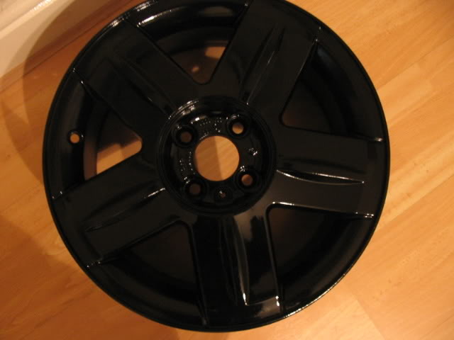

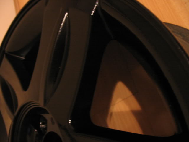

Well, finally got two of the wheels finished now and i can finally see what their going to look like. I'm quite happy with how they've come out, there are a few areas which could have been done better, but hey its been done with spray cans from halfrauds! lol

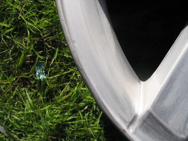

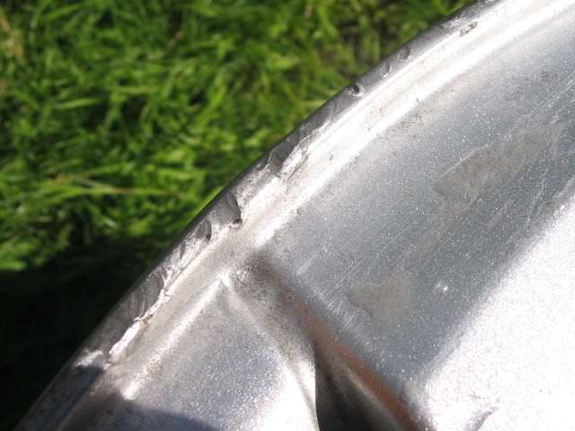

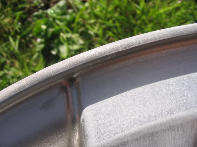

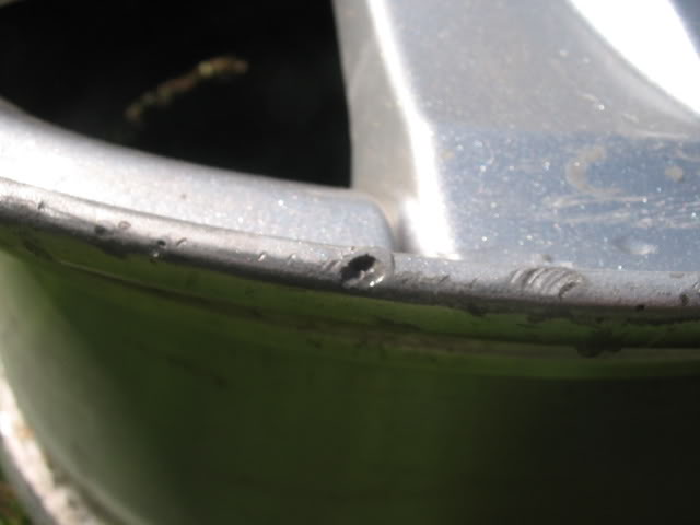

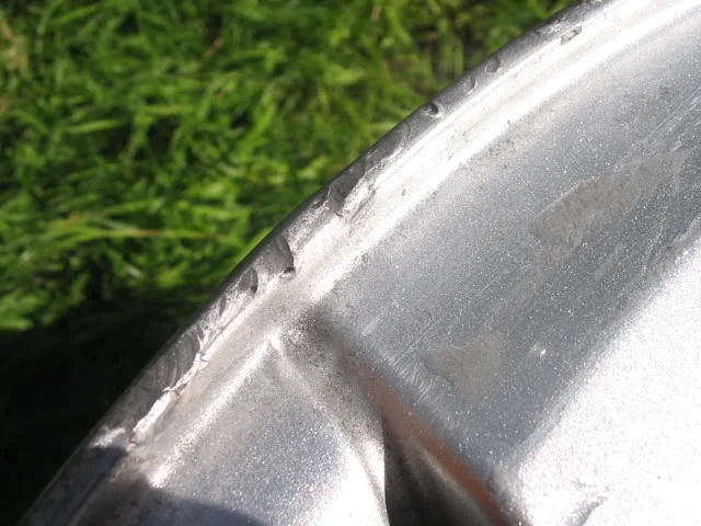

The other two need a bit work due to the kurb damage, but i've managed to fill (keeping the curve of the rim :D) and smooth down one alloy, heres a few before and afters. :)

Cheers Matt, after using way too much paint and fcuking up the first one ten times, i've finally got the hang of it ;) lol

Nice one Dan . Looks like you've done a good job there mate . Alot cheaper than paying to have em refurbed eh ;) Did you use the metallic filler i mentioned , the Upol D Metallic Filler ?
I had something very similar in my stash. ;)
Works a treat and a piece of piss to sand down...which was very lucky in some cases! lol

Look fantastic, but you've painted the areas where the wheel nuts go. I did this on mine and the bolts kept coming loose due to the paint heating at a different rate to the metal (i assumed)! Took the paint off of that section and they were fine after that. Worth doing let me tell you!!!! :D
I did this and almost lost a wheel mid-session at Goodwood.
Before you fit them you MUST remove the paint from the bolt hole where the wheel bolt seats...or the same might happen to you!

Cheers mate, i'll make sure i'll get some sorted, don't want me wheels to fall off lol :)
