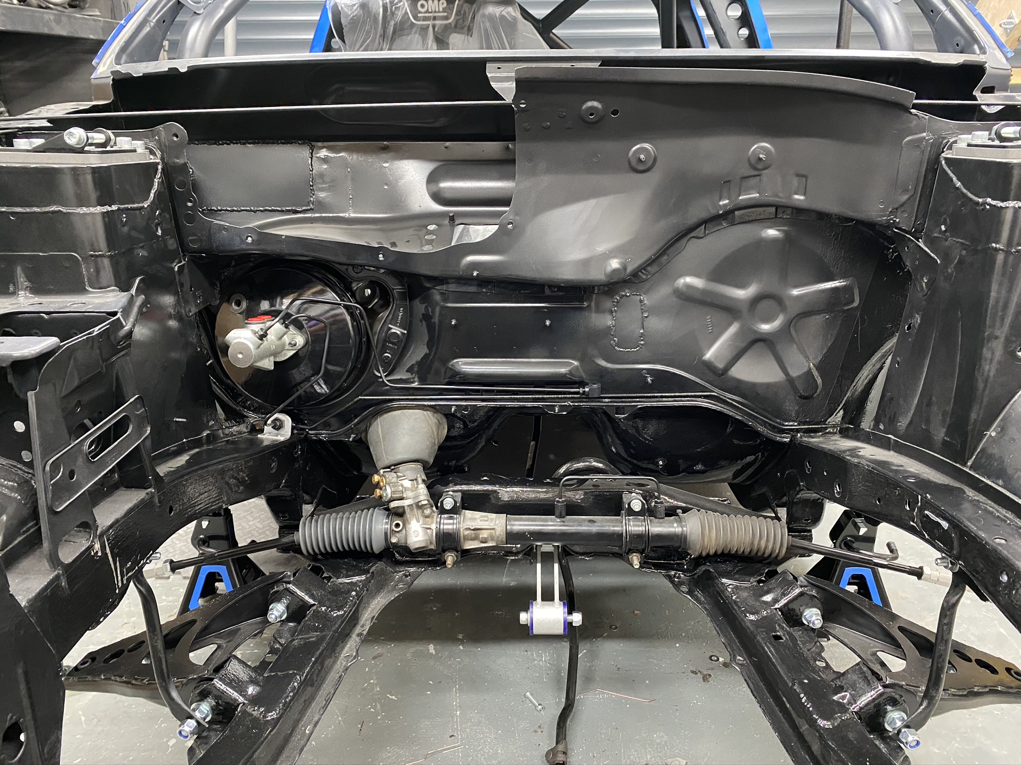

scott.kir Car BMW 120D M Sport Oct 12, 2020 #1 Could someone confirm to me which outlet of the master cylinder feeds front/back brakes thanks in advance
U Usr117063 Oct 12, 2020 #2 scott.kir said: Could someone confirm to me which outlet of the master cylinder feeds front/back brakes thanks in advance Click to expand... This is from @FPummell build, you can see clearly in this

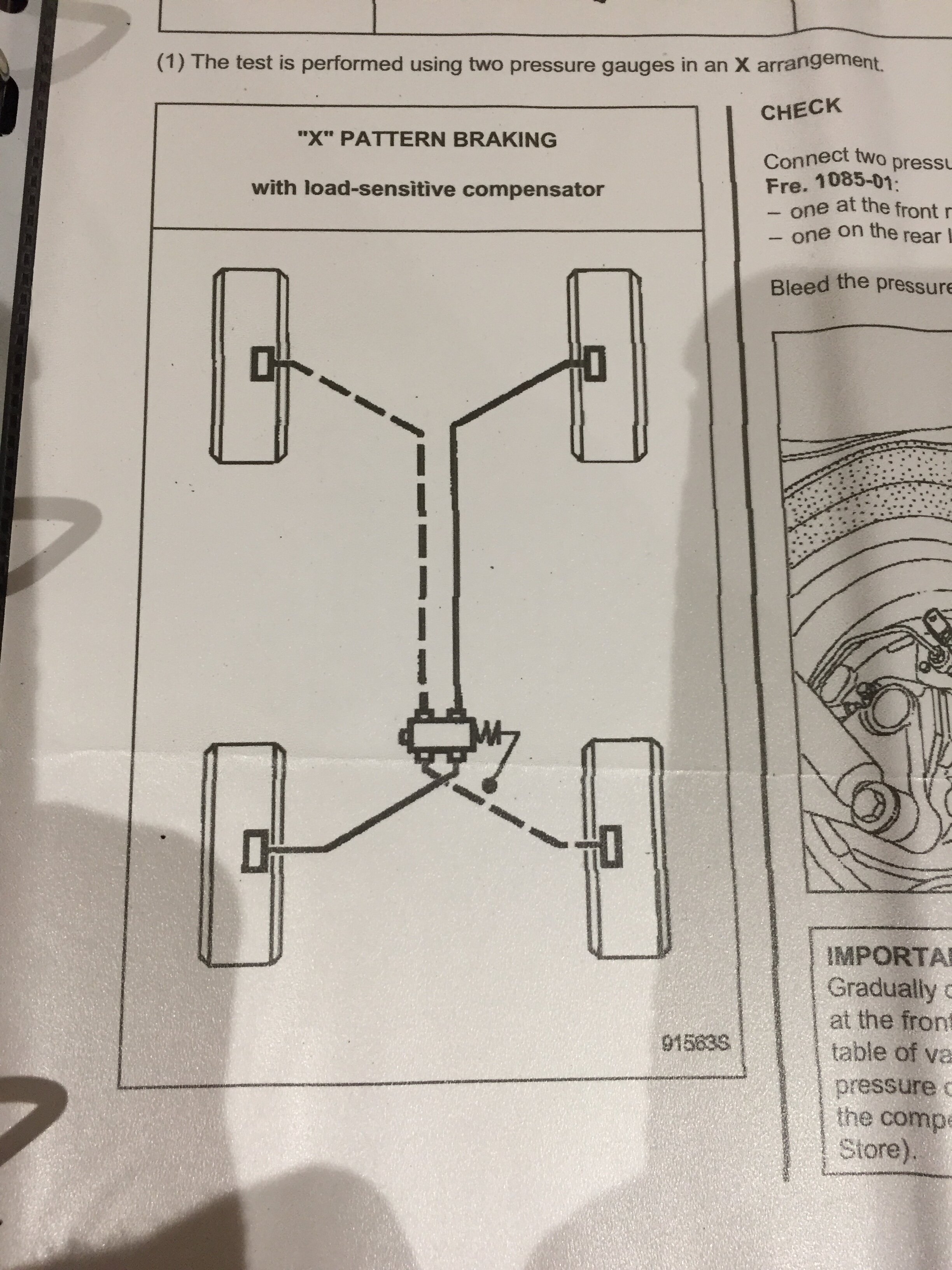

BashRacing Oct 12, 2020 #3 It's a diagonal split system So Front port feeds NSF + OSR rear port feeds OSF + NSR
