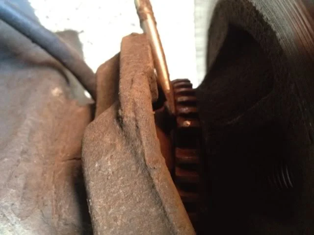

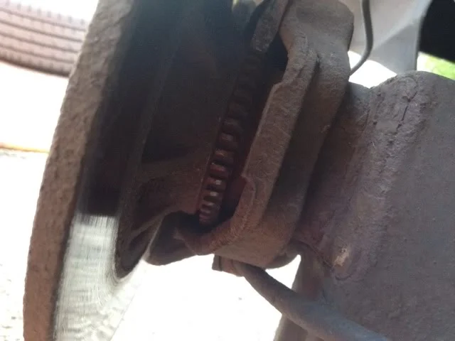

First off, I had a rattle, and after a thread on here just couldn't resolve it, today I have.
Oooo, whats this!

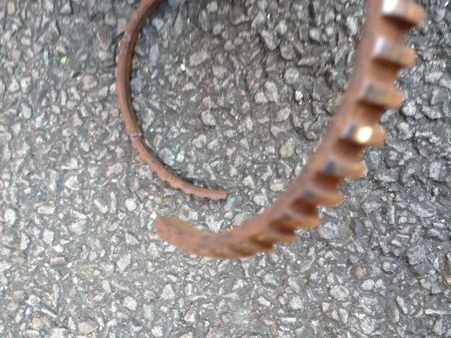

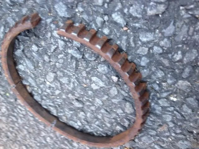

FOUND IT!
It was loose, need to now find out what it is?
As it was loose and broken, I took it off, problem solved!
So could someone please tell me what this is, I have a 172 cup for the record, and have new discs/pads/bearings in the post to change, whilst looking around I found a problem.

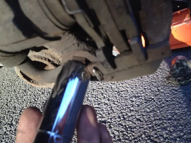

The 17mm Socket wouldn't fit on the bottom caliper bolt
How do I move this clip thingy stopping me get access?

But, if you cannot work out, that you just have to tap the little pin over slightly to get a socket on, then I would be a little concerned.

It wasn't a cant work out, it was a case of there is a retaining pin on it, to the left, I didn't know if this needs to be removed to slide the pin free, knock the pin out completely, shift it (as I've now been told) After having the which I now know as ABS ring being broken, I dont want to just smack the pin out if it needs a simple retaining pin removing.
