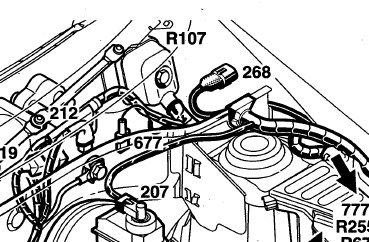

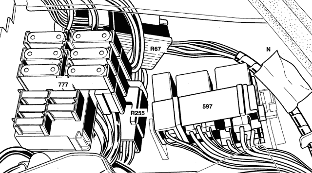

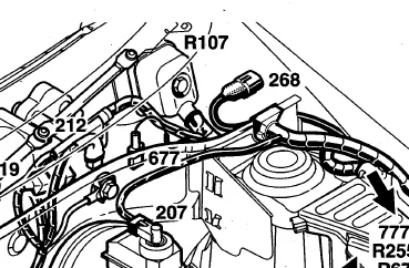

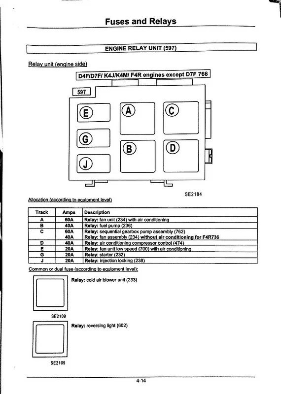

Where are you going to source an engine loom though?
A major clean up of all connections is where to start.
Plus the 90 pin connector to the ECU.
