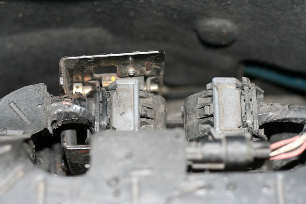

By the way this is the state of my tamper proof box! I think I've found it just in time to stop the wires getting cut through. There could be water in there though. Also it looks as though I've lost half of it. Wheres the other side of the box and the lid? Anyone know how to tighten it back up? Thanks.
