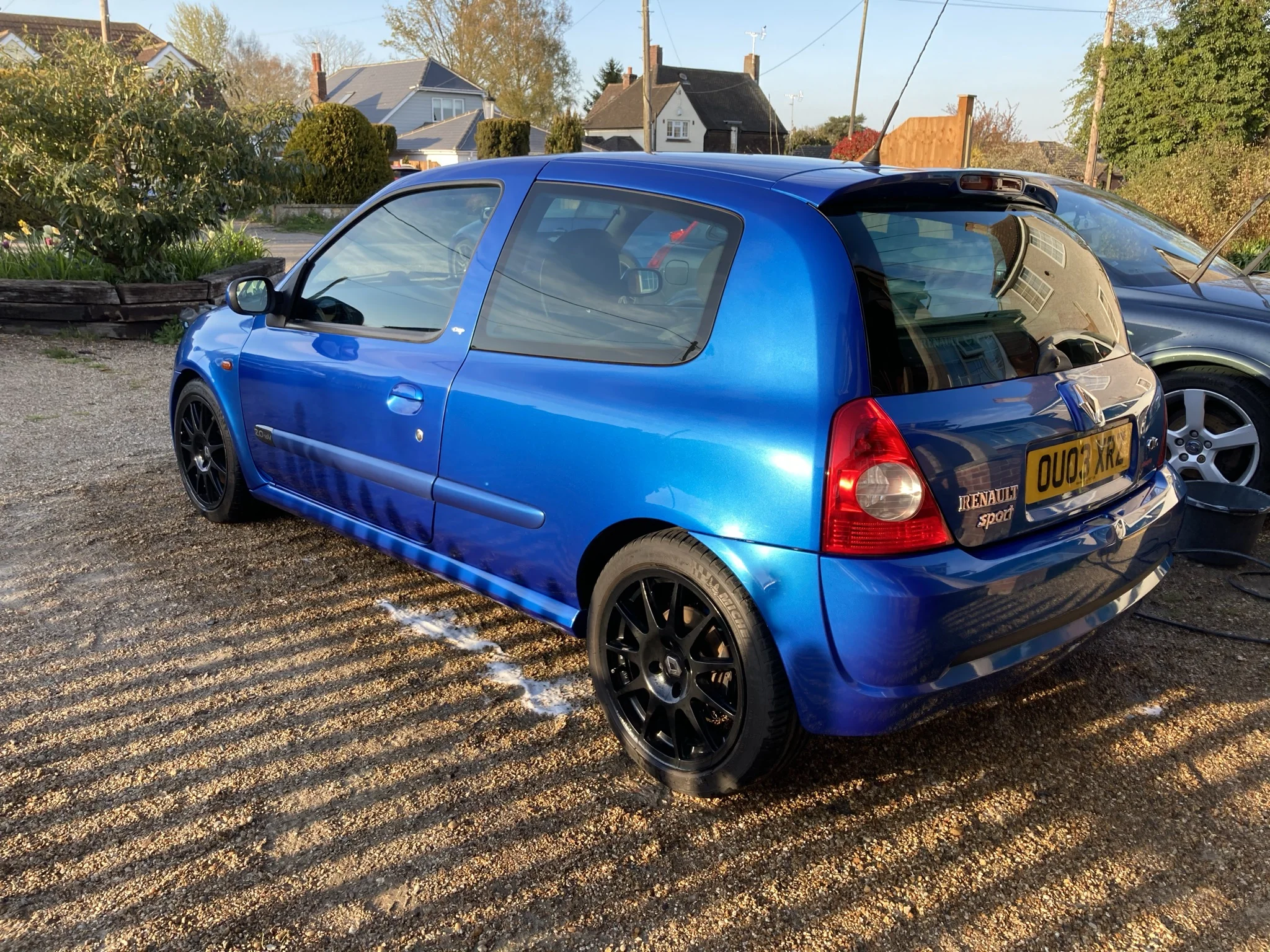

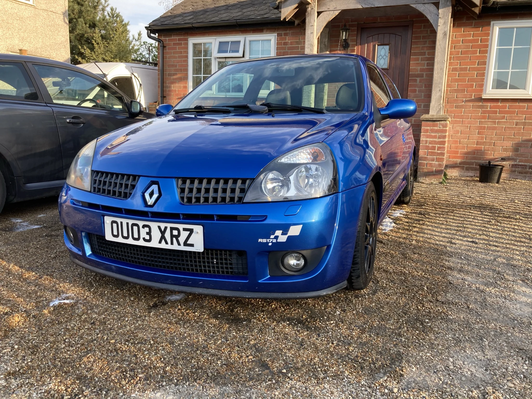

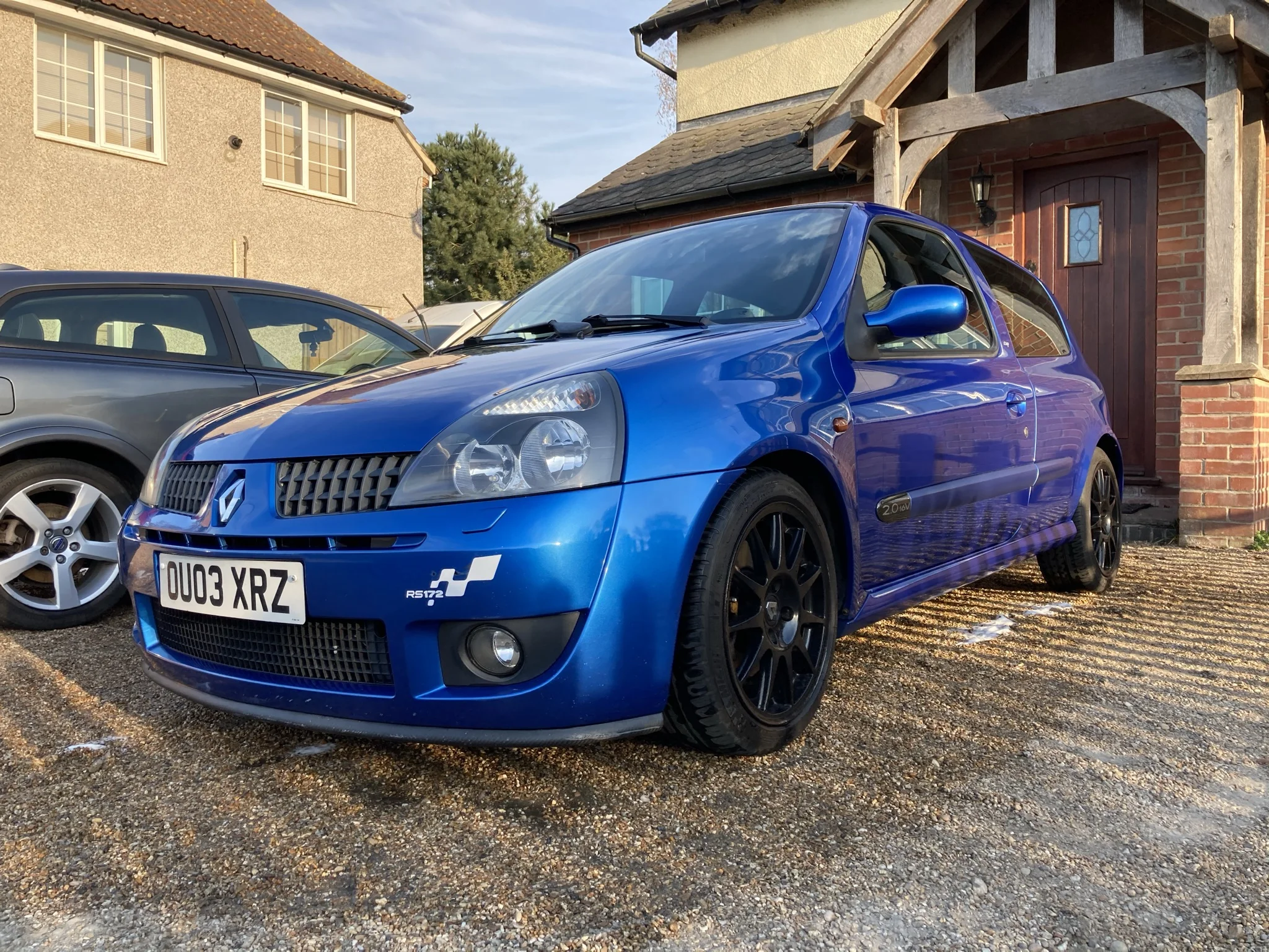

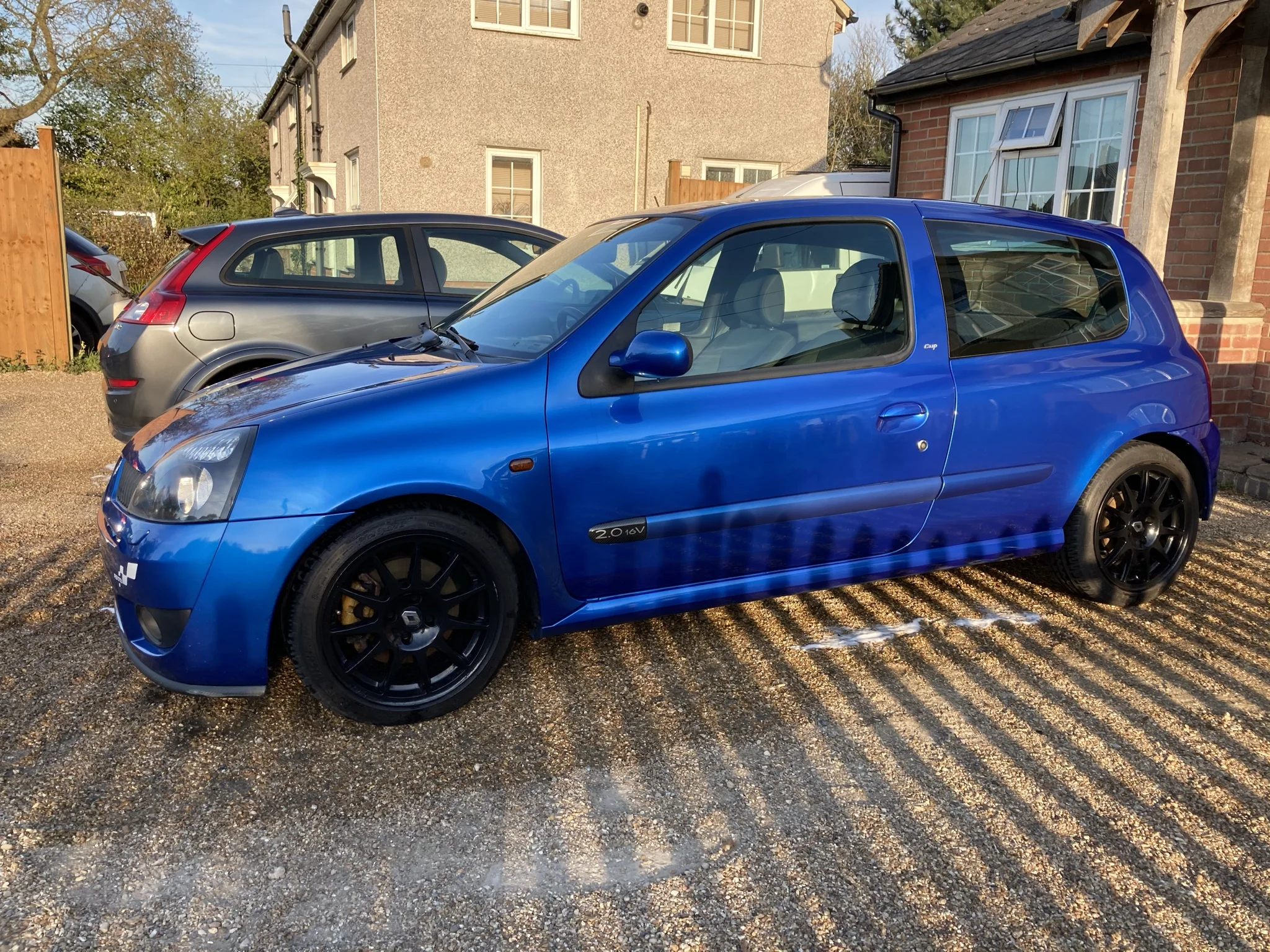

A few pics after washing it post collection from Portsmouth.

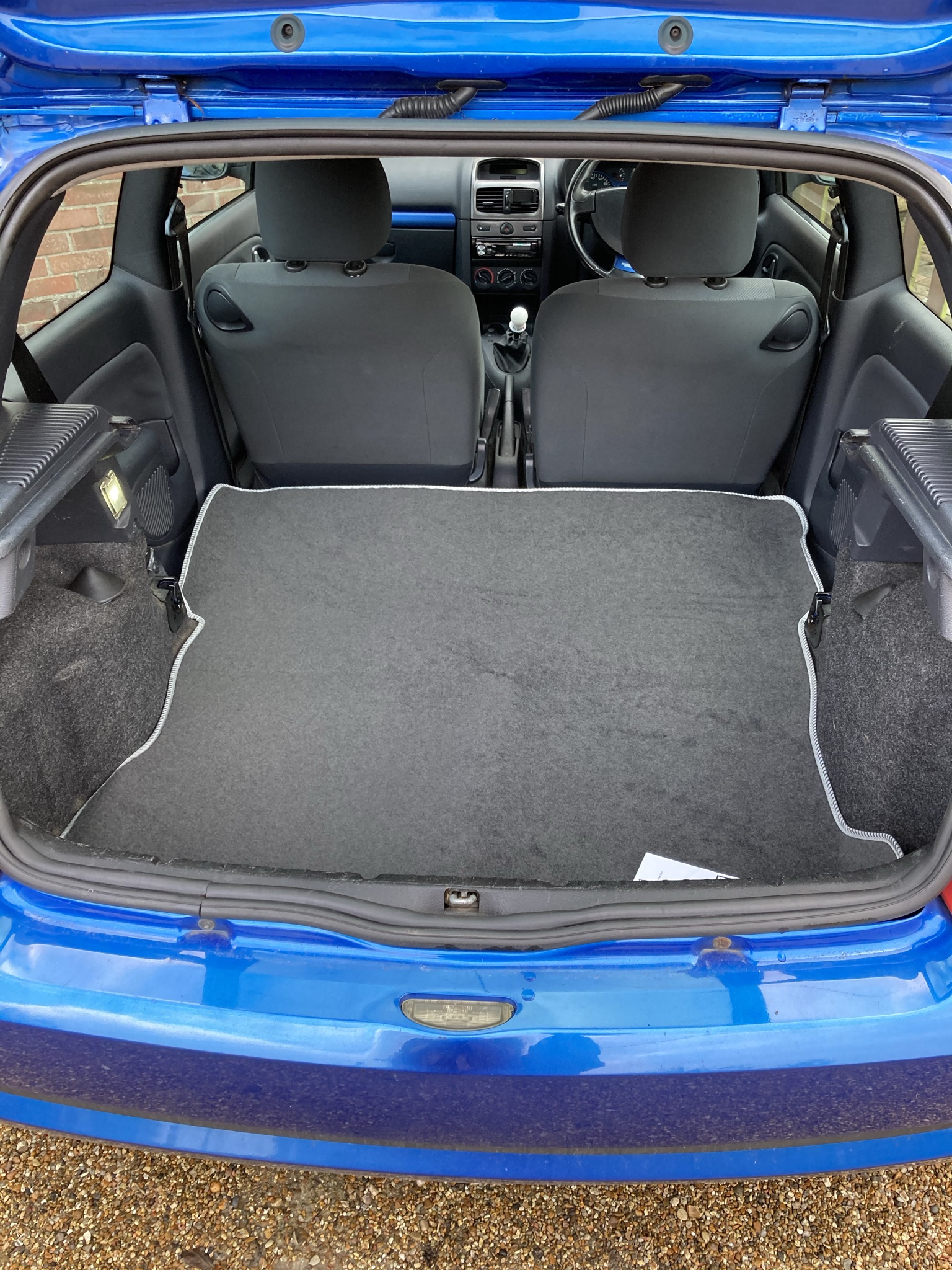

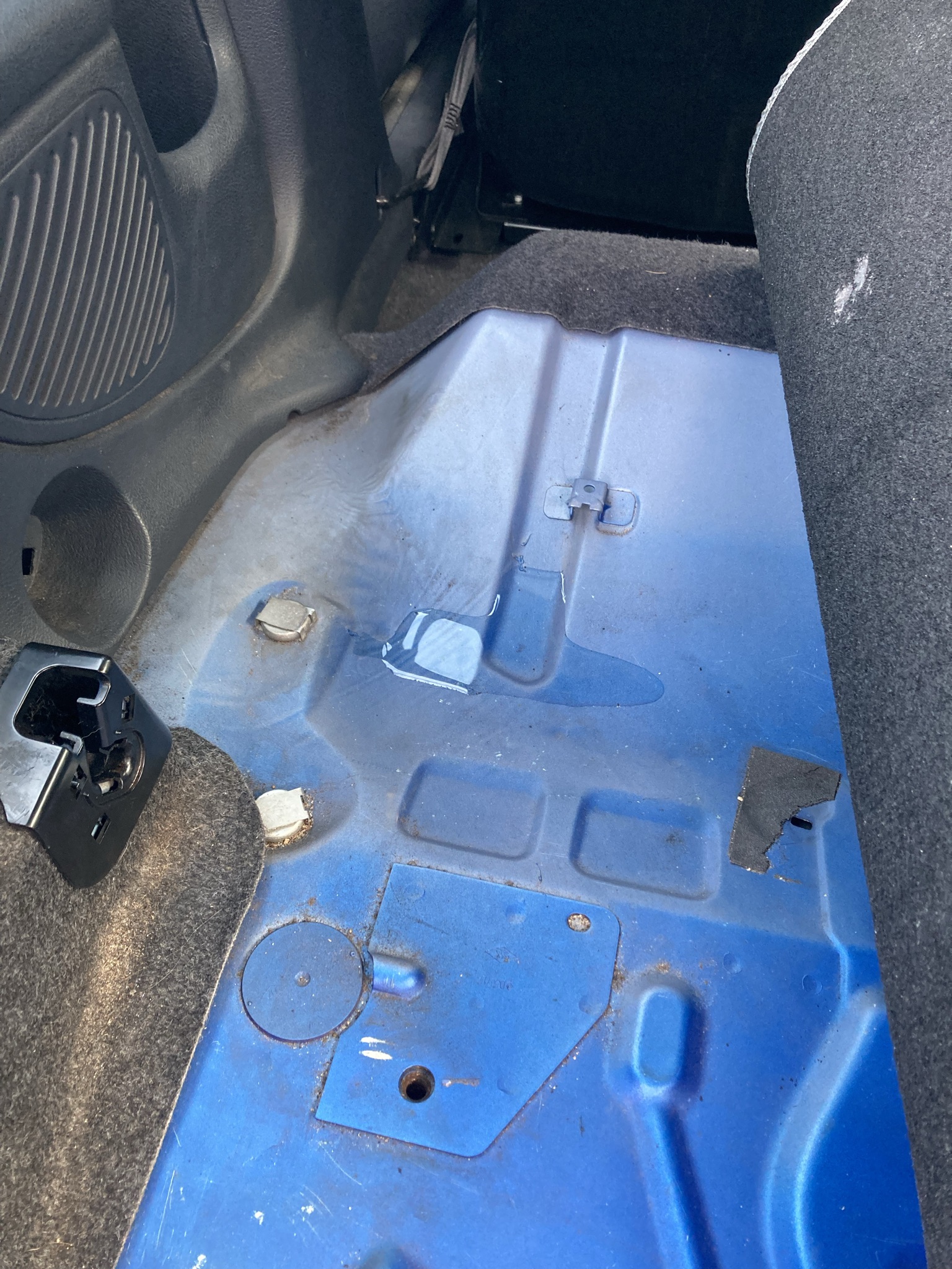

So the first thing I set about doing was removing the rear bench and covering the floor with a custom long boot mat I bought from eBay (chose the grey colour as it matches the interior carpets better than the black). As the car won’t be used for daily duties, this made sense as the rear seats were never used and it helped save a bit of weight.

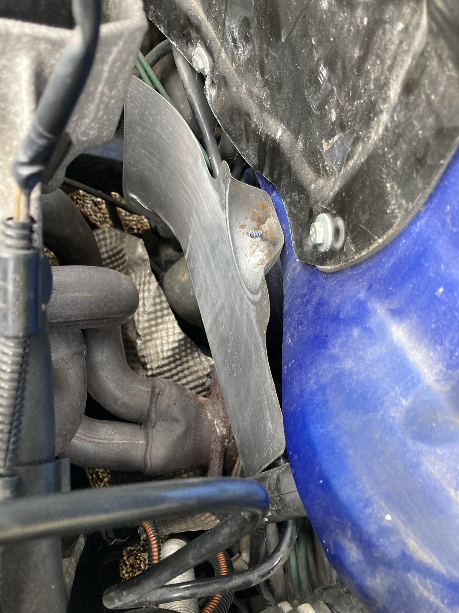

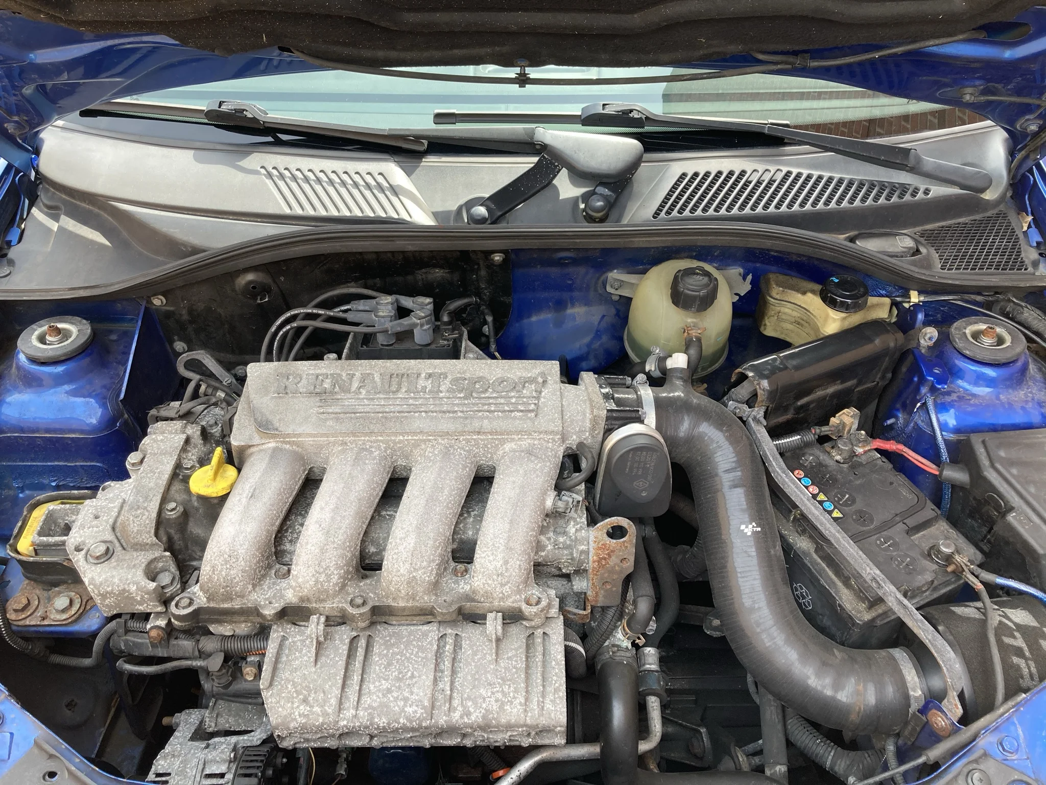

I was also lucky to source a 1.2 8V heat shield from a forum member. As I had previously removed the original engine bay heat insulation which was looking very tired, this was the perfect option as it keeps the oem look and is also functional.

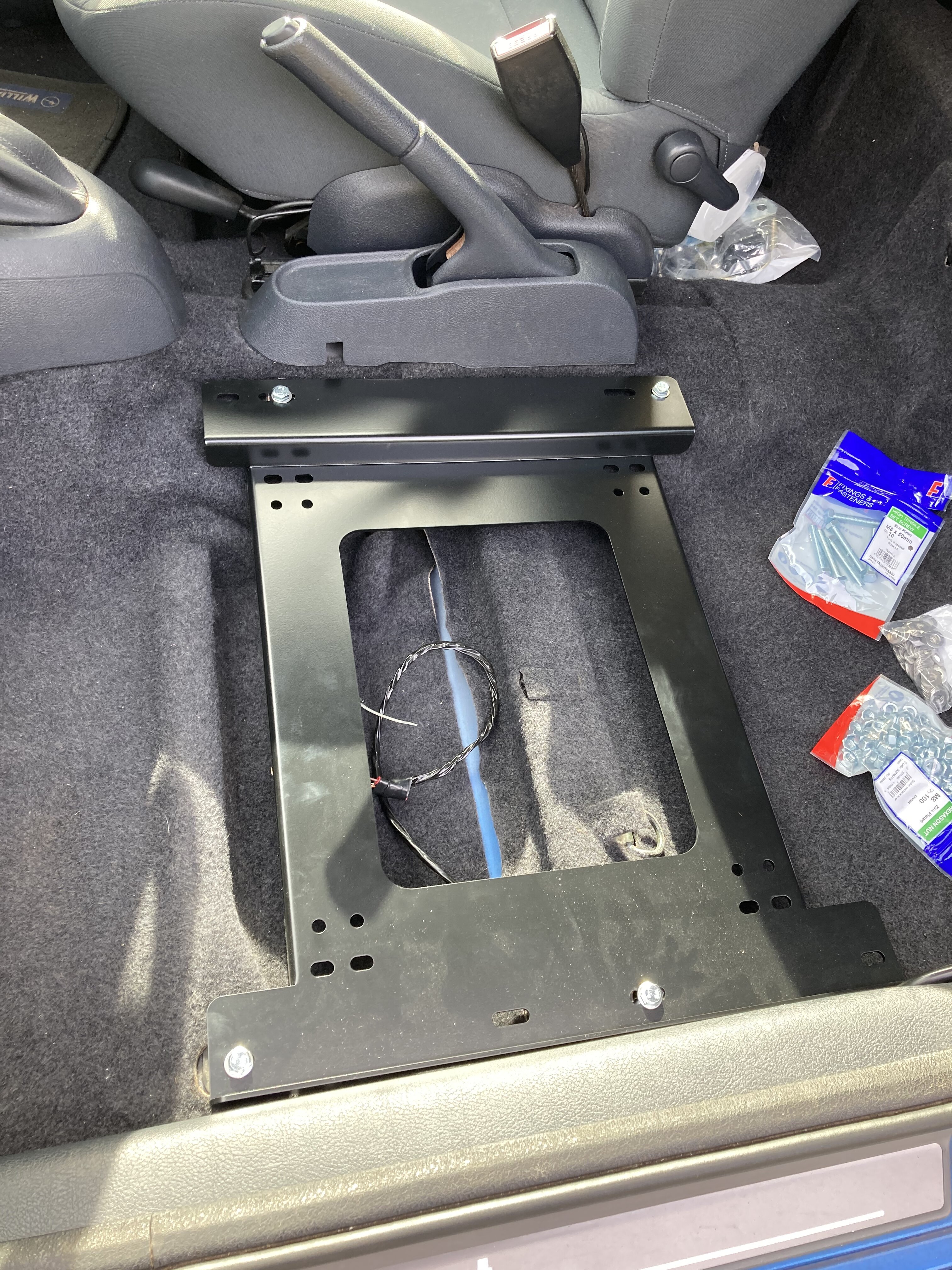

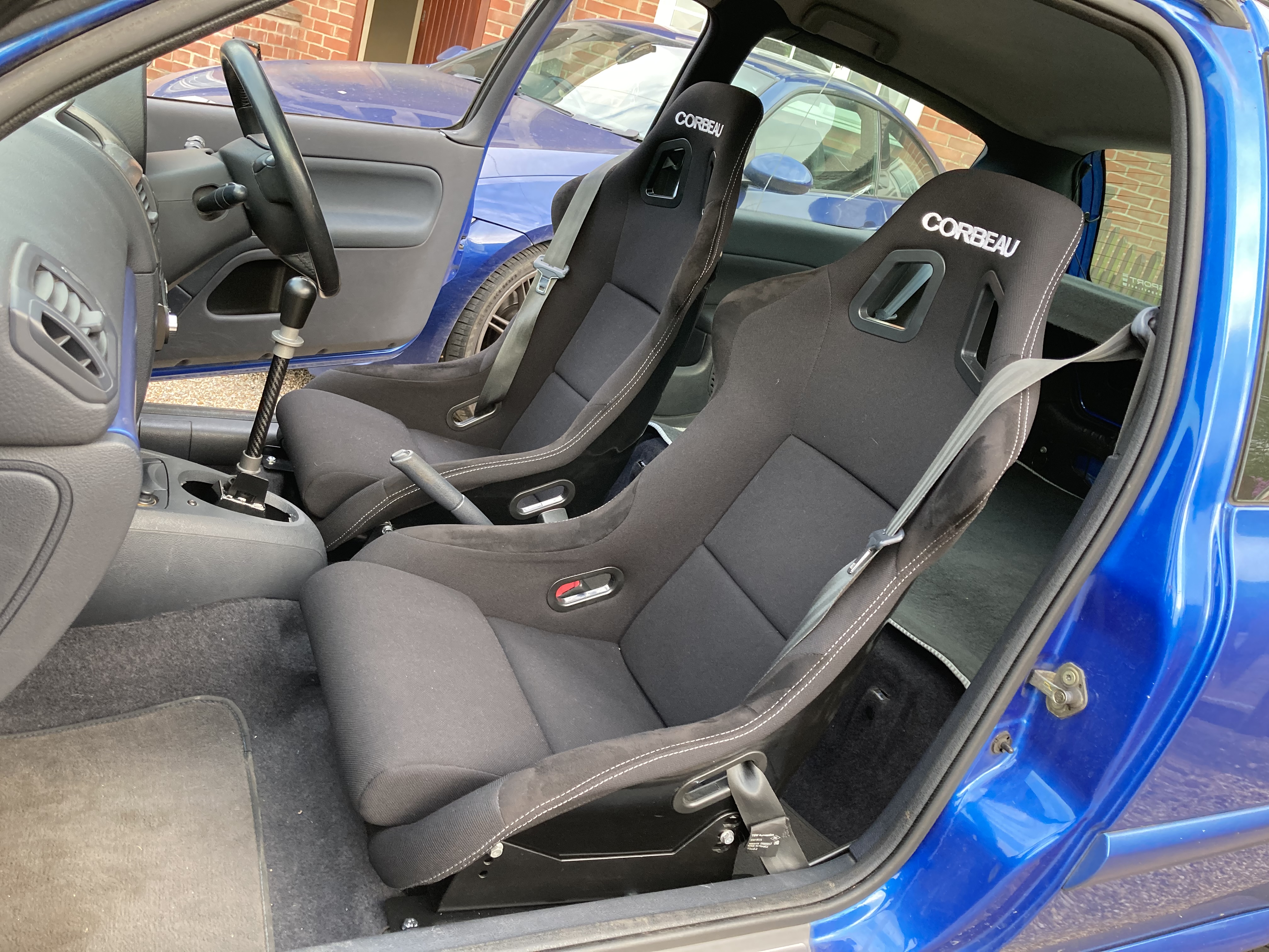

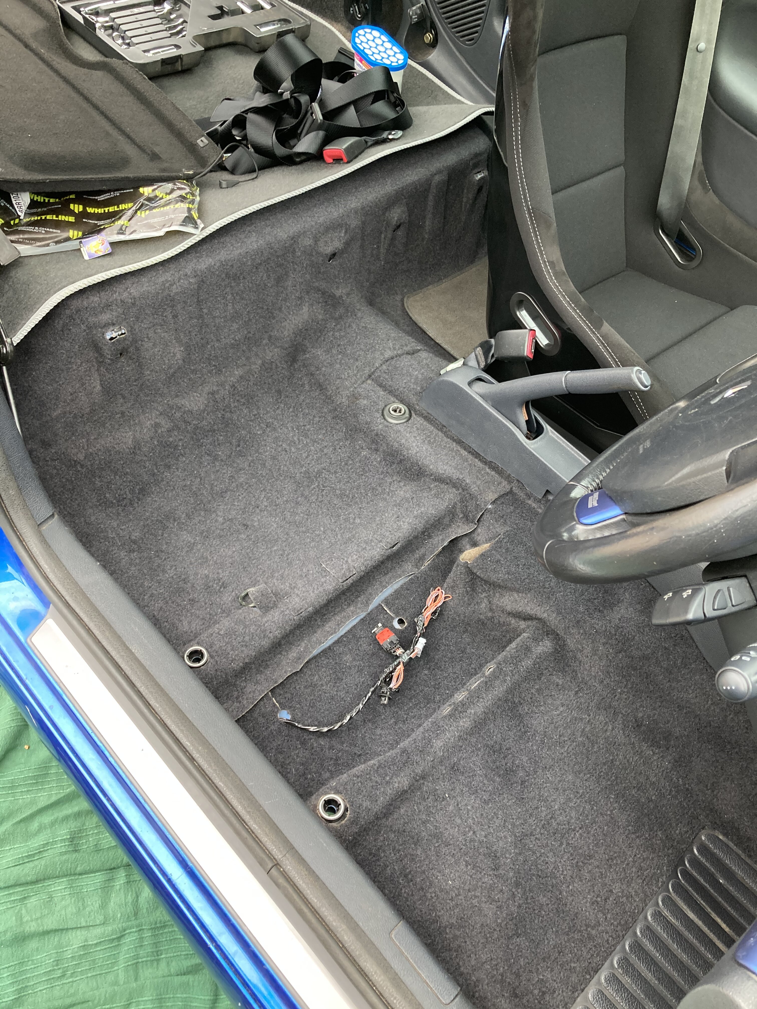

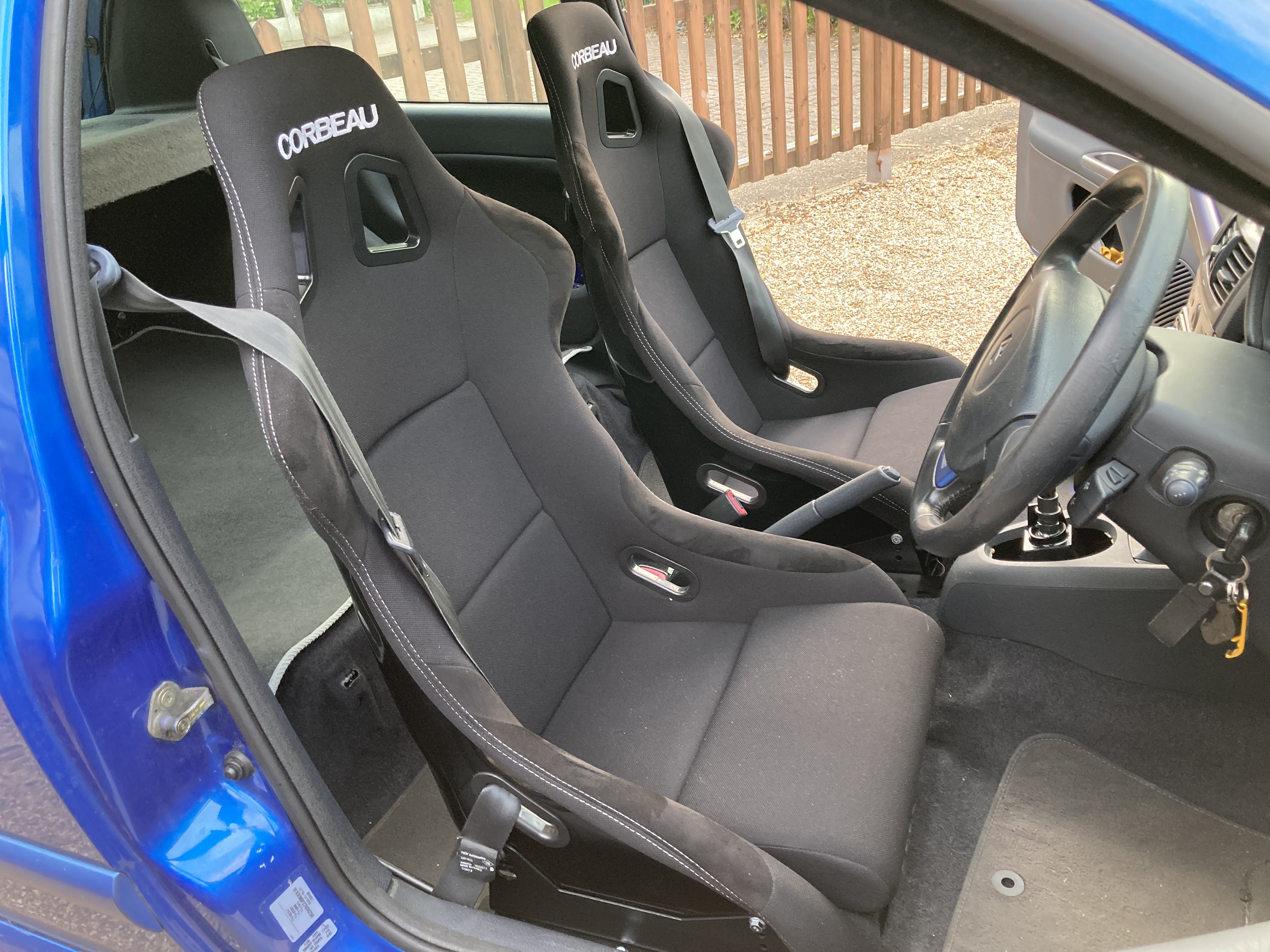

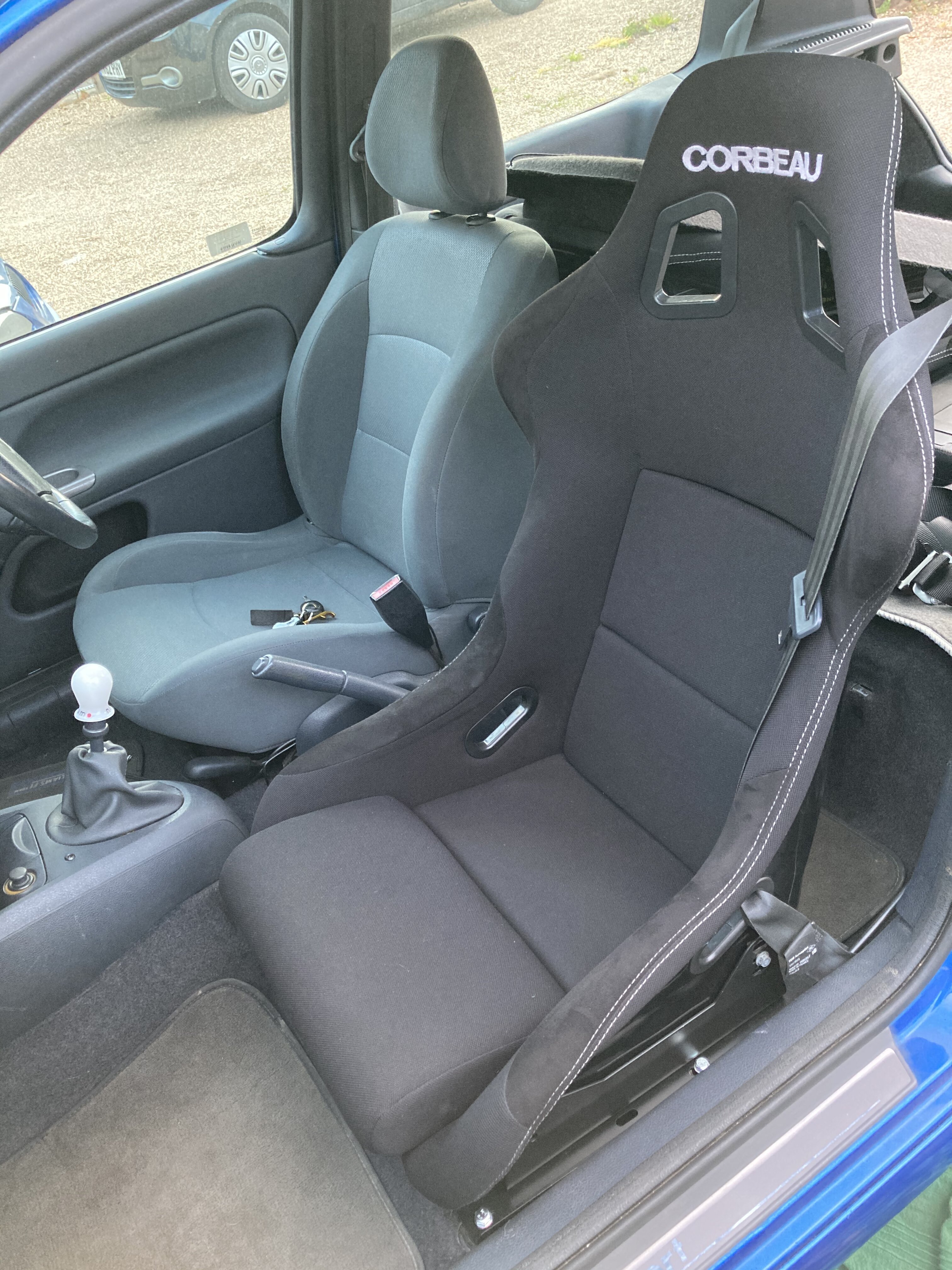

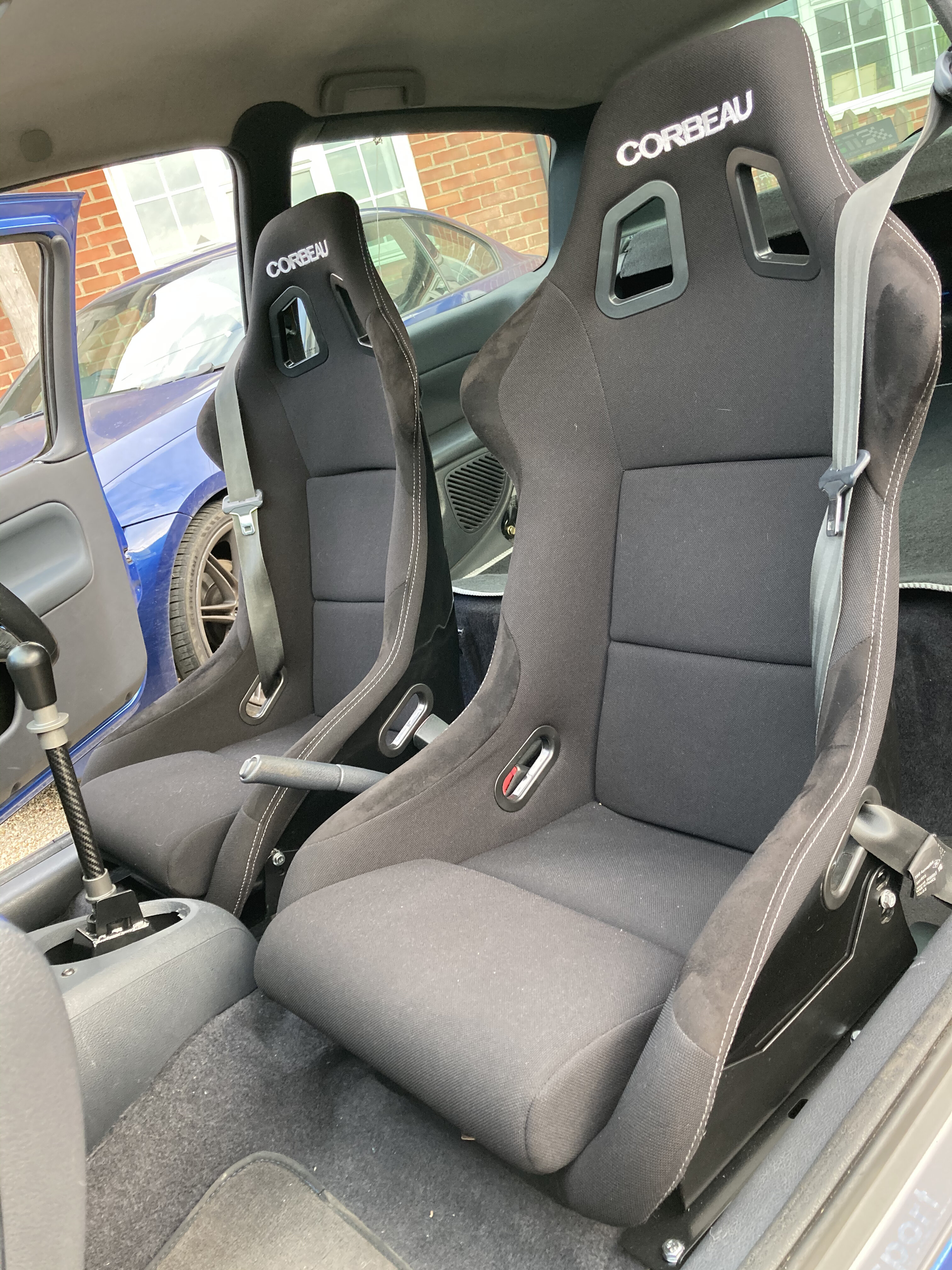

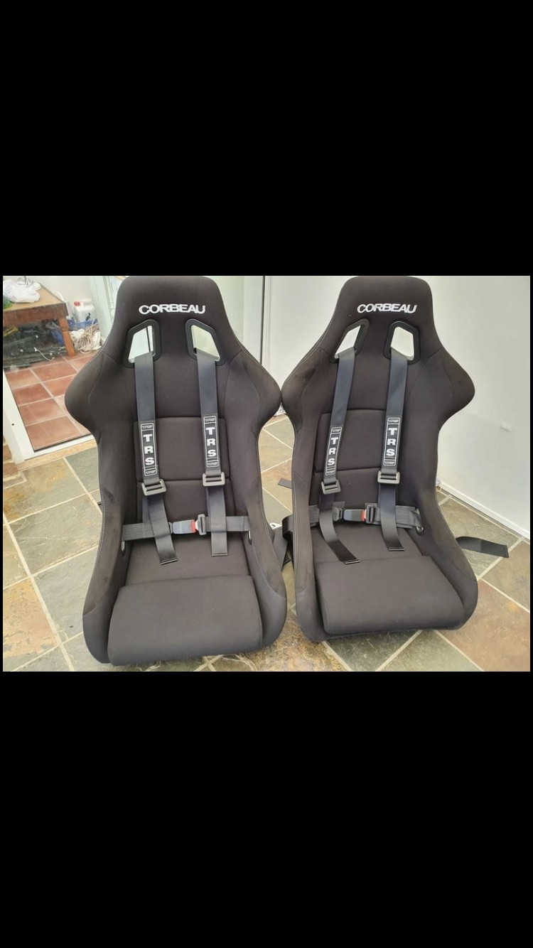

The first area I looked to improve were the front seats. I used to drive with them in their lowest height setting and even then it still felt like I was sitting on the roof so this needed to be addressed.

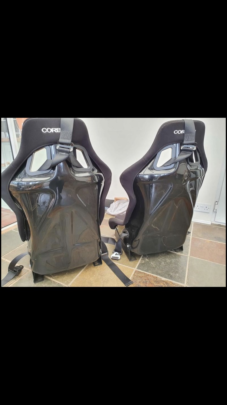

After a long hunt I managed to find a pair of Corbeau Clubsports on Facebook marketplace which were in immaculate condition. I then purchased a pair of Jon Foz’s X-Low subframes which I bought directly from him, to achieve the lower driving position I desired.
I began working on the passenger side - removing the original seat and runners by undoing the 4 bolts that are located underneath the car. I then cleaned the carpet before placing the Jon Foz subframe into position.
I then attached the side mount to the seat and loosely bolted the seat with the mount onto the subframe for a test fit.
Once I was happy with the seat position, I tightened up all the nuts and bolts and moved onto the drivers side.
Once again, the 4 bolts holding the seat into place were removed from underneath the car and the seat was removed, as well as the carpet cleaned.
The subframe was then installed and the seat was correctly positioned after a few test fits and the fixings were then fully tightened.

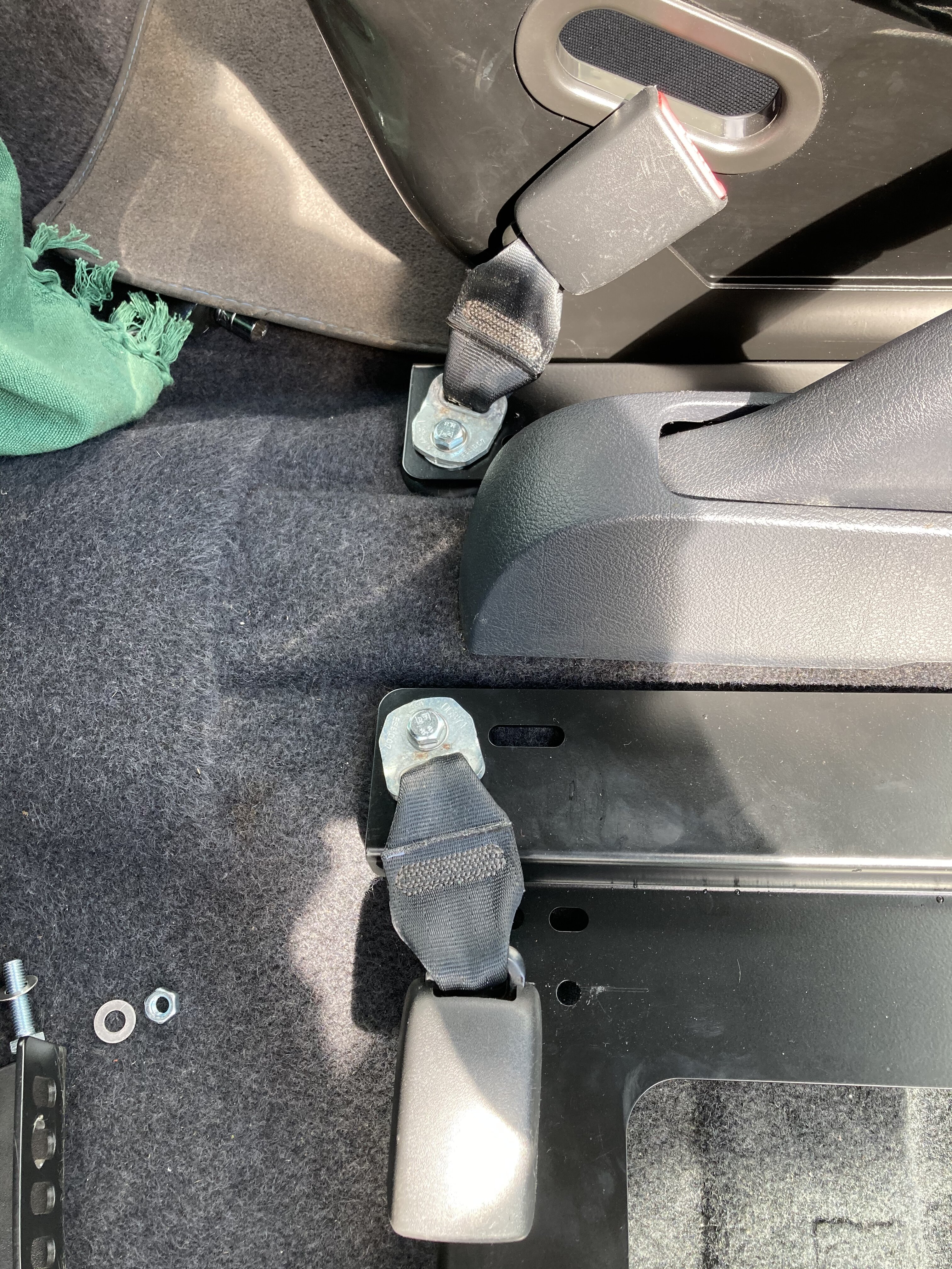

As the original seats had the seat belt retainers fixed to them, I used 2 Toyota Aygo seat belt retainers and fixed them to the subframes so that the original seatbelts could still be used.

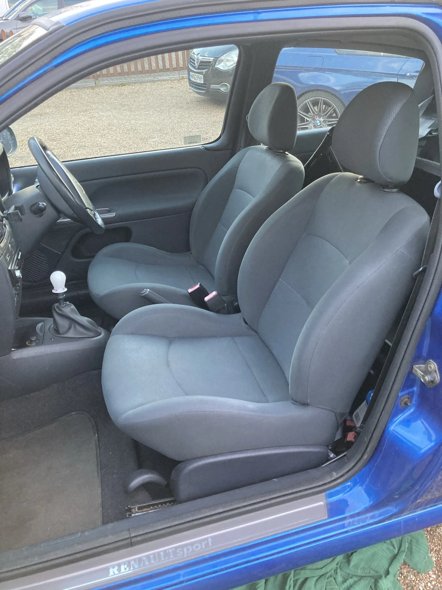

Before
After
This is by far one of the best modifications I’ve done so far as it completely transforms the driving experience. I’d highly recommend the Jon Foz subframes to anyone considering them; they are great quality and they actually sit flat unlike some other subframes out there. For anyone that’s interested in fitting them, I’ll post the list of fixings needed that Jon sent me.

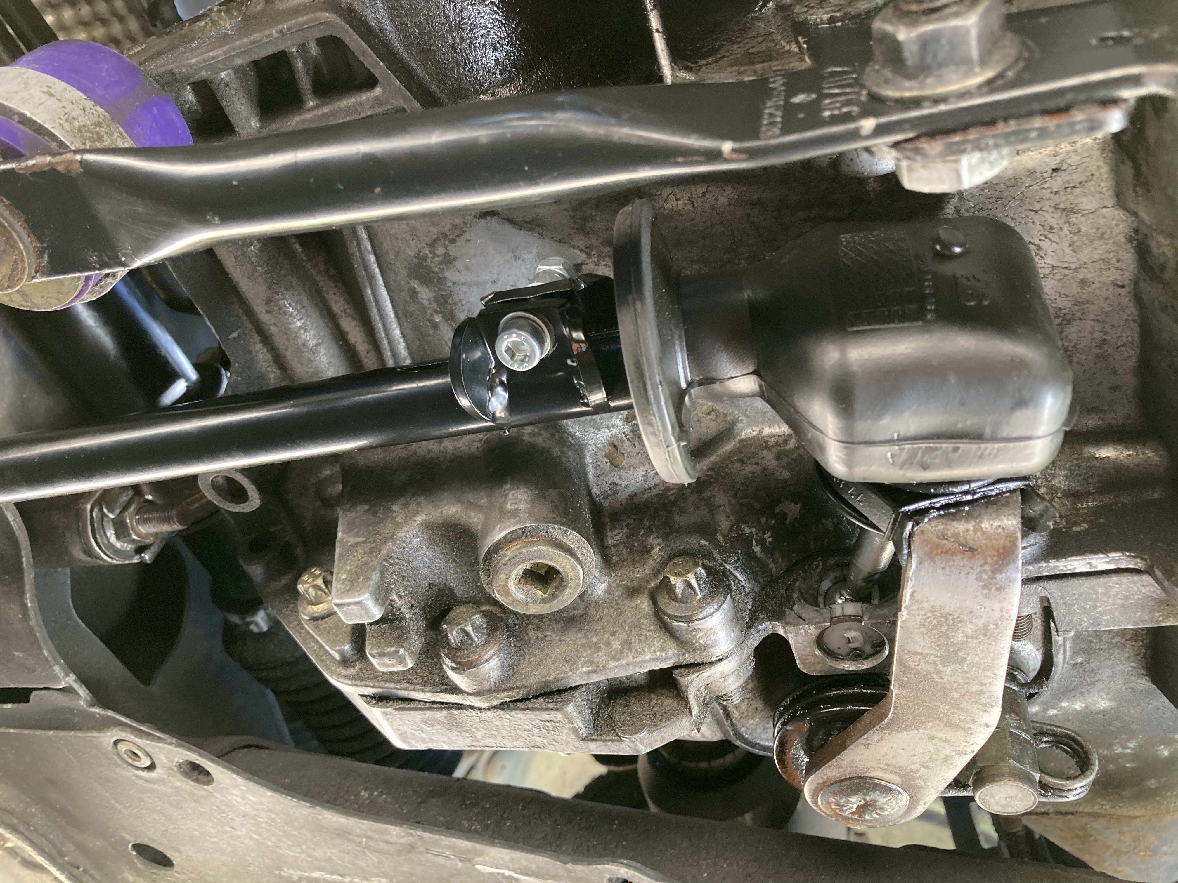

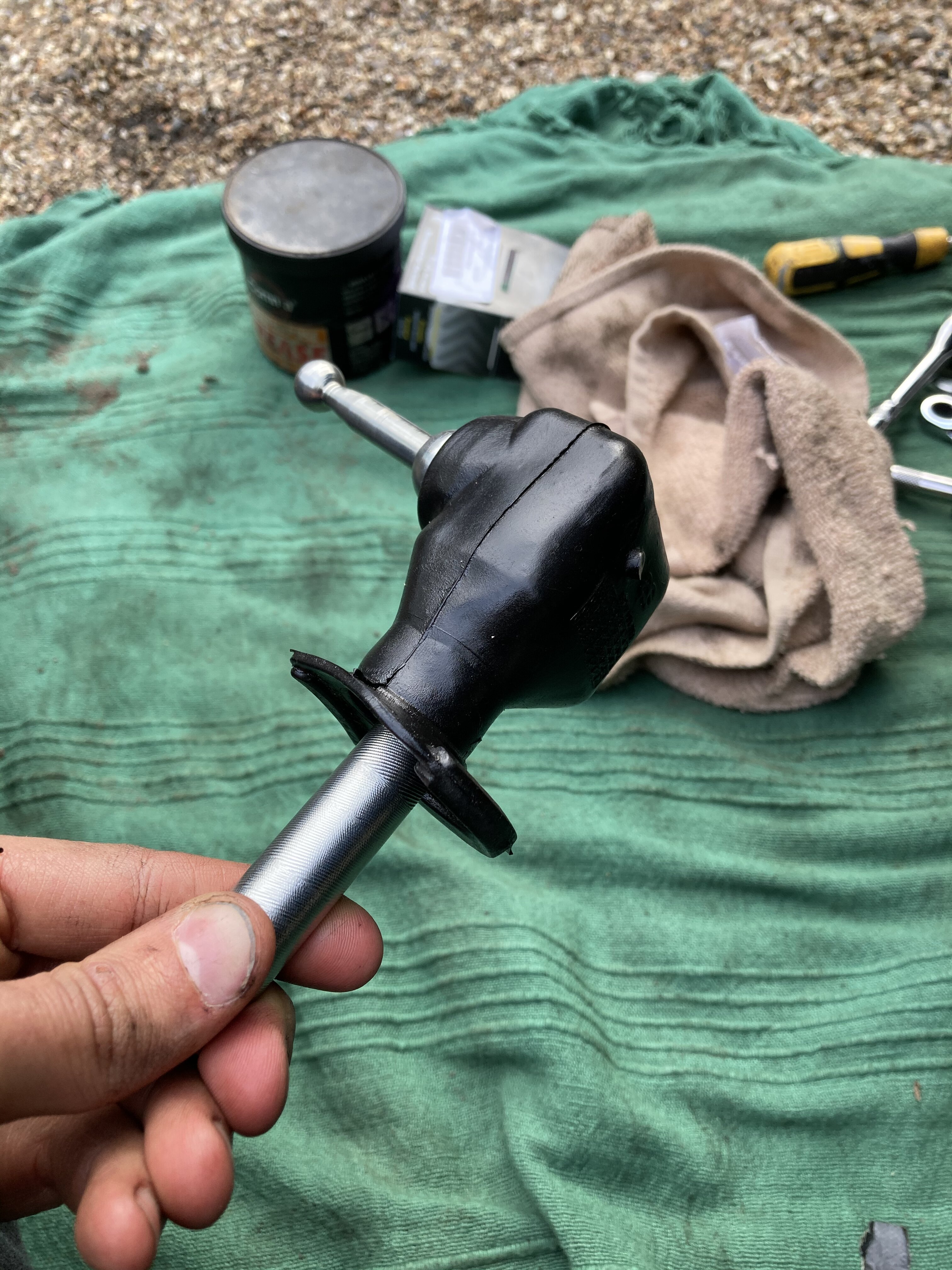

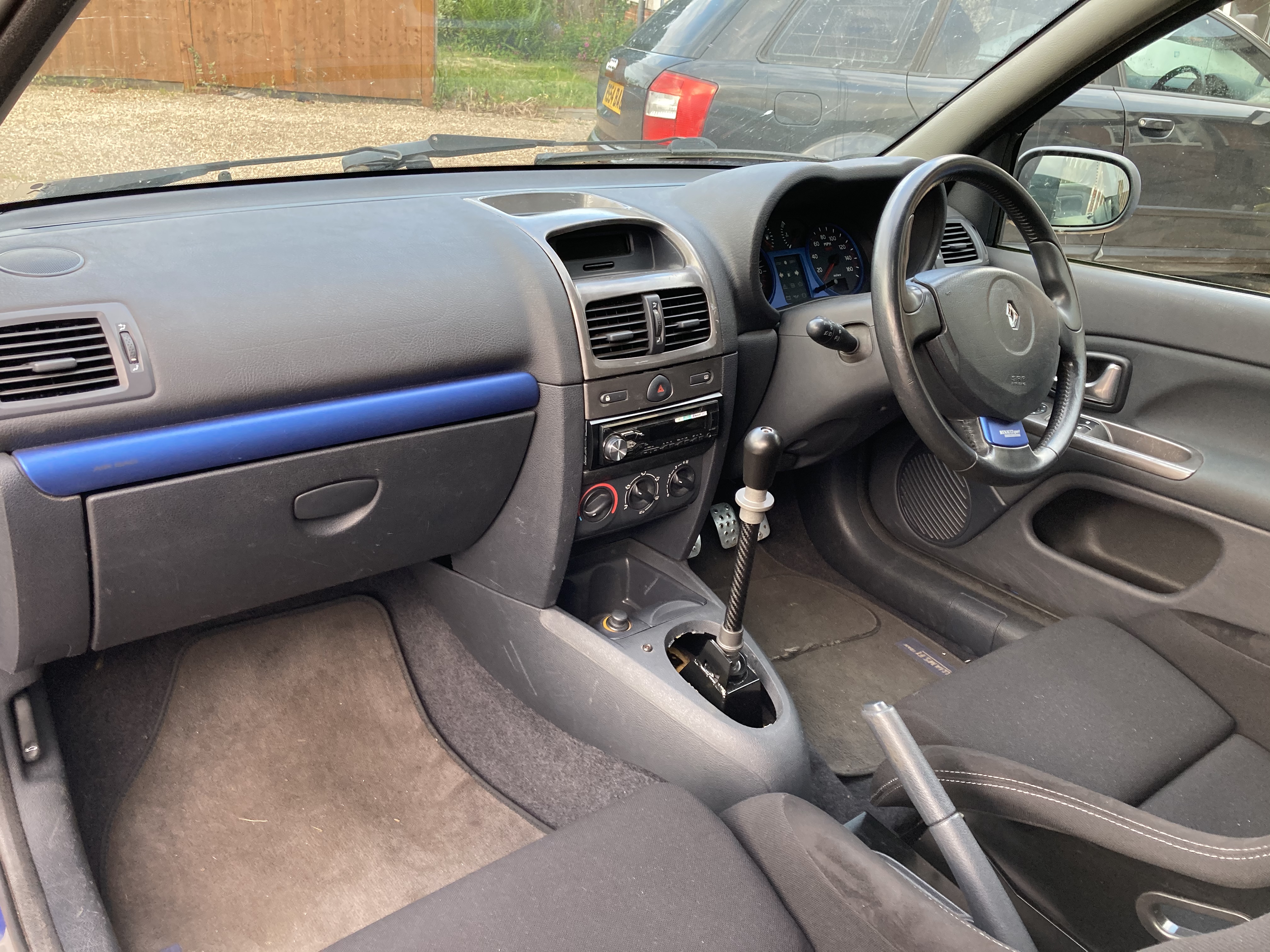

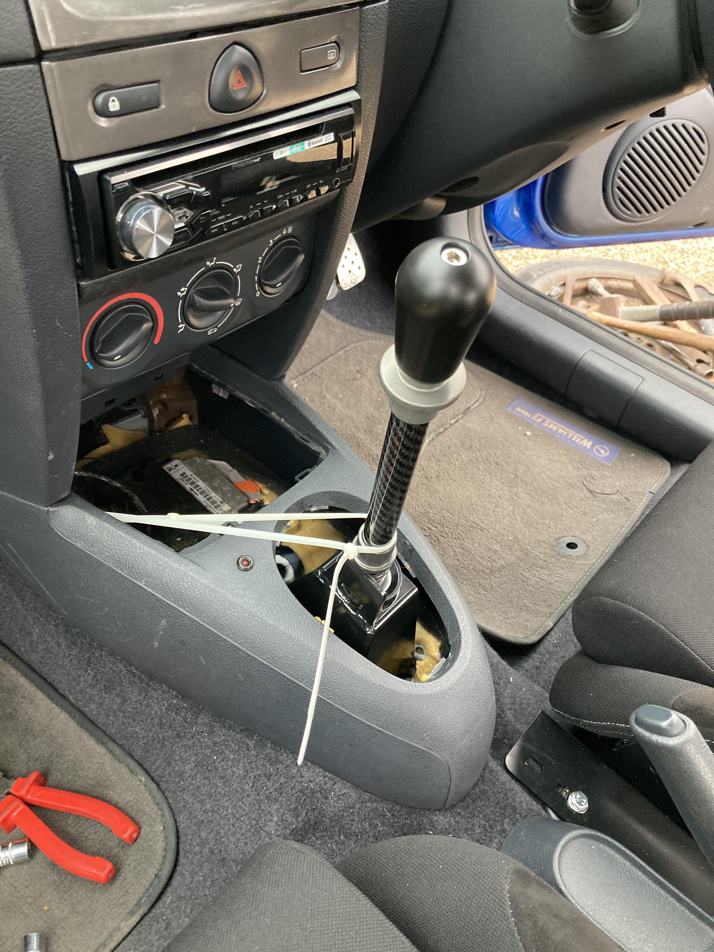

The next big mod I went on to fit in preparation for Anglesey was a PMS shifter. I wanted to do this as I’d heard they massively improve the gear shift and they are also less harsh on the synchromesh when driven hard. As second hand prices seemed pretty strong, I decided to order a new one from KAM Racing as it was not a great deal more to pay and it was also more convenient as they offer next day delivery.

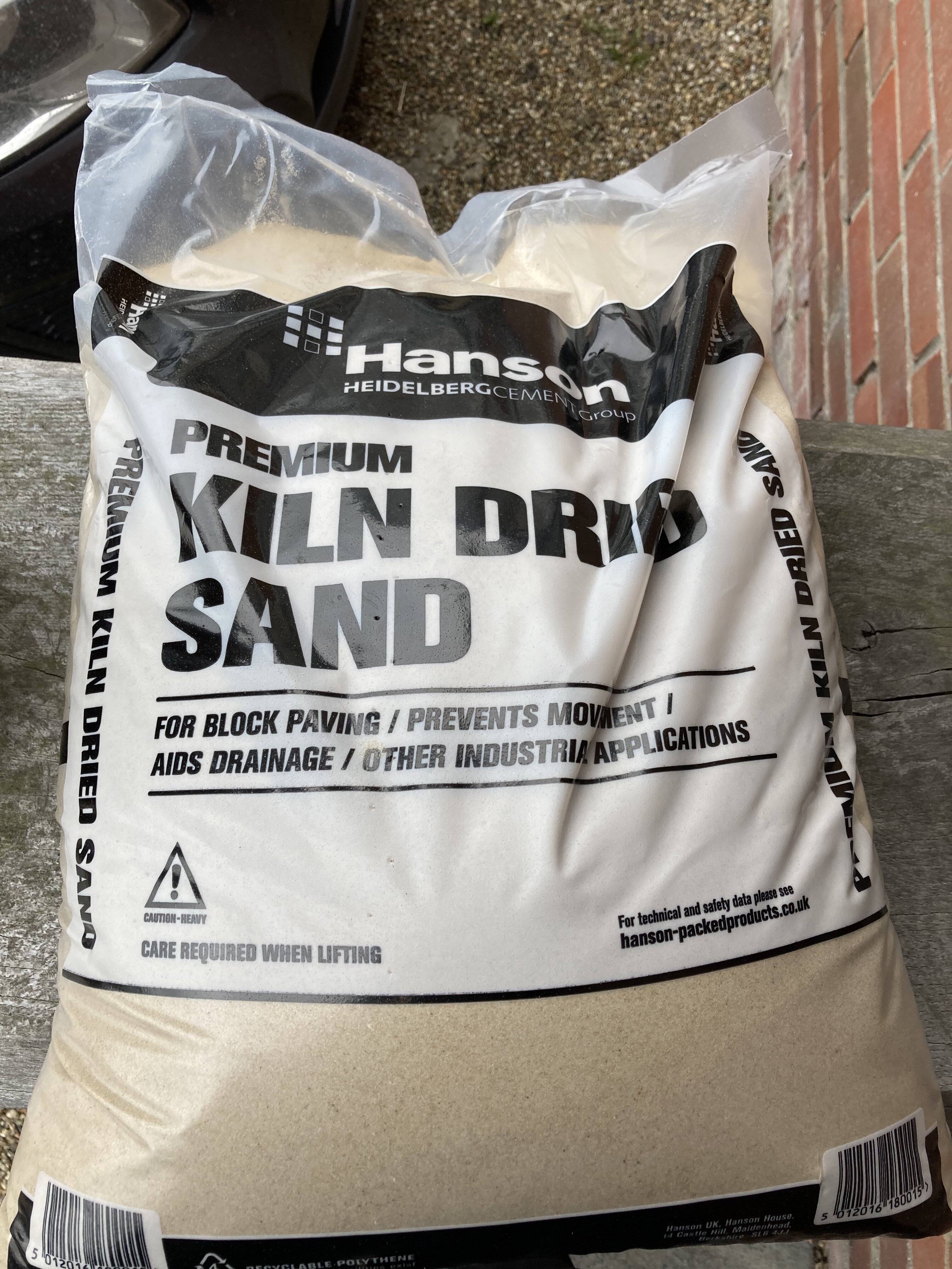

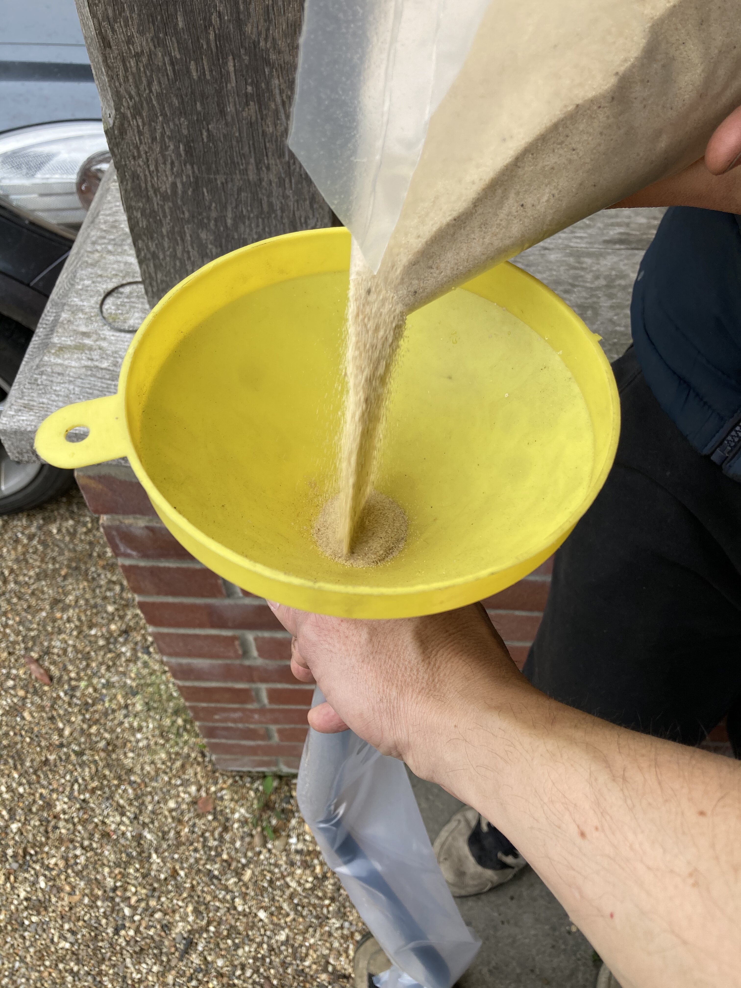

Before carrying out the installation, I did a few things to try and limit the amount of vibration I would experience with the shifter. First of all was to use the original rubber gaiter with the PMS front pivot arm which I packed with grease. I’ve heard this can slightly limit vibrations and as it would also keep the dirt away I thought it was well worth fitting.

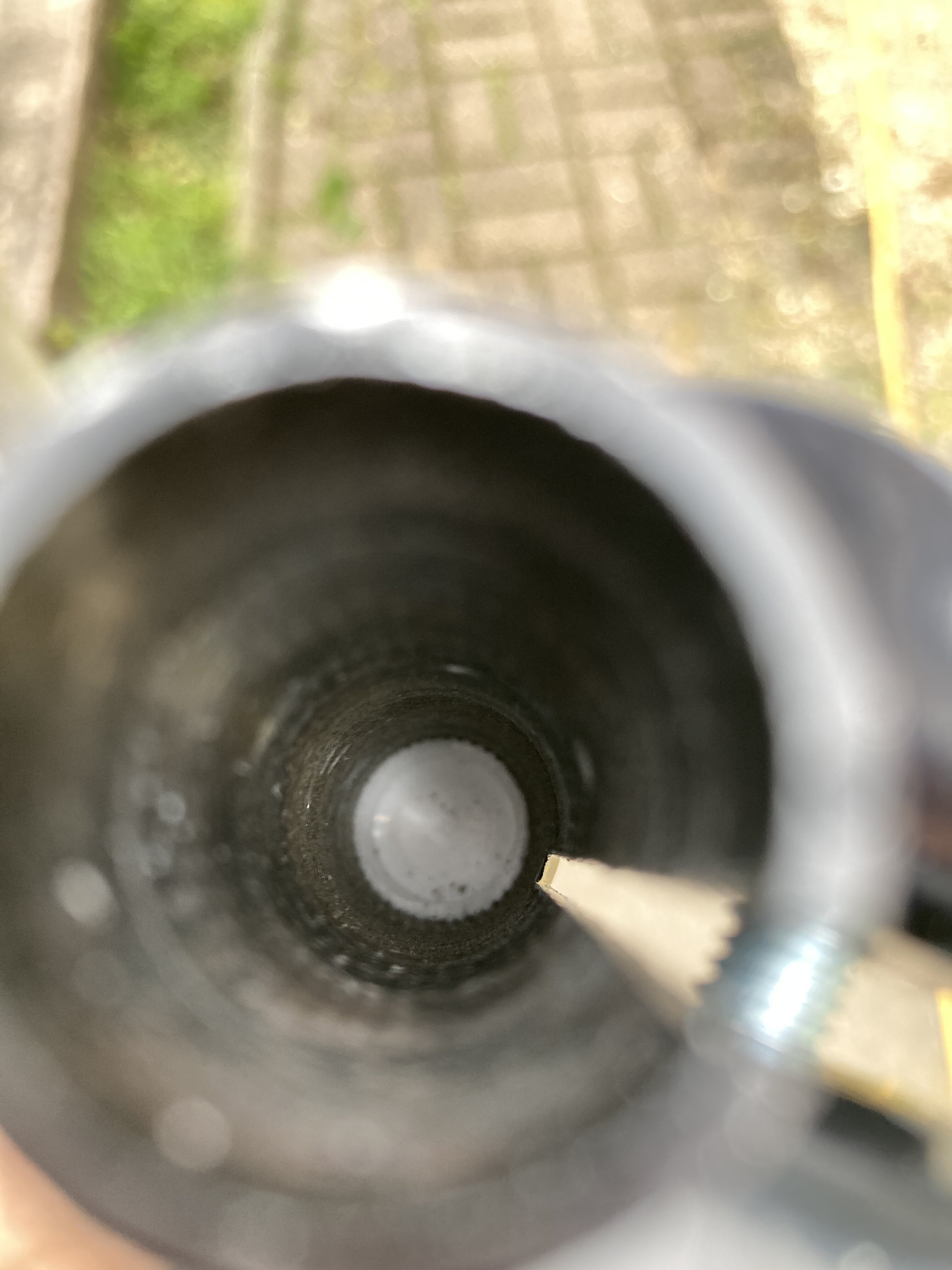

I then decided to fill the linkage rod with kiln dried sand as it would hopefully absorb and kill most of the vibrations.
To prevent sand from pouring out of the linkage rod when in use, I ended up cutting a toothpaste lid in half and pushing down the linkage rod until it met the top of the sand and created a seal :ROFLMAO: This actually worked perfectly due to the tapered shape of the toothpaste lid.
Installing the PMS shifter was a pretty simple procedure - just unbolt and drop the old shifter and remove the linkage from the gearbox, and then bolt in the PMS shifter and connect the front pivot arm to the gearbox with a nylon bush and a circlip. Then all that needs to be done is to attach one end of the linkage rod to the end of the shifter and then connect the opposite end to the front pivot arm. The hardest part of the whole process was setting up the shifter. I think I must have spent well over an hour adjusting where the linkage rod connected to the front pivot arm in order for the shifter to properly engage through all gears. I ended up cable tying the shifter permanently into reverse gear as I found this was the best way to find the optimum position.
Some pics after the install was complete.

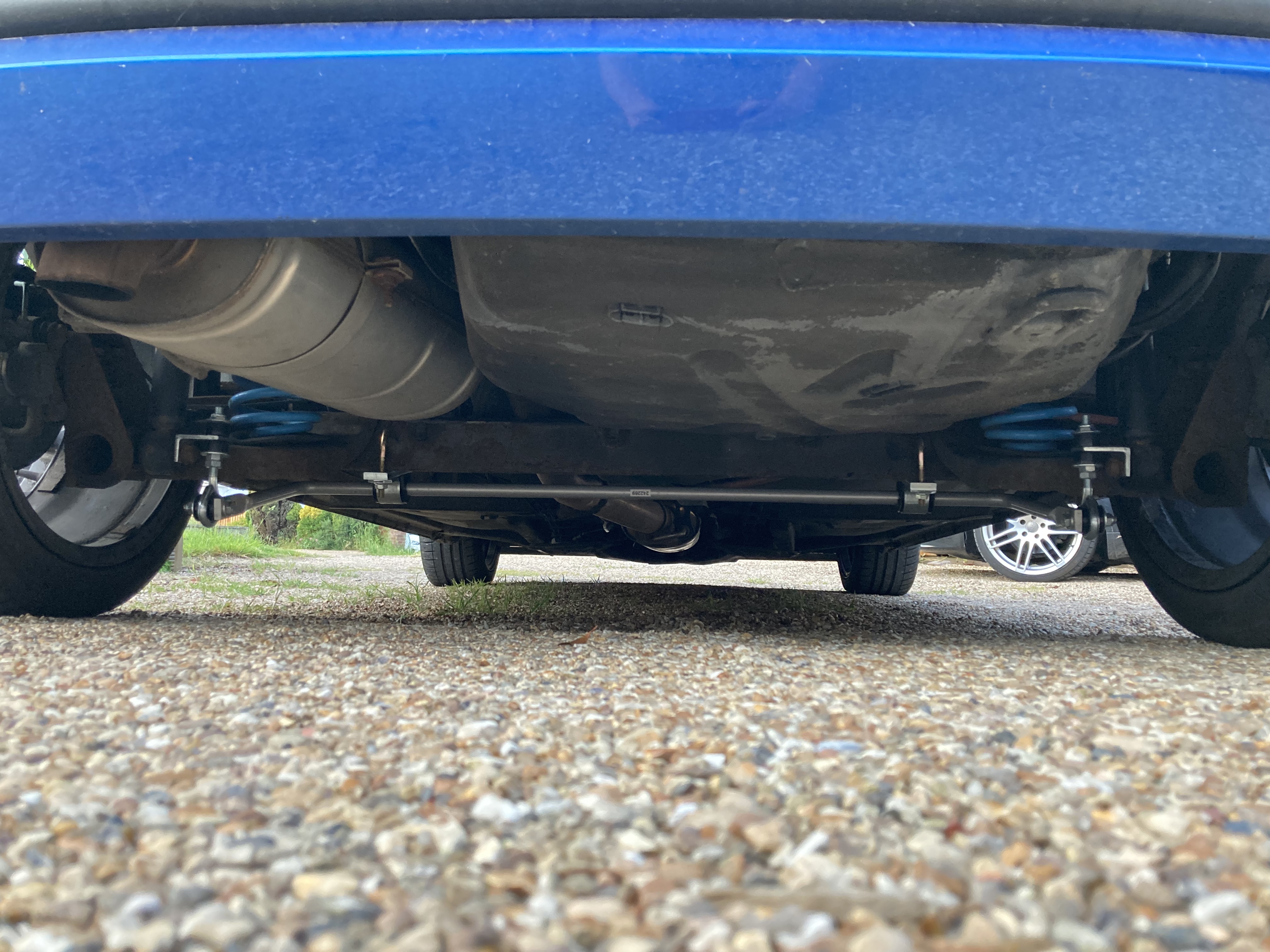

To finish it off, I then installed a Whiteline rear anti roll bar that I had bought second hand from a member on the Clio Sport Facebook group. As this was the first time I’ve used an upgraded anti roll bar, I set it to the softest setting to see how I get on with it.

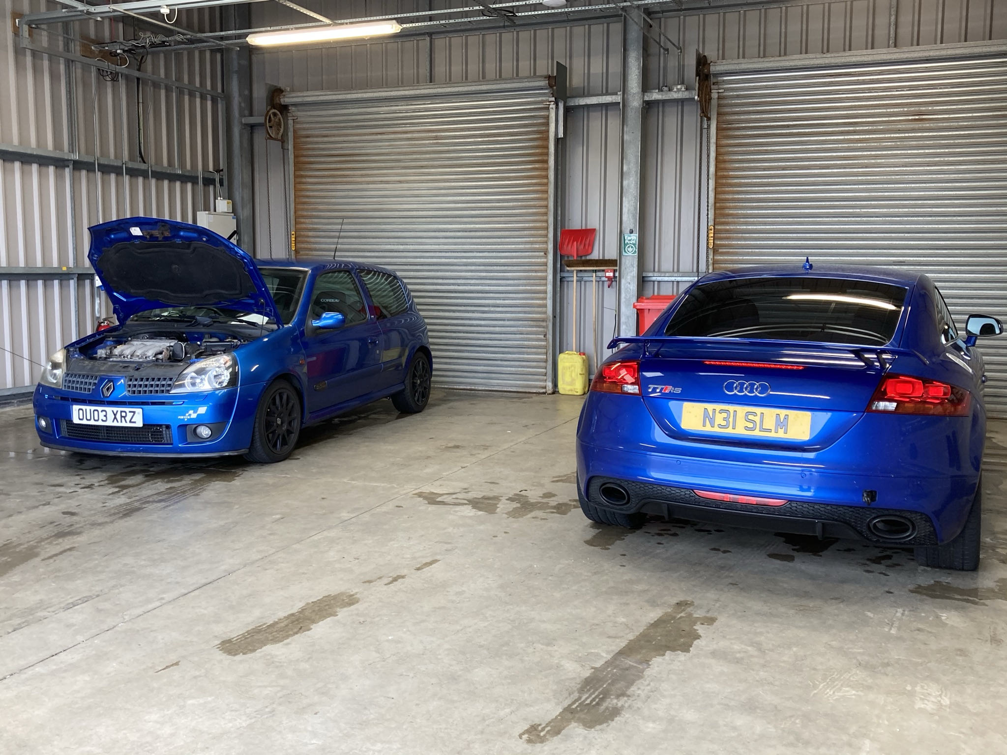

At this point the car was fully ready for the Anglesey track day.
I decided to drive the Clio up there from Essex (will definitely not be doing that again) 😭 The journey ended up taking us around 6/7 hours with a few stops so I was glad we’d booked a hotel to stay the night before the track day.
Was in good company when I eventually arrived.
Unfortunately these are the only pics I took on the day but I can happily say that I will definitely be doing plenty more track days in the Clio. Coming from a karting background I was hugely impressed with how you can throw these things about and as the track was wet I had it sideways on plenty of occasions (probably due to the anti roll bar). The track was also brilliant - the tight and twisty corners were great fun and the views were insane being right on the coast!

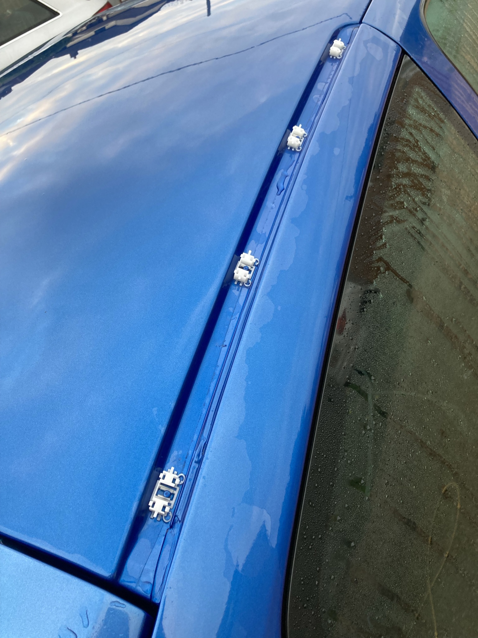

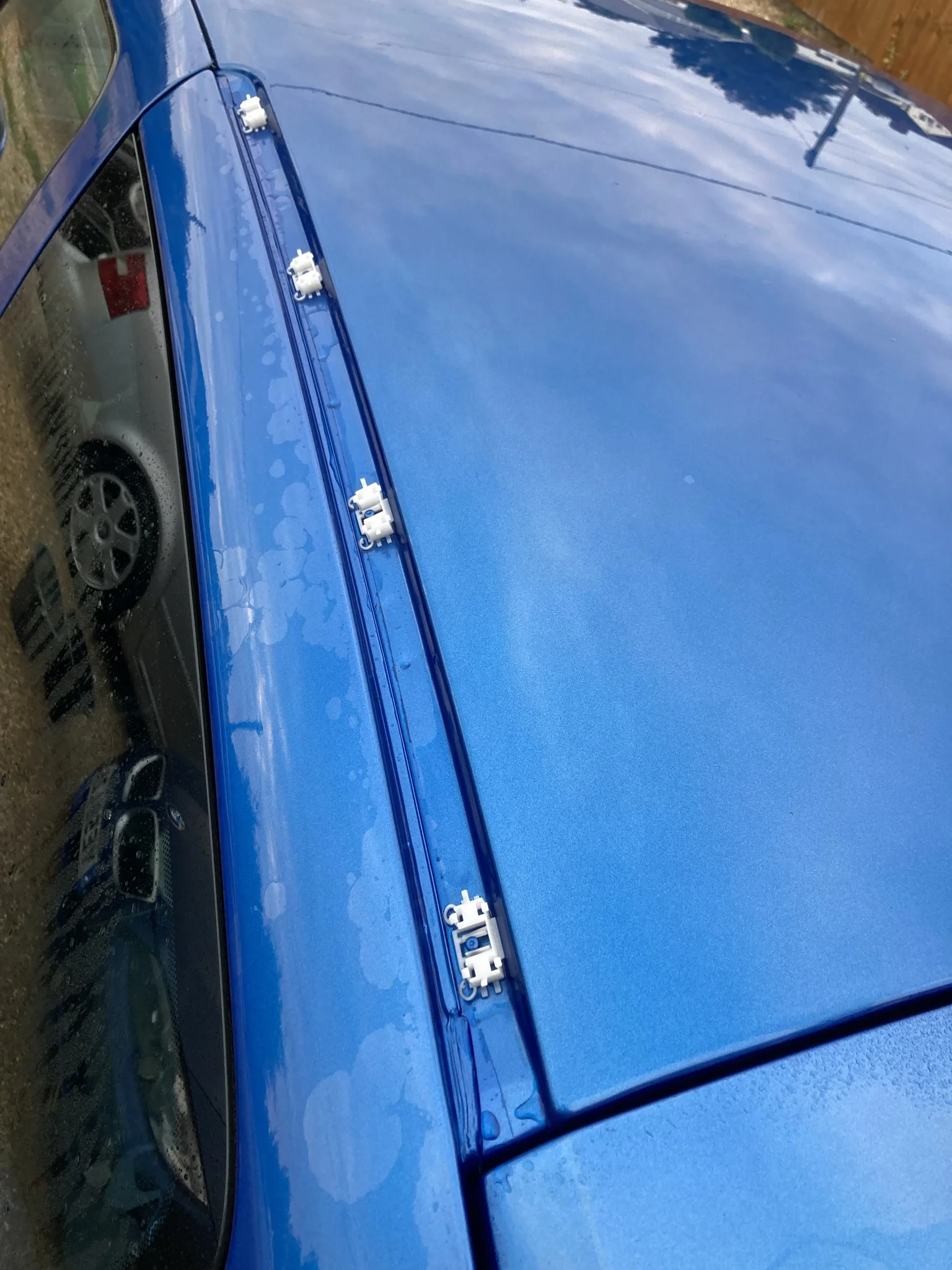

Took these off and cleaned all the crap out.

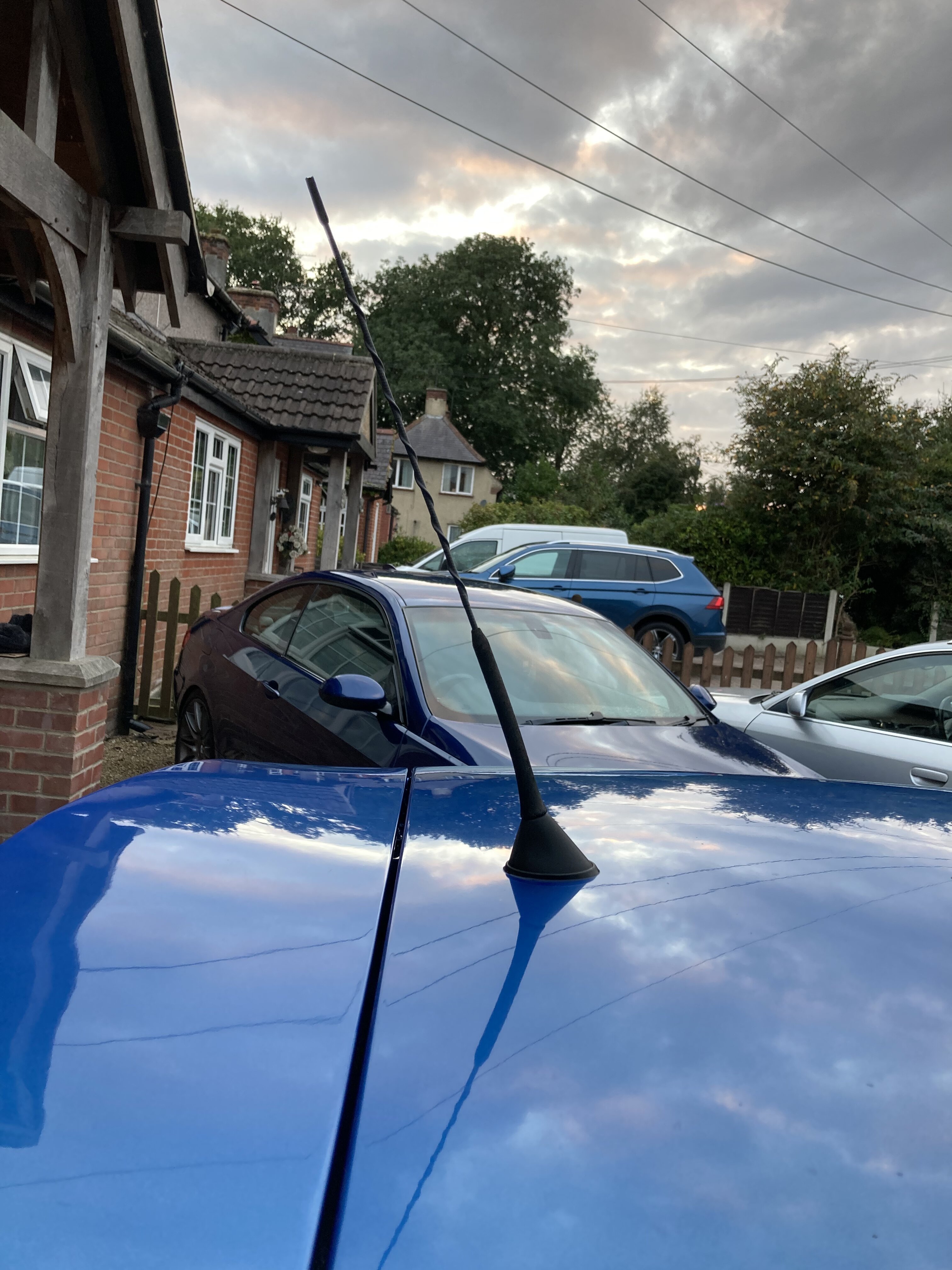

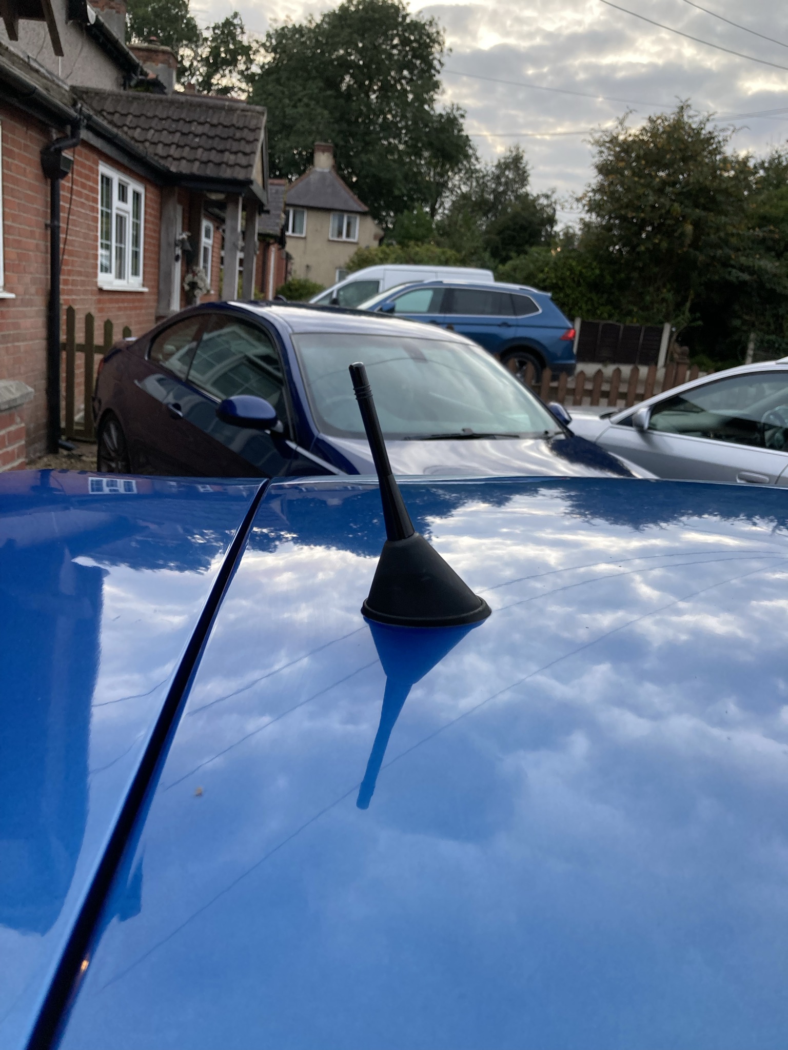

Fitted a stubby aerial - looks so much better than the old one!

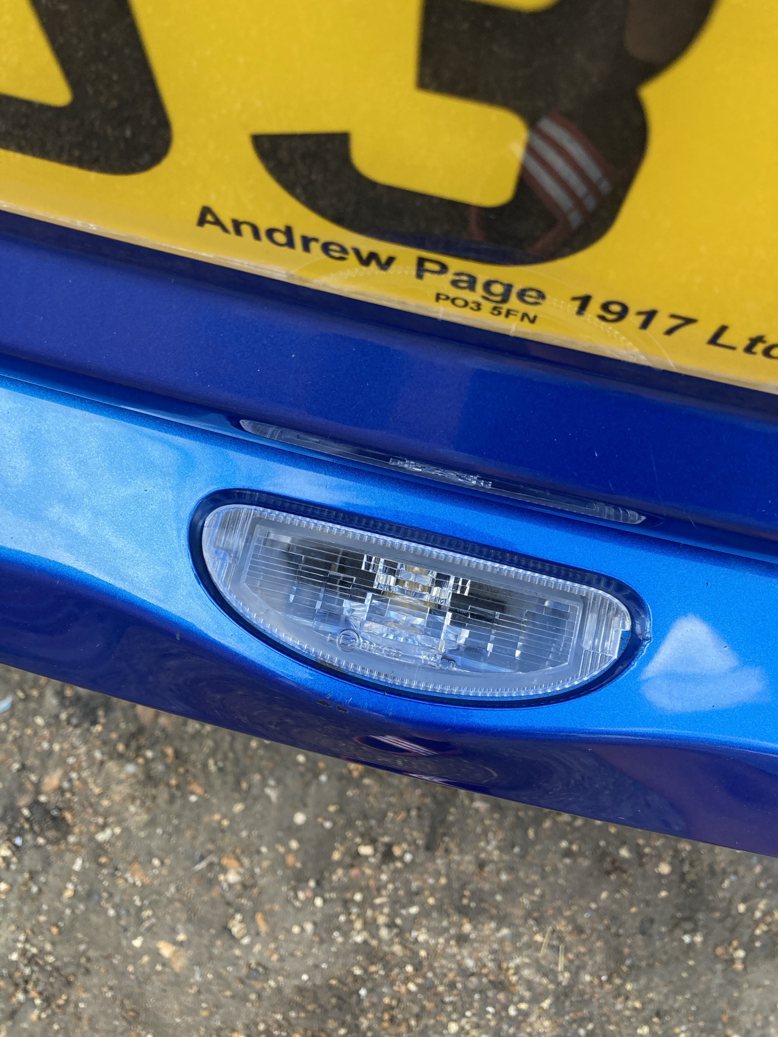

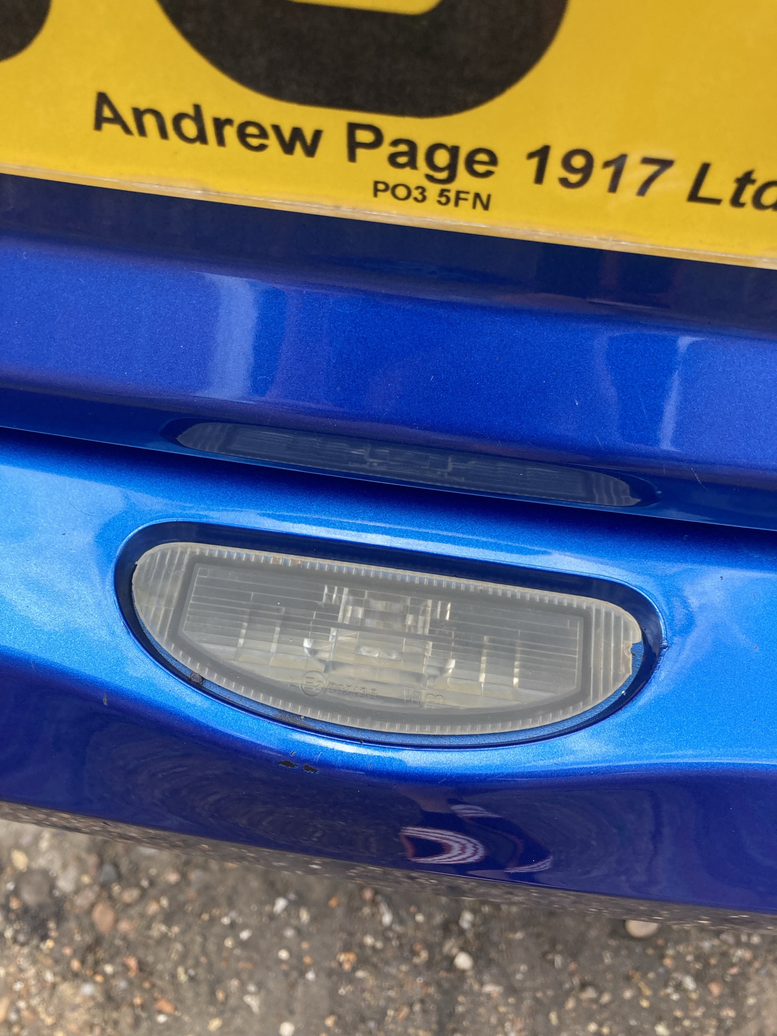

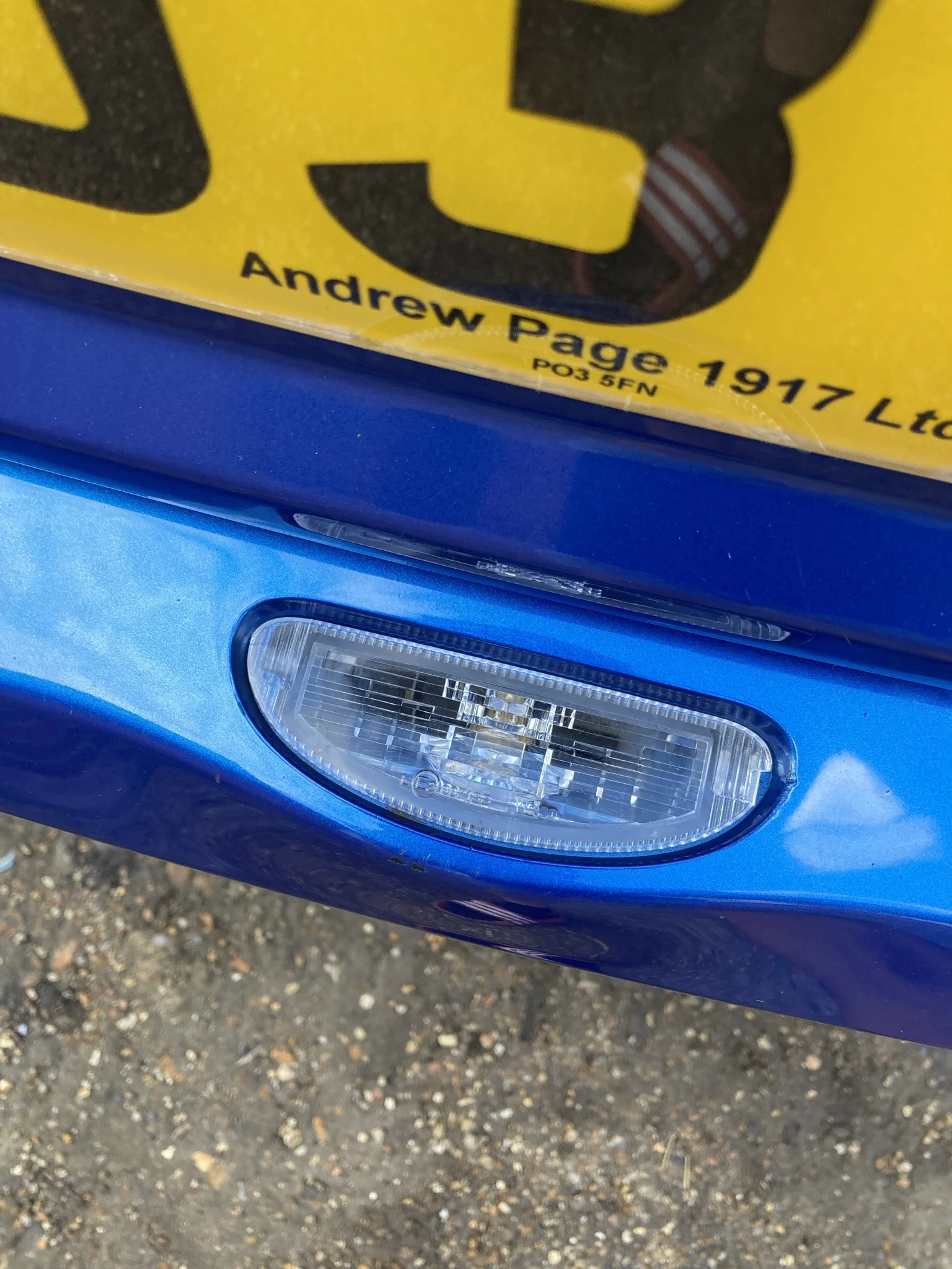

Also replaced the old number plate light lense for a fresh item.

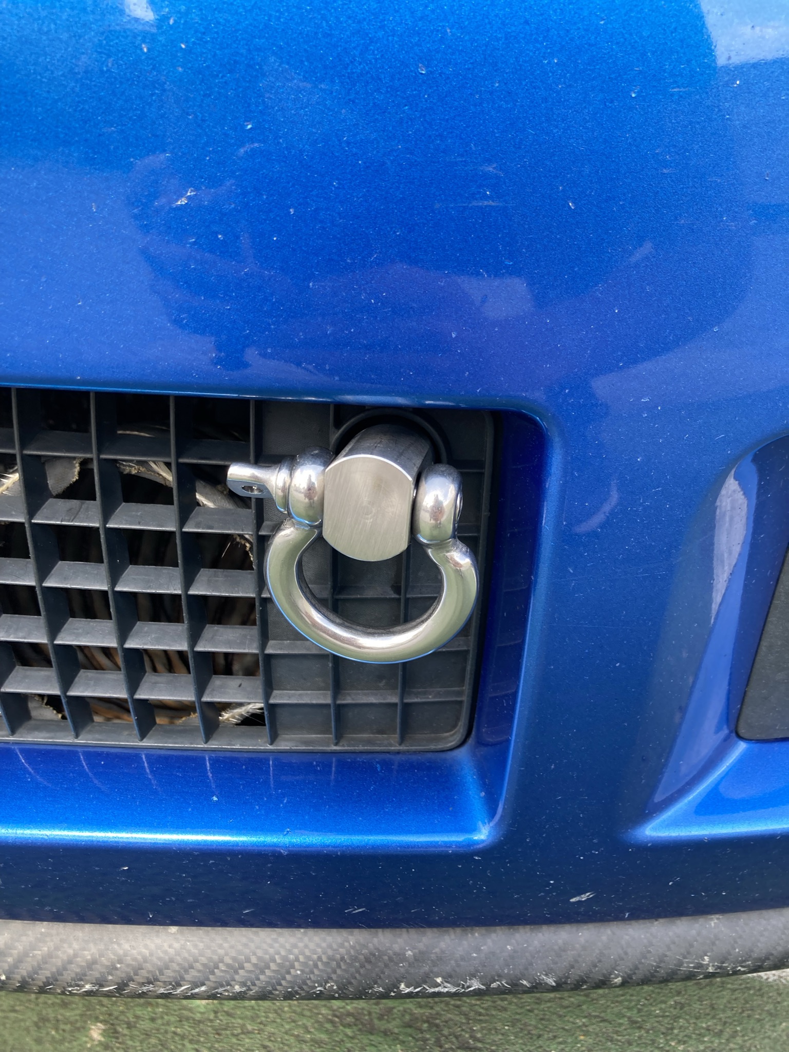

I also fitted a M.A.D Designs towing eye. These are great quality items and really smartens up the front end.

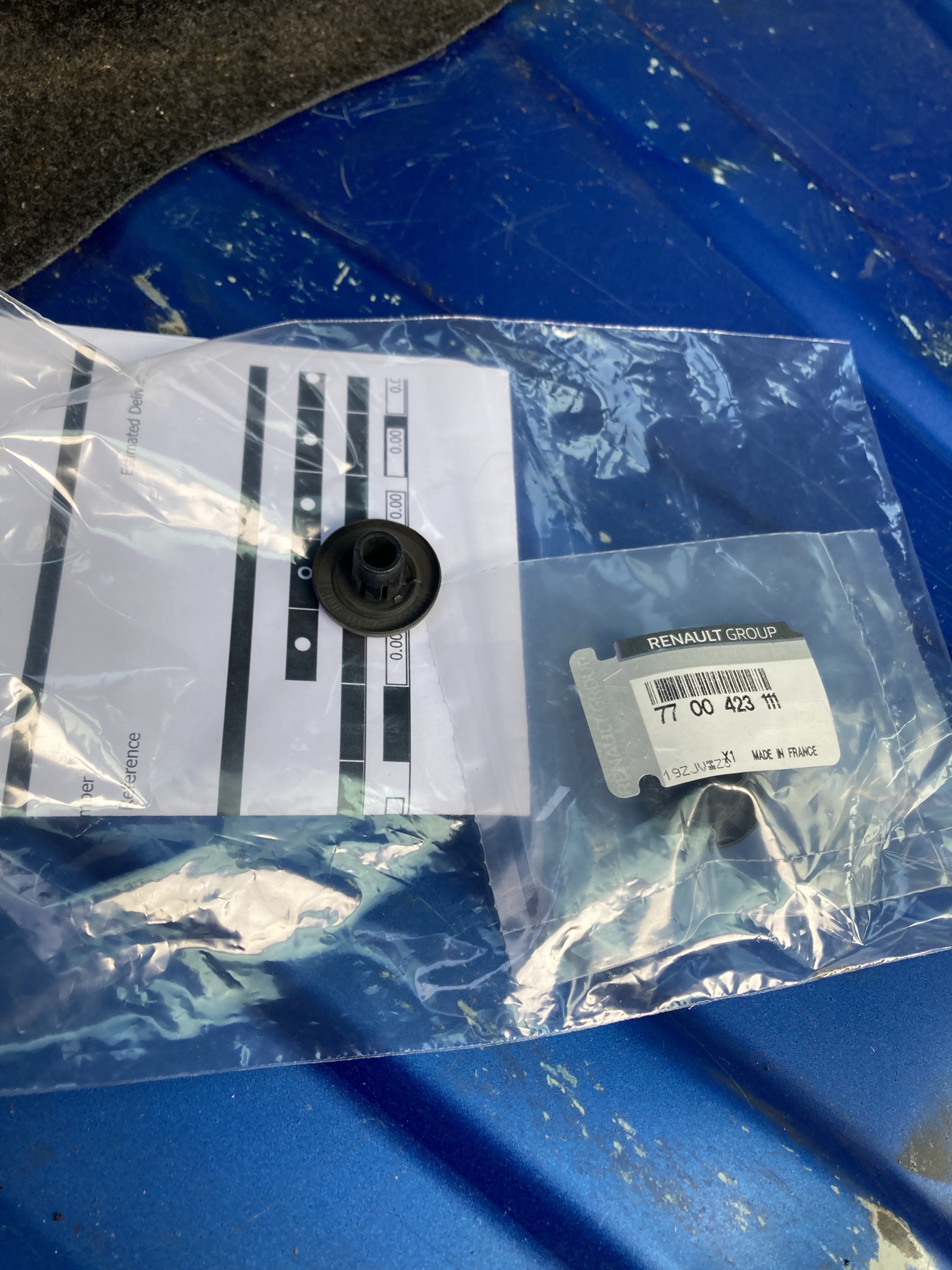

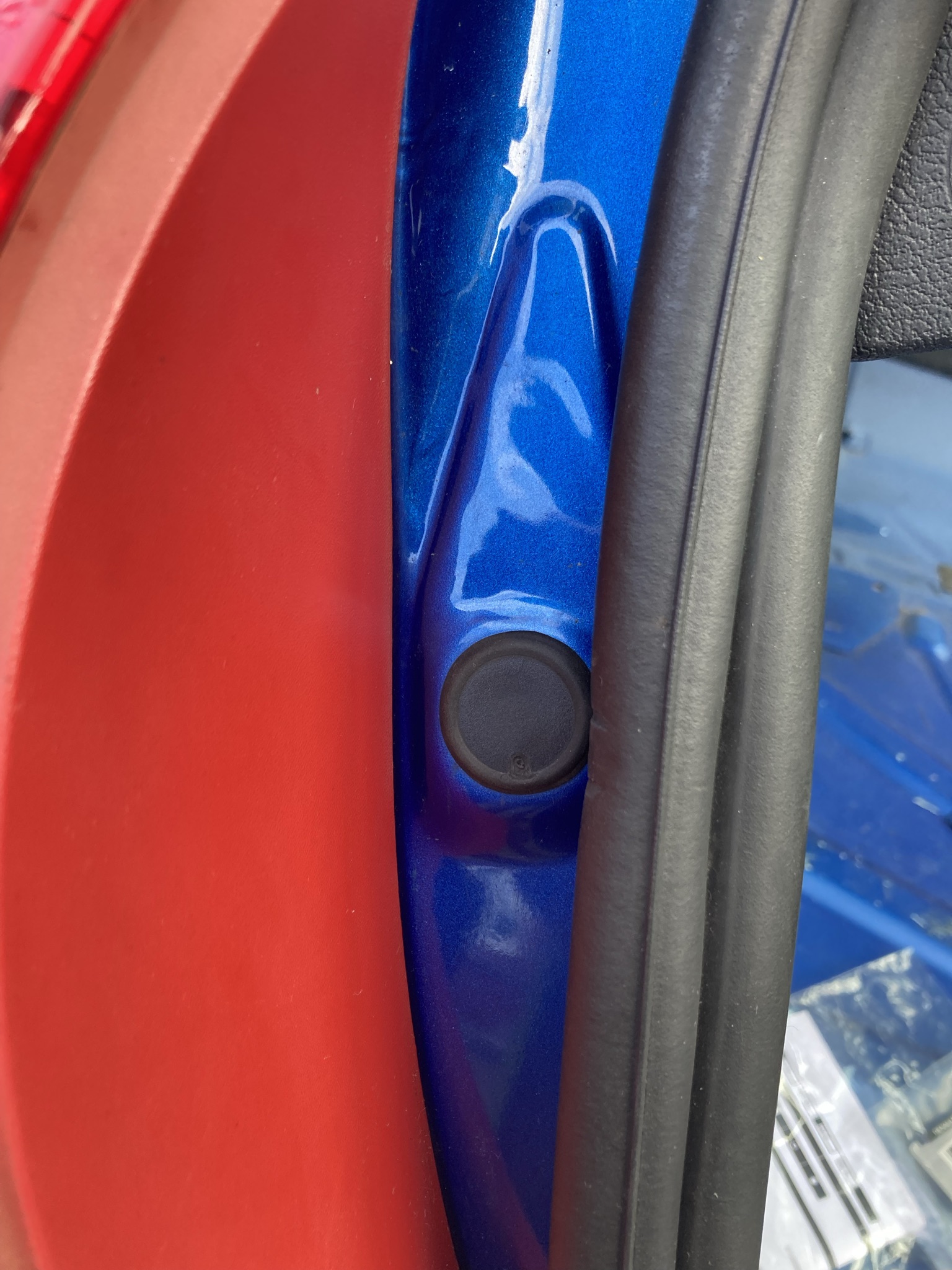

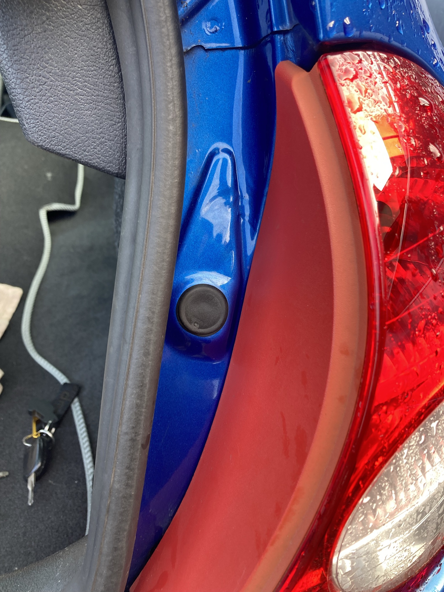

After washing the car I found I had some water ingress coming in from around the boot.
I ended up tracking this down to a perished rubber boot stop which wasn't creating a seal.
Luckily Renault still use these on newer models so I was able to get 2 replacements - only cost around £3 for both I think.
Only one was leaking but both were replaced for good measure.
