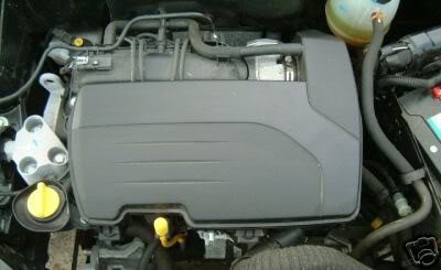

my clio is 2004, 1.2 16v new type of engine with different throttle body.(googled a bit about it and it seems that they changed engine type at 2004)
Engine looks like that:
