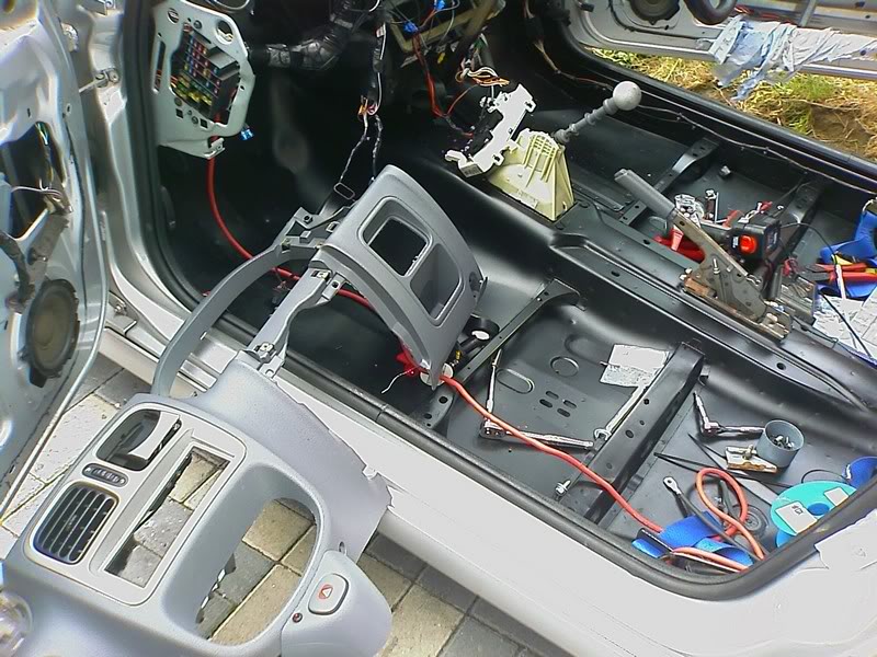

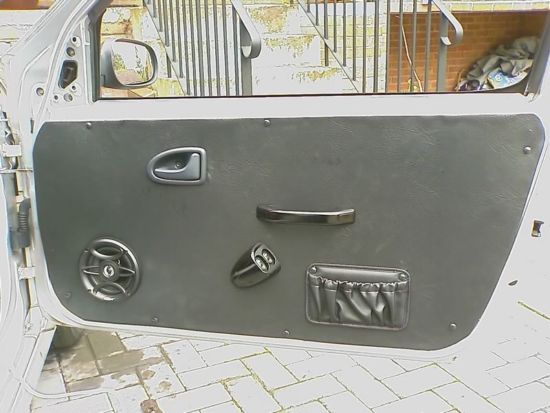

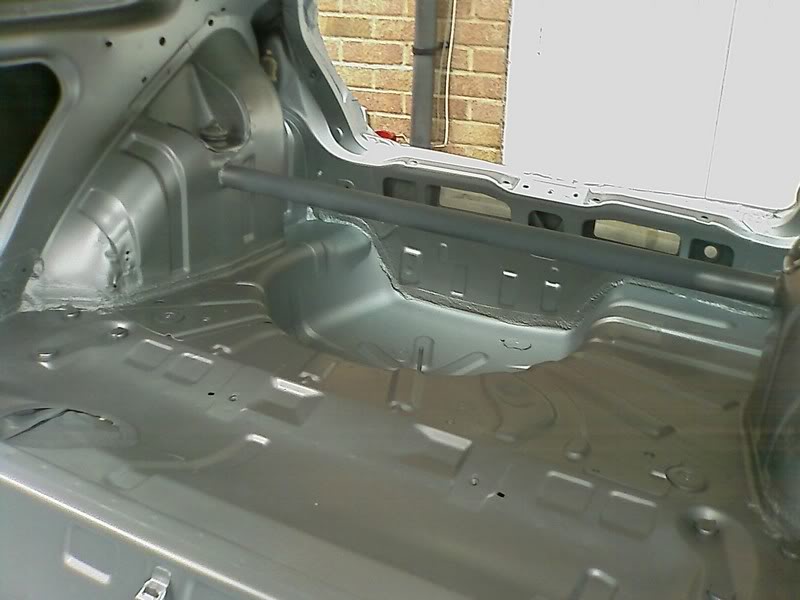

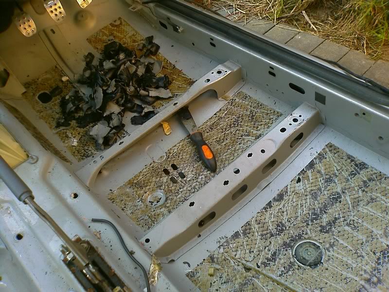

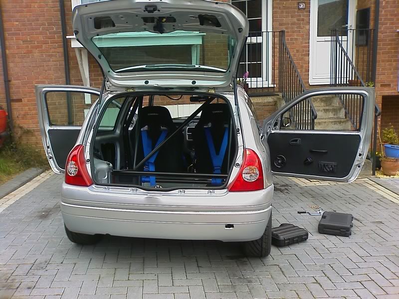

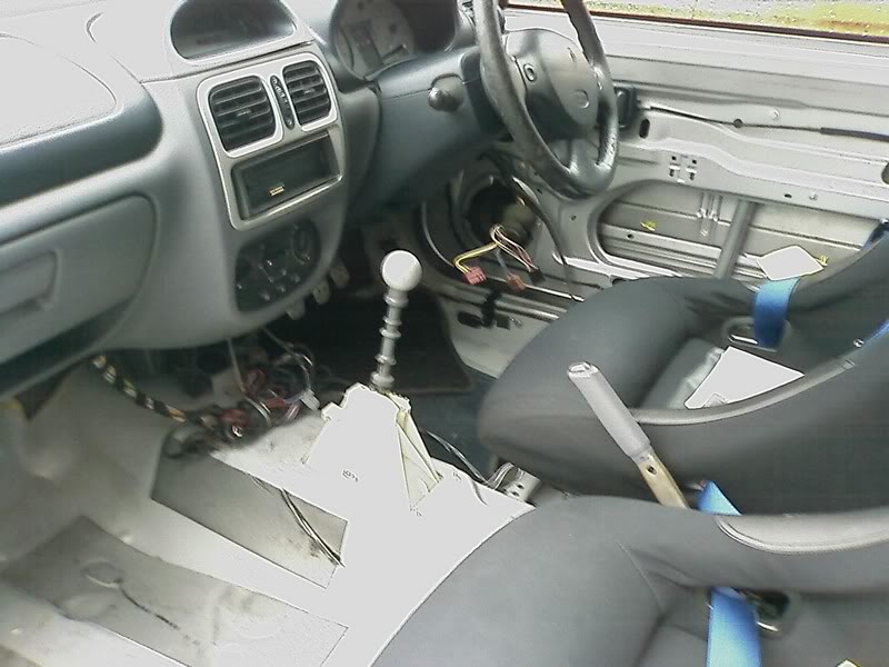

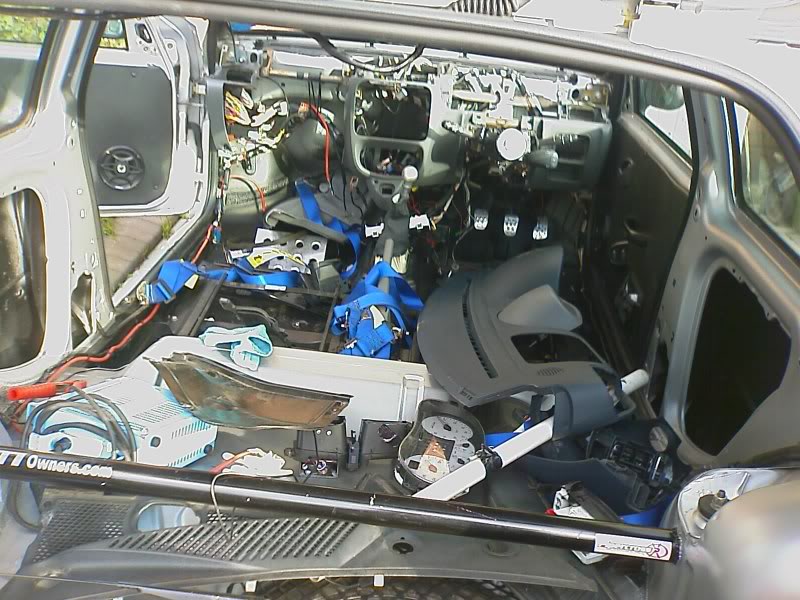

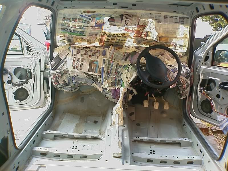

The car was already stripped of interior and had buckets, harness' and an ex-msv cage fitted. So the plan had changed slightly.
With no events or activities planned until the 2nd weekend in March I set about tidying up the car a little. This soon turned into major surgery as the complete dash came out, all unnecessary bits of wiring loom cut off, sound proofing removed, tar scraped off, the interior painted and Custom door panels made with mondeo electric window switches.

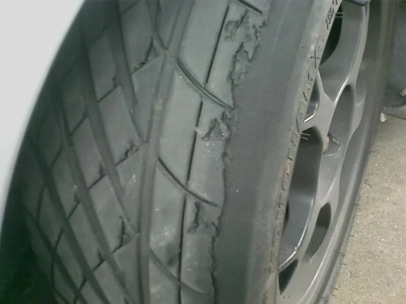

On the third run, with Ph-reebone on board, I clipped something & split a tyre.
Game over early.

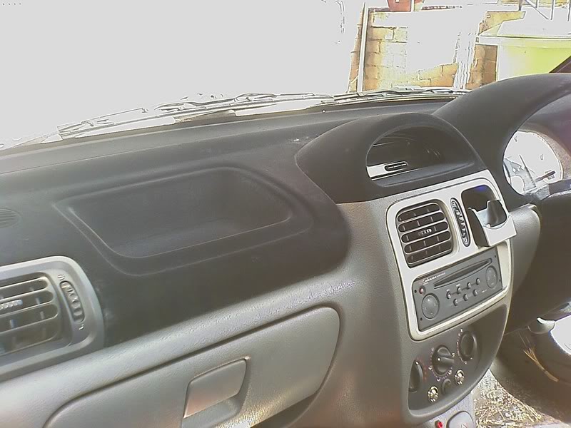

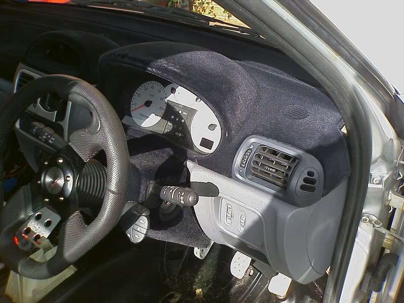

A few days later, a parcel arrived. It was the dash top I'd sent off to be flocked.

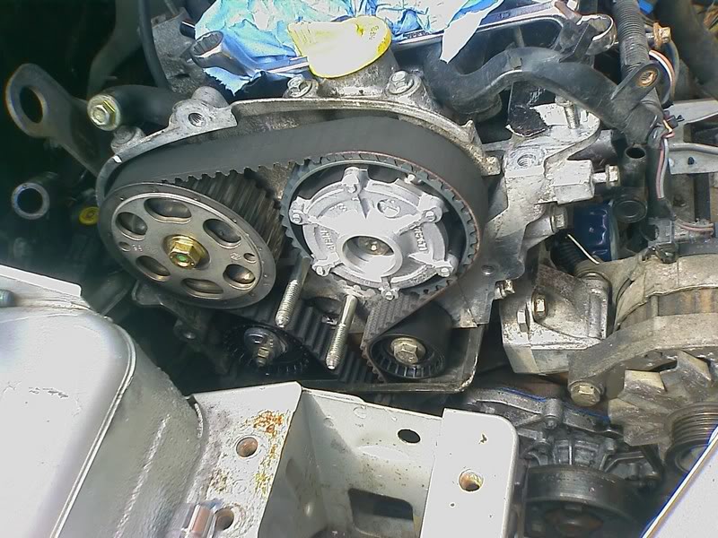

So on went a new knock sensor, cambelt, tensioner kit and both cam pulleys.

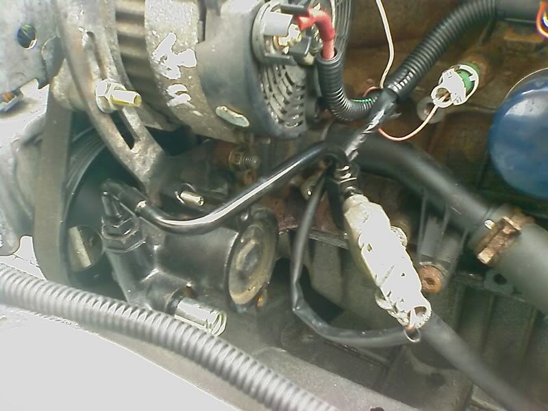

To bin the a/c compressor setup, I sourced a Volvo alternator, Volvo pas pump and had a custom pipe made.
All this transformed the performance. It was now so much more lively and willing to rev.

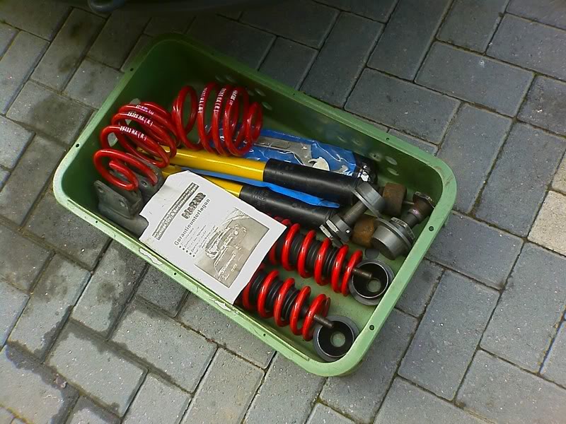

In preparation I had fitted and had set up some H&R coilovers. They had been in a box in the car when I got it.
I'd also fitted a prospeed exhaust I'd kept from my old phase2. This ment I also had to swap to the later type cat too.

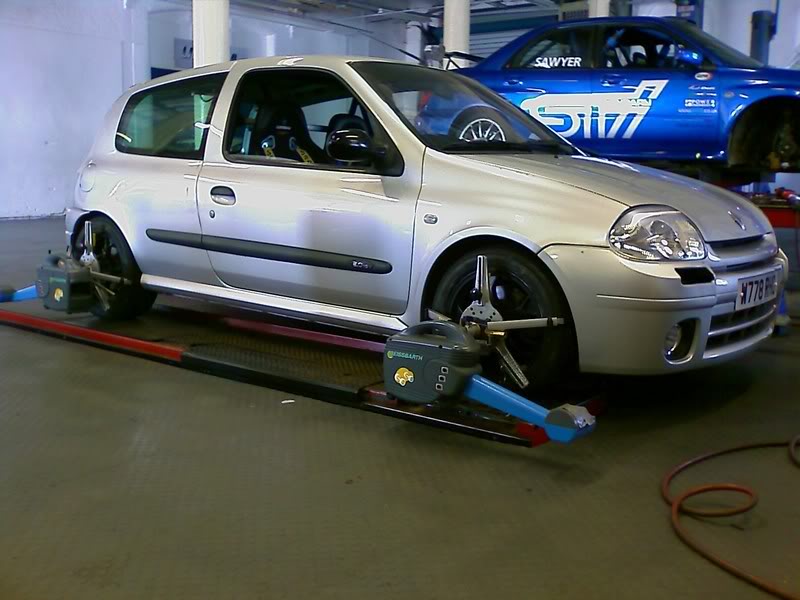

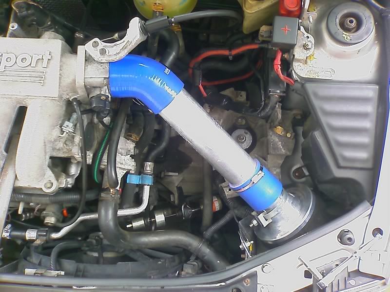

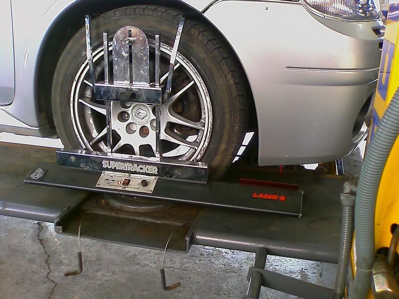

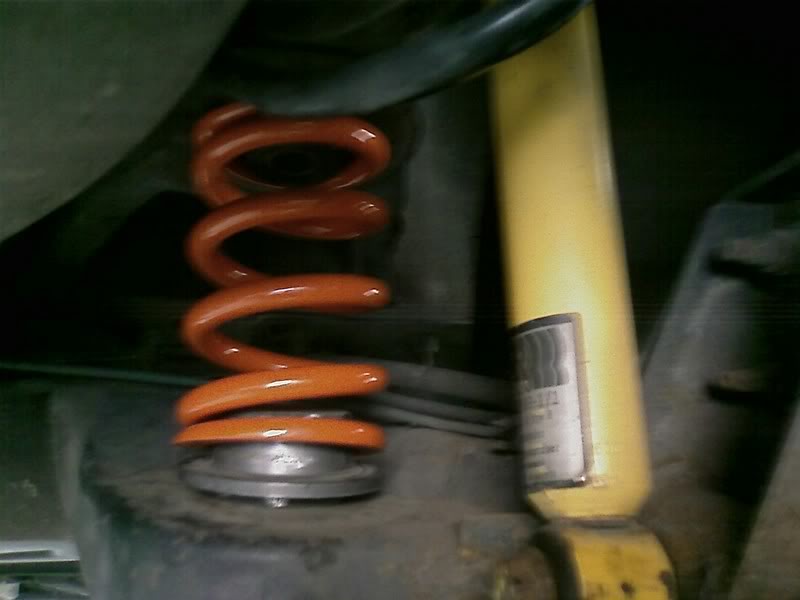

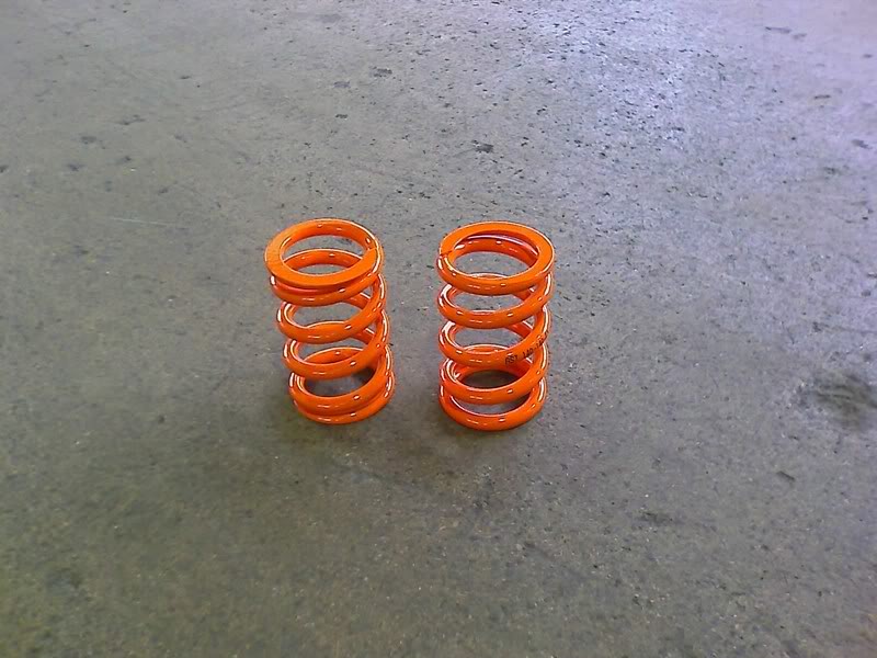

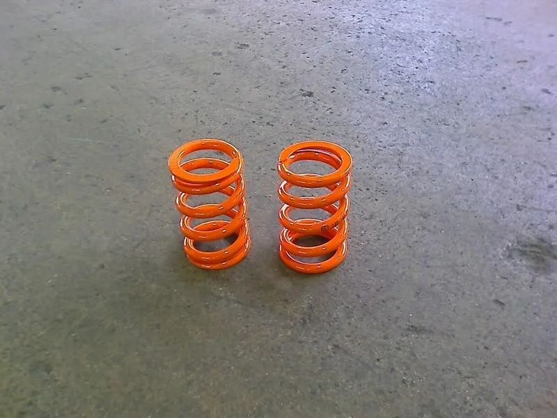

After speaking to a local Subaru and motorsport tuner, I changed to stiffer rear springs to try and help with the understeer. The difference was noticeable right away, even at slow speeds on the road. But the real test would be next time on track.

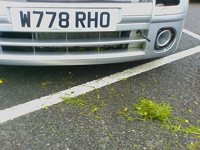

At this point I made up a cheap custom induction kit that sounds amazing!

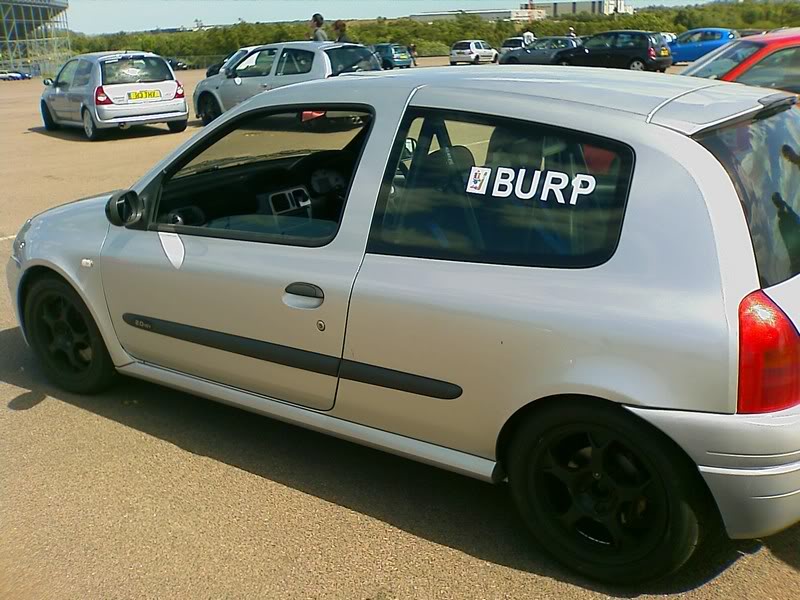

I decided to get one more trackday in, before the tax ran out at the end of August. I wasn't going to re-tax it over the winter.
Oulton park with Renaultsport on the 20th of August was the chosen day. Tony was guest driver again and apart from him getting lost on the first lap, and me having a few passenger scaring moments, the day went smoothly and the car was much improved.

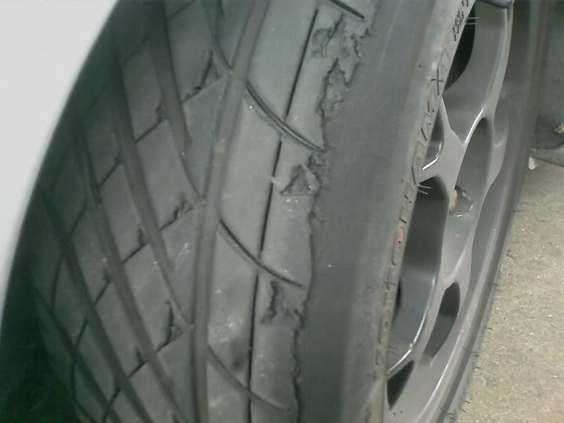

Although the same cannot be said for the tyres......

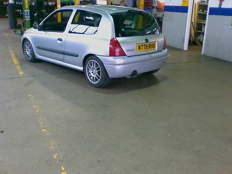

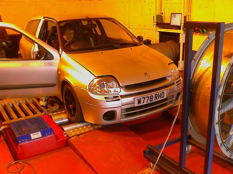

The following Saturday was day many had been waiting for. A rolling road day I had organised at 'PowerStation' in Tewkesbury. Now we would see how much power the car had gained back after I'd done the cambelt.
I would of been happy with a result of around 165-170bhp as the engine is fairly standard. On the first run it made a brilliant 174bhp and I was very pleased.
The induction kit does suffer from a bit of heat soak, not a problem on track with plenty of airflow, so the rolling road operator said he thought it had a little bit more to give. Second run and a result of 175.2bhp @6905rpm with 148.5lbf @5565rpm.
Very happy and gives a good base for the future.

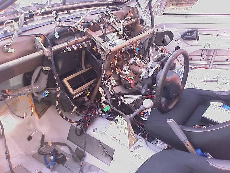

So the end of August, the tax ran out and declared it sorn. Any more mods were on hold while I saved for my wedding. Or so it should of been, I knew I wouldn't leave it alone for long. As long as I didn't spend any/too much money I could still mod.

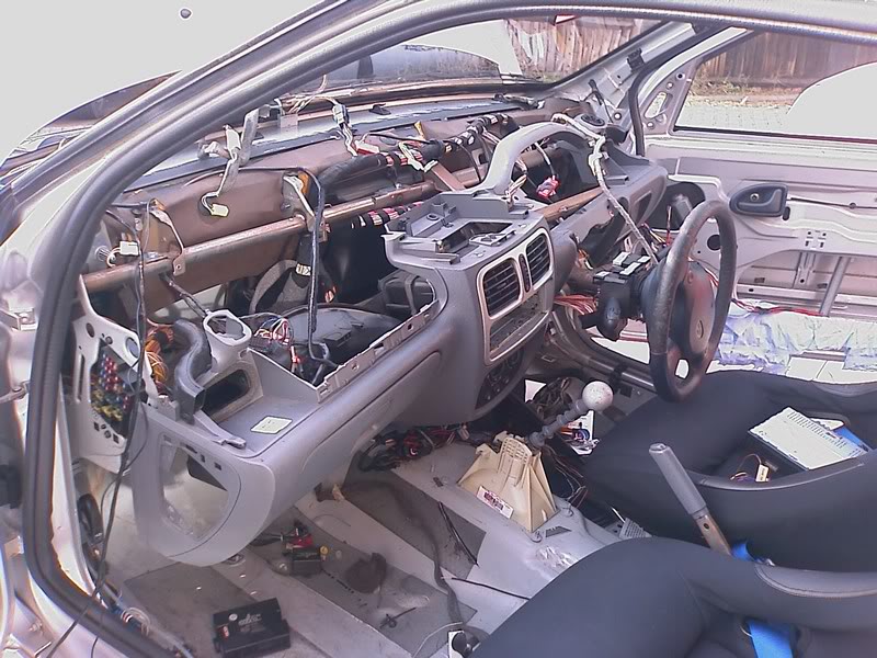

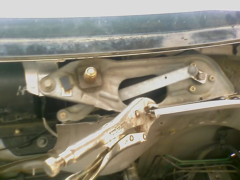

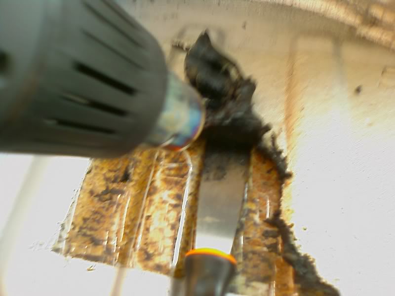

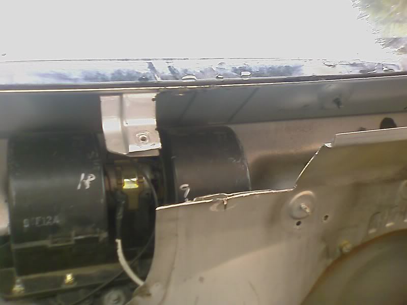

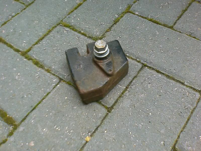

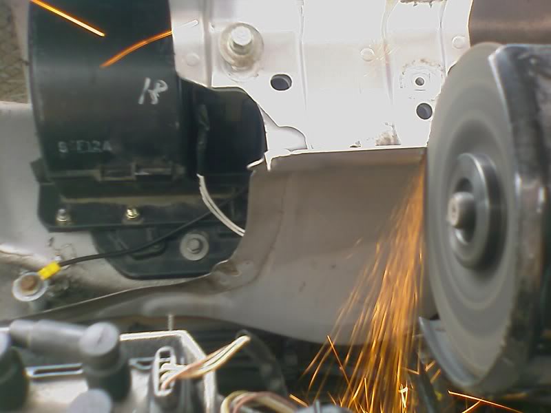

Ripping out the last remains of the aircon, an lump of iron from under the engine mount and some more tar ment another 15kgs gone.
I modified the wiper mount point to get a Citroen AX wiper linkage in, freeing up some space under the scuttle & saving abit more weight.

just a quick one though, why spend all that time stripping every little bit of extra weight, sound deadening etc then put the complete dash back in?
coz it looks s**t without/with only part of it in. If you read my thread there are some pics of th dash in bits

ah right thats cool just wondered without me sifting through the threads.
in the ideal world id like a real minimalist one like a cup racer. but starting with a road car means that there is a huge amount of wiring loom behind the dash. Will be putting a phase 2 dash in it next year, will trim off as much as possible.

would be interested to see how much of a diffrence the custom rear springs made.

Next for me was Curbourgh sprint track,this was the first time I had chance to drive the beast,what was soon apparent was the unwillingness to "turn in" and this caused much fun during the day which has been well scribed elsewhere.This made Jays performance at Bedford even more creditable with a car that handled in such a way.(NEVER REMOVE THE ABS FUSE)
After the spring changes Oulton park loomed upon us.What a transformation!,the car now felt "safe" to drive.By this I mean it didn't want to understeer into the armco and had a little bit of oversteer when asked for,this for me was the perfect set up to feel totally in control,so well done Jay for getting this sorted.
