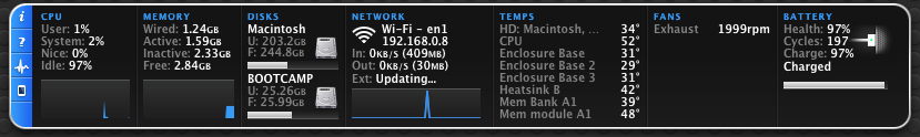

Gavin.
Thats idling (web browsing), as soon as the temp of the CPU starts to rise the RPM of the fan goes up with it. At around 80 deg the fans are at a full 6000rpm. Its loud but it needs to be to stop the internals melting, any computer will do the same thing tbh.

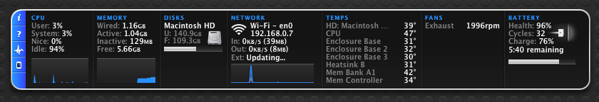

Gavin.
Oh yea mine is a MBP, its fans still go at full wack when needed though. Try streaming something using XBMC it tends to send mine nuts for some reason.
