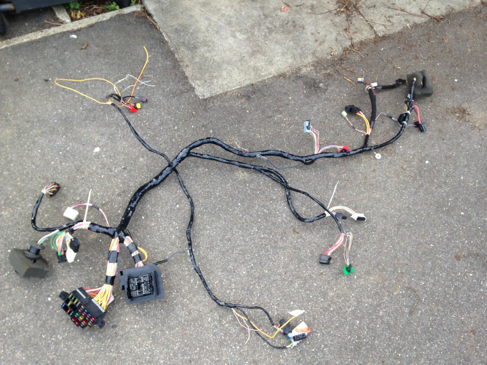

This is what I ended up with a recent loom looking like. EPAS integrated, gauges hard wired, USBs hardwired and airbag system reduced to the bare minimum. (earths, lives and canbus network)

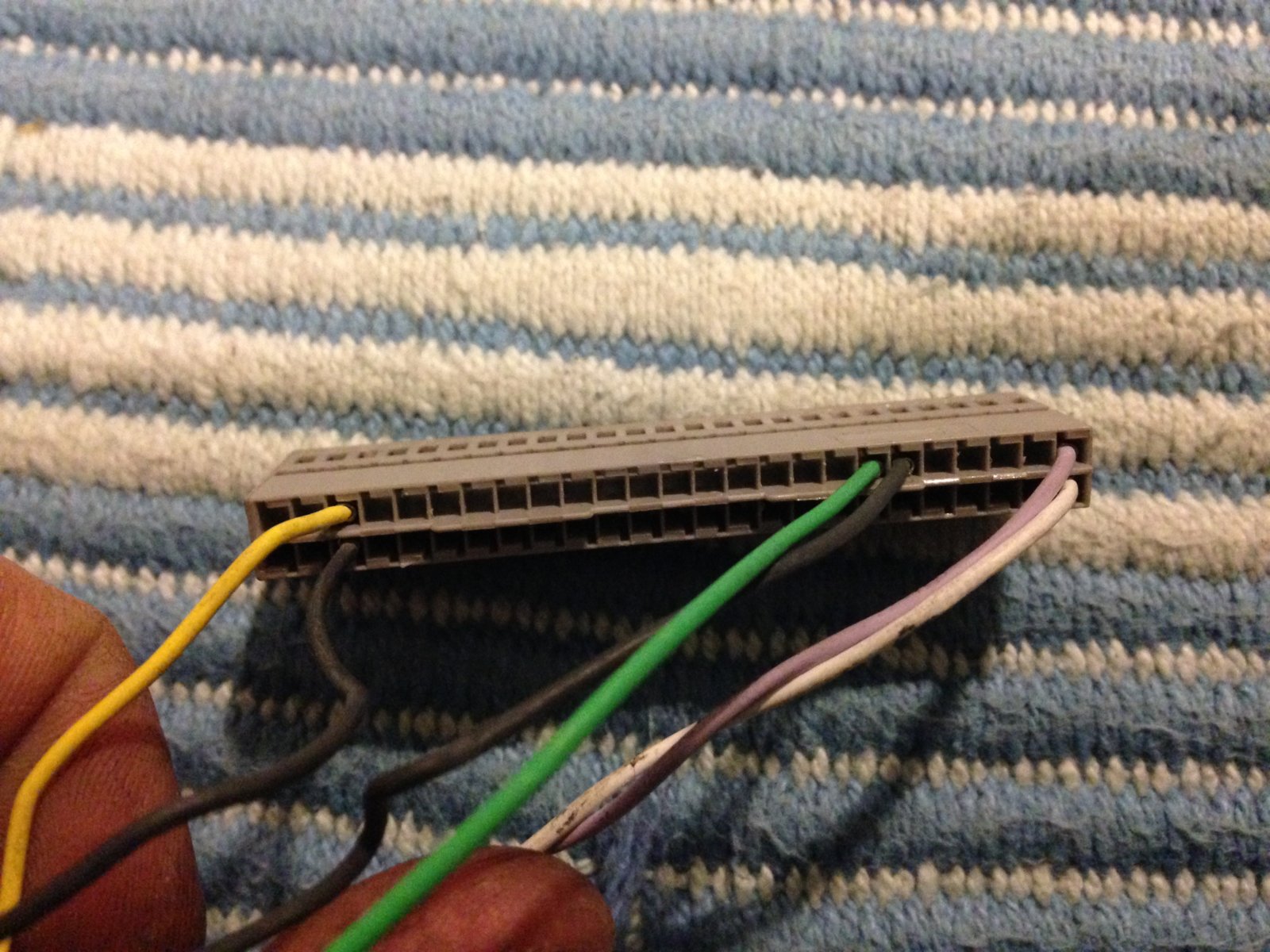

This was my cup loom. Pic also of what's left in the airbag plug.
