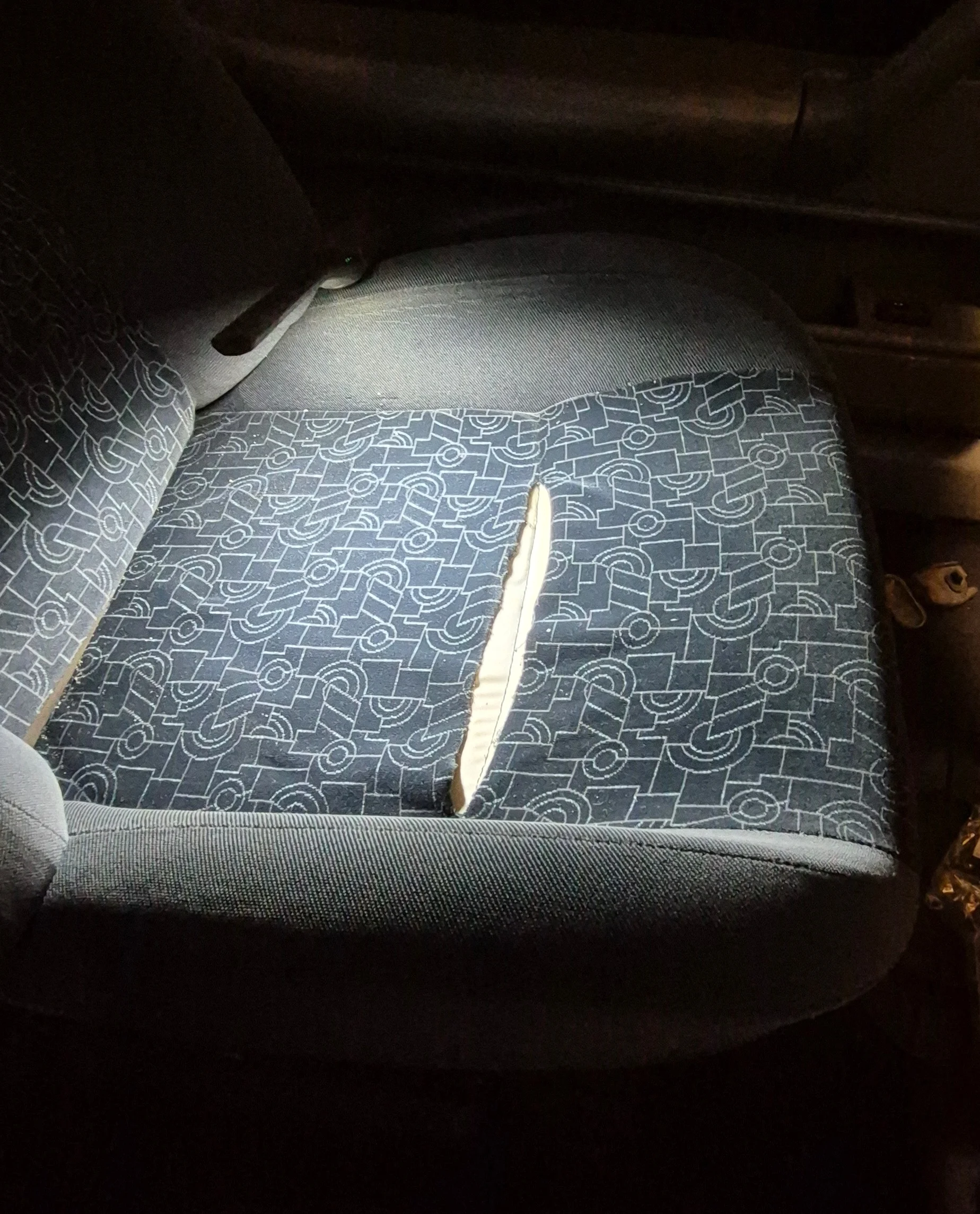

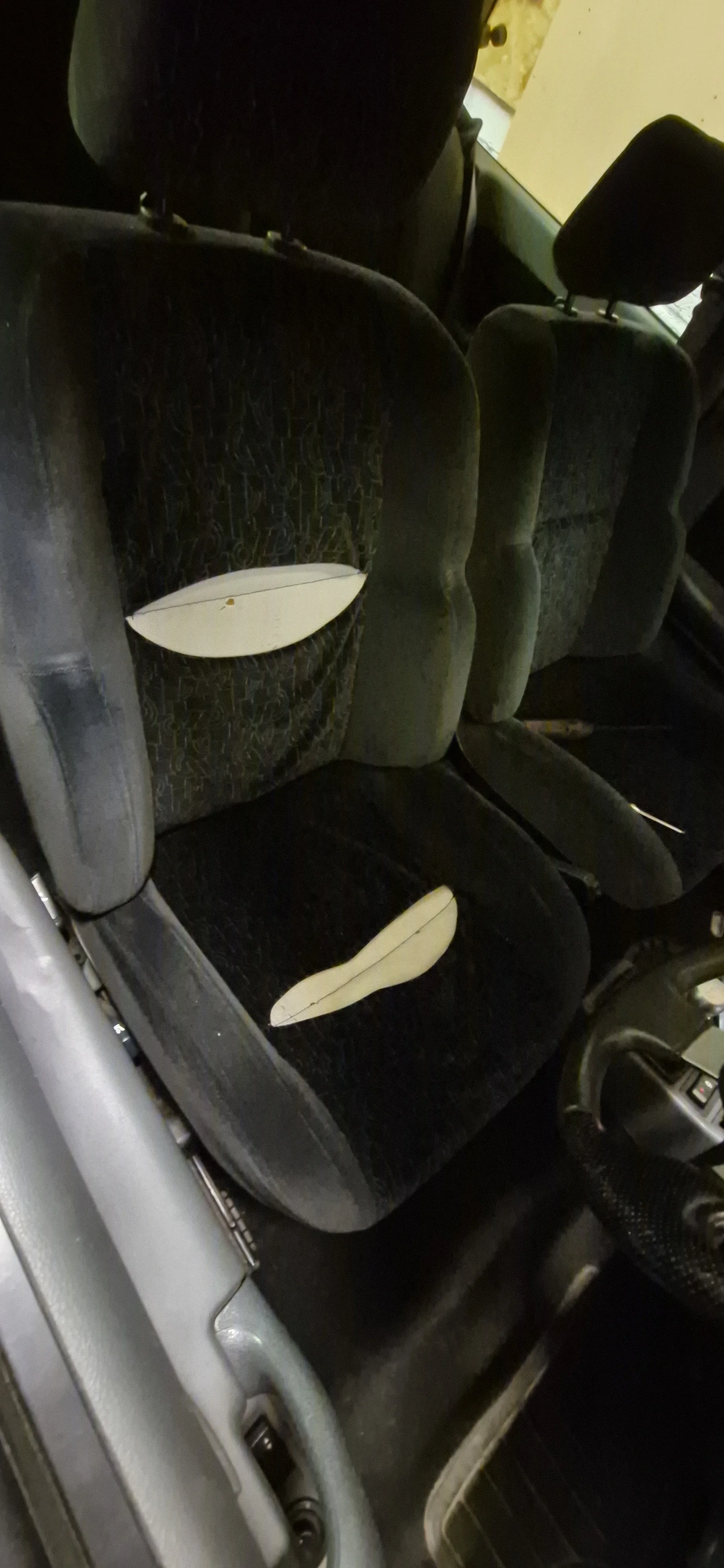

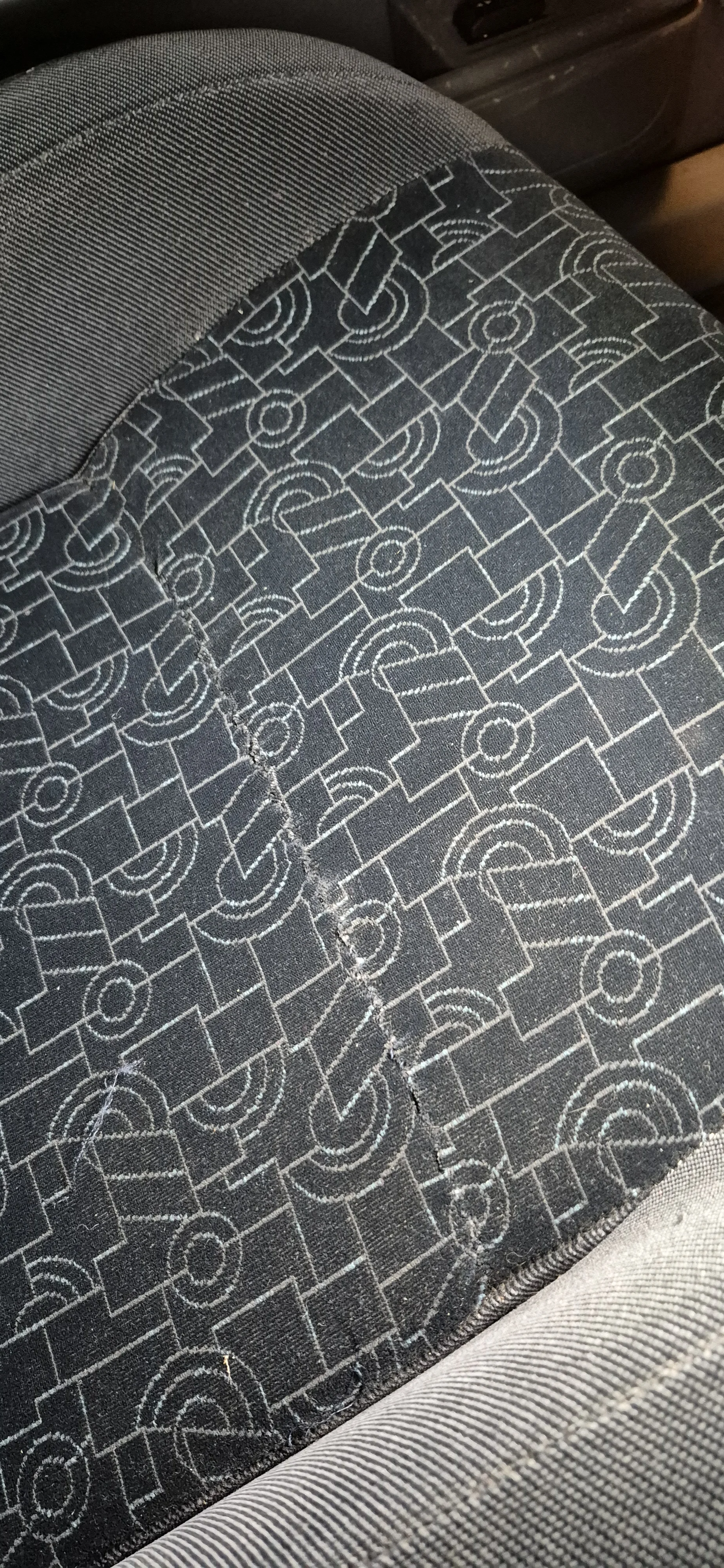

-The seat fabric is unstitched on both seats

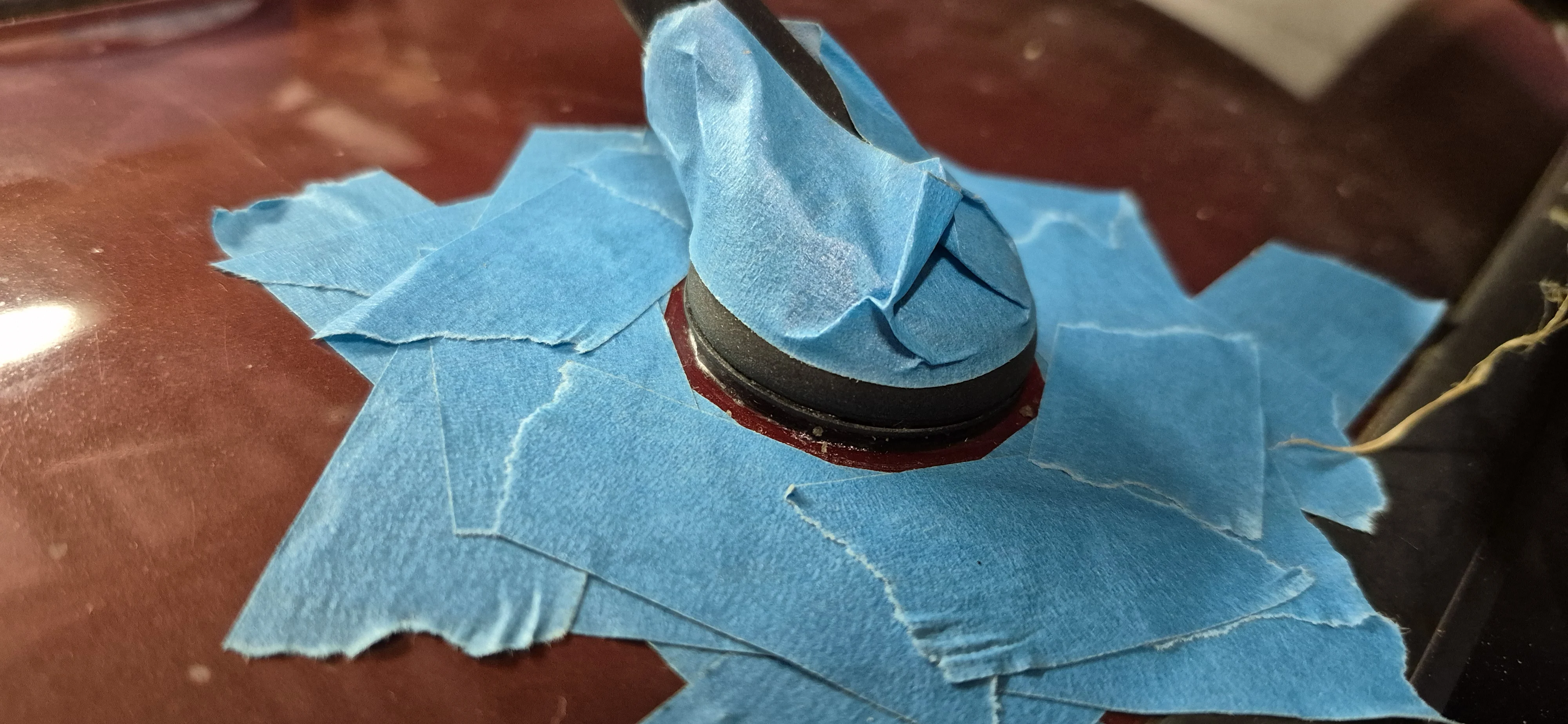

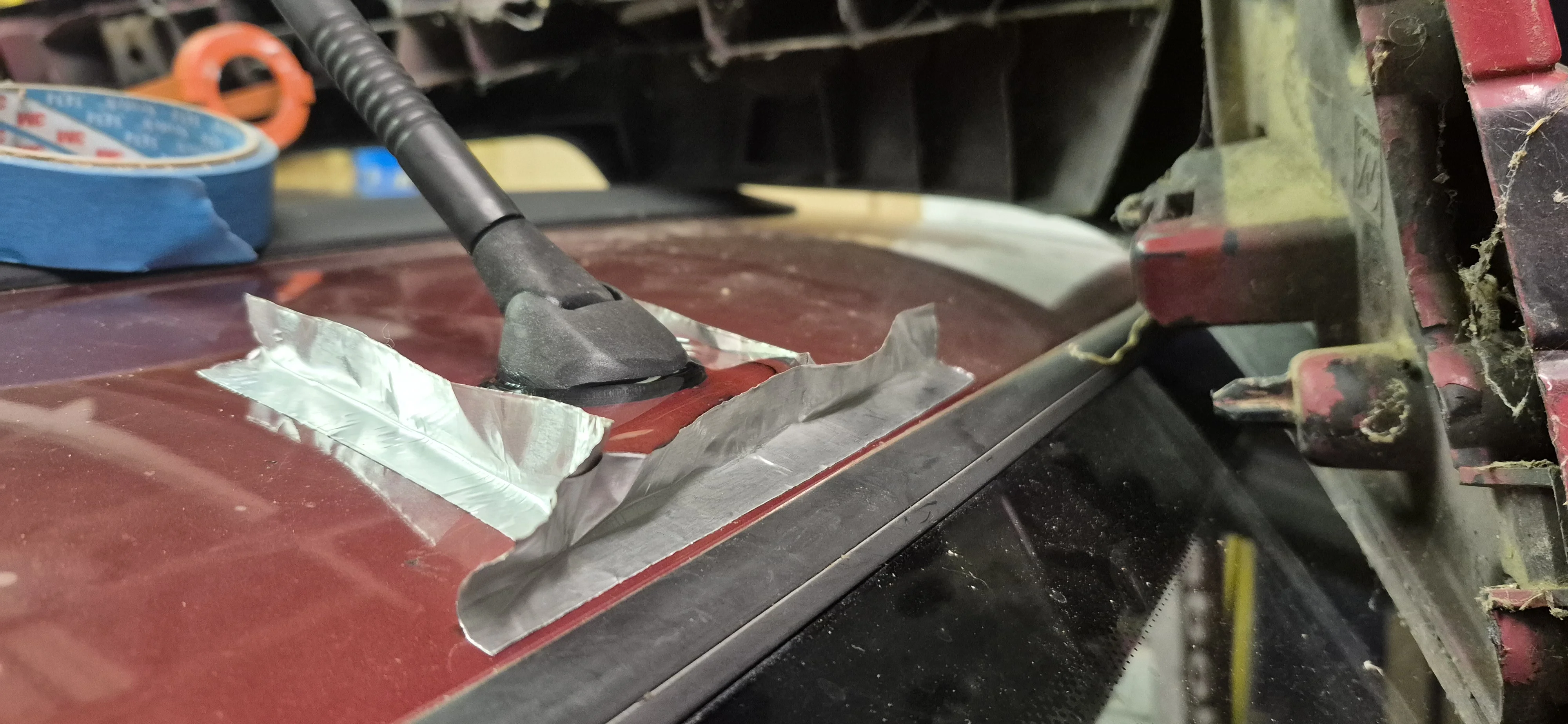

First job was to have a look at the leaky roof, and decided to have a look at the ariel first and aha! it is loose! So I remove the ariel and clean it up and stick it back on with some tiger seal.
Then I build a little dam and check my work...
Perfect, it's not leaking. Job Done.

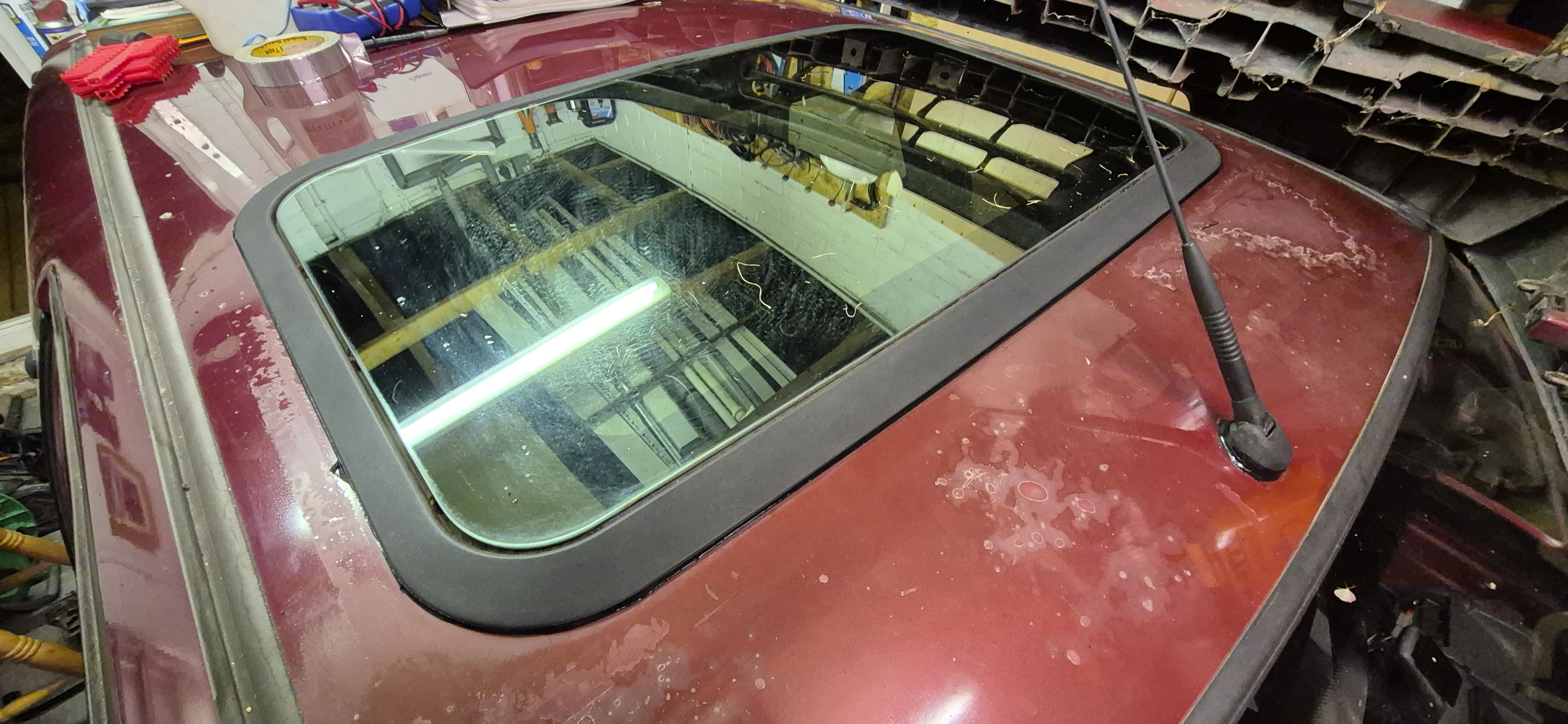

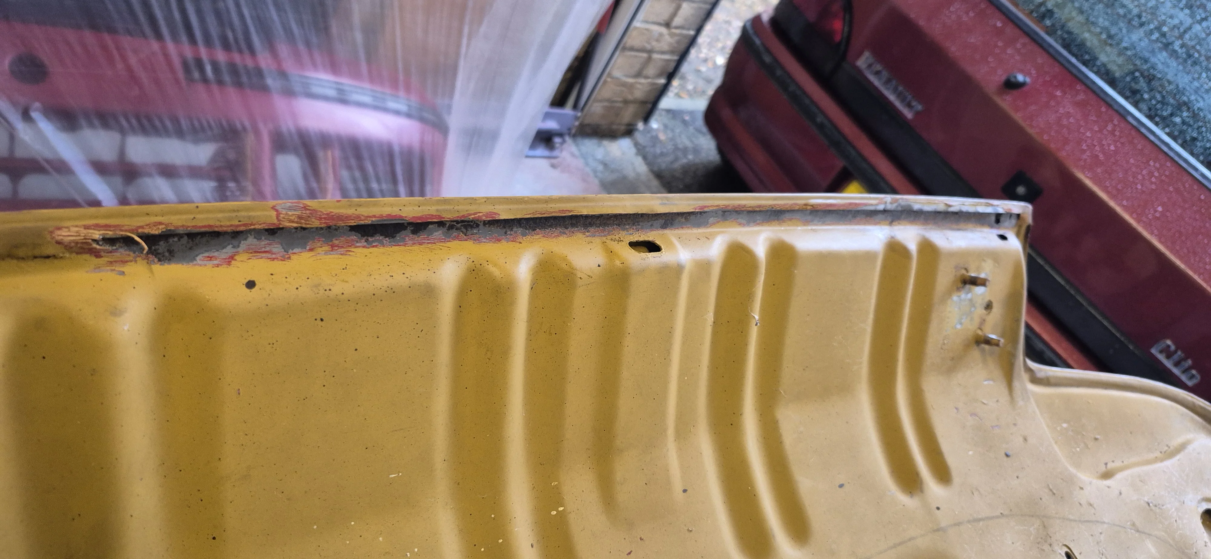

I had probably better check the sunroof though just to be sure
oh..

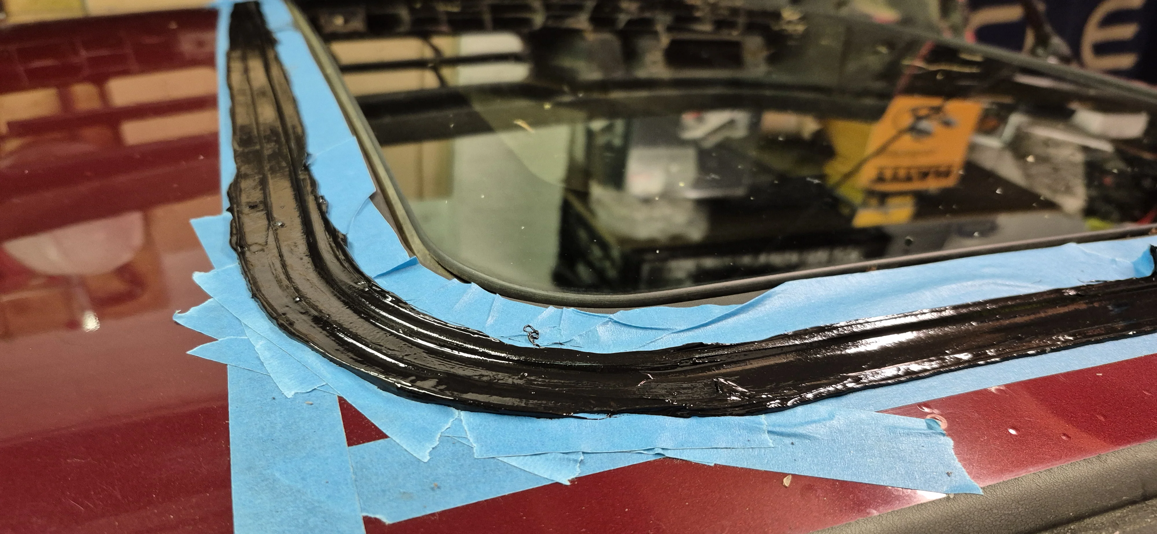

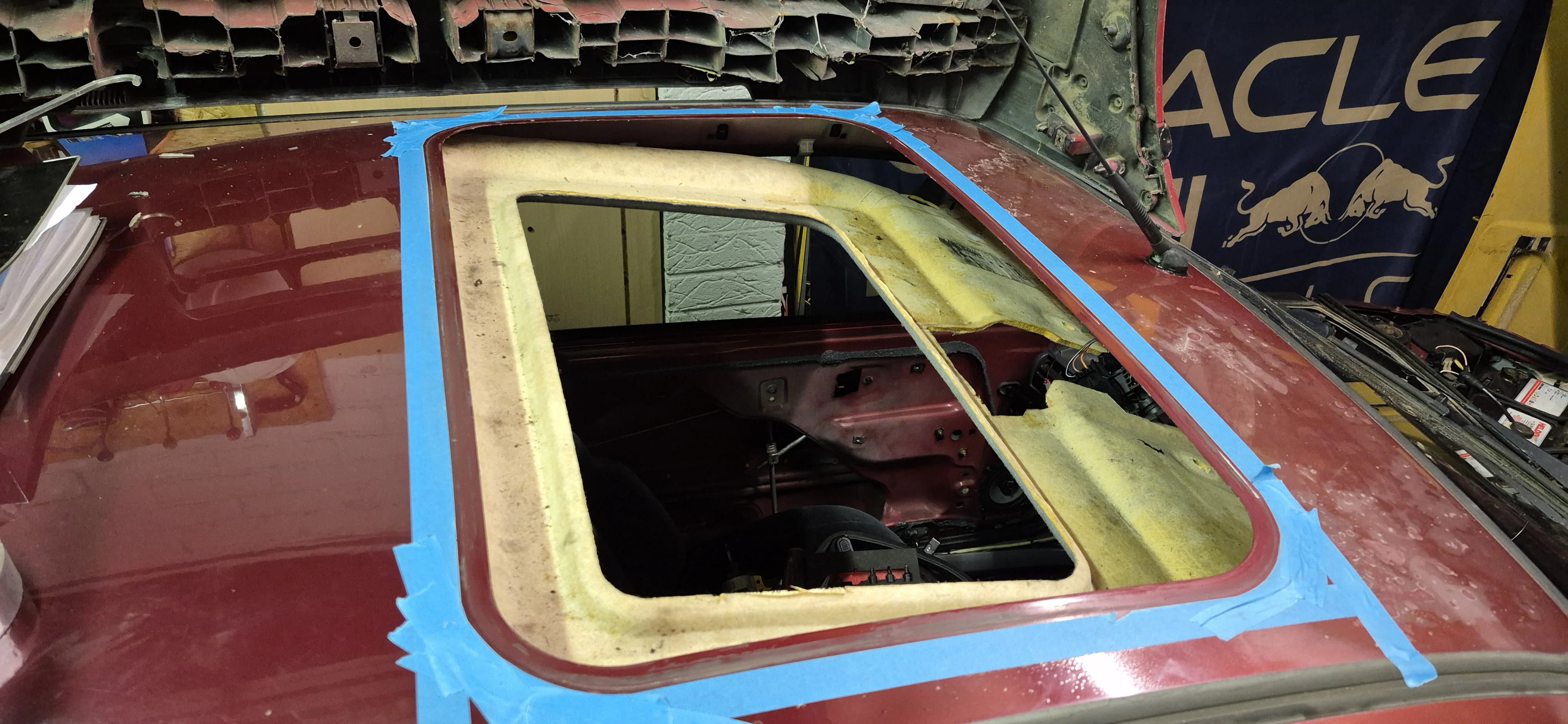

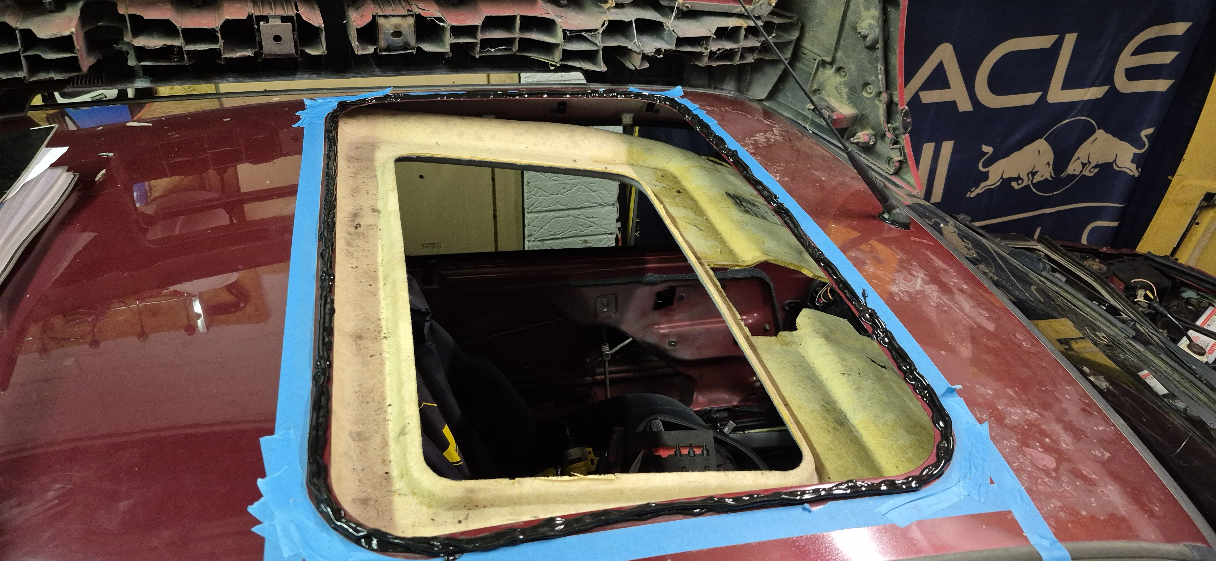

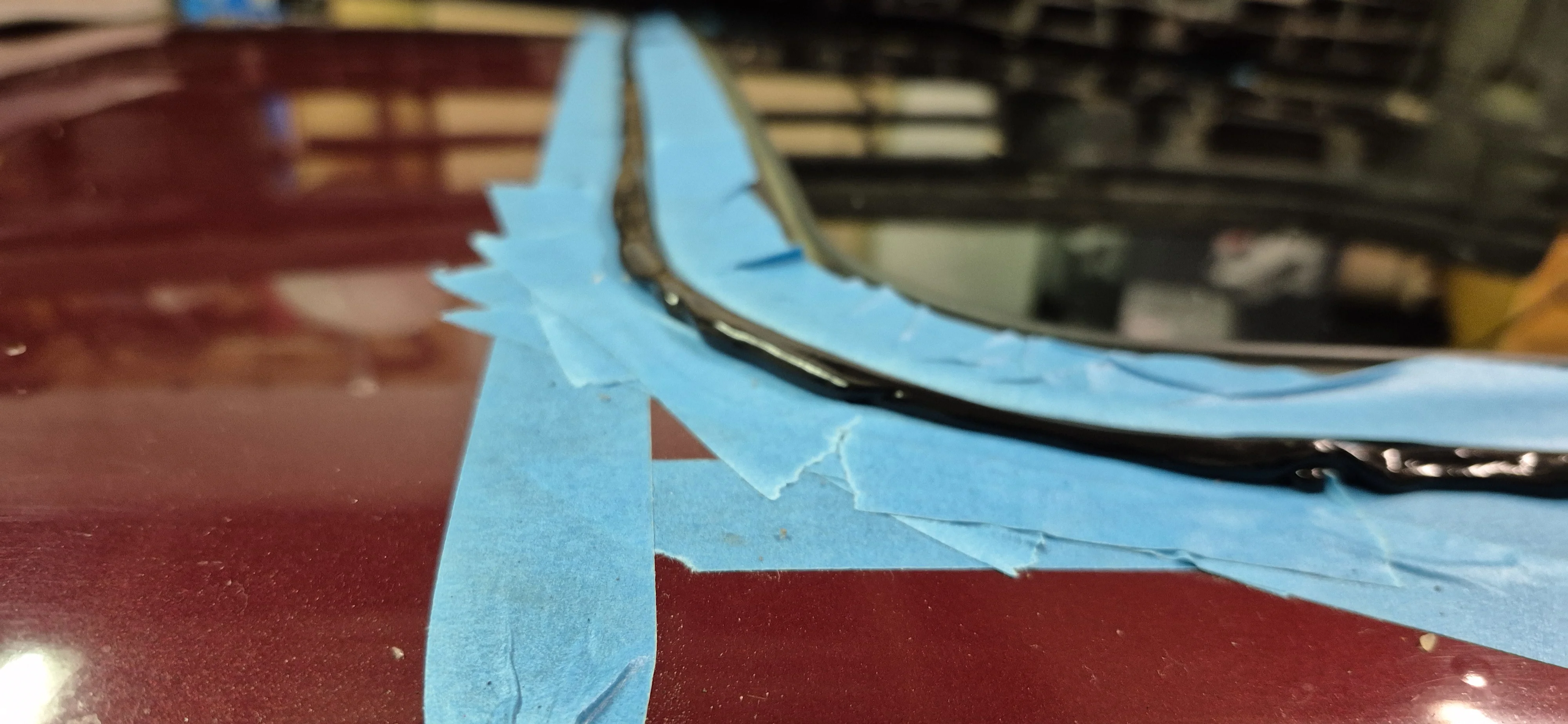

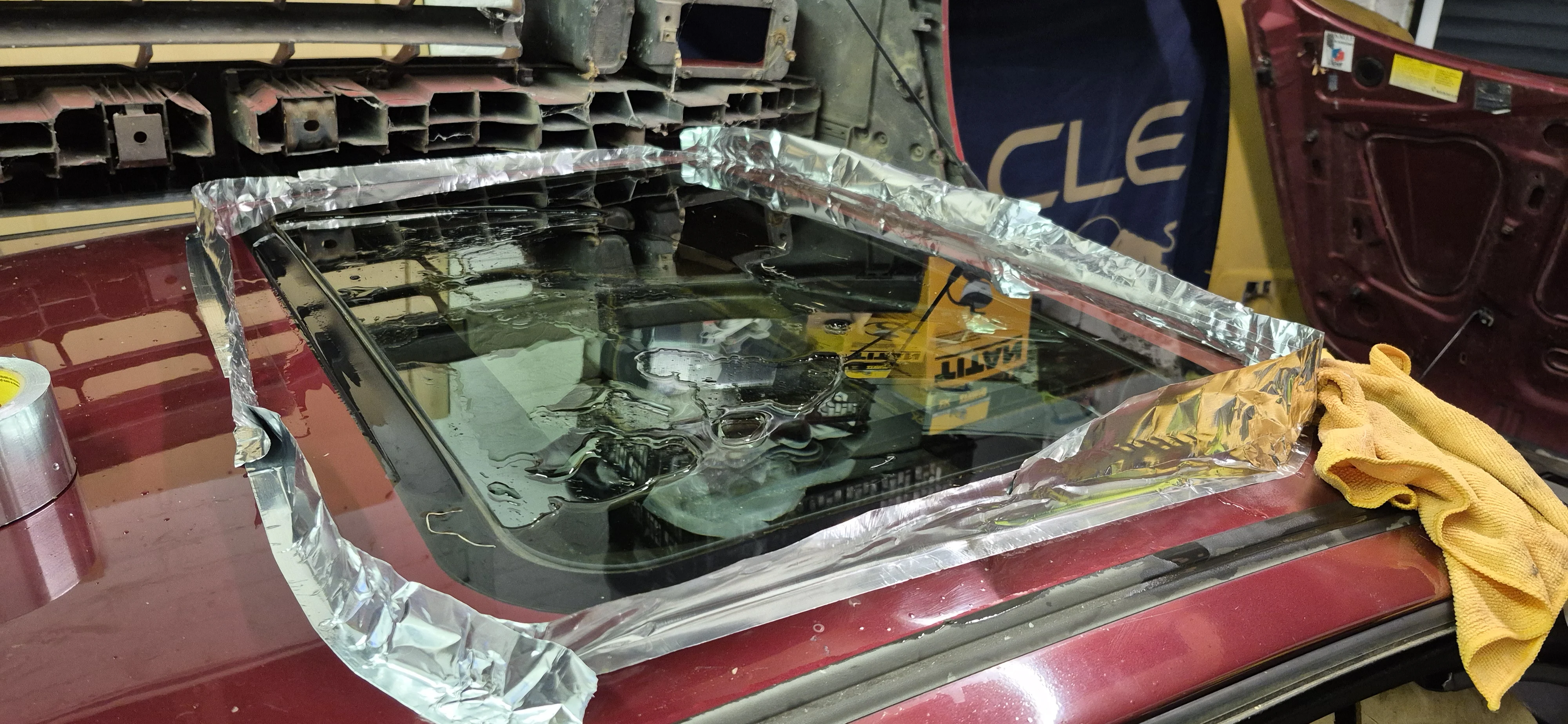

So out comes the sunroof, and I can see why it was leaking. There is not much in the way of original manufacturer seal. Somebody has been here before and there has been an attempt to seal it with silicone from the inside. I clean up the roof and sunroof frame throughly, mask them both up and use a whole tube of tiger seal before refitting the sunroof and cleaning up the bead.
I put it on thick, taking no chances

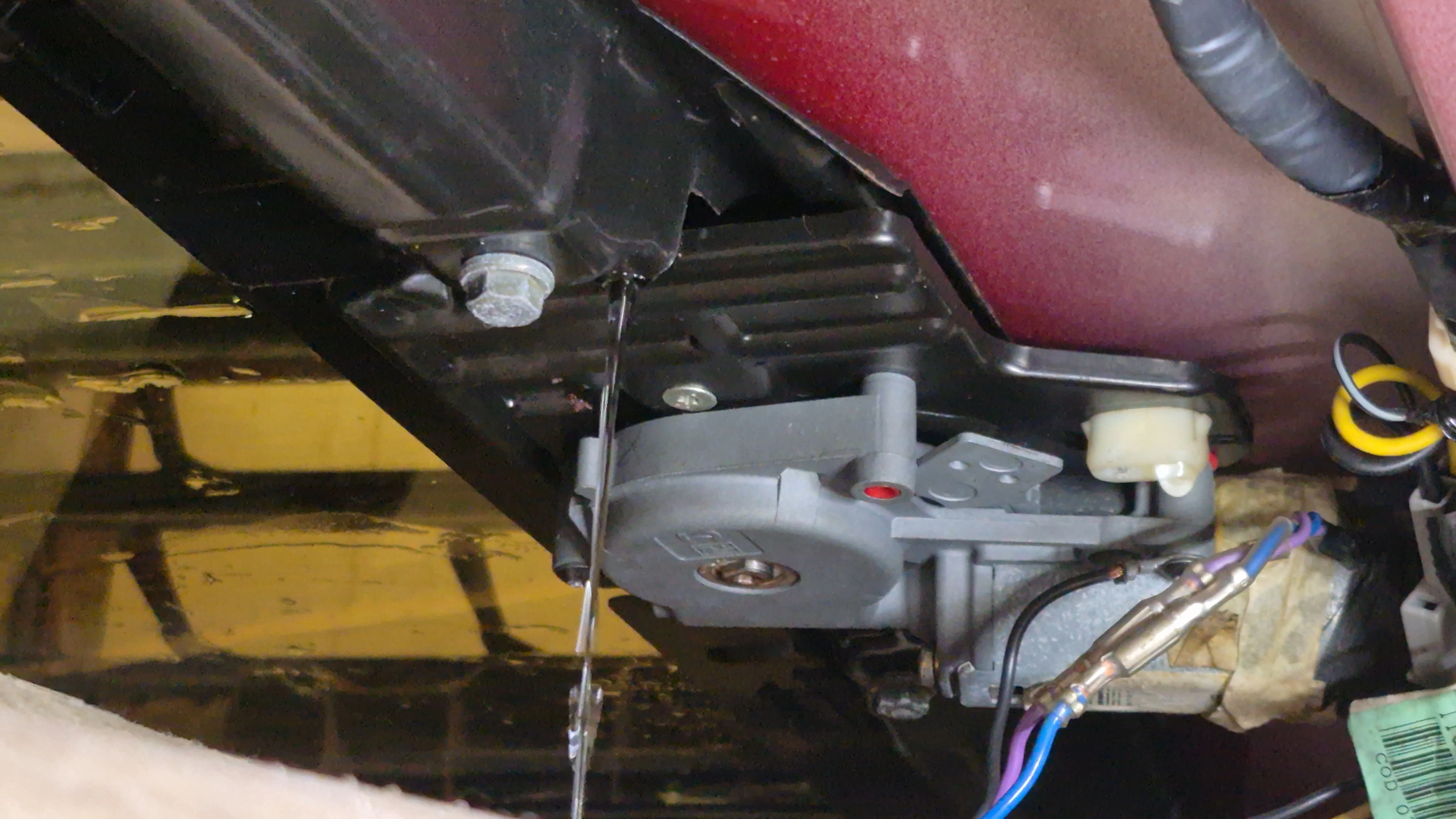

Another dam built, another leak check carried out. A vast improvment, no longer streaming in. There is a slight trickle that I can see it coming past the seal on the window glass. So i open up the sunroof manually (as the sunroof motor also doesn't work I forgot to put that on the list!). I clean the surround and seal thoroughly cleaning all the gunk out from underneath the lip of the seal. This seems to do the trick and it is holding the water at bay.

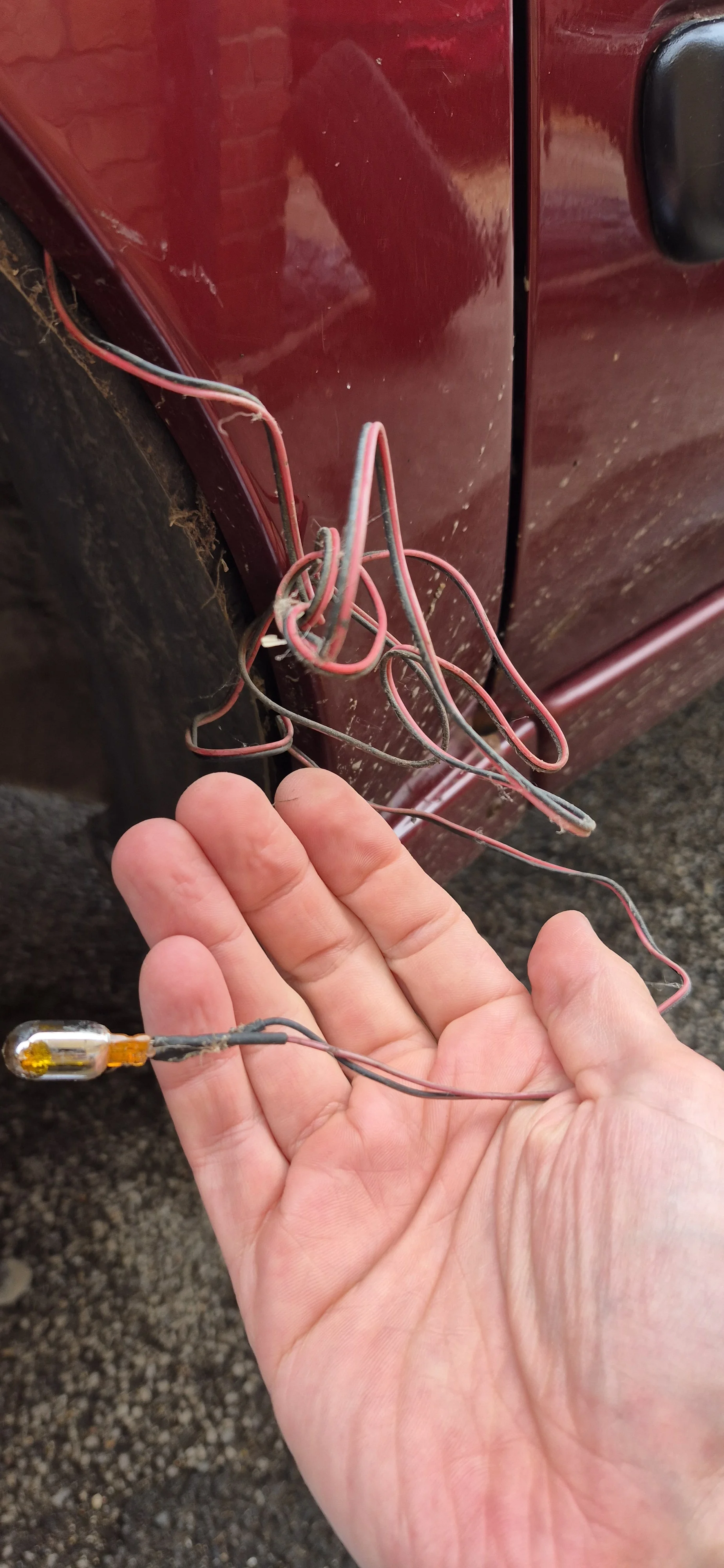

Next I look into the side repeaters, pop them out and find no bulb or bulb holder in there. So I take the arche liners out and dig around and find this set up, a bulb bodged into the look with what looks like speaker wire! Not sure what the plan was to hold it in the side repeater as it has no holder. And it doesn't work anyway, it the same on the other side.
I order and fit some generic LED side repeaters from ebay as a quick fix, they are smoked and are 'animated' style. I don't like them but are a quick solution, I will be ordering the correct parts for the original look down the line.

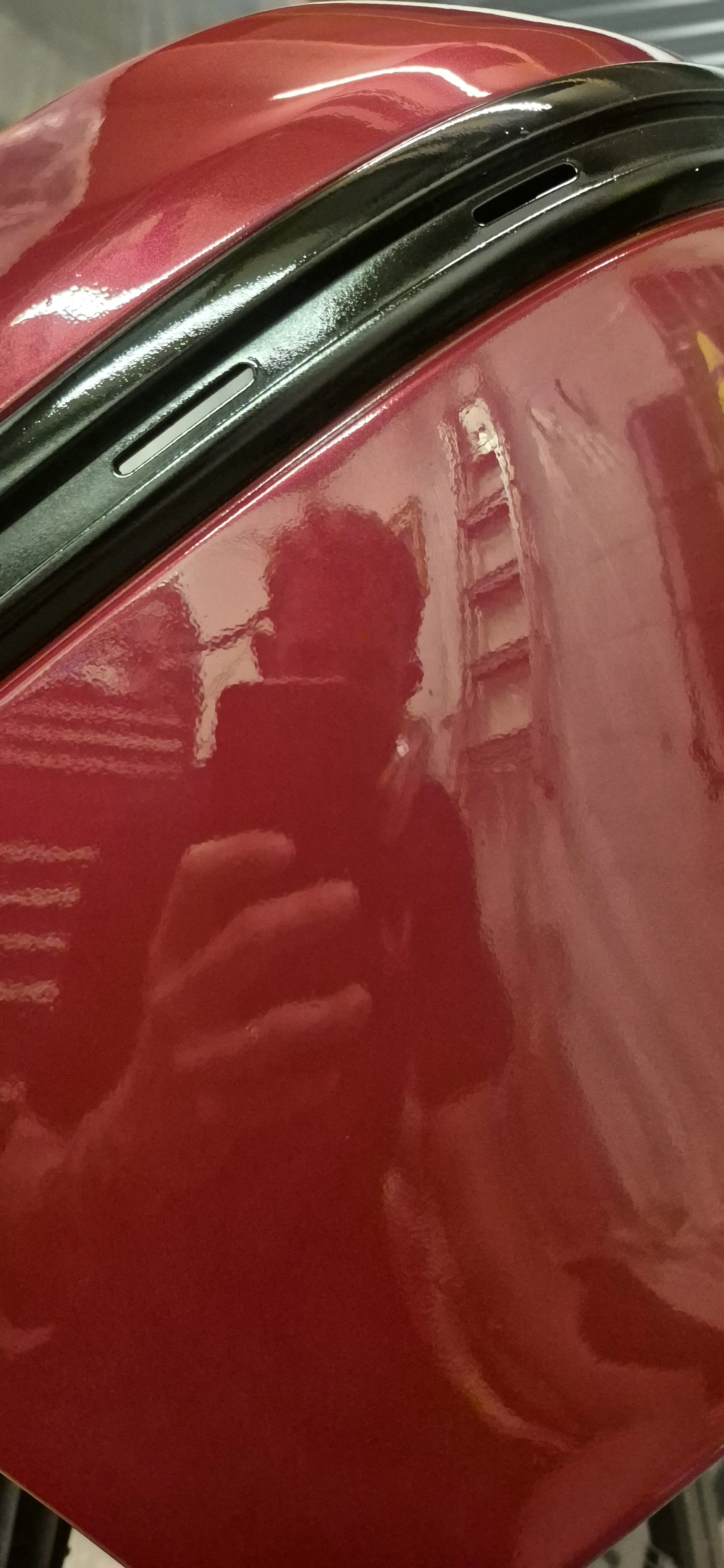

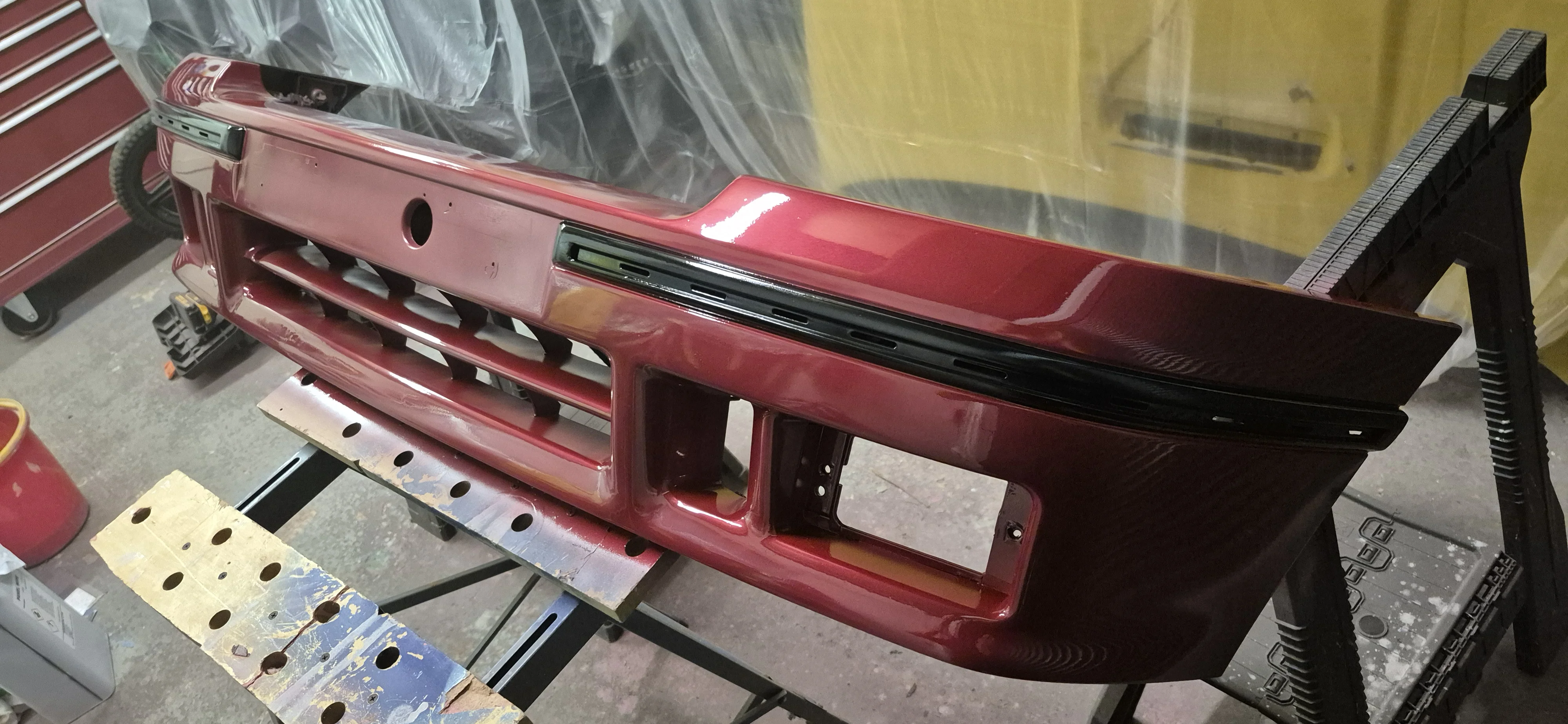

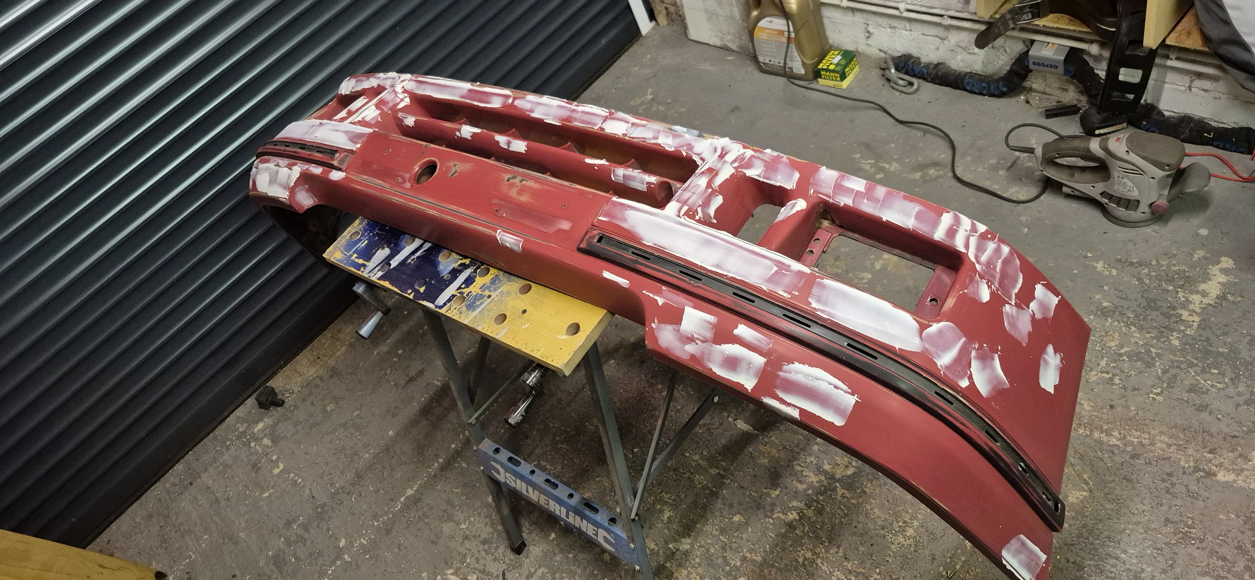

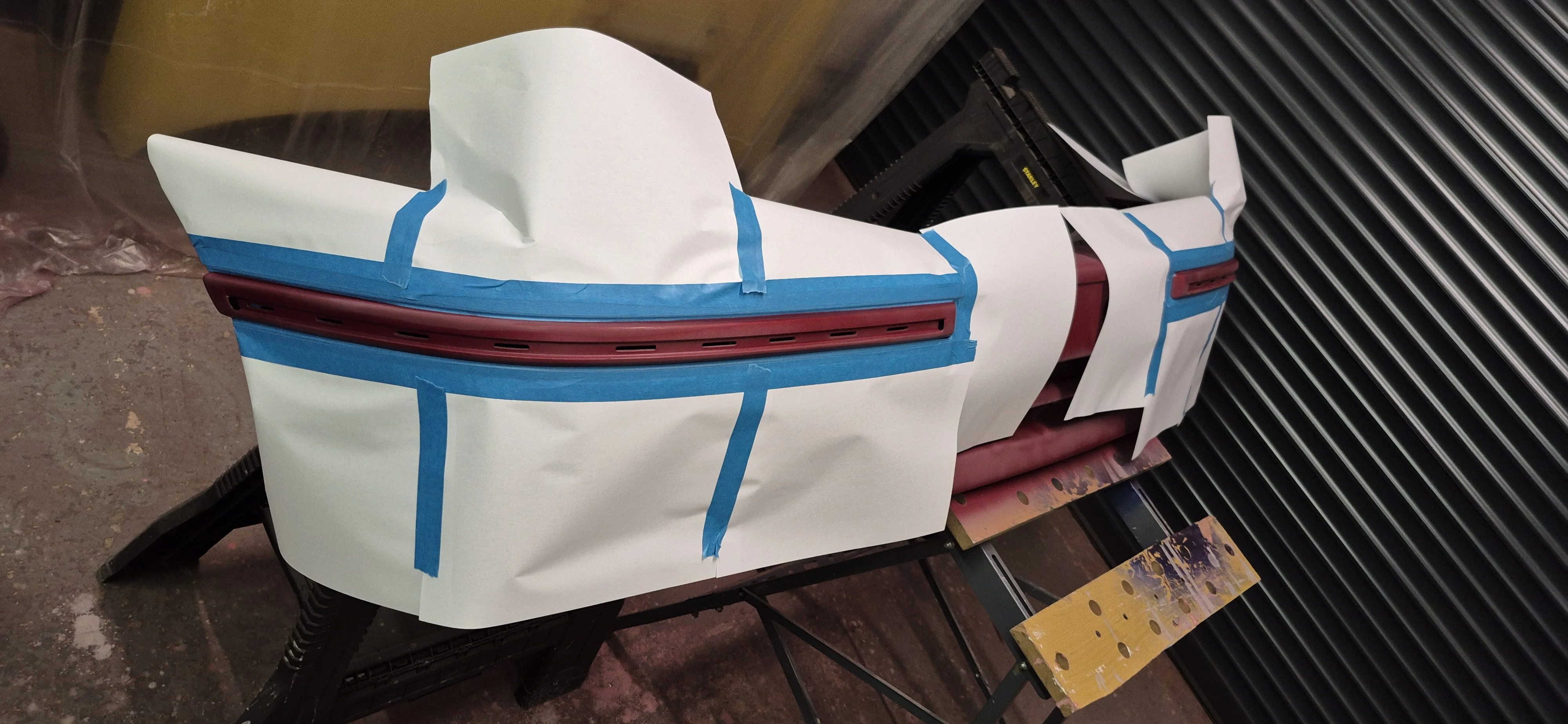

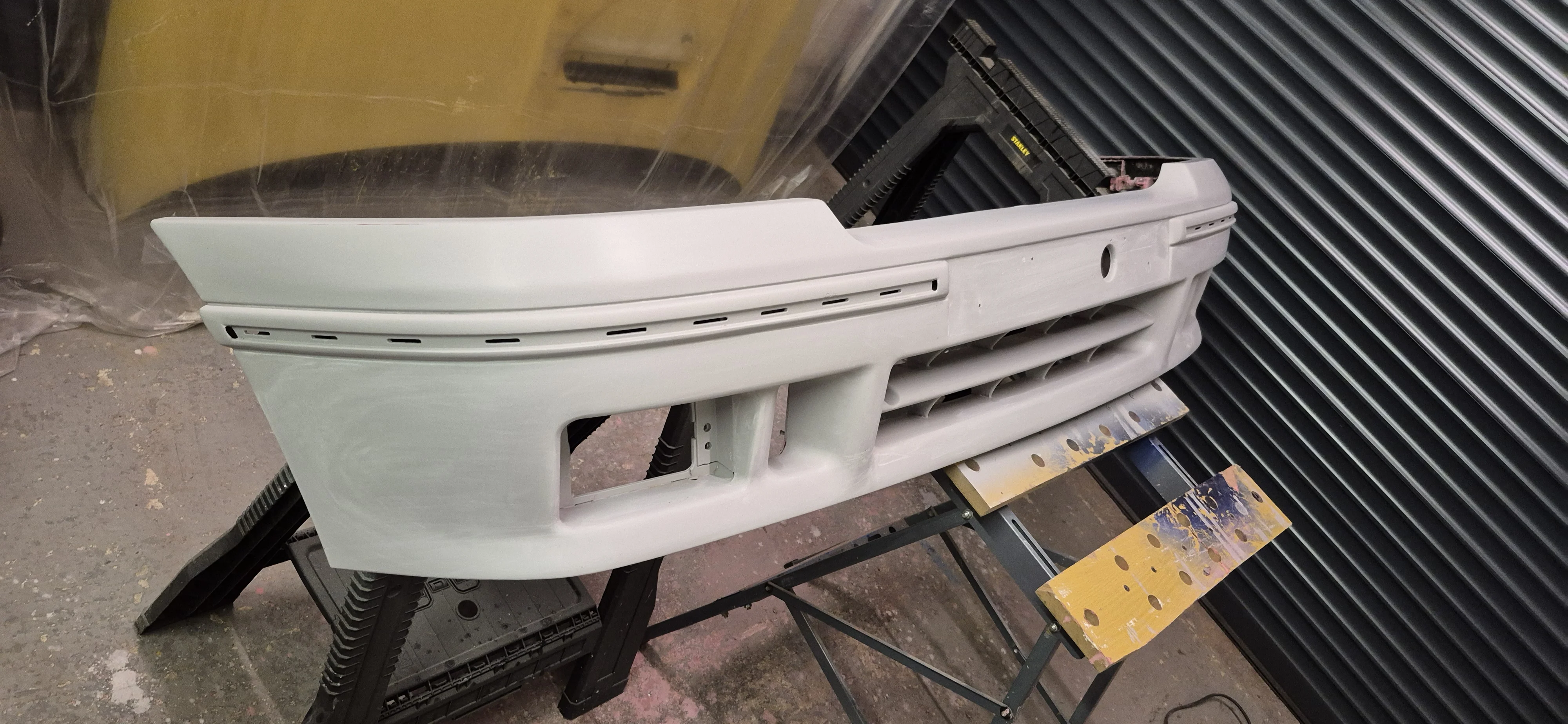

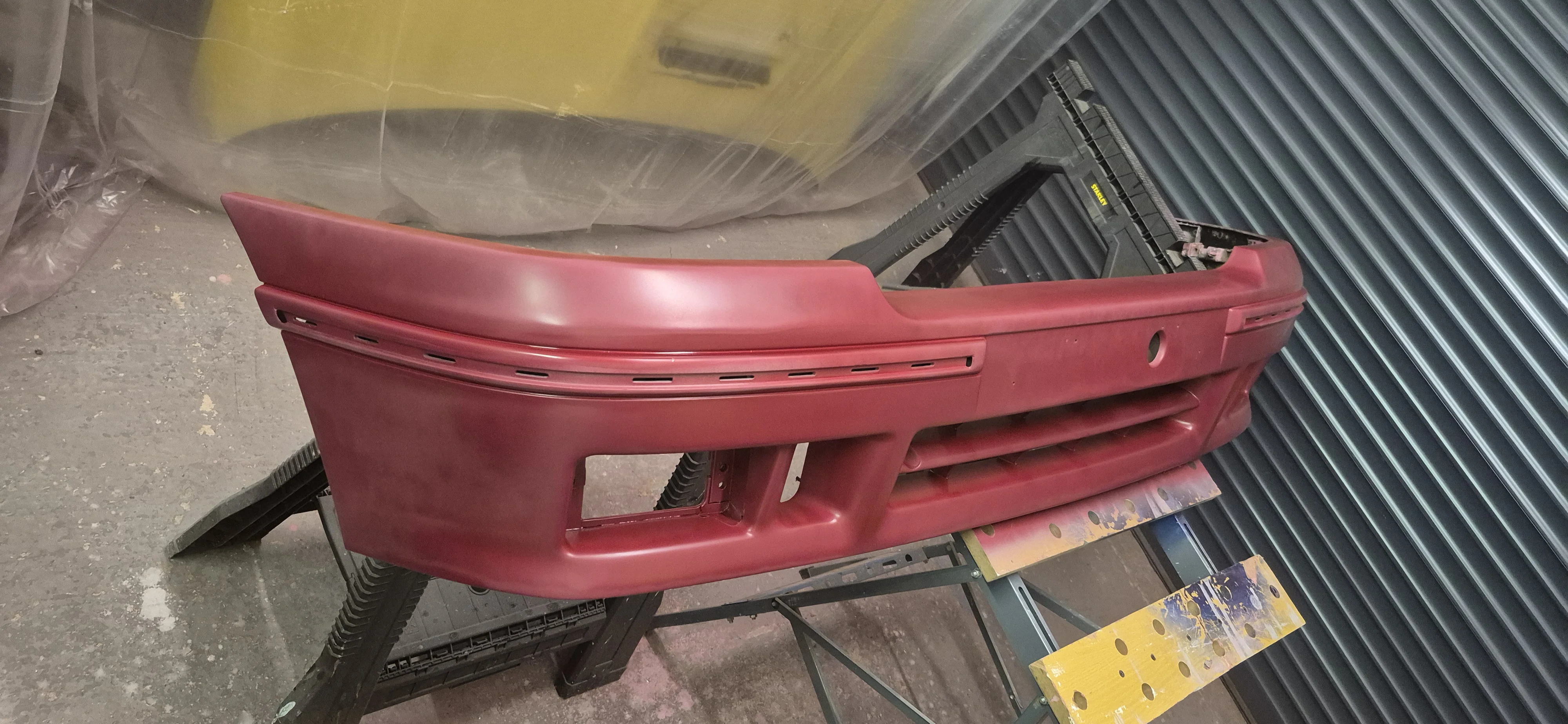

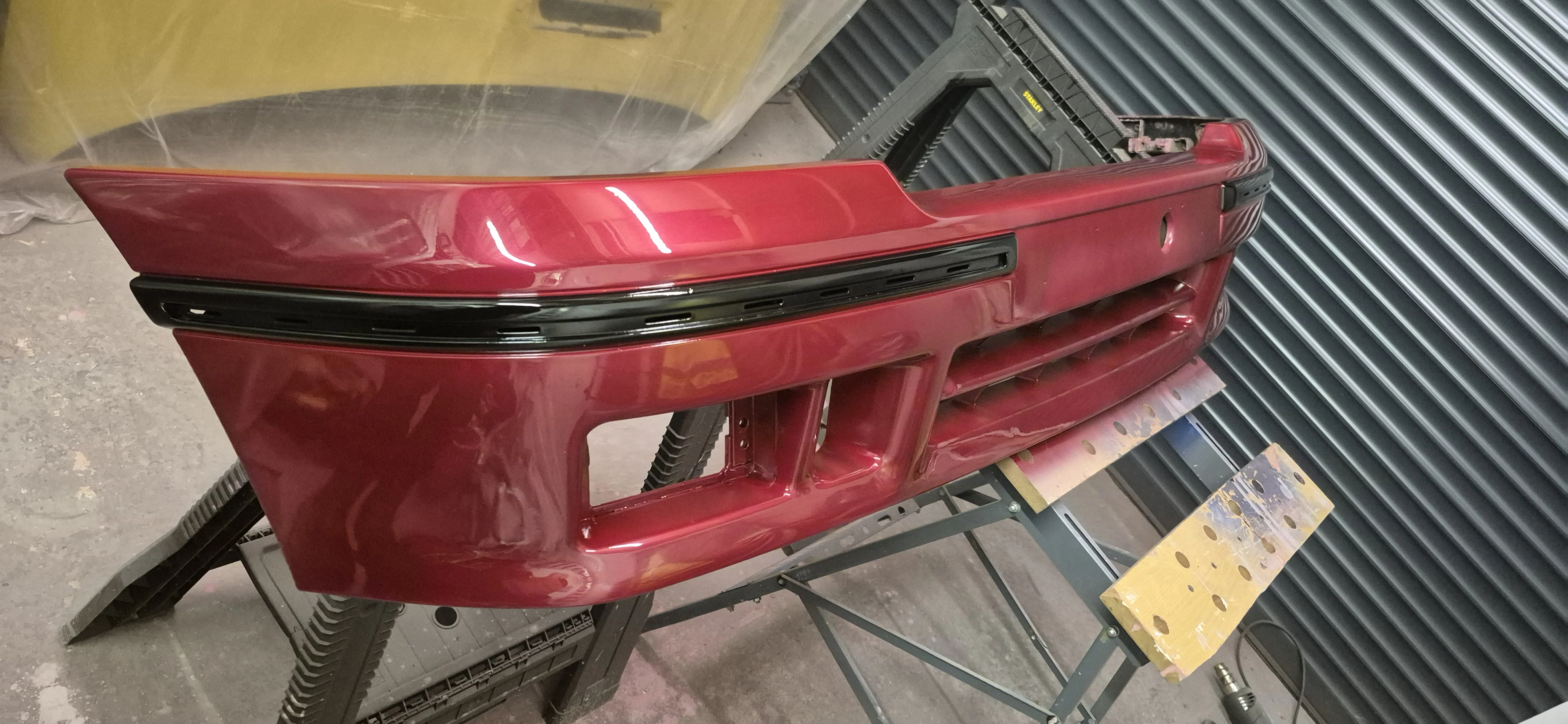

Next I tackle the bumper and bonnet. Luckily the car came with a spare boot, bonnet and front bumper. I stripped the bootlid and drilled off the hinges and scrapped the rest, it wasn;t in good condition and I don't have the space for it. I decided to rub down and tackle the bumper myself.
It isn't perfect but I am pretty happy with how it turned out on a rattle can job (plus have you seen the rest of the car? :ROFLMAO:)

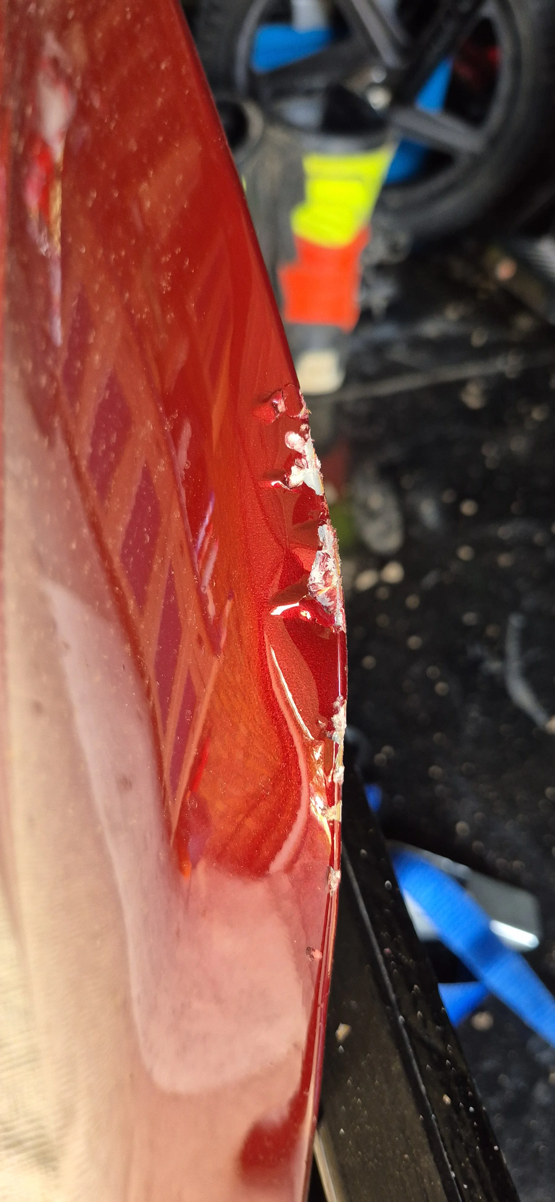

I don't have any picture of the resprayed bonnet, but I do have picture of it 4 days after collecting it after I dropped it right on the corner whilst trying to fit it on my own :mad:
Many swear words were said.
I will straighten that out and and touch it up another day, for now it is back off and in the garage as I need to do some work on the engine anyway.

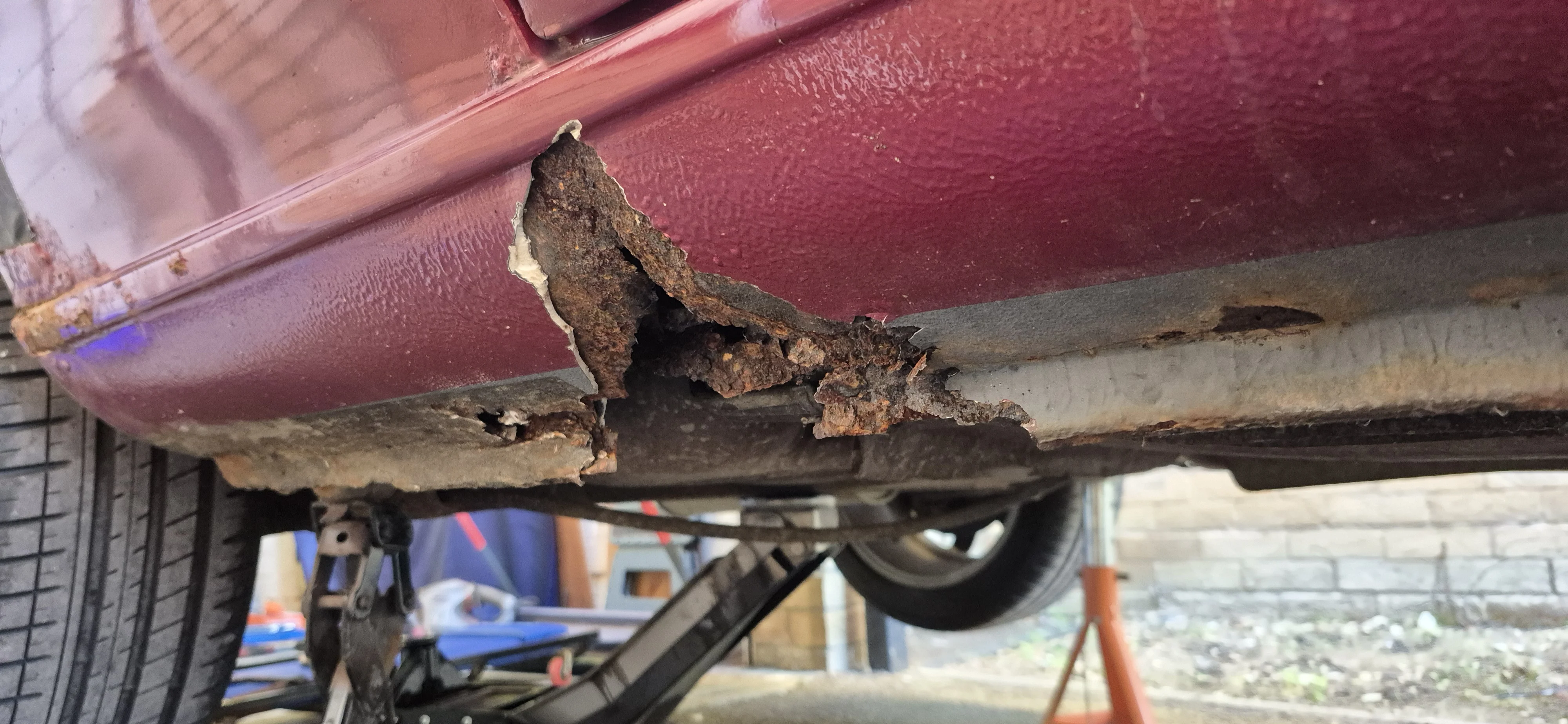

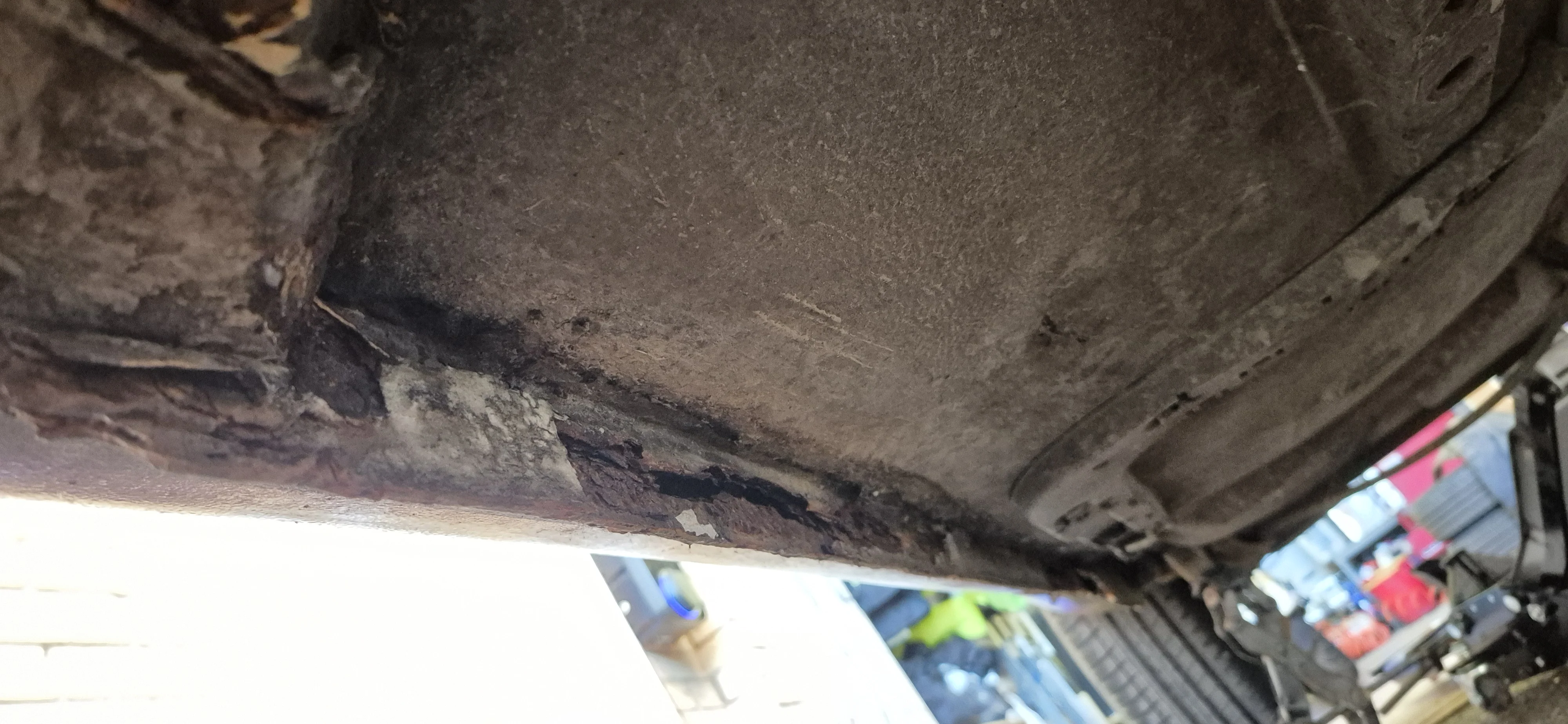

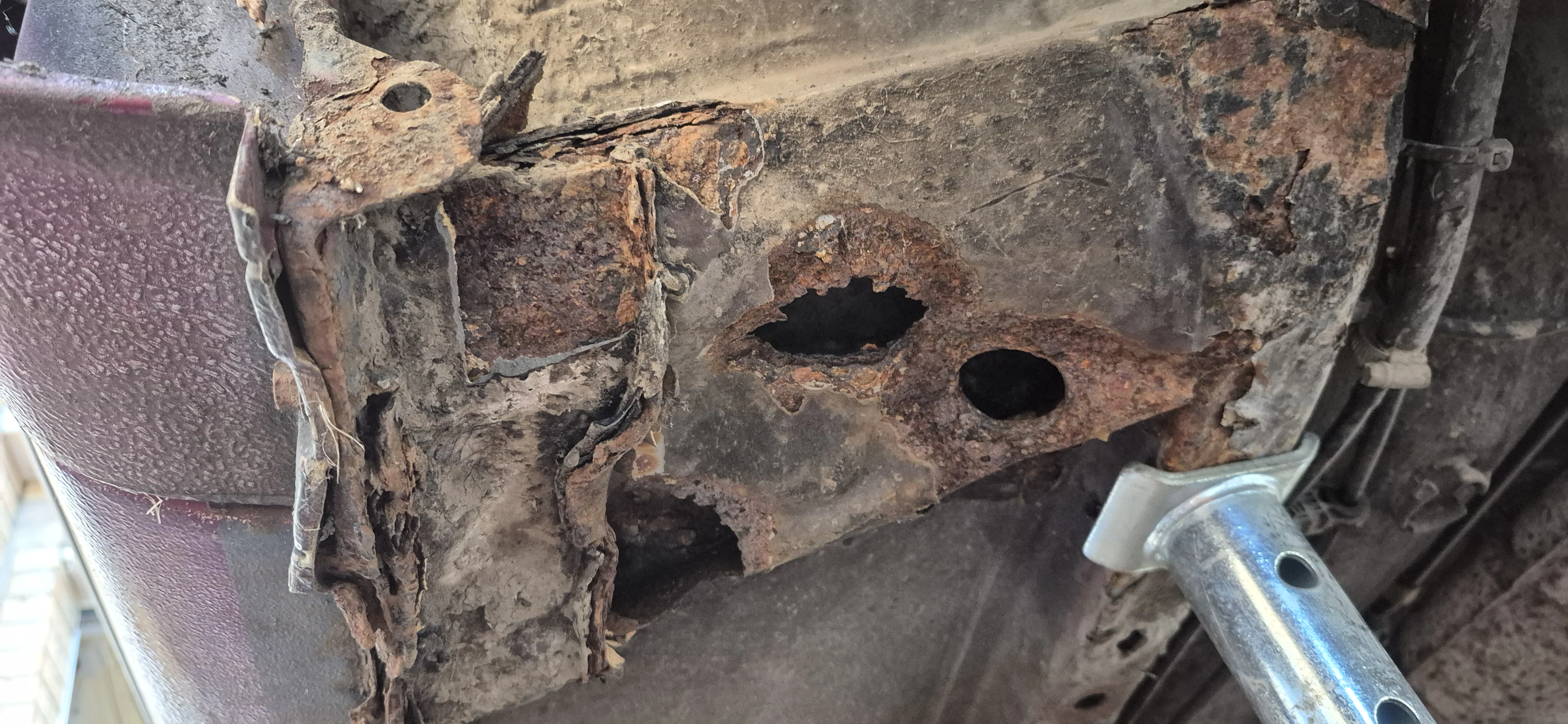

Time for a poke around underneath to see how bad these sills really are...that was a mistake.
Well there goes the 'not a big project' then. Needs front and rear jacking point, inner and outer sills on the drivers side. Passenger side it a lot more solid at the front but needs a repair to the inner and out sill towards the rear arch. So this work will be carried out over the winter with the aim to have it all done and MOT'd for the spring. It is disspointing but it is probably my fault for digging too much with a screwdriver, and I would rather just get it sorted now than let it get worse.

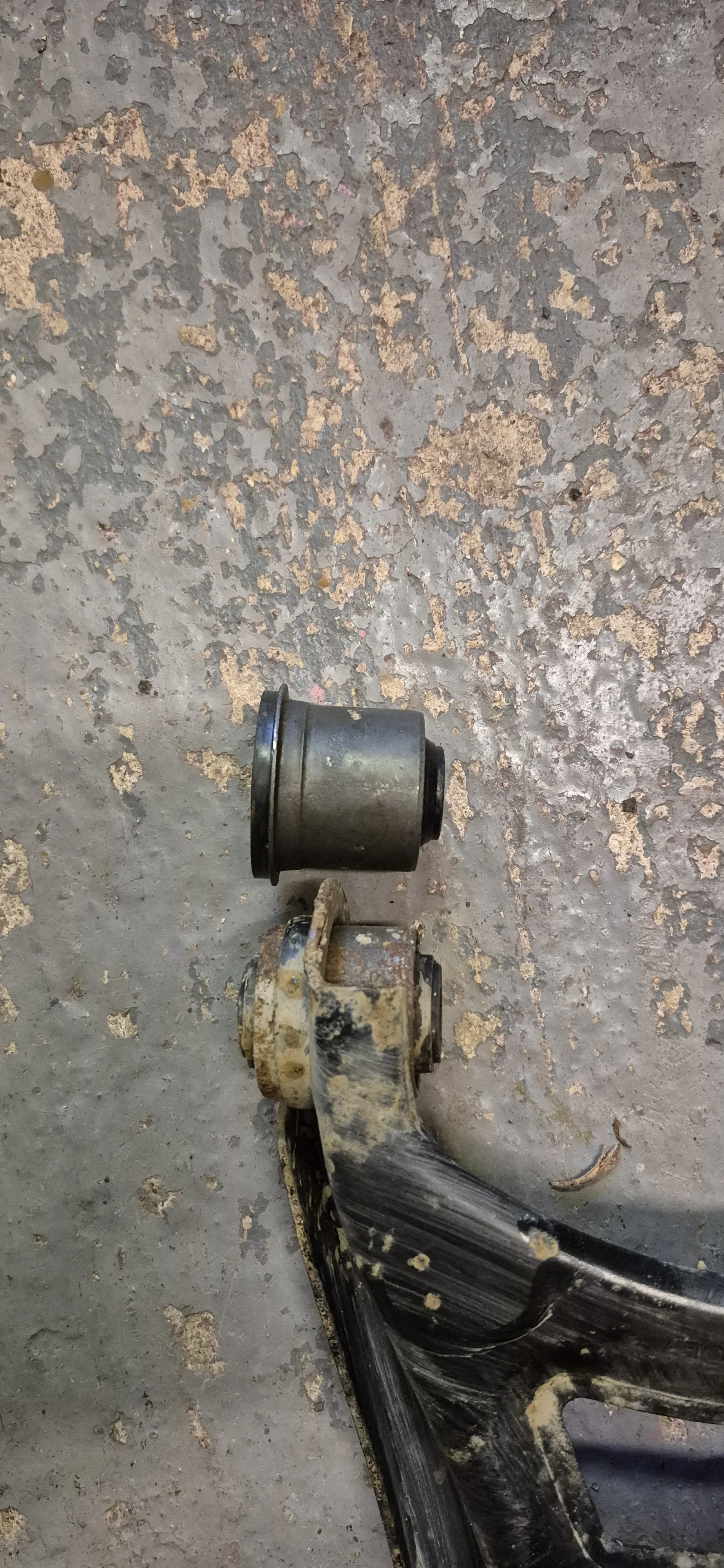

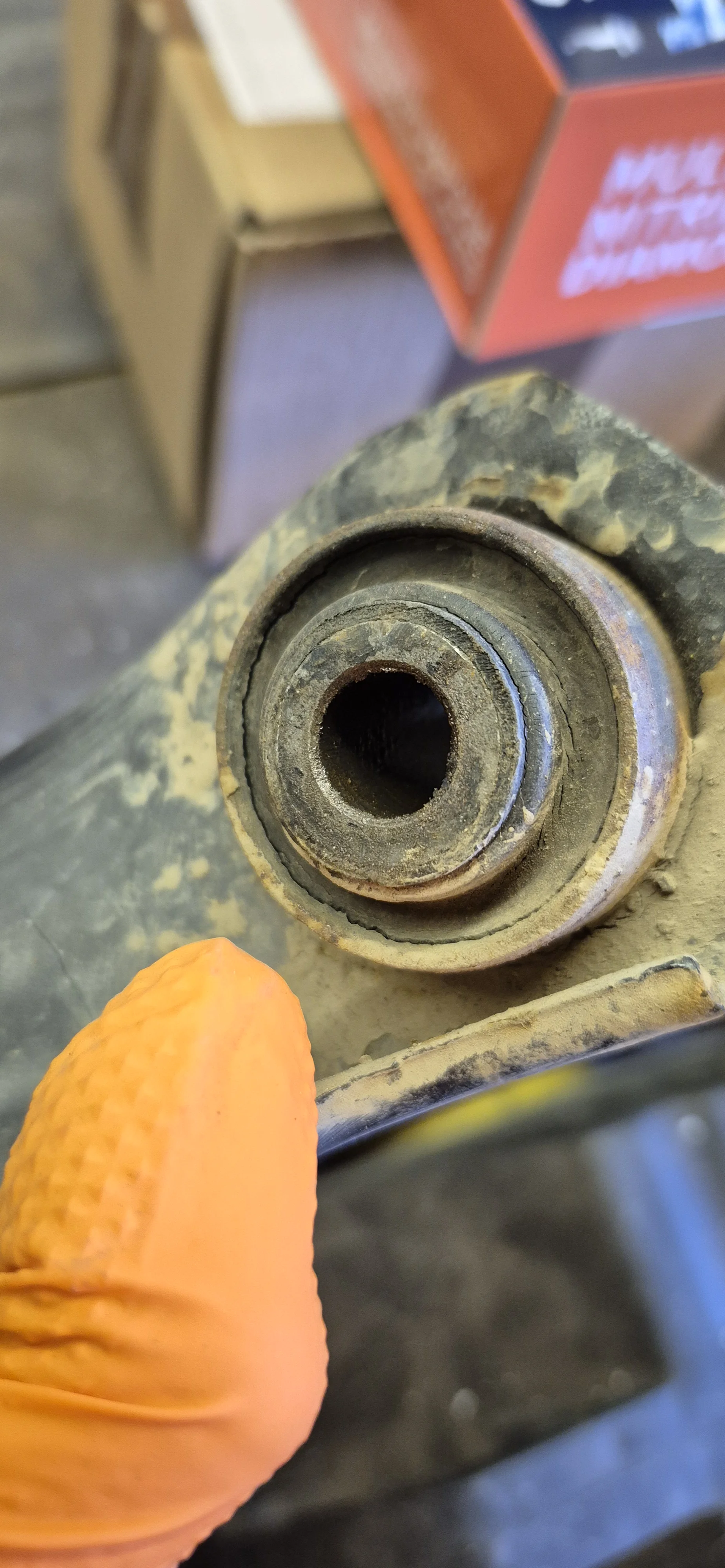

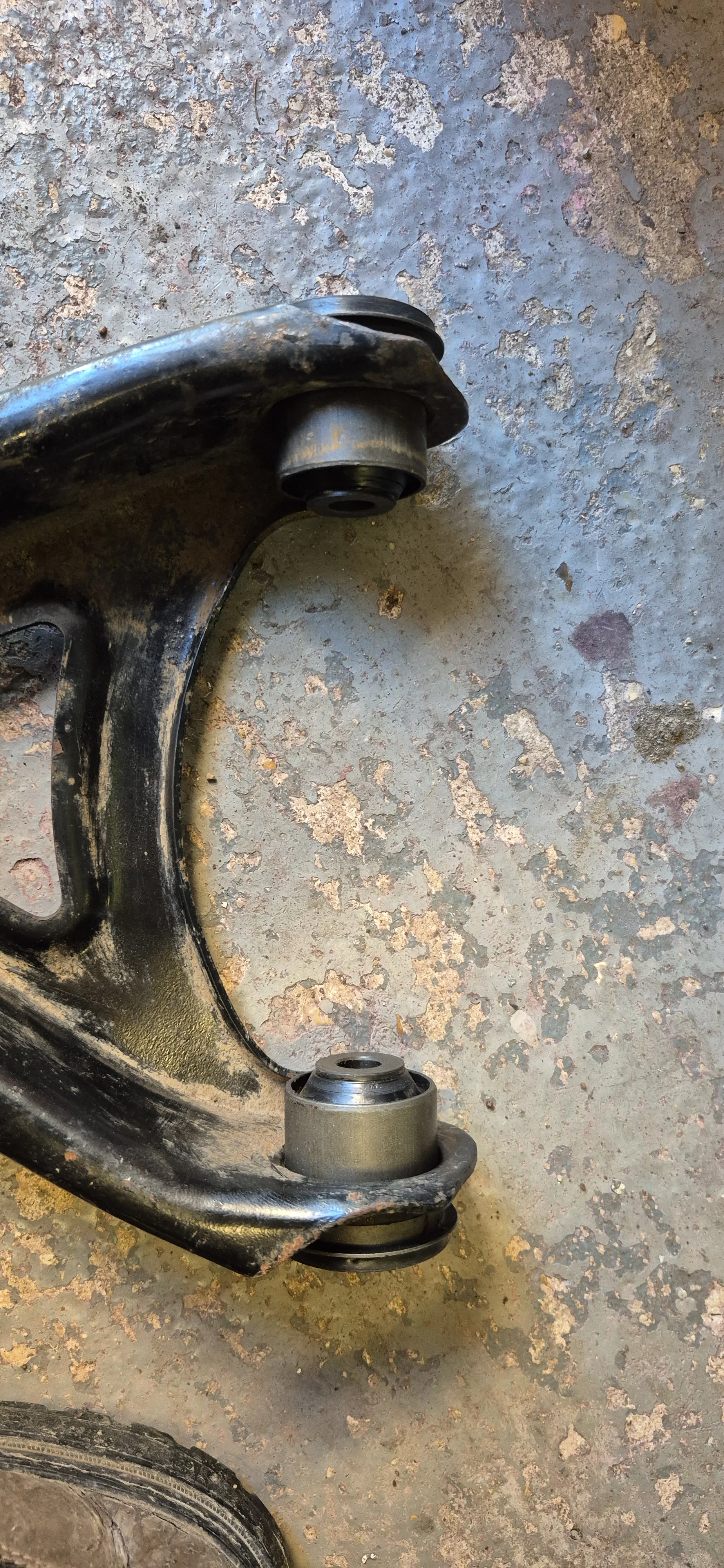

Whilst I was under the car I noticed the front wisbone bushes were perished, so I had them off and replaced the bushes. I was looking to replace the whole arms but couldn't find reliable information on the correct wishbones. Most websites insist that all MK1 wishbones are the same including the williams, some websites same all the same except 16v and williams which are the same etc etc, so I just decieded to replace the bushes.

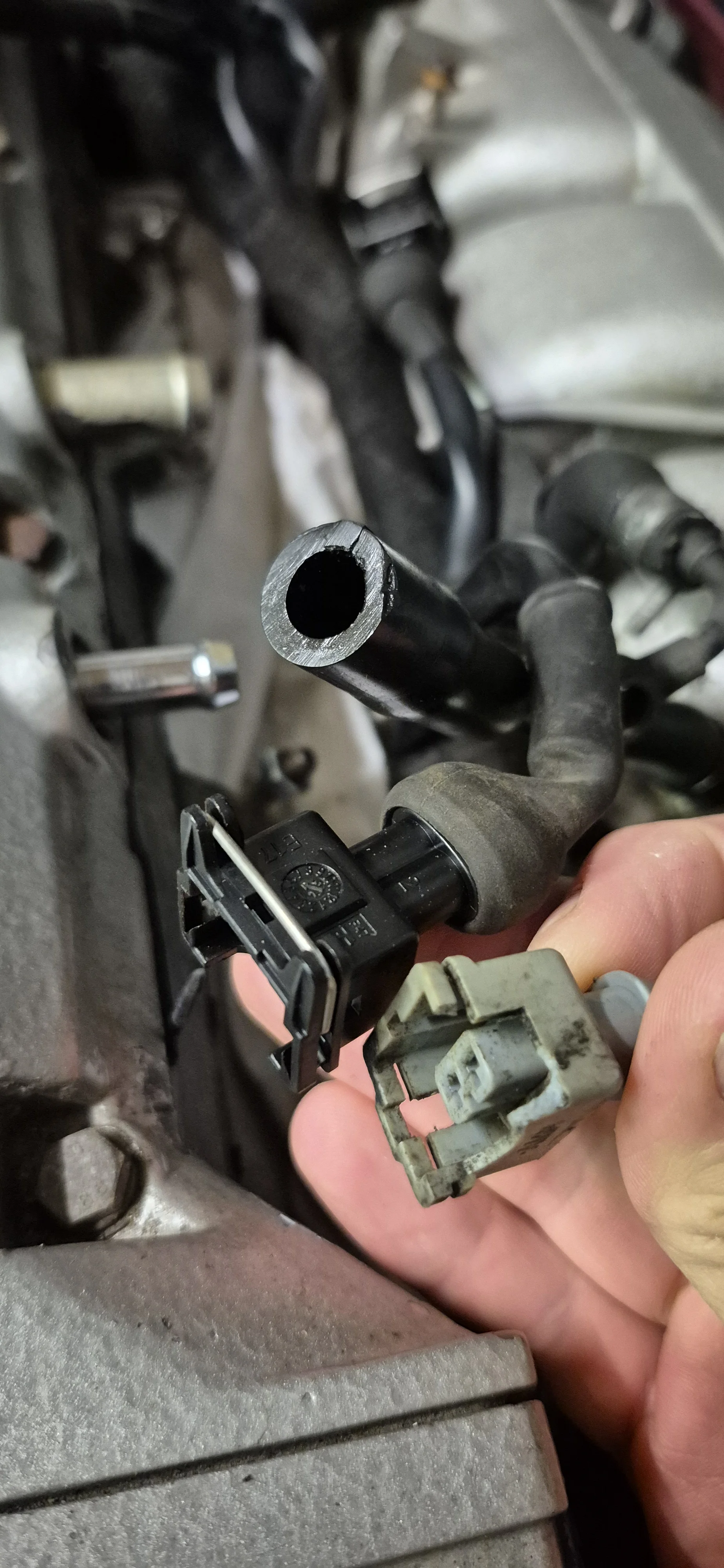

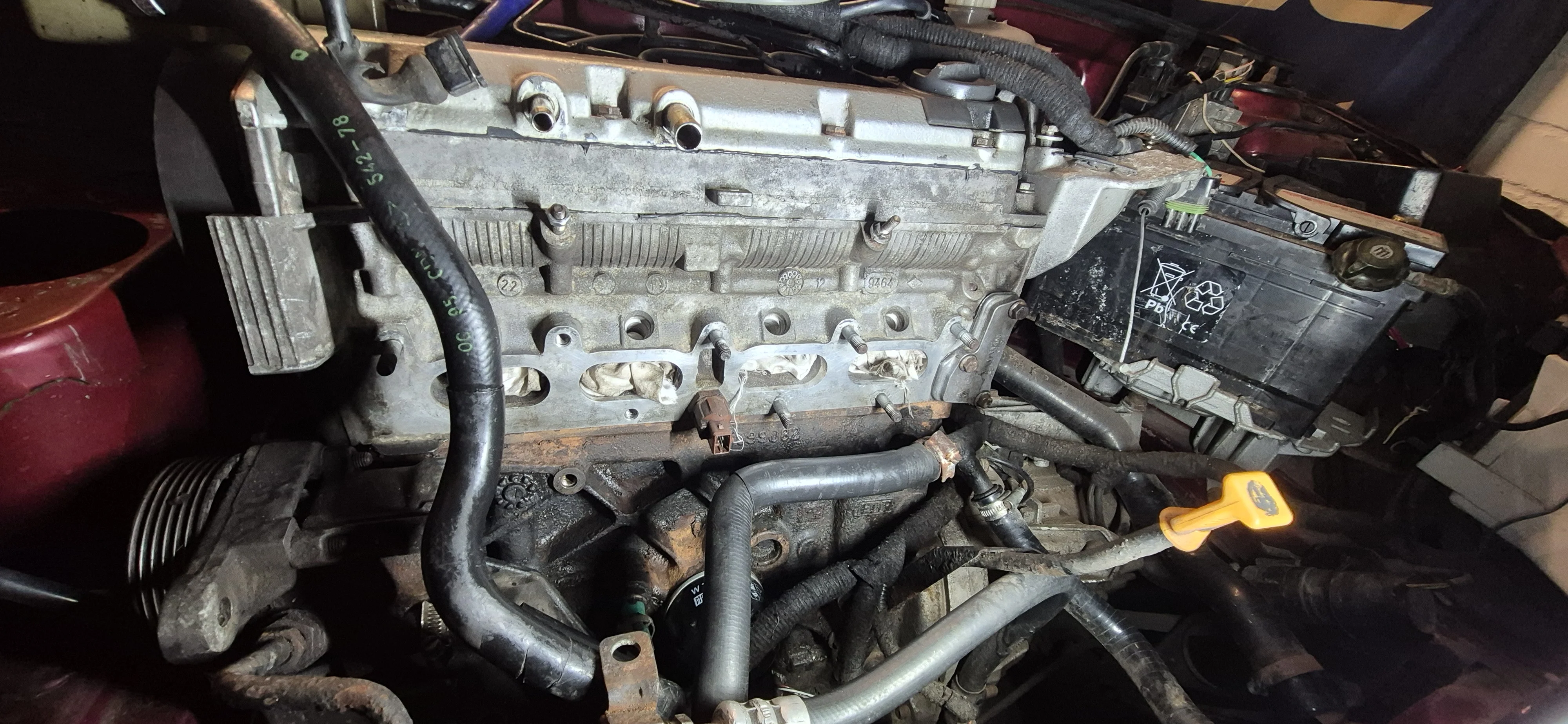

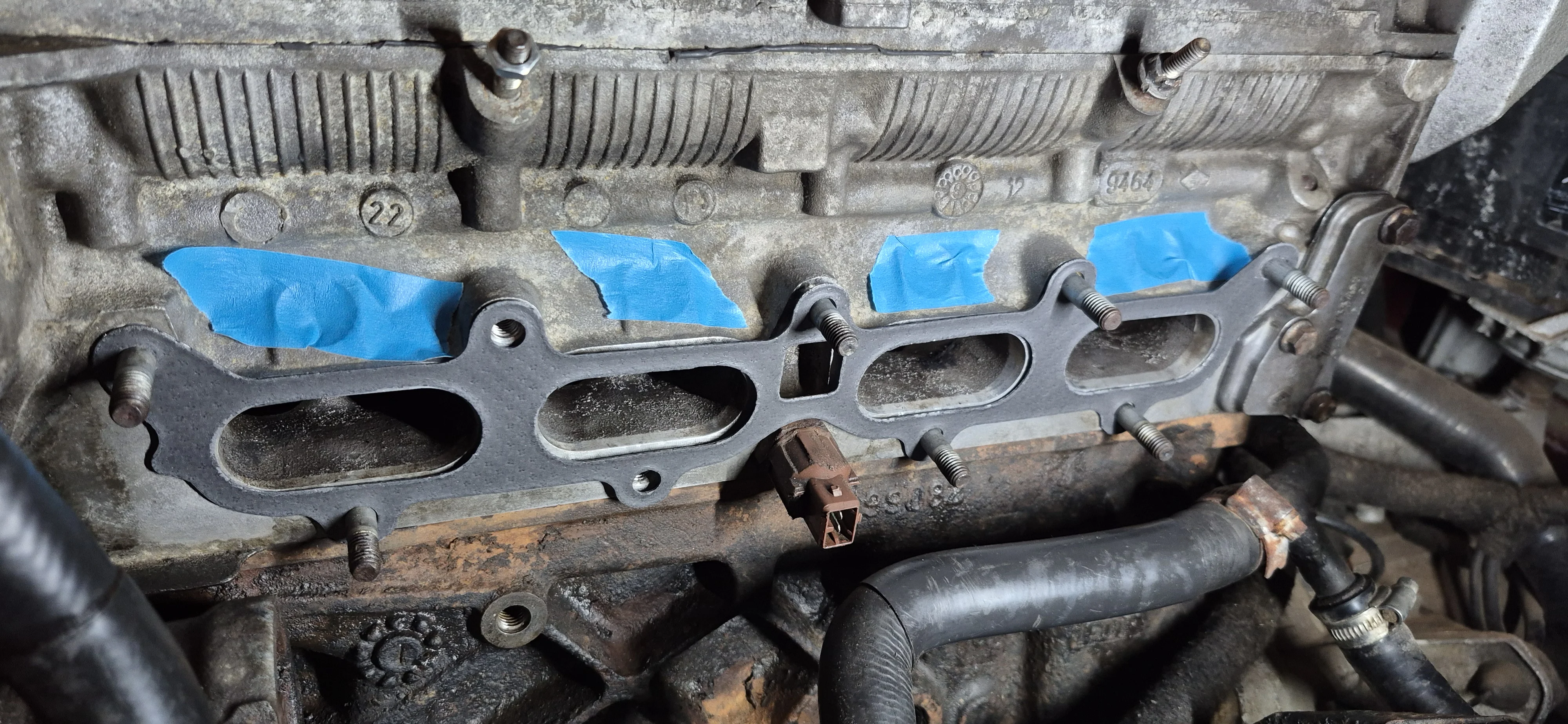

I investigated the whistling noise convinced it is an air leak in the vaccum system as it is come from around the inlet manifold somewhere. After a comment from my wife about how strong it smells of petrol after running I thought hmm you're right and had a look at the fuel injectors. Maybe a little bit wet but not too bad, but with the engine running a squirt of WD40 around the no4 injector changed the note of the whistle. So I stripped out the fuel injectors to replace the injector seals.

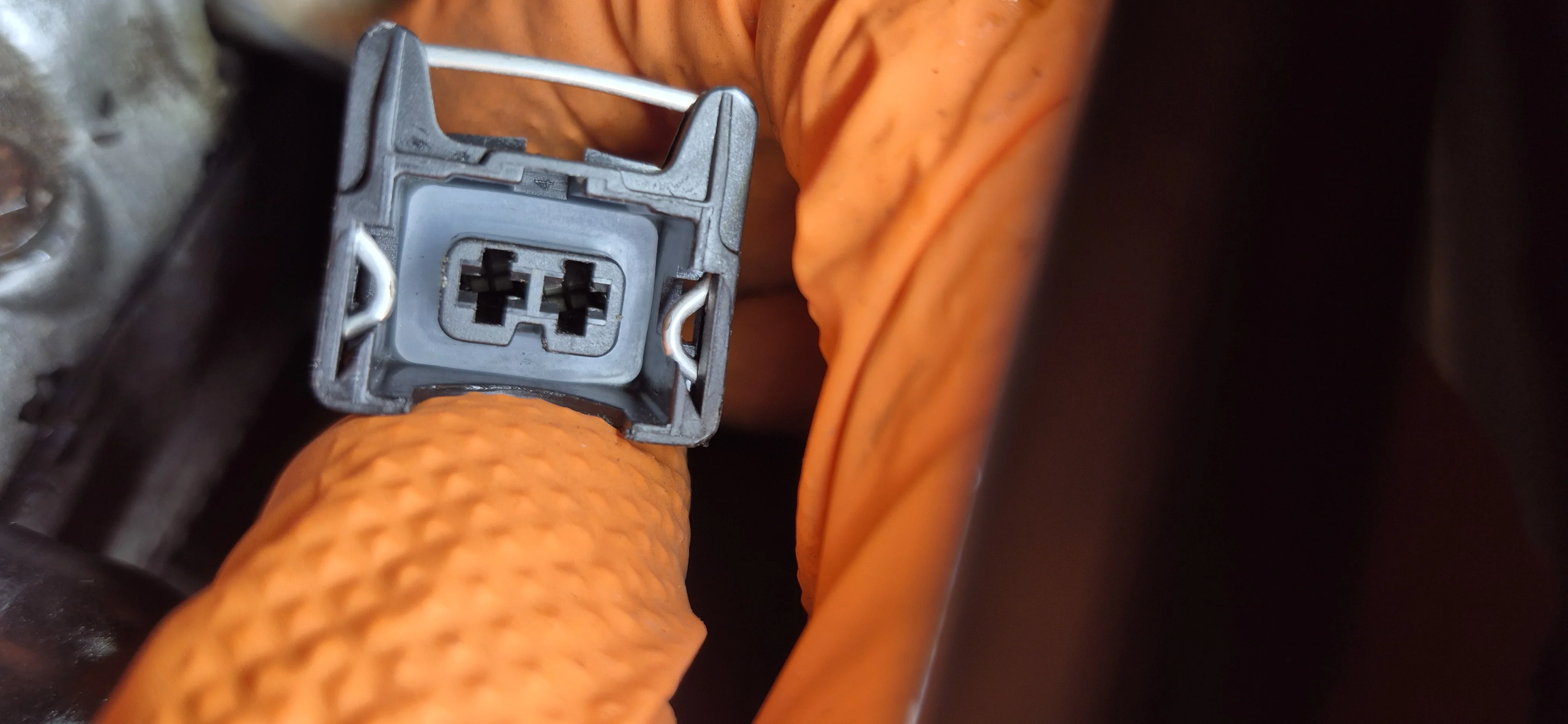

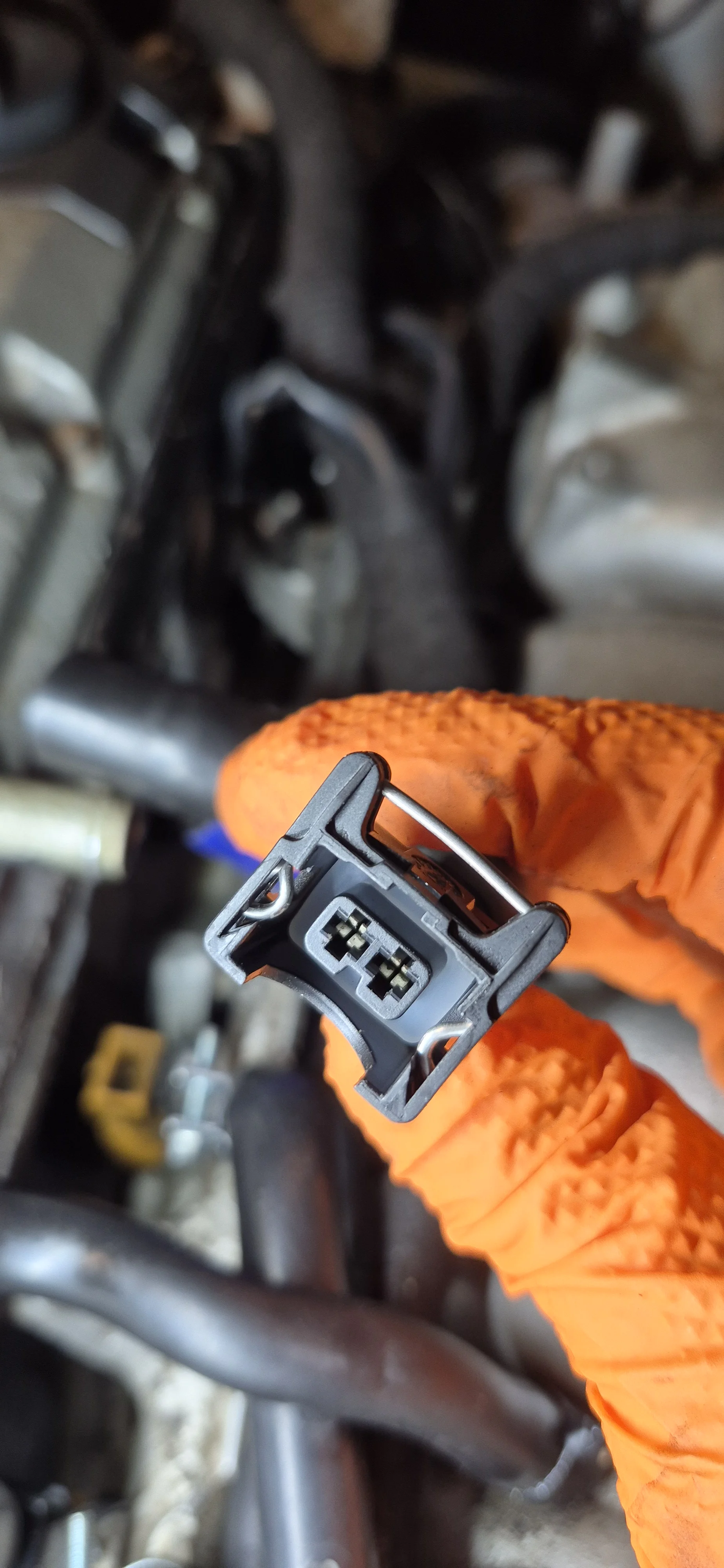

I have also replaced the injector plugs on the loom as the original plugs were brittle and broken

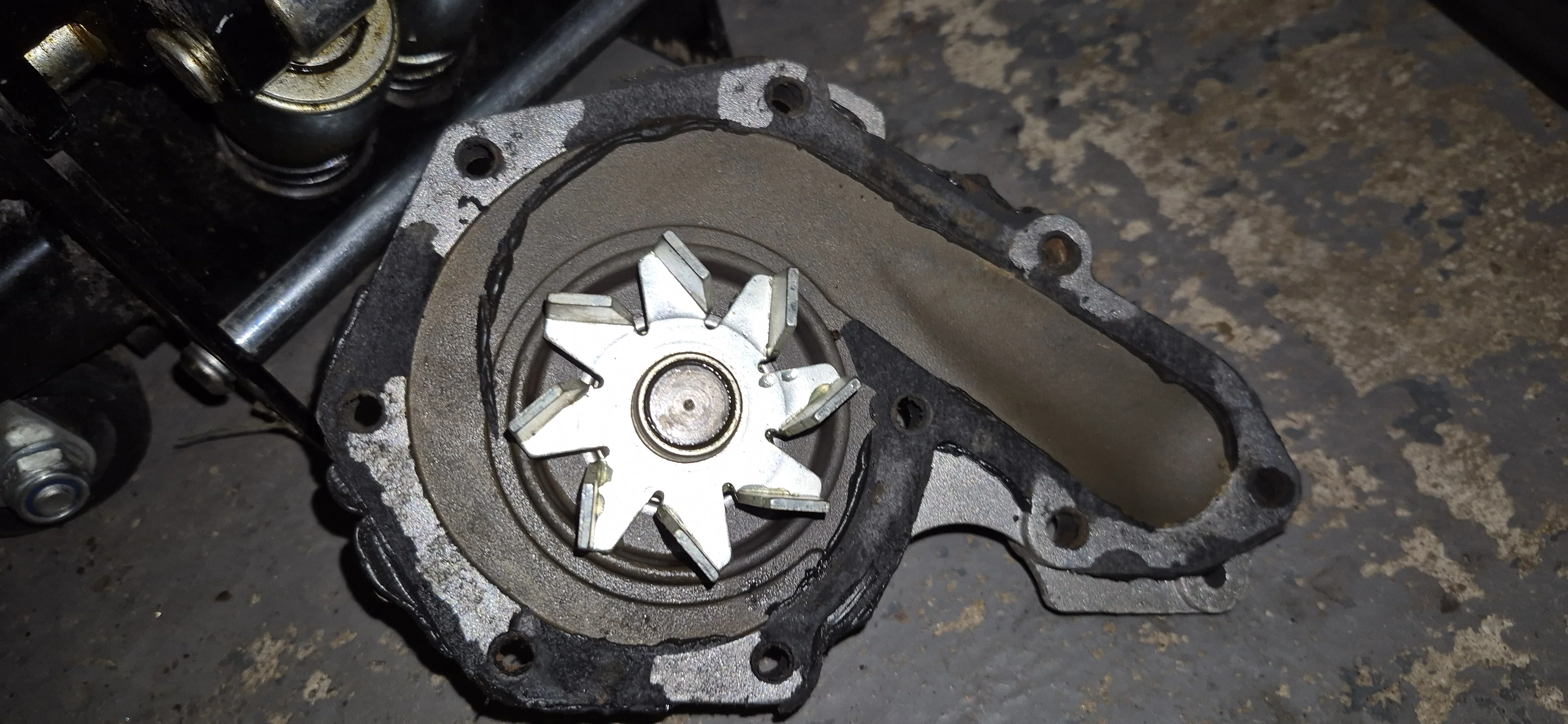

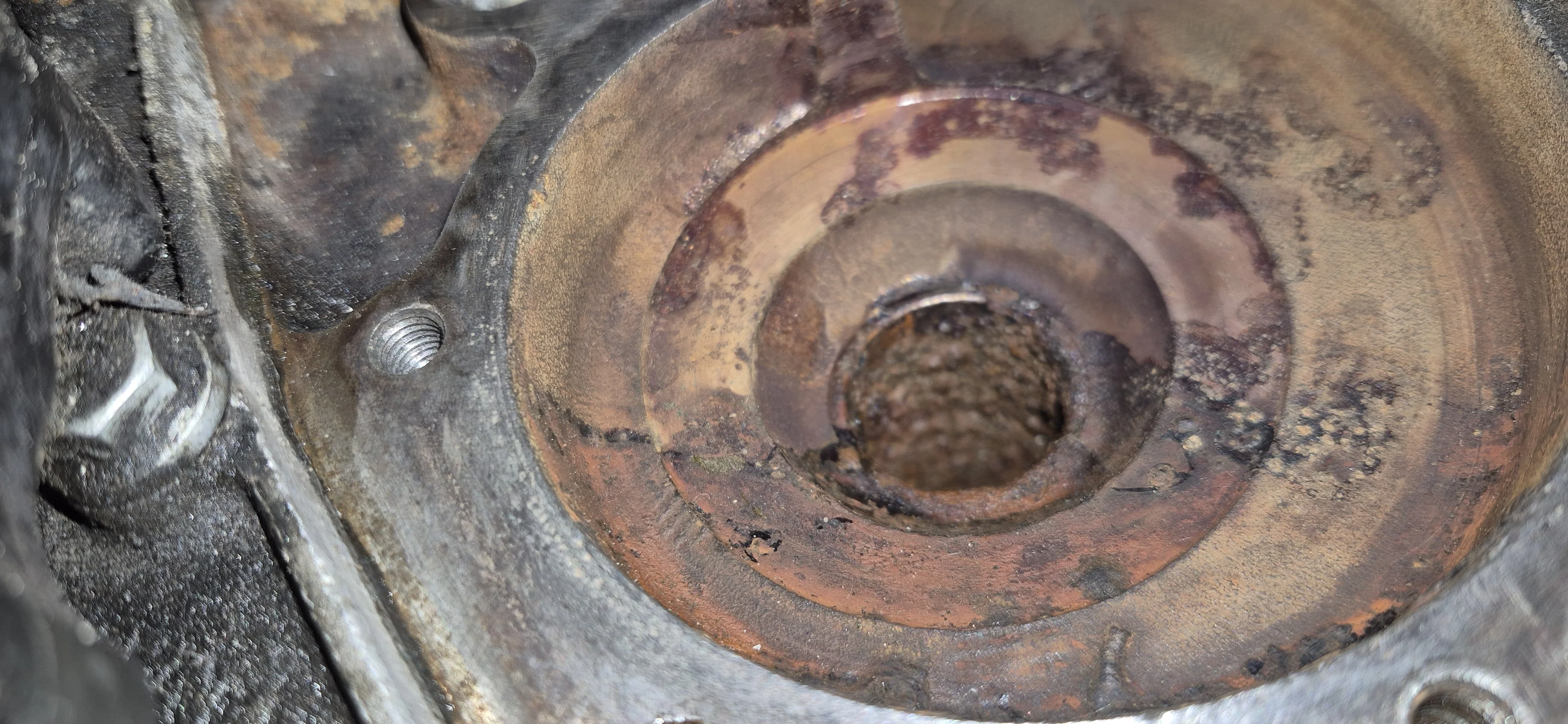

I also carried out a smoke check on the intake and it is leaking slightly from the inlet manifold area, so as you have to remove the injectors to remove the inlet manifold I figure I may as well do this at the same time. And as I have to drain the coolant to remove the radiator to remove the inlet manifold I may aswell do the timing belt and water pump.

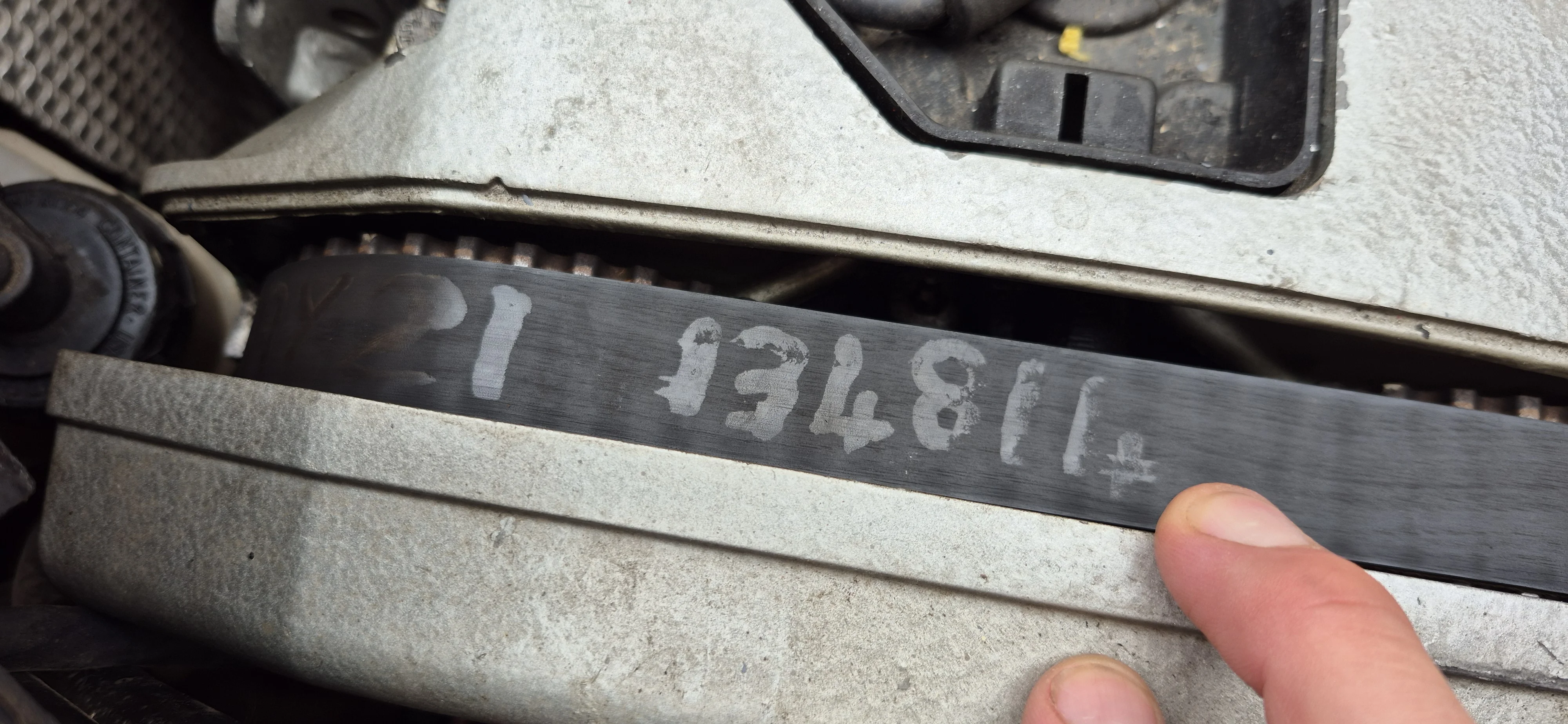

I had already had a quick look at the timing belt to see what condition it is in, helpfully the last person to do it wrote the date and mileage on it
May 2021 and 134K, so it has barely done any mileage since, less than a thousand, But it is over 5 years old and it will give me peace of mind to change it.

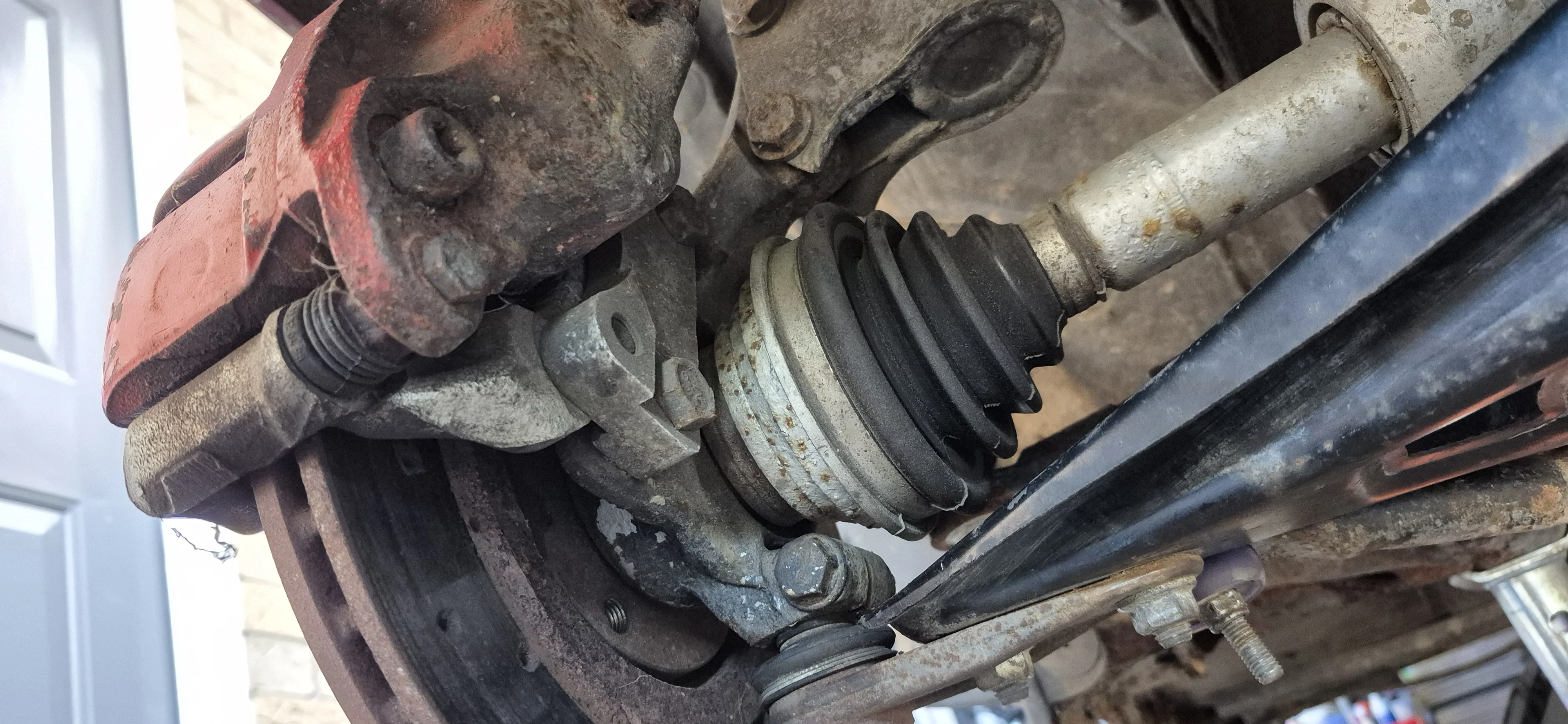

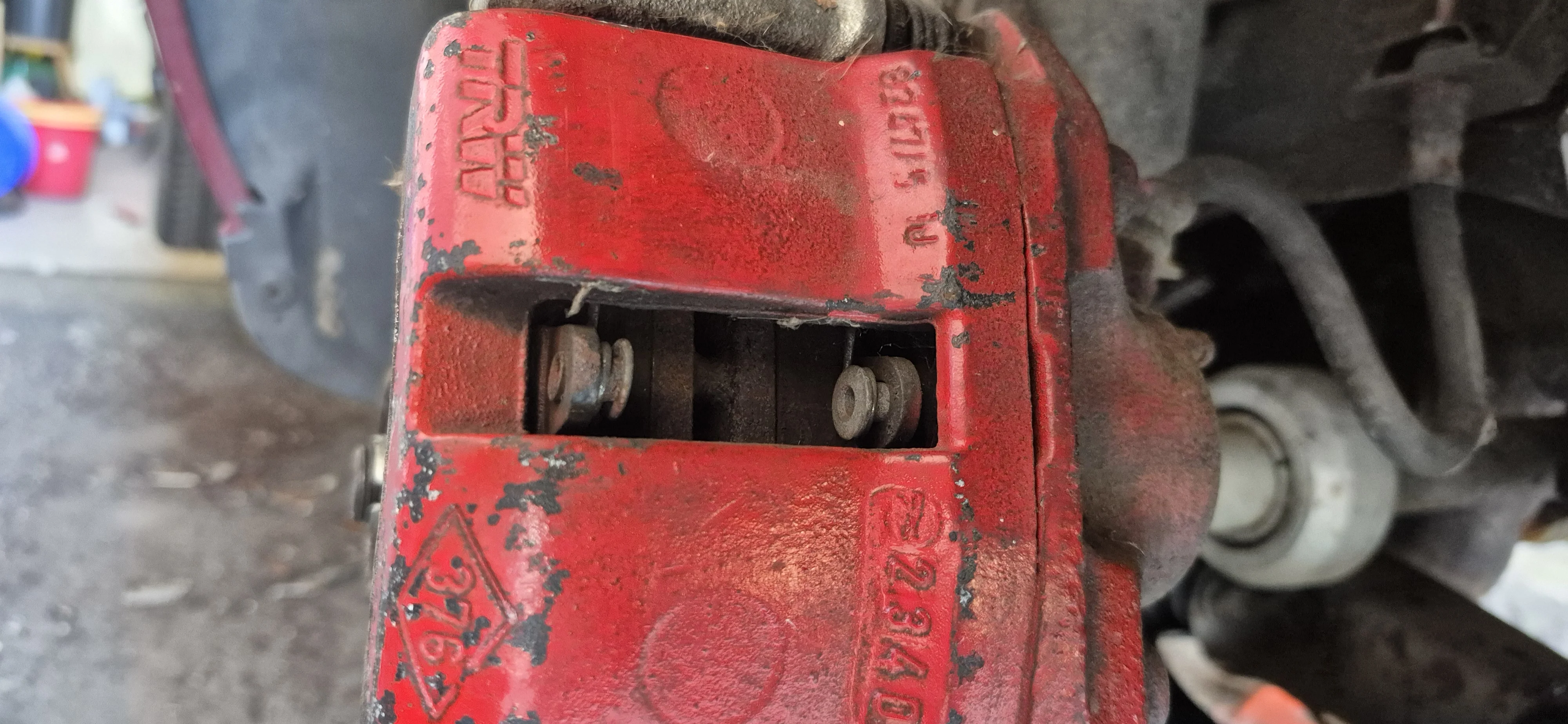

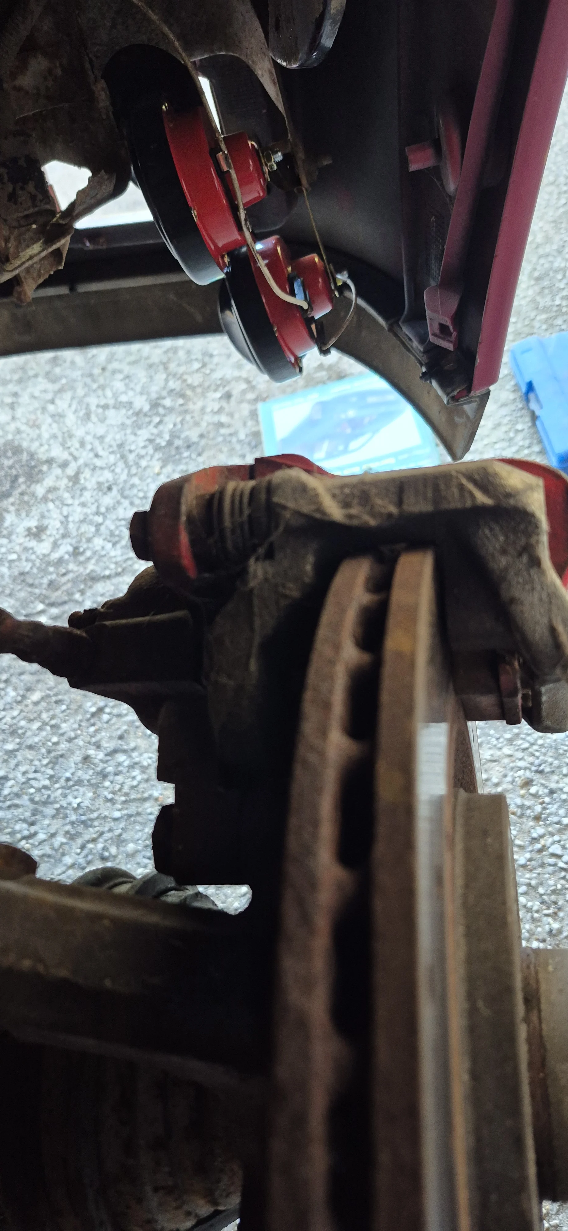

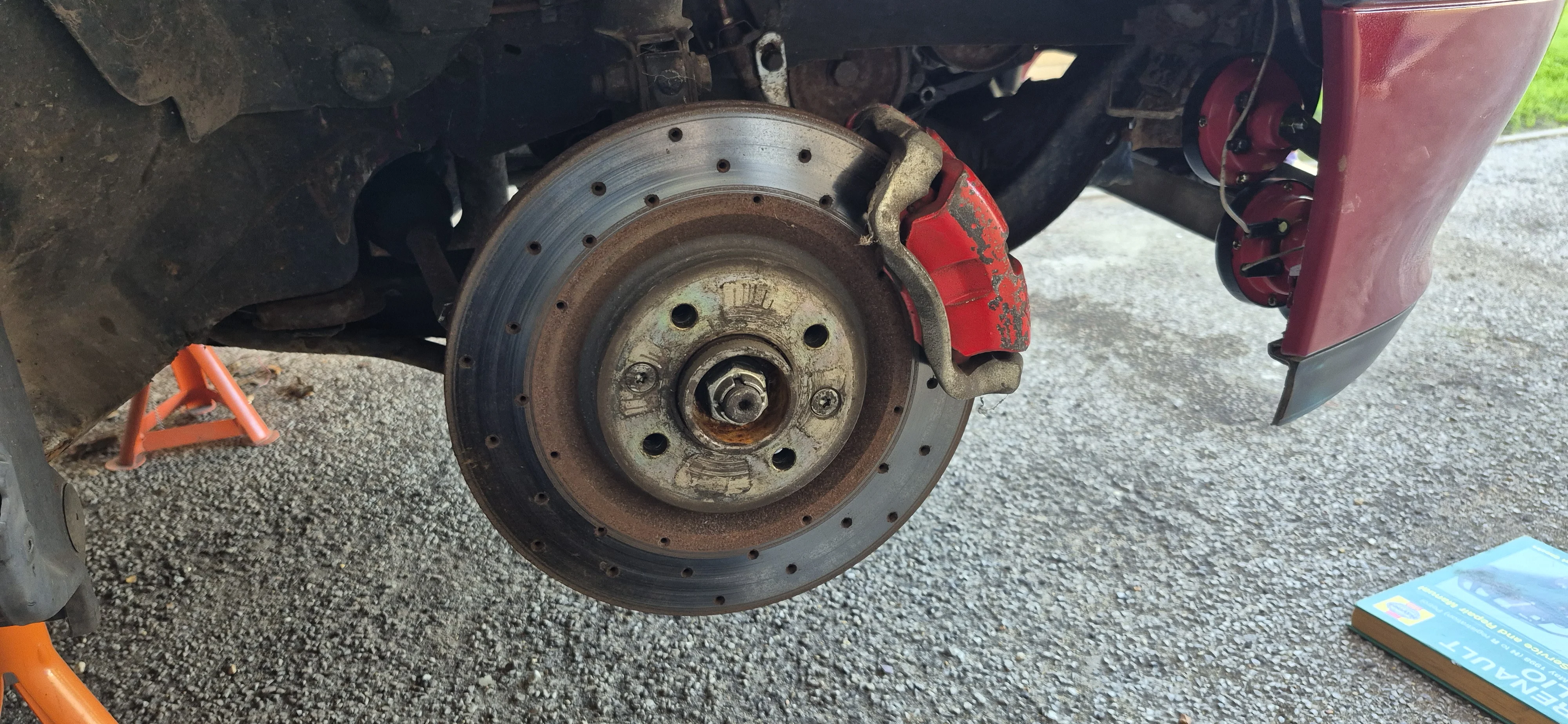

Whilst I was doing the wishbones I noticed the brake pads are clearly too small for the discs. Quick look at the haynes manual says the discs should be 259mm diameter and these are 285mm.
Can anbody shed any light on this? Do these look like the original hubs/calipers but with a caliper spacer and bigger discs? or is this set up from a different model?
