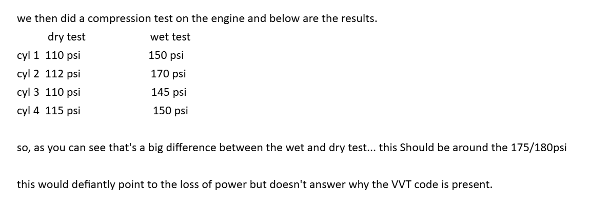

  • Garage 1 (Aug 2024) suspects that worn piston rings are causing the low compression and lack of power (Readings attached) and that an engine swap would be the most economical solution
  • Garage 2 (Sep 2025) thinks the piston rings are intact, and the low compression is caused by either the ECU or a broken camshaft

Compression test results are not good, if the test has done properly.
When was low compression verified, before or after cambelt.
Sounds like last 2 garages have been throwing the parts cannon at it hoping it will work, without any real idea. Ecu wont affect compression, and if camshaft was broken then you would definitely know about it.

Compression test was done after the cambelt was fitted. It had no power loss prior to parking it up. I would have thought if it was piston rings they would degrade over time, not suddenly. It also has no trouble starting and no unusual exhaust smoke

If the rings were as shagged as they're making out, it would be consuming alot of oil, likely smoking alot, and probably have a good amount of crankcase pressure
Pretty sure the garage said crankcase pressure readings werent concerning
No smoke and has never had an issue with excessive oil consumption. I regularly check it and it barely needs topping up each time
