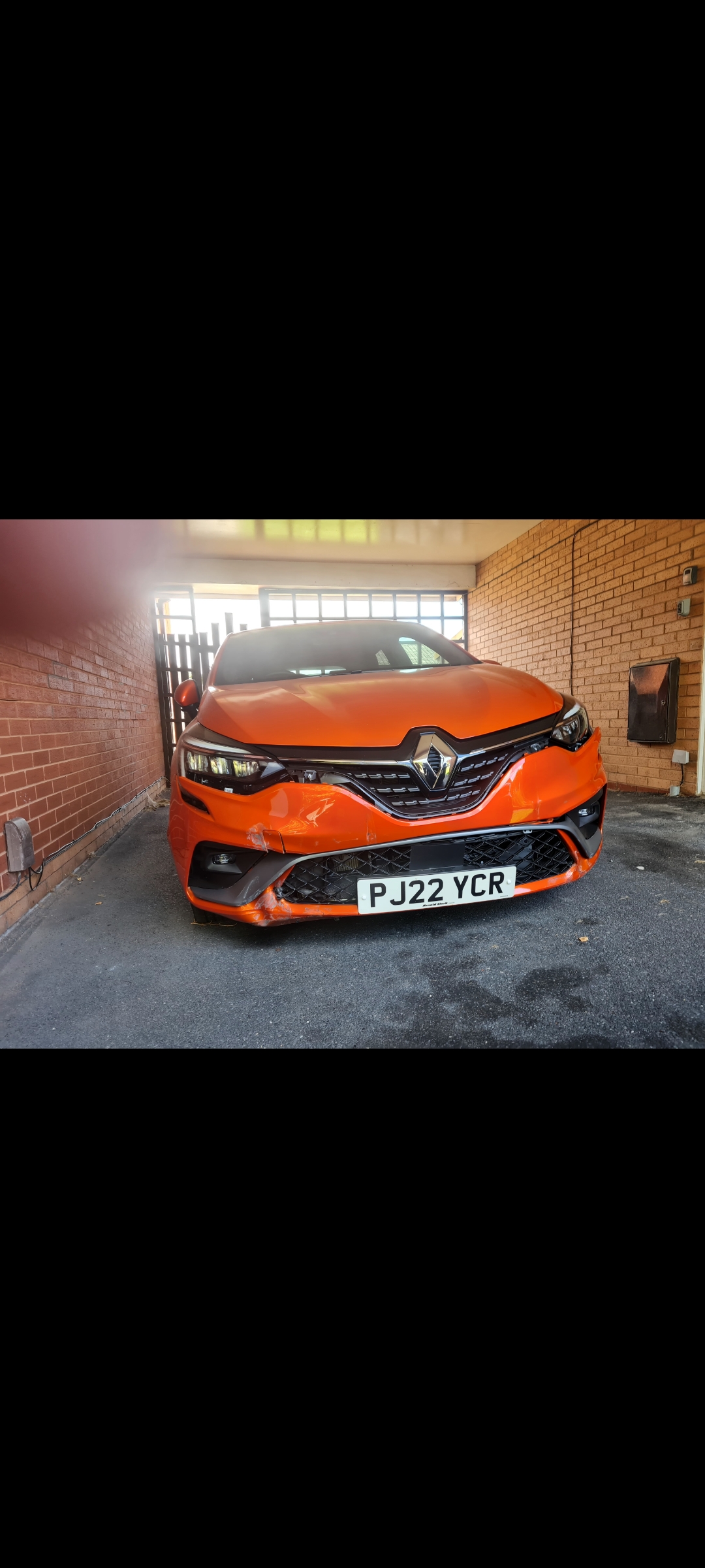

Hi all, so my Clio has been off road since 6th August, it decided to lock the steering and brakes and all I could do was hit a pole to stop the thing! Anyway this resulted in needing a brand new wheel and front end minus the wings, headlights bonnet or the plastic arches or undertray, it's been a nightmare trying to get the insurances repair management network to actually chase things such as the engineering company's report which added an extra month delay on the repairer ordering parts and even now its going to be probably end of Jan maybe more before I get the car back as apparently the parts needed are all on back order! So I've had the car since new 4 months old and these europcar cars are making want to drive them into their own stations!!! Do any of you have access to part numbers for this clio? If I manage to find the parts I can then go to the insurance company directly and tell them its taking the p***!

Well I thought that myself thing is it didn't just lock up it flicked left too I used my whole strength to try stop it but it did it anyway! My personal opinion is the steering servo decided it was going to do what it felt like (there was a recall for that servo a year or two ago but my car isn't one of those) I was only switching lanes in a 30 on a hot day with my son in the car so it's not like I was trying to spin around a corner! The anti collision system didn't flash up nothing and the lack of brakes was scary as hell ABS wasn't kicking in and the pedal was stuck solid no amount of pressure I put on it was moving it and the ABS wasn't kicking in at all! Funny thing is afterwards the e-handbrake kept staying on when the RAC recovered it every few inches it came on its self! Also the car wouldn't start initially because the steering lock was on so tight had to wiggle what little movement it did alow and press the start button until the lock released.
So the report stated that there was nothing that could be Identified as broken the ECU had a load of fault codes (no eml or issues before this) and that the codes could be down to a low battery (the car was used every day and after the accident I went out and started it every day and left it running to make sure the battery didn't go flat! Their recommendation was to clear the codes and do an extensive road test after the repairs are done!

I don't want it back unless the problem is found but because the engineering company haven't Identified a cause there is nothing I can do for a warrantee claim, but if nothing is found on the extensive test once I have it back I'm going to request the engineers report and take it to Renault and get them to look at it. In 16 years of driving I've never lost control of any car the steering issue has got to be either the steering lock came on which wouldn't show as a fault unless it is there but they think it was something else or the steering servo the brakes god knows what went on there!
Surely if the epas lost power it would log a code. I'd guess some sort of electrical fault as I assume the brakes are drive by wire too as the cars a hybrid? I'd be surprised if clip doesn't dig some fault codes up.
This was my point to them unless an electrical part (sensor or other) either becomes disconnected, dislodged, or practically explodes they're not going to be able to see if the parts in question have failed! (to be honest I doubt they took the dash apart to get to the parts as the repairers wouldn't give them a space for a day, and the car has never moved from there) So the report of the ECU being full of fault codes "probably because of the battery running low " is a load of s*** they'll be what it flagged at the moment of the collision as it could be moved but it took the Rad so not moved far enough for faults to come up! it's done 3,400 miles I've told the insurance company as much I'm going to wait for the parts to come in have an engineers come out again before I take it back and see if it spews out a load of codes then I can say cars faulty I ain't driving it!
