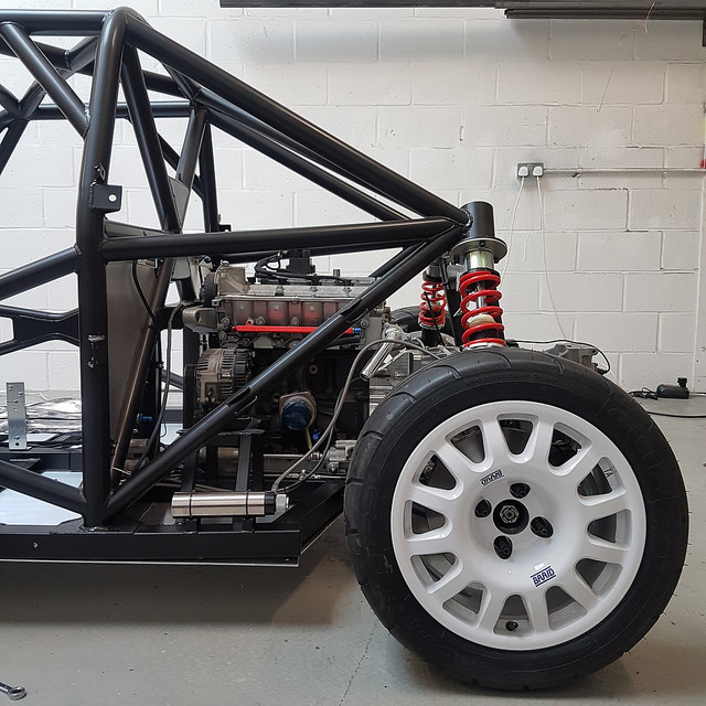

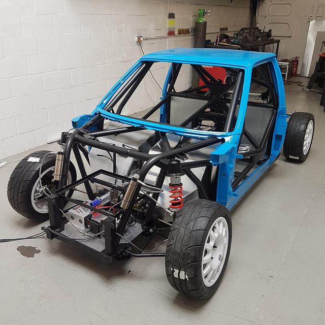

Just a quick update.. the engine is in and the car is now on the ground!

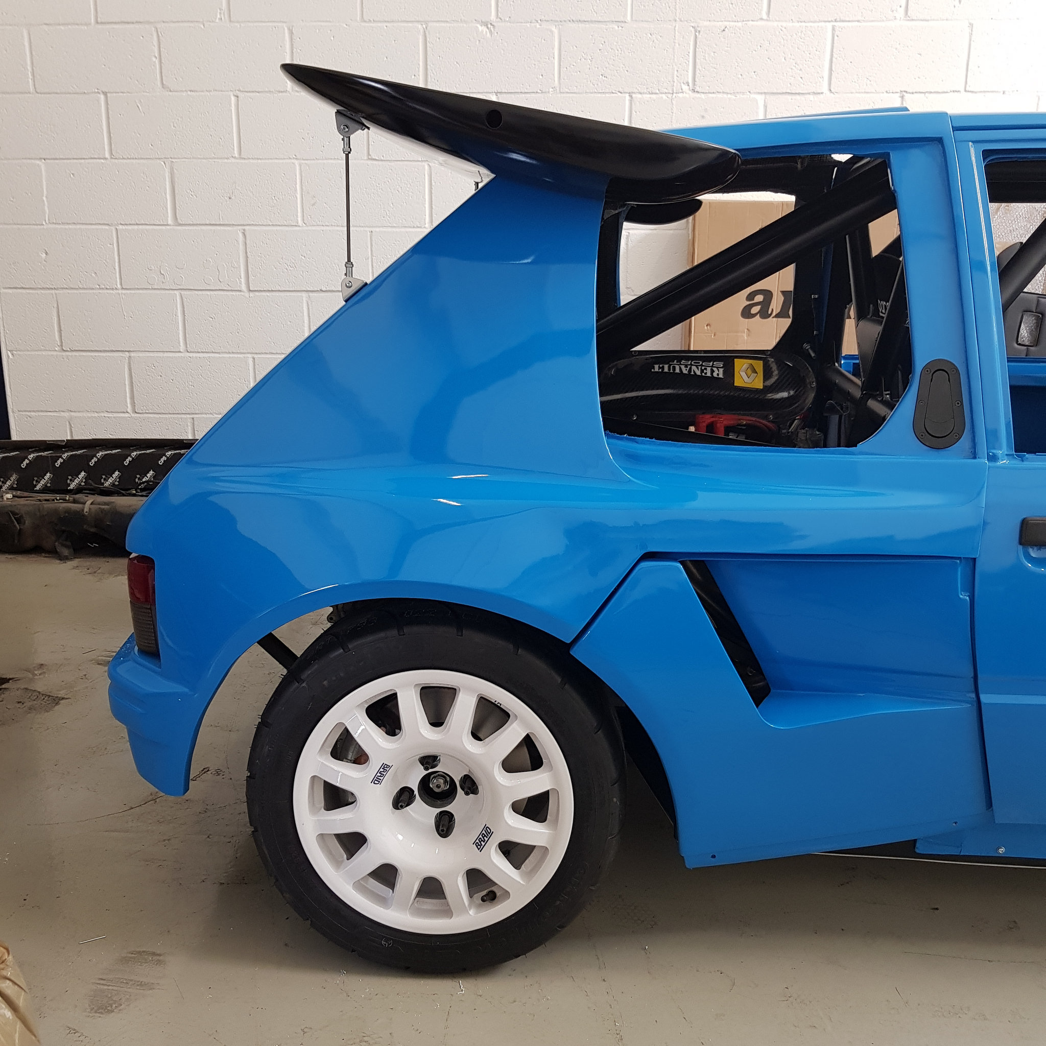

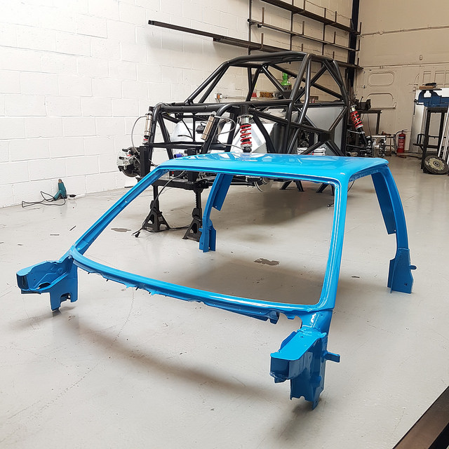

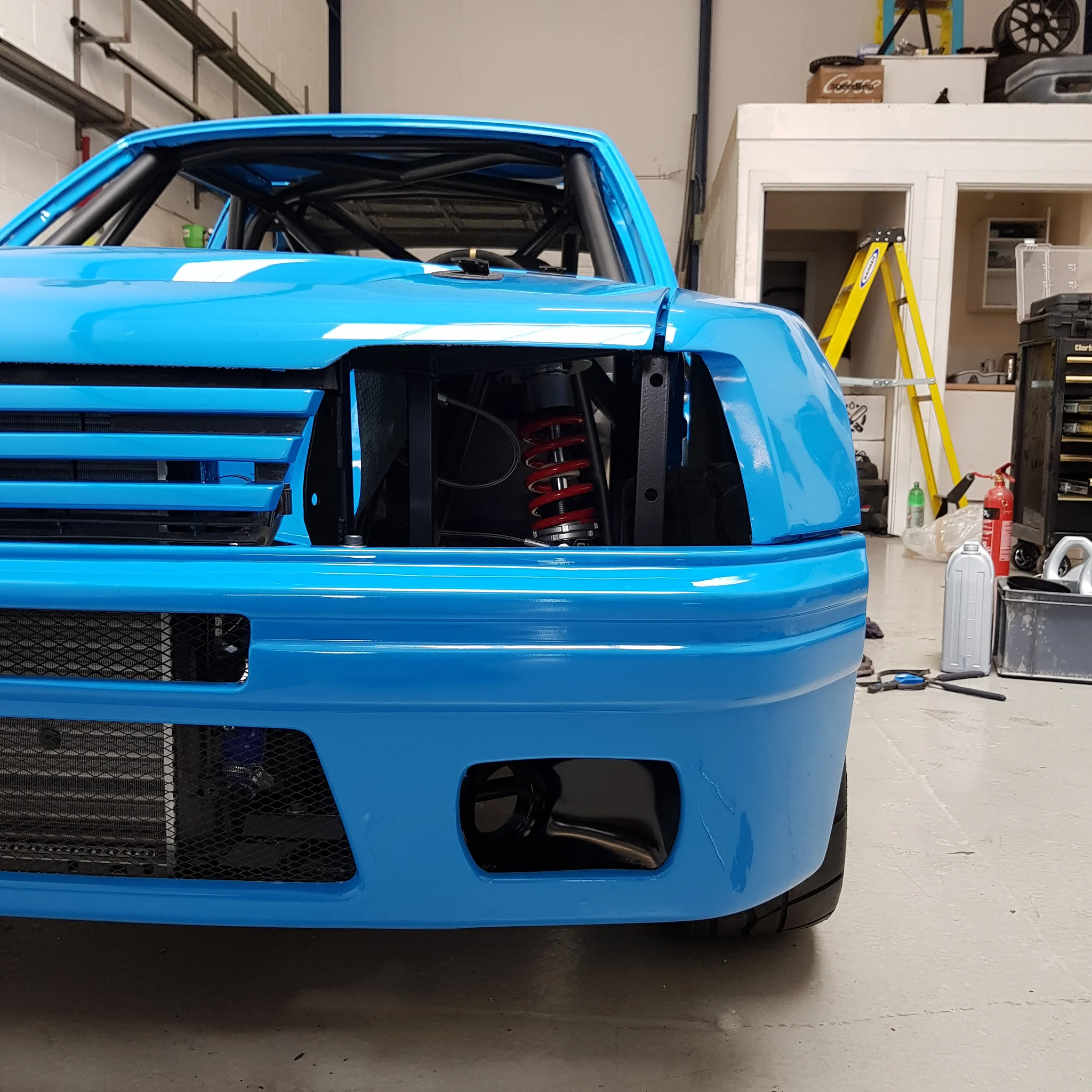

I also got the first bit of bodywork back yesterday..
I don't think that pic does it justice at all.. the contrast of blue and black looks unbelievable in person :hearteyes:

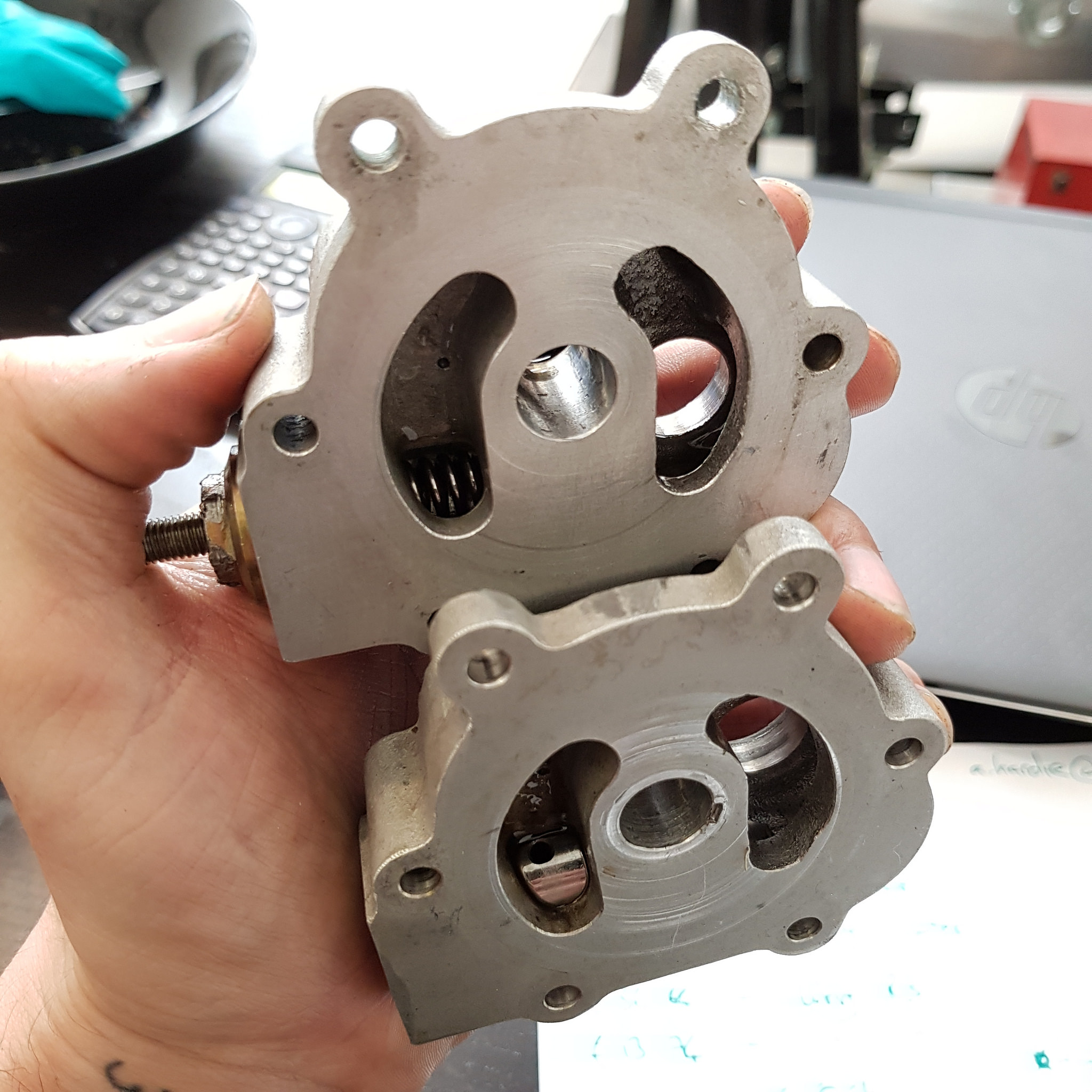

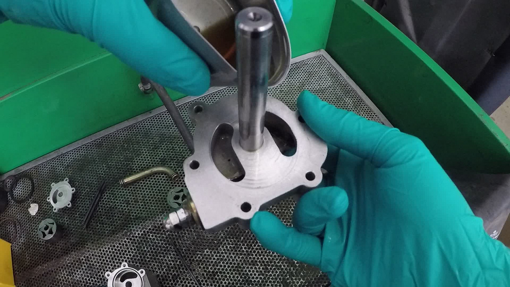

OK so actually it wasn't that the PRV was stuck open, it was completely missing! :fearscream:
The dodgy one (top) only has the spring fitted, no valve.. the bottom one is how it should look.
Got the pump rebuilt now with the best bits from the two spares I picked up, and had 4 Bar oil pressure with the drill. Should have it running this afternoon. :cool:

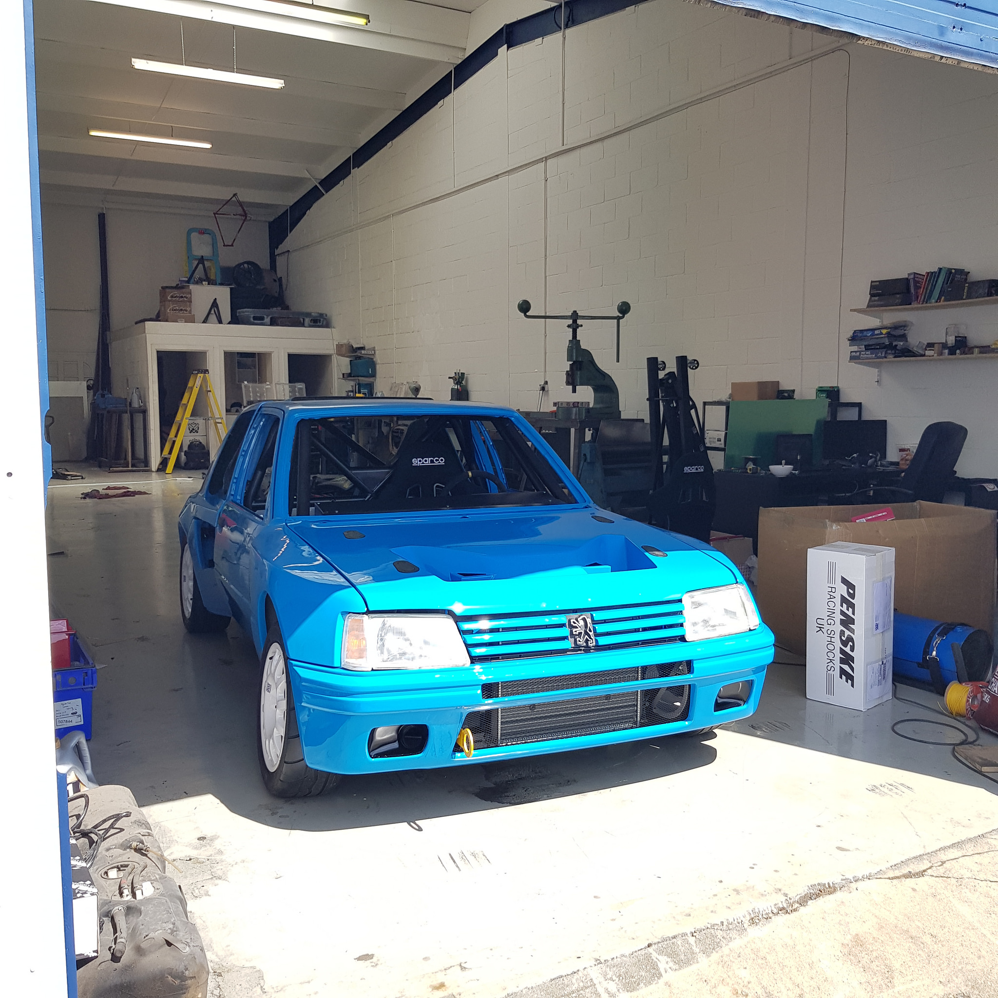

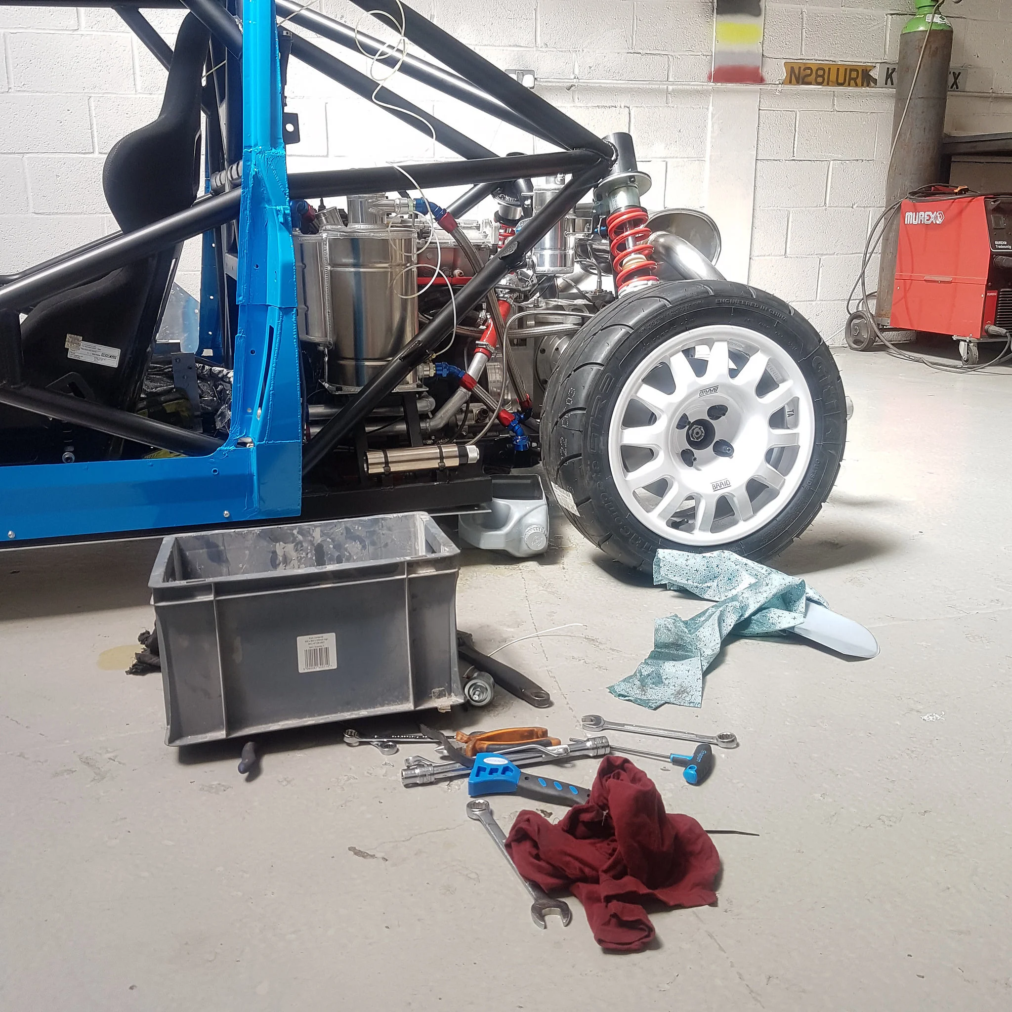

Here's how the car looked a couple of days ago.. pretty sad.. engine in bits.. tools everywhere.. oil everywhere.. chasing a problem which threatened to be a total nightmare but thankfully turned out to be relatively simple!
With that sorted I could get on with finishing the build, and yesterday I Instagrammed a sneaky preview of how it would look..

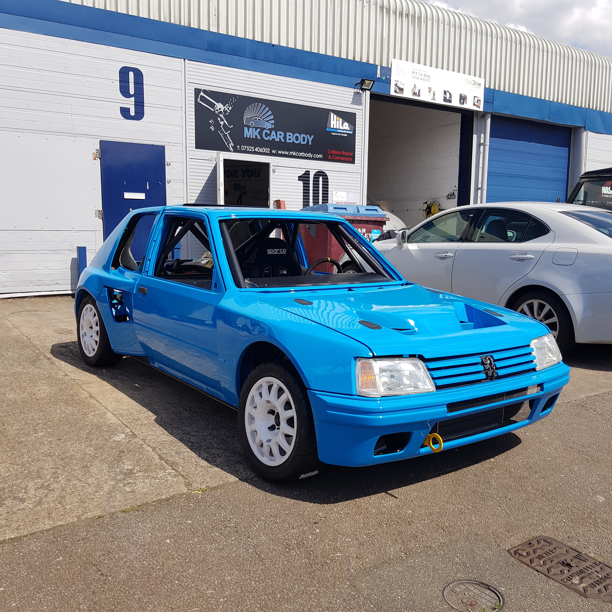

But then today.. after moving 3 non-running cars out the way.. I pushed the car up to the front of the workshop..
Then took it for its first (very short) test drive! :hearteyes:
It looks SO GOOD out in the sun. It looks nice in the pics but they just don't do the colour justice!
I'm still working out a problem with hesitation, which is stopping me from being able to drive it properly. Oh and there's no windows yet. I have a new set of injectors coming tomorrow which (I hope) should sort that out. I have a load of spares but tbh I don't know which ones are already dead, which are dying, and which will die soon, so it's best to just swap out the lot. Fingers crossed tomorrow I can have it running well enough to get some video footage!

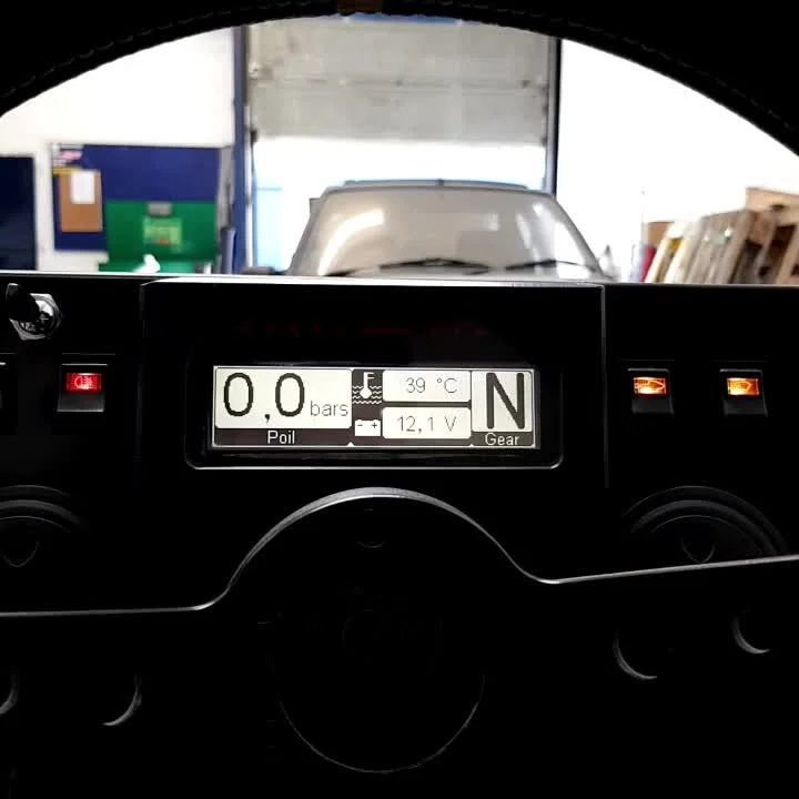

To update this.. the injectors made a small difference in that it was noticeably smoother, but it's still not running properly. When you stab the throttle it will gulp air and bog down, then when you lift off it will rev up, which makes driving it absolutely impossible. I have now changed MAP, ATS, VVT solenoid, coil pack, plugs and leads for known working ones from my 172 as they all had identical part numbers. Lambda, injectors, and CPS are now brand new, and I've checked the throttle pot to find that it's also fine; the only thing I haven't changed is the coolant temp but there's an output on the digi dash showing temps I would expect to see. Cam and ignition timing are still spot-on as far as I can tell from the timing marks and everything was built up as per Renault's process.
I spoke to Track & Road as I need to see what the ECU is reading to be able to diagnose the issue, but and he told me there's probably only 1 person in the country who could read the ECU to check live data and that's only a "maybe". Everything is proprietary and sealed specifically so teams can't mess with the mapping so it's designed to be restrictive! I'm going to check cam timing as a last resort on Monday but IMO the most likely cause is a wiring harness problem as it has gone through the stress of being removed, bundled up and stored, then re-fitted in a completely different layout. Checking the wiring could take me days and show up nothing, depending on the cause, so it's looking almost certain that all of the FR electronics will be ditched in favour of a DTA S60, new dash, and new harnesses.

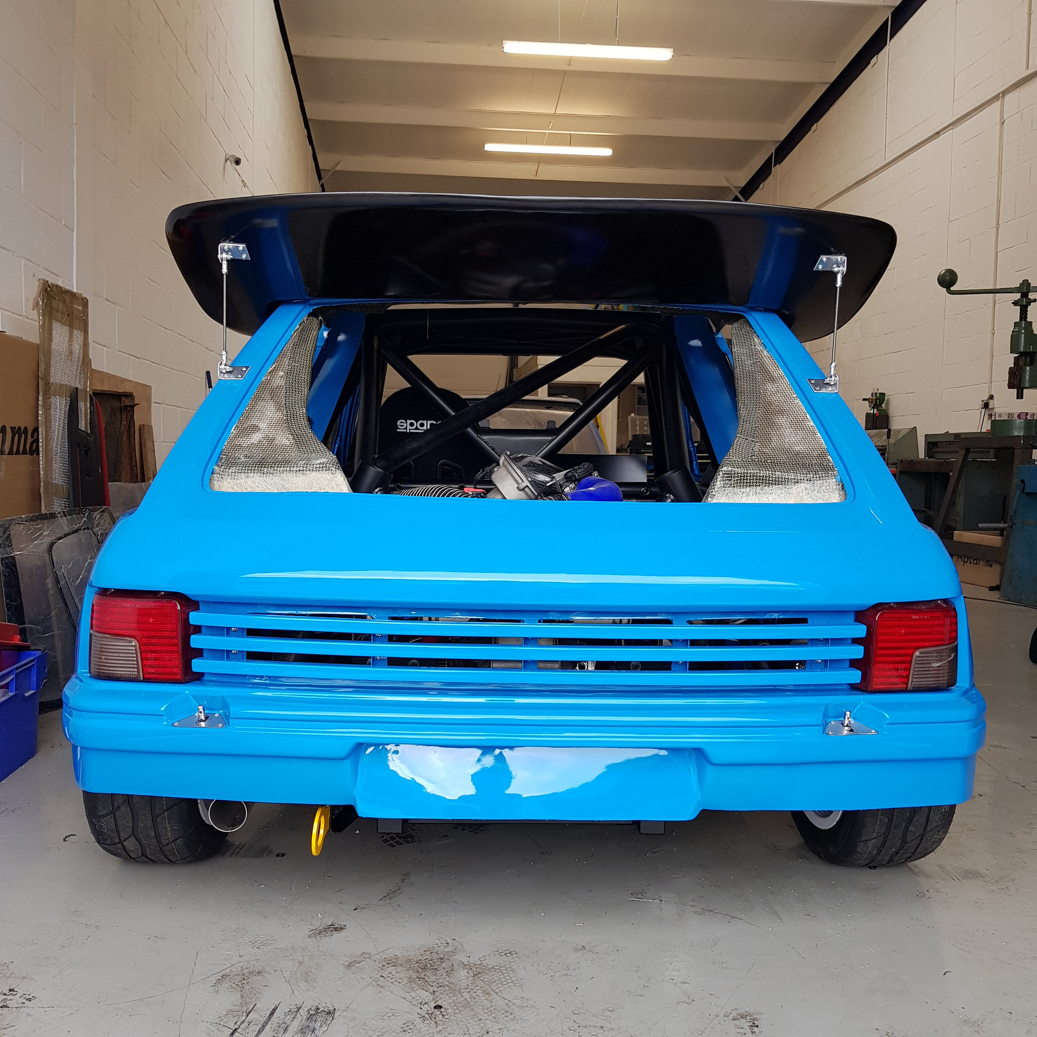

In slightly happier news the rest of the build is pretty much finished, including the enormous spoiler!
