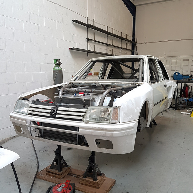

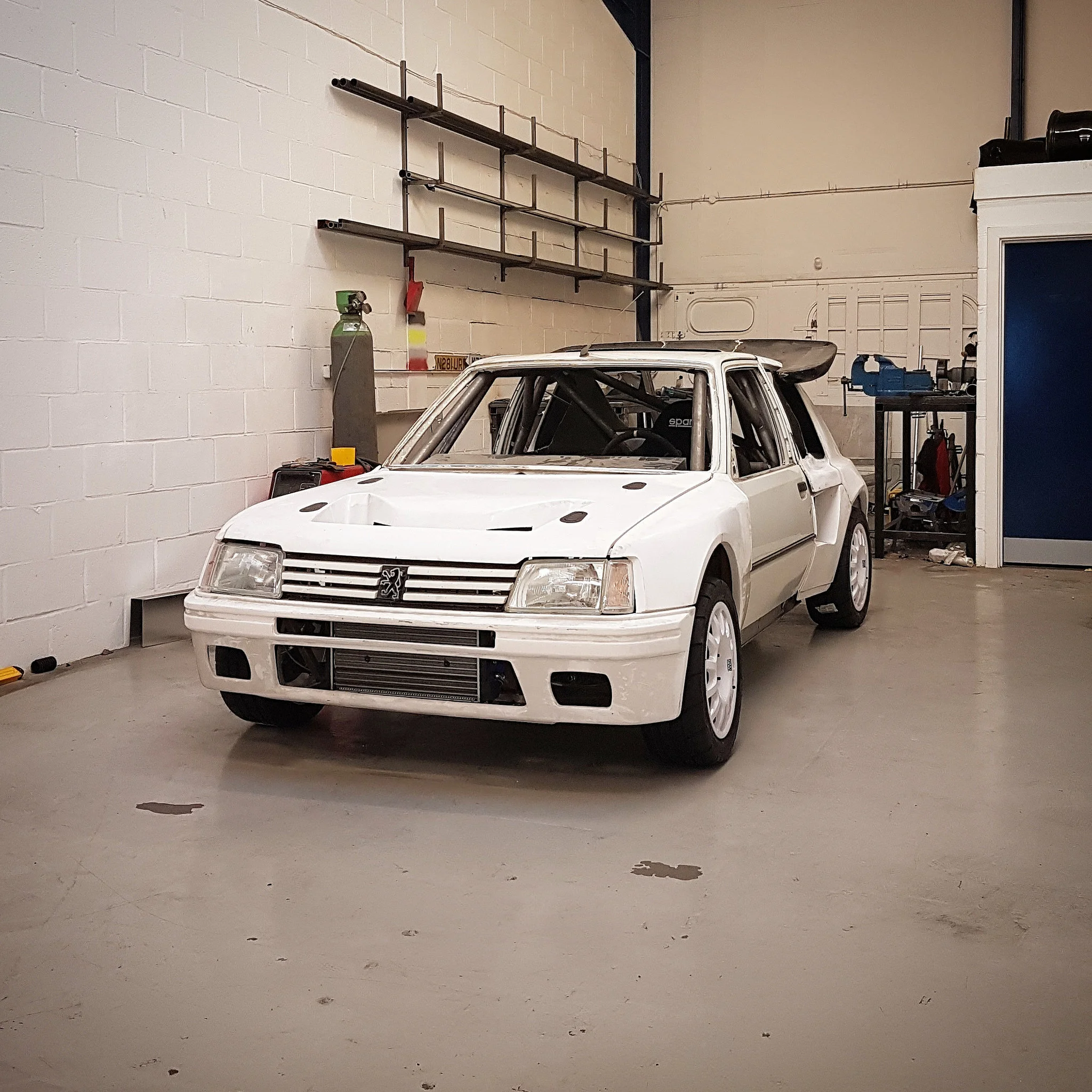

The car is getting very close to done now, but it won't make the 25th Feb test day. I could reel off a list of reasons but it's easier to say there was just way too much to do in such little time, no room for problems, and the reality is there's 3-4 weeks left until the thing will be ready to tear down for paint & powder coat. The list is growing ever shorter though, and is now down to: coolant plumbing, wiring, fire extinguisher, fluid lines, windows, a load of small finishing touches.. ok still a fairly long list then.

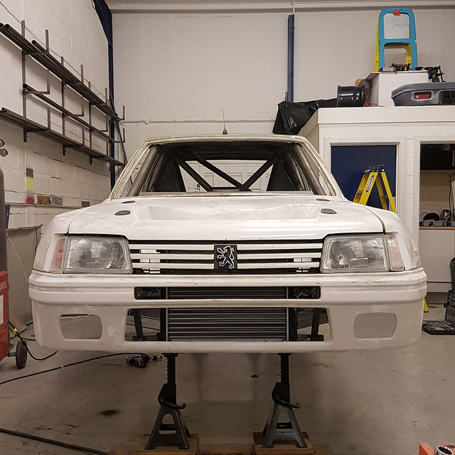

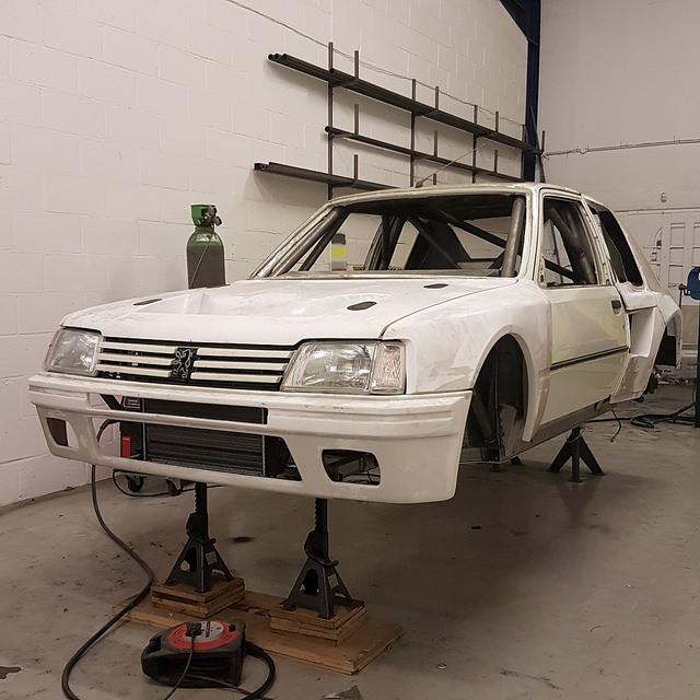

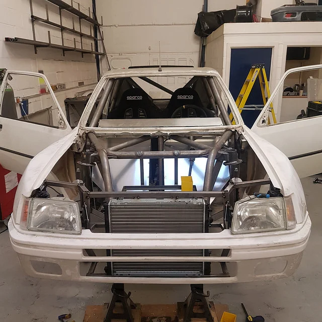

This week I've finished up the body mounting - the only thing left now is some hinges for the rear clamshell. We want to retain the original headlamps and indicators, so I had to make up a frame to hold everything in place. The lamps that came on the shell were knackered so my own GTI donated some bits for the time being!
Looking pretty good now!

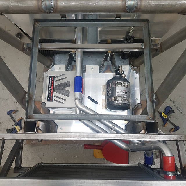

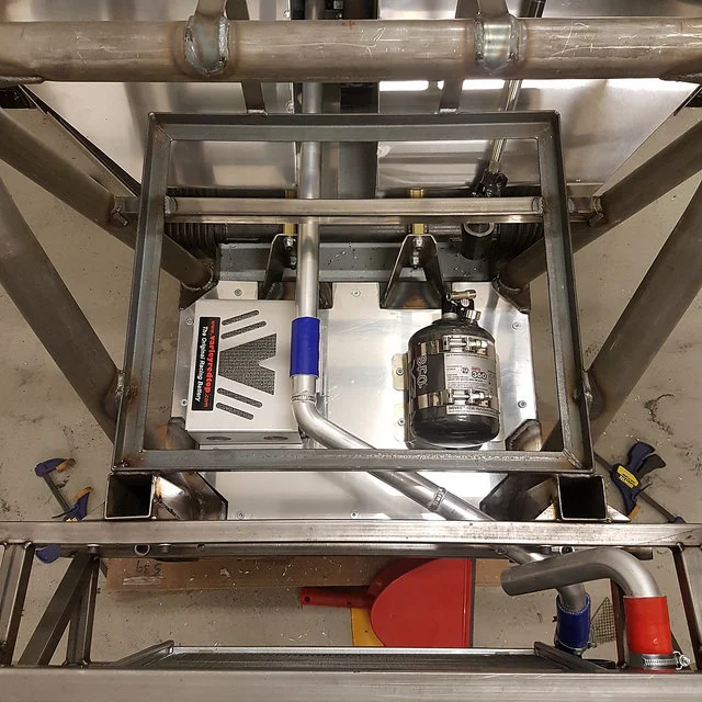

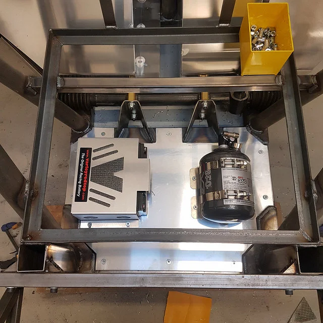

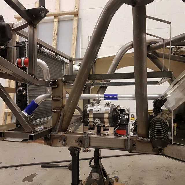

Then I fitted the (tiny) fire extinguisher and battery..
And finally.. this is the gap I have to get cooling pipes through! 😢
Not an easy job, that one!

Can you not get coolant pipes down the side of the passenger seat?
  172 Cup
Looks so good. Hats off my friend!

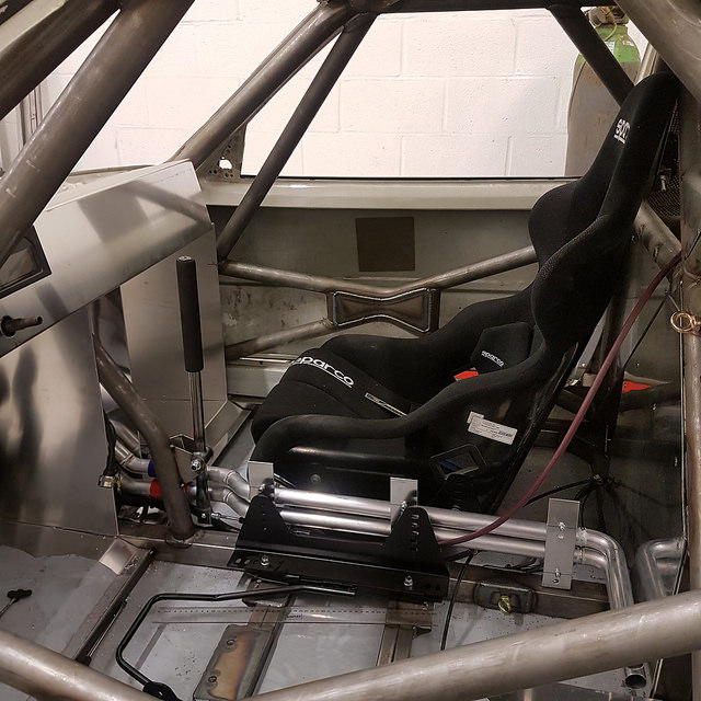

I did want to send them down the driver's side originally, as there's a bit more space that side with the seats being shifted over, but there were a few problems with it.. the biggest being that avoiding the pedals / driver's feet was almost impossible, but even if I could there was a problem with the lap belt which would have had to rest on the cover - not ideal. The passenger side is out because of the same belt problem and they'd end up on the wrong side of the engine, so the centre is the only space left!

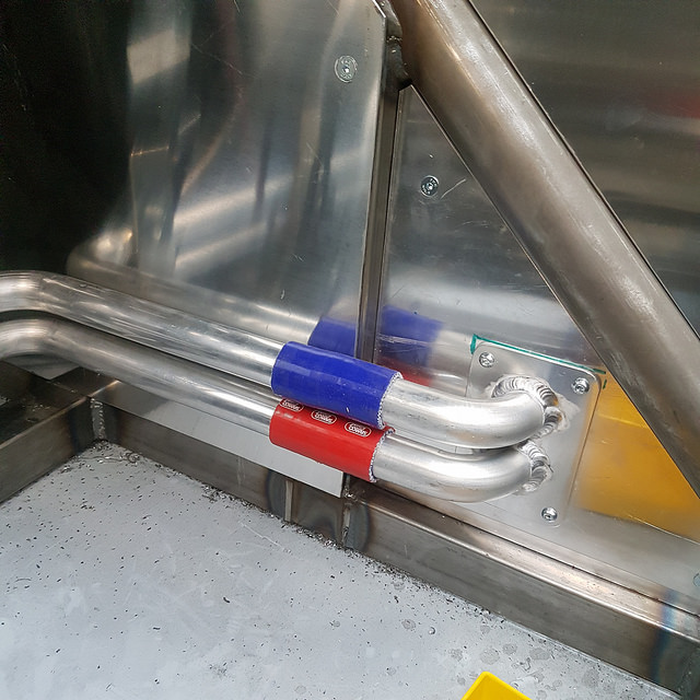

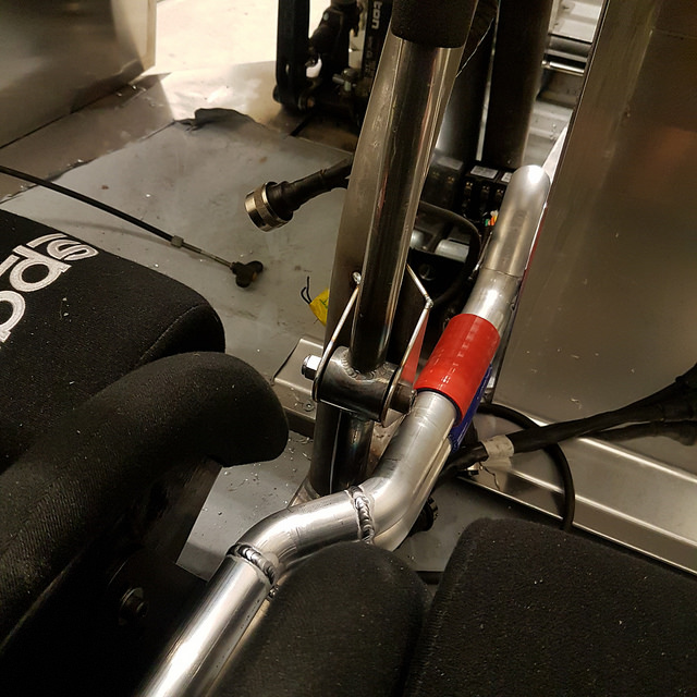

The job I've been dreading actually turned out to be pretty enjoyable, which is nice! I got off to a bit of a dodgy start as I had 10m of aluminium tube but no bends and couldn't find anyone to make me any, but was rescued by a little-known place who had a bin full of them in the correct size - apparently no good for F1 but just fine for me!

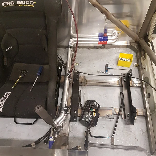

Started off with the most restricted bit around the shift lever. I'm going to have to trim a tiny bit of the bracket away to avoid rattles but it's actually not as bad as I feared!

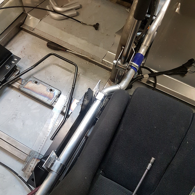

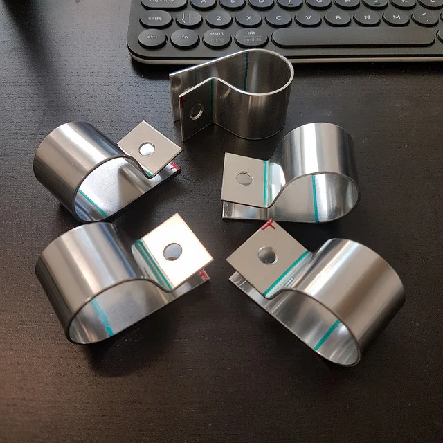

I had to come up with a way of securing everything that still enabled me to slip insulation over the pipes, so made some little P-clip brackets
..Which then attached to some L-shaped brackets that bolt to the floor. There's room above the pipes to secure the brake, clutch, and fuel lines too.

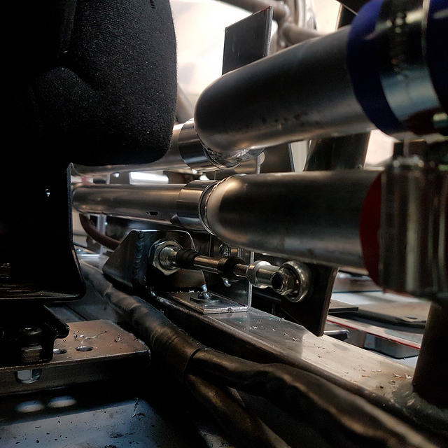

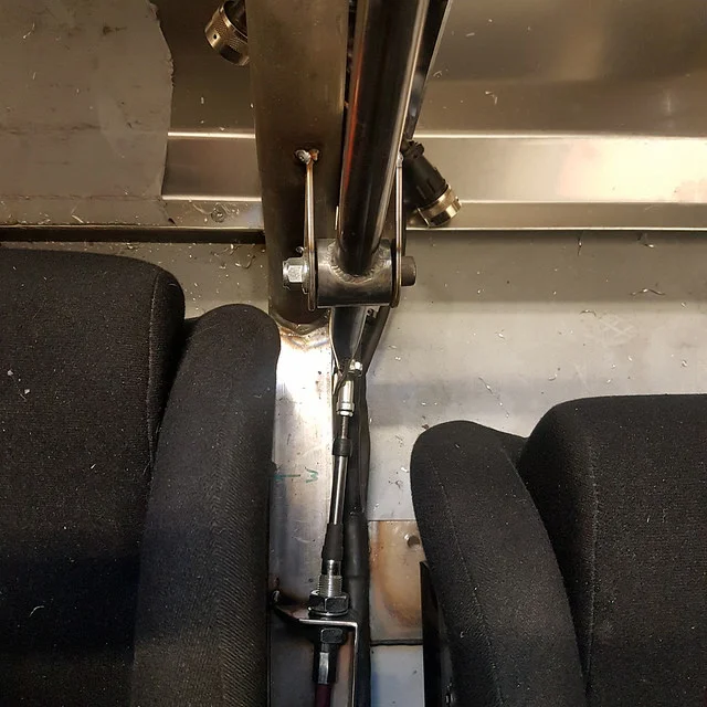

This is how close everything is around the shifter..!
It all looks pretty nice. :up:

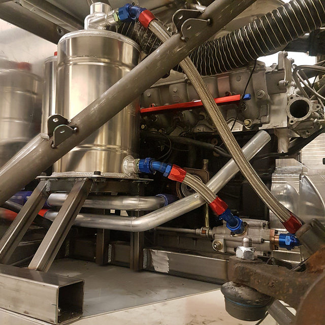

Then I moved on to the front end, routing from the shifter to the radiator. This was a bit fiddly as the hot pipe is below the cold, but on the rad the inlet is at the top, so the pipes needed to switch around somehow along the way.
I opted to do the cold side first..
Hot took a bit of fiddling to get right, but the pipes are parallel which is what I like to see :cool:
Then to finish off the middle bit I made a little pass-through for the engine bay firewall
And finally I routed from the firewall to the water pump and thermostat outlet
Frustratingly I need ONE MORE bend, as the thermostat housing is 28mm and points in the wrong direction, so I can't 100% finish it this week! I'm pretty happy with how it all came out though, and the nice thing is there's no impossible geometry so they can be CNC bent later if required.
