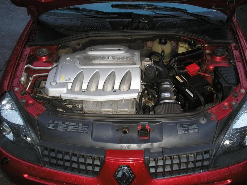

it's the bit where the black L bend goes into the engine
just unclip it and look in there, it's the part that opens up when you press the accelerator.
The part infront of the coolant bottle, is only held on by a circlip, if you switch the ignition on and get someone to press the accelerator you'll see it open/close.
