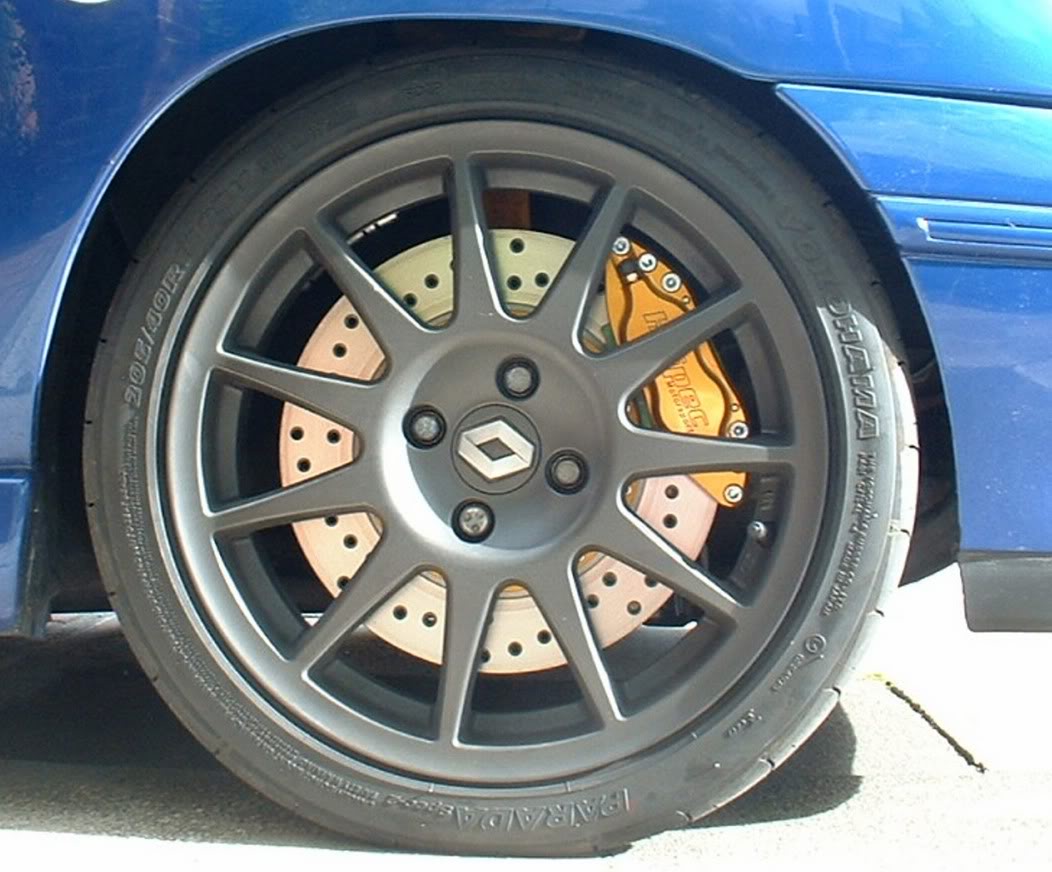

300mm discs under 16s Pic request
it should do, i had 295mm discs with 4 pots under 15's when i had my vts. It will also depend on wheels design, comps offer good clearance as do rotas
You can get 330mm under 16's with the right wheels/calipers.
300mm Should fit under 15's, again depending on wheels/calipers.
I had 300mm hi-spec 4 pots under turinis
They fit buts its tight
