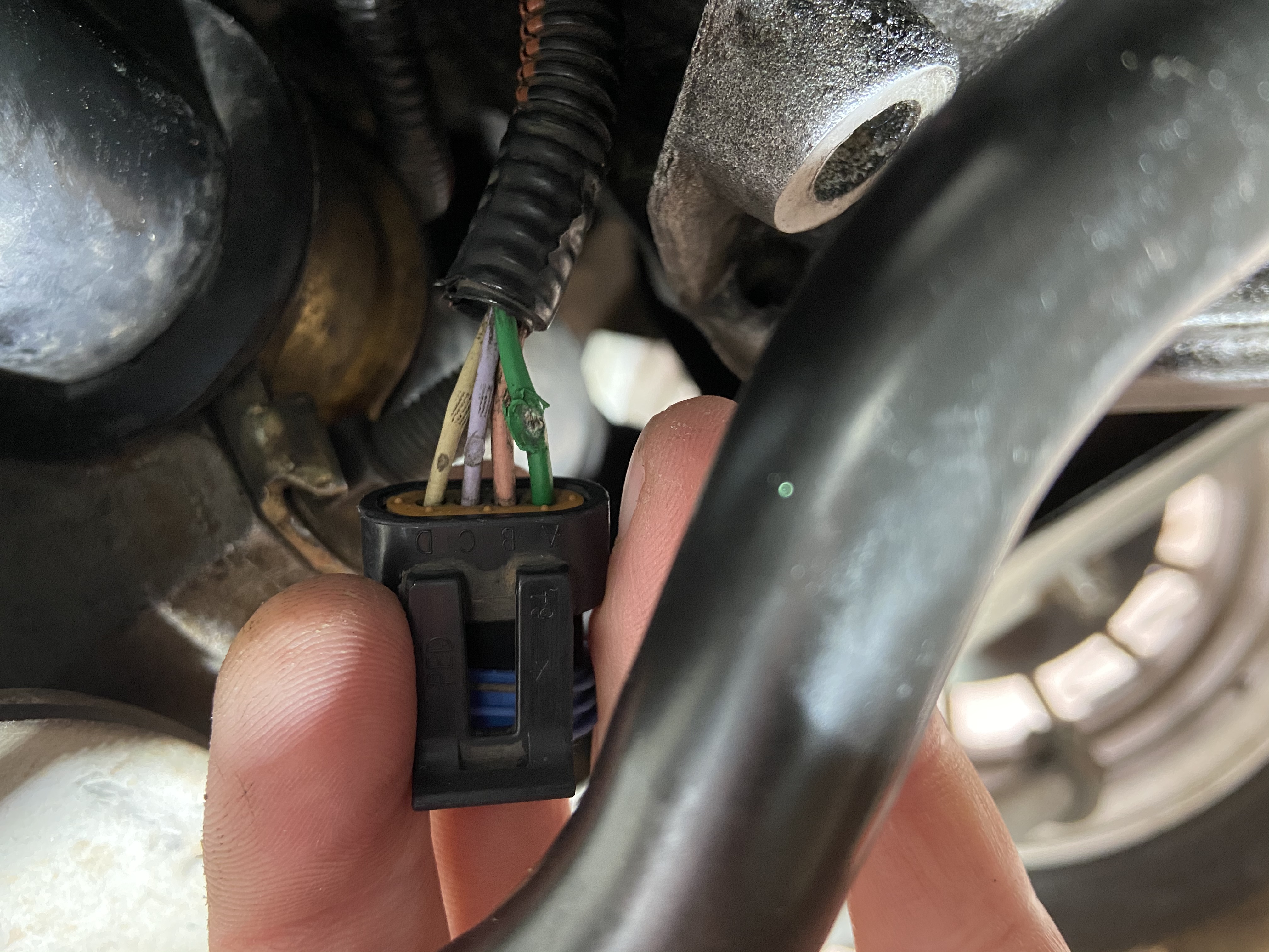

Check the oxygen sensor wiring has not come loose and shorted out on the exhaust manifold, had couple like this in work.
Over ten years later and this suggestion has just saved me a lot of head scratching and chasing wires! Unfortunately for me the wires were melted on the wiring loom side on the connector so I couldn’t just replace the sensor.
