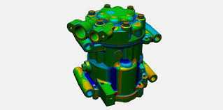

We use Geomagic design X for all our cad, it’s basically solidworks with a bunch of tools to help convert scan data.
The most useful tool is the accuracy analyser which will colour map the cad to show you what’s in and out of tolerance.

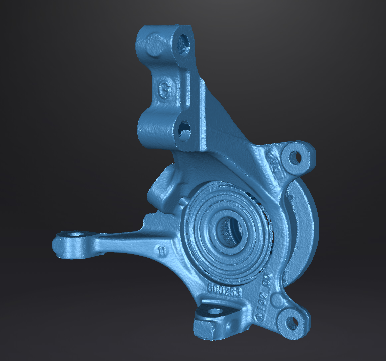

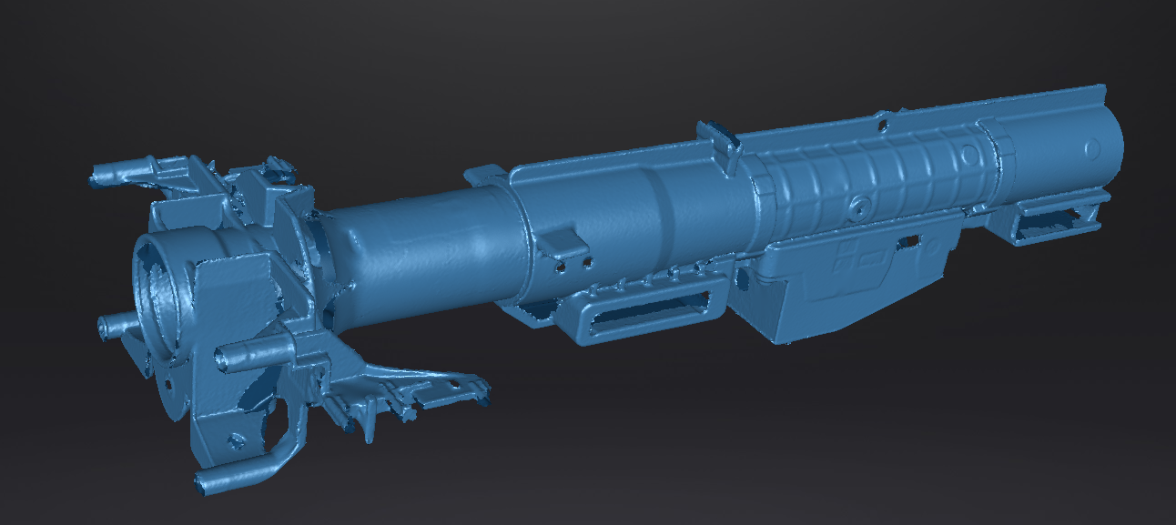

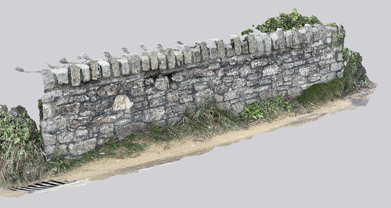

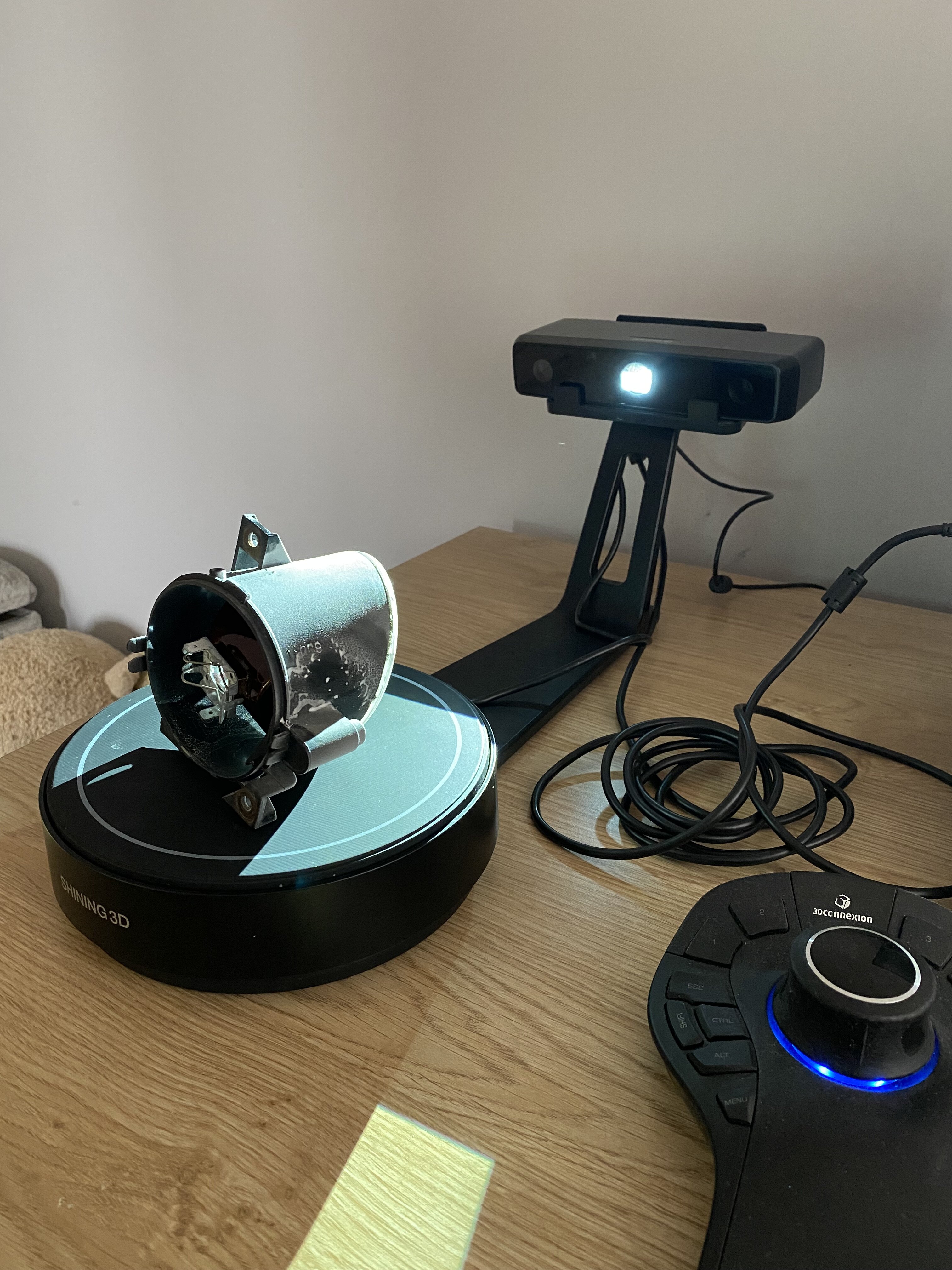

I have an Einscan H which I bought for 4.8k last year, for the price the detail and accuracy is great. It does take some time to setup and learn and some parts can be difficult to scan, even with dots and scanning spray. But different scanners can be better at somethings than others.

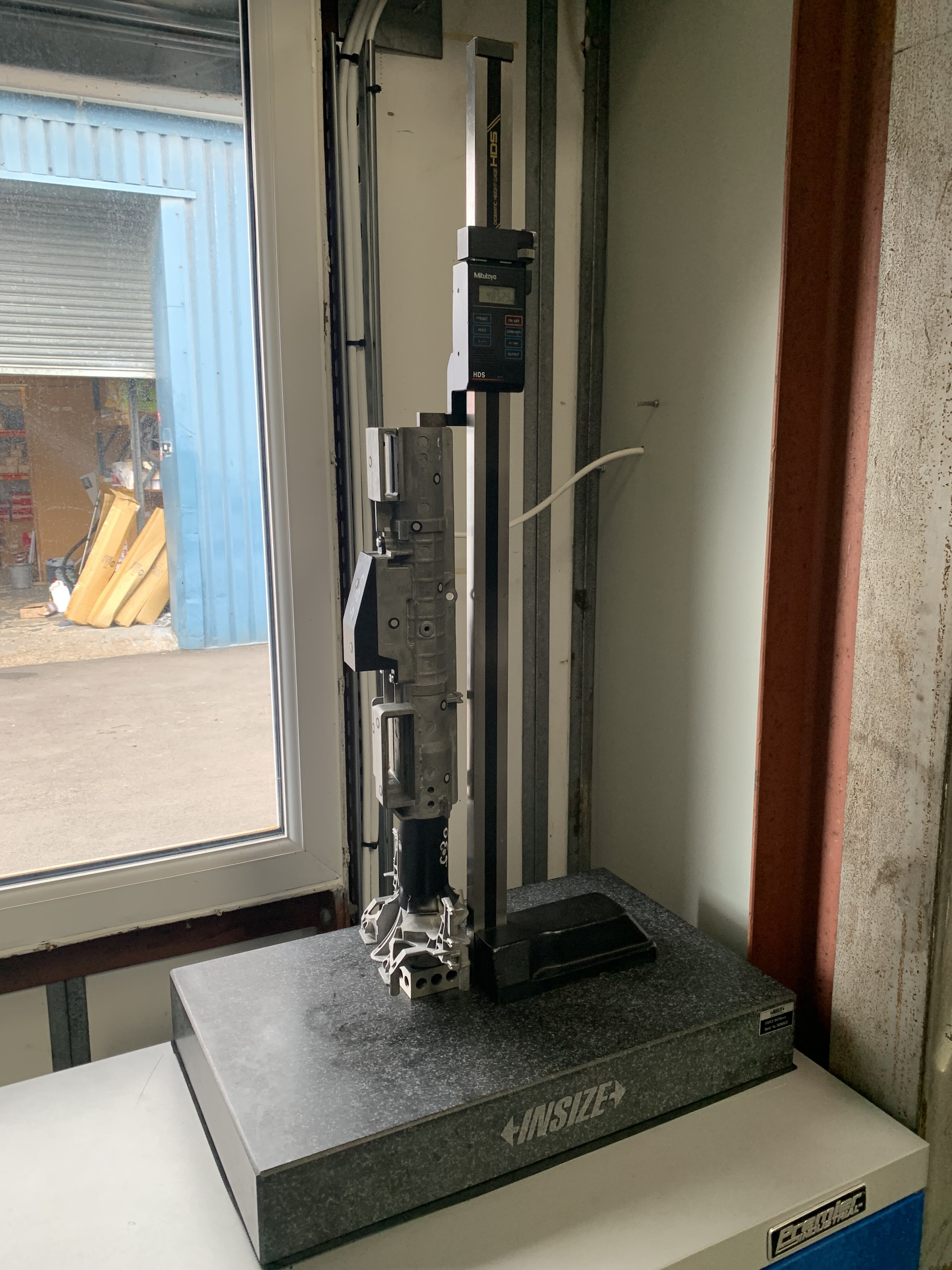

@Touring_Rob I want to have a scan of the car.. Its just the prep and other measuring tools to make sure of the accuracy that stops me right now. Scanners not going anywhere though! Ive been putting most of my focus on the machining side of things and researching/studying for the cnc mill.
The inspection plate will be moved once I organise the unit away from the door/shutters, away from the light and draft..

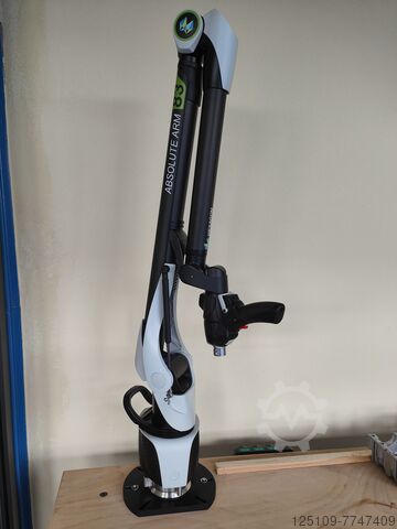

I tried a handheld scanner recently and it didn't pick up tiny details as well as our arm based Hexagon one, but it is obviously way better for scanning a whole car.
I scanned part of a Ferrari 250 Testarossa chassis (a good day out that was) with ours but it was a bit of a hassle as I had to move the scanner a few times, and its quite awkward. We have a 1.5 metre long arm.
We got ours after hiring one from Hexagon for a month for a trial, it's very similar to this one.

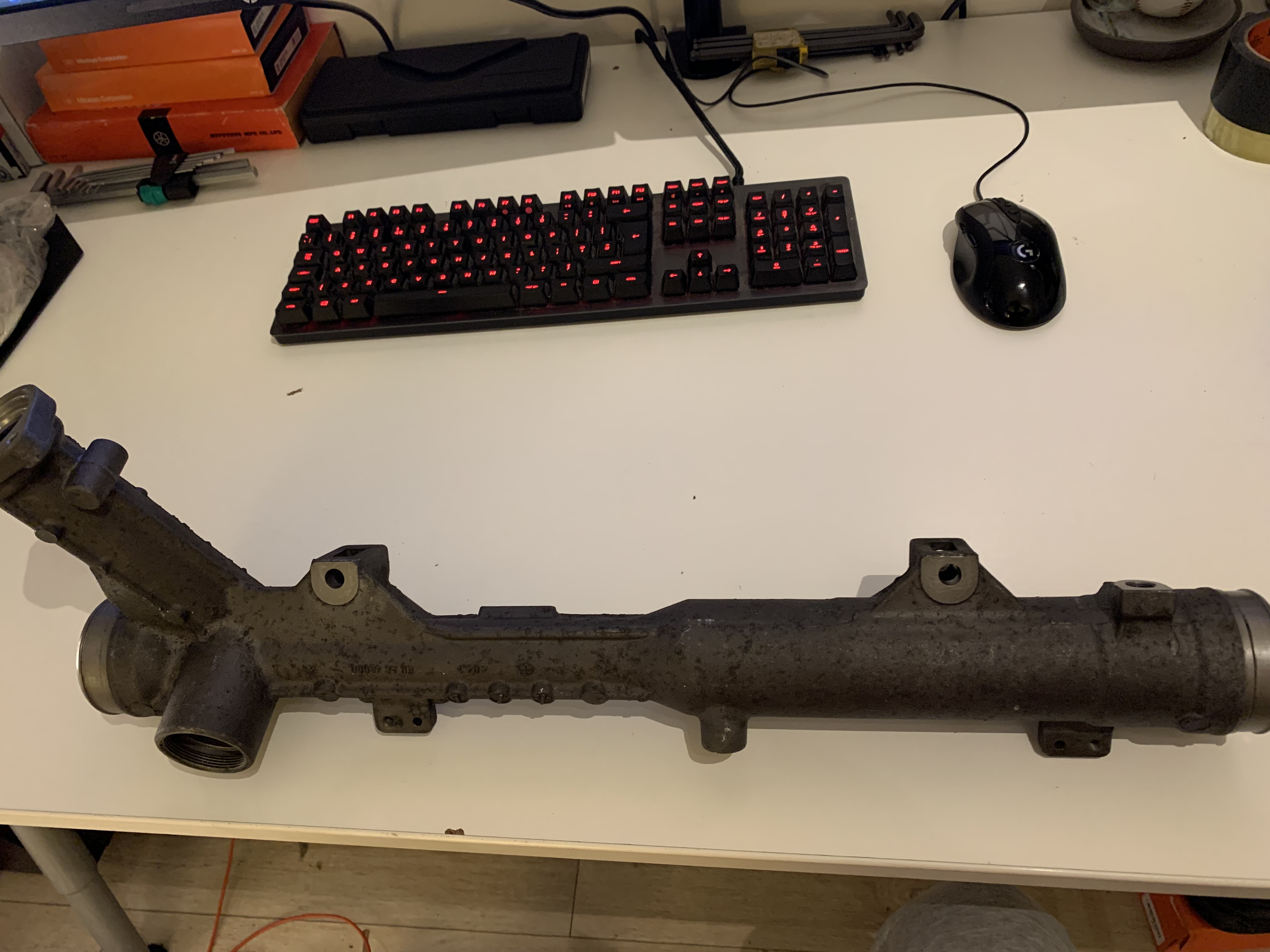

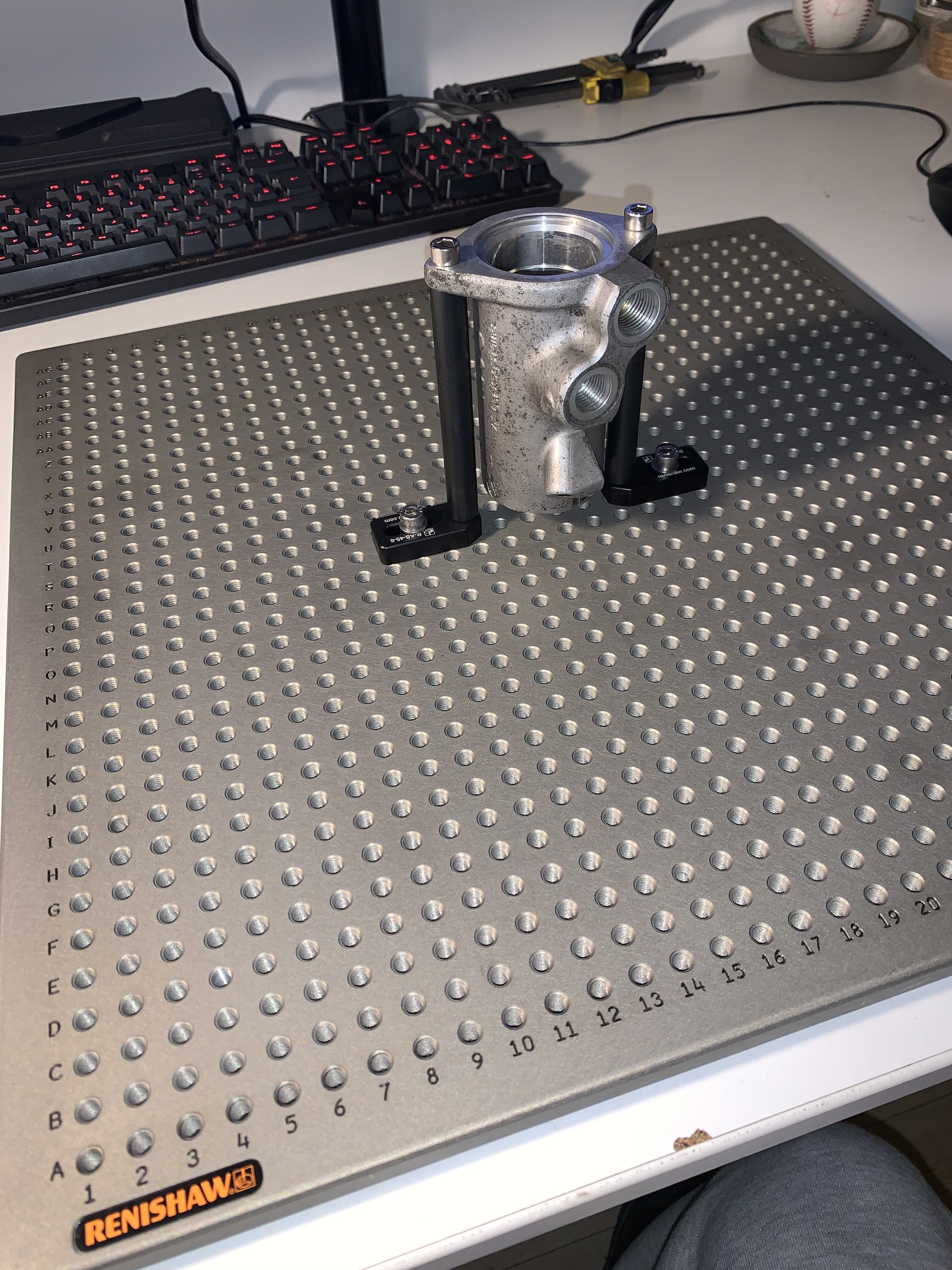

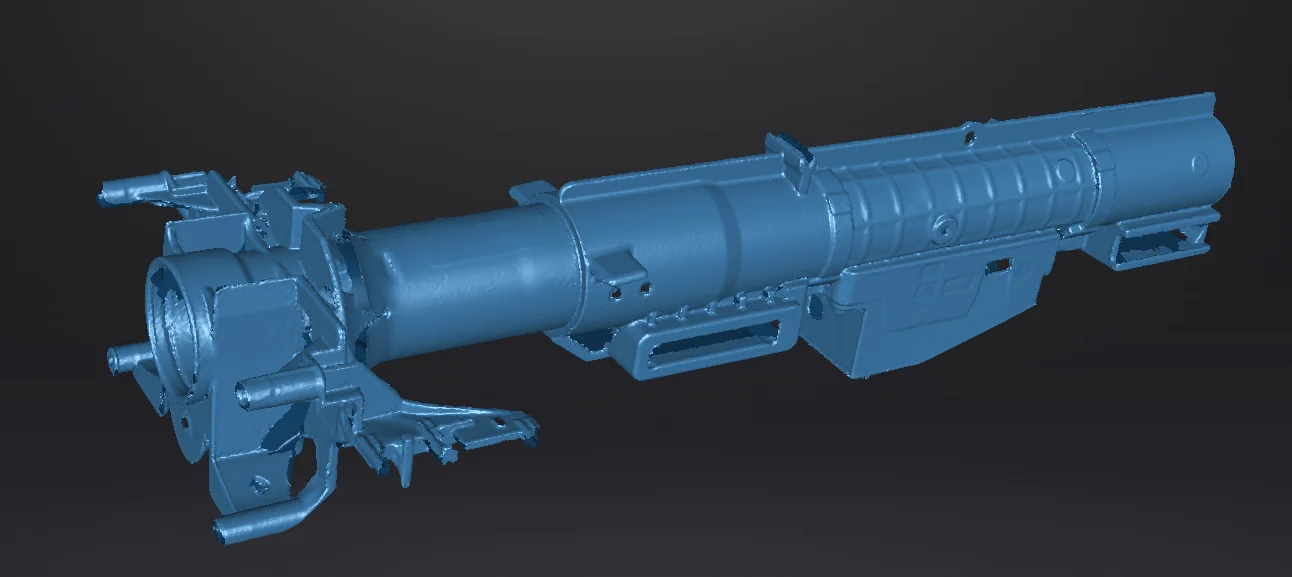

For the guys in this line of work, I dont suppose you could give a rough estimate on what it what it would cost for a solid model to be made from a scan of these rack housings? Ill supply the scan and some measurements to work off. I'm based in kent.

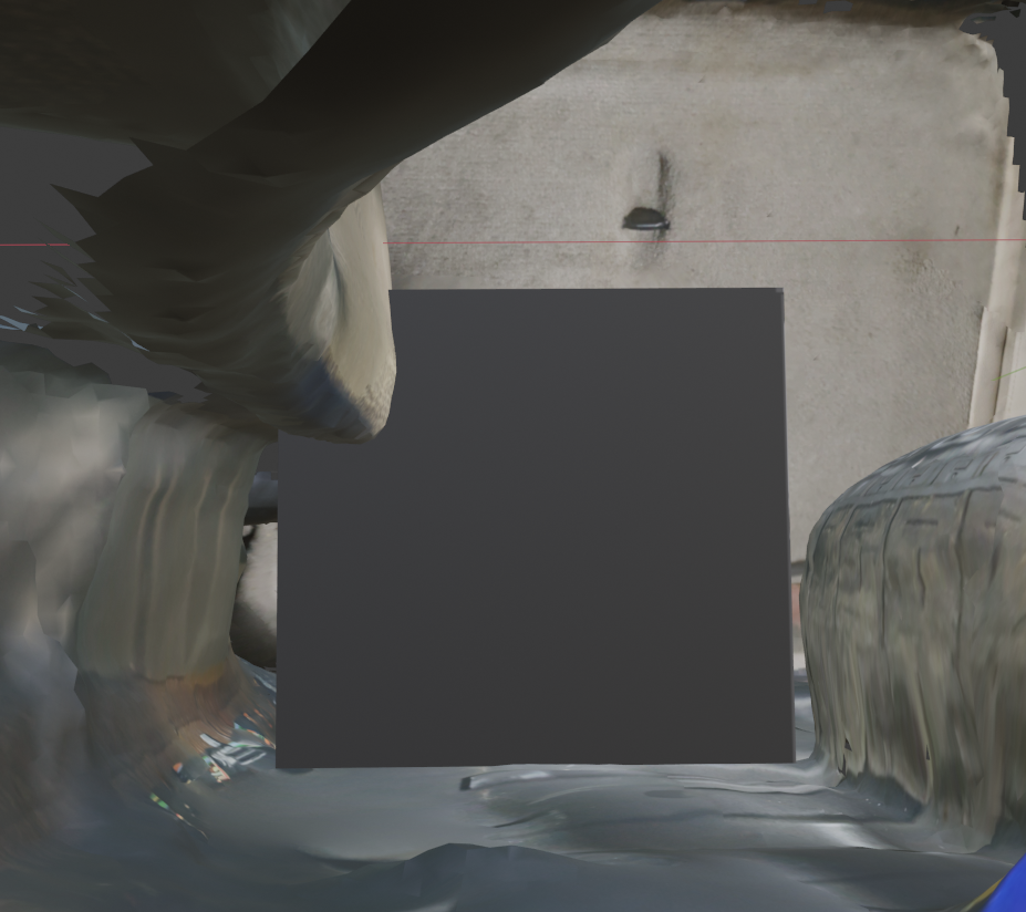

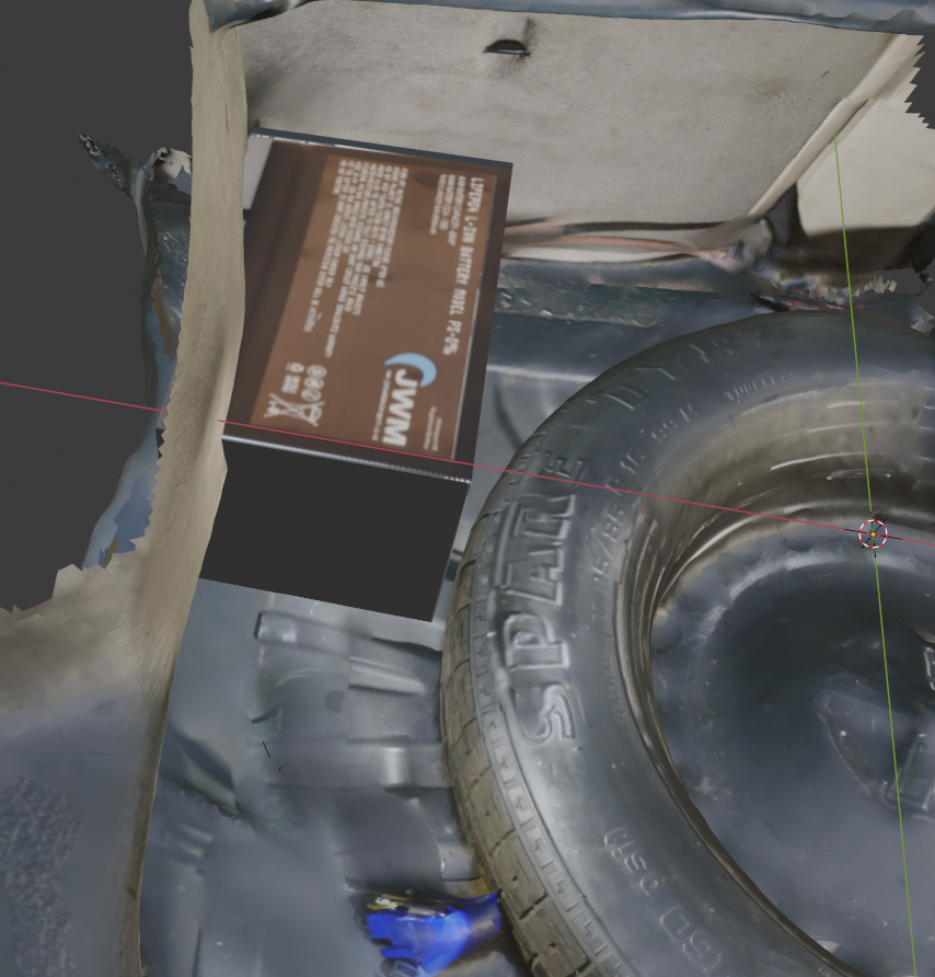

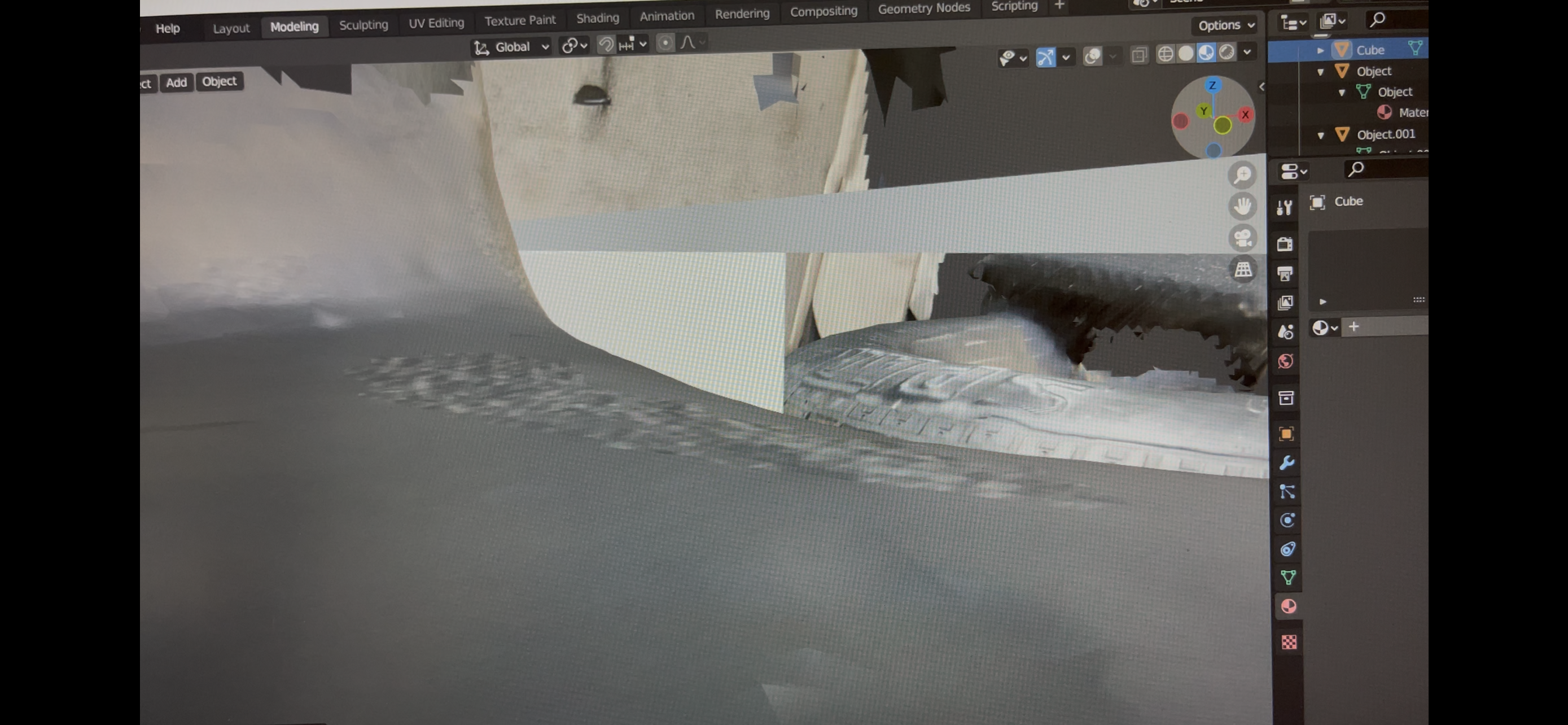

Space in the boot is looking a bit tight, will a battery fit?
Quick, whip out the phone, take a scan, stick it in Blender, and make a battery-sized box.
Answer: Yes.
Yes, but it’s a bit of a faff to do it in three dimensions simultaneously, and with it being a box you can just move around you can play with slightly different angles etc and see what gives you the best clearance. Plus it was close enough that I wanted a visual representation.
I also added the boot floor on top of that to see how high it’d sit with the battery under it - 27mm higher.
That’s a little bit of a gap to the side wells, but if it means I have a full sized battery I’ll live with it. (And there’ll be separate supports for the boot floor so the weight won’t sit on the battery as well)
Had I not decided to texture the battery I’d have done it in about 5 mins.
What did not take 5 mins was removing the fecking boot tray that goes around the spare wheel. Had to remove all interior trim from the rear seats back to get that fucker out.
