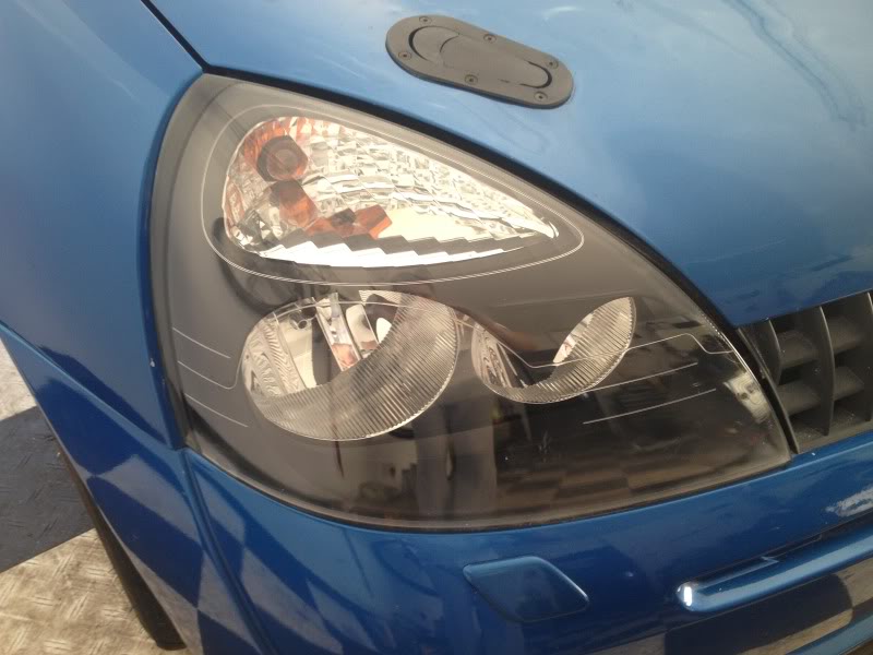

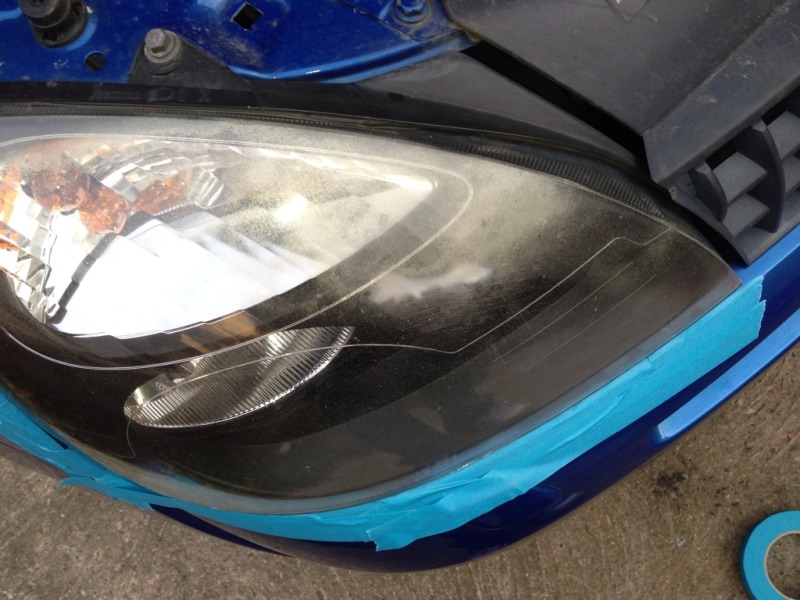

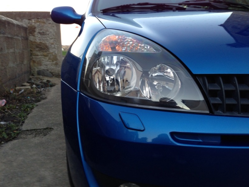

Did mine today with this kit
Before
After

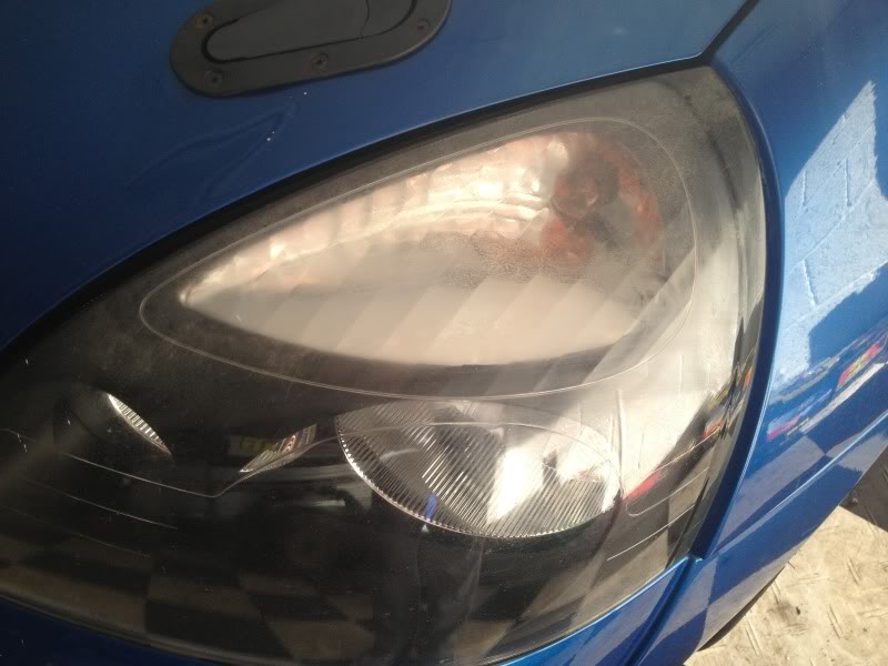

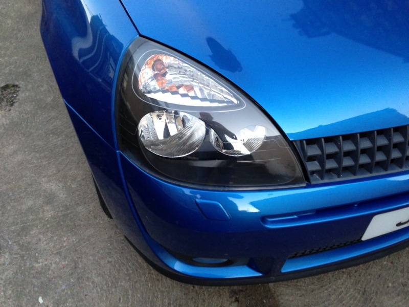

Did my drivers side the other day well chuffed with the results just gave the other side a polish as it was fine
Before
After
Totally transformed my front end and id even say my lights at night have improved some what aswell, only tip iv got is make sure ur drill is fully charged and be carefull if it starts getting wobbly as my paint took a little hit even with it being taped up
  Renault Clio 172 Cup
Took me about an hour i also clayed the light first to make sure it was totally clean and nothing could contaminate the pads

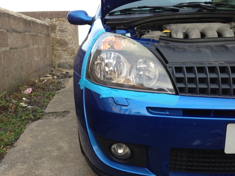

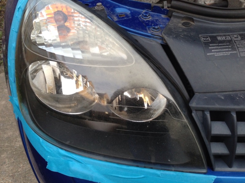

Not bad, only did the driver's side as this was the worst, not completely gone but still an improvement. I can see area's which could benefit from another bash.
Next weekend i'll do the other side. Great bit of kit.
