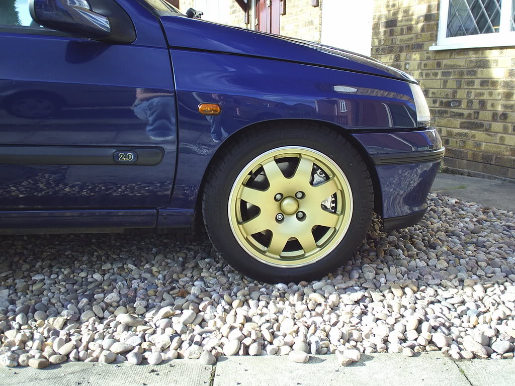

Ohh btw, I had those Hi Spec 4pots on the Williams, I don't recommend them.
why whats wrong with them ?
Fred hasnt dissed them atall i dont think, no point gettin the big brake kit from k-tec then have to fork out more again to get 4pots :)
Just felt more about show than anything.
Didn't feel alot stronger than the standard units. I expected to go through the windscreen but not overly different.
Looked awesome though:
