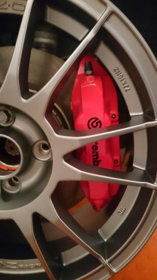

It'll be the spokes and inner part of the rim that will potentially cause you a headache mate. Look at the pics of my superleggeras and you'll see what I'm on about. Et37 for reference as well.

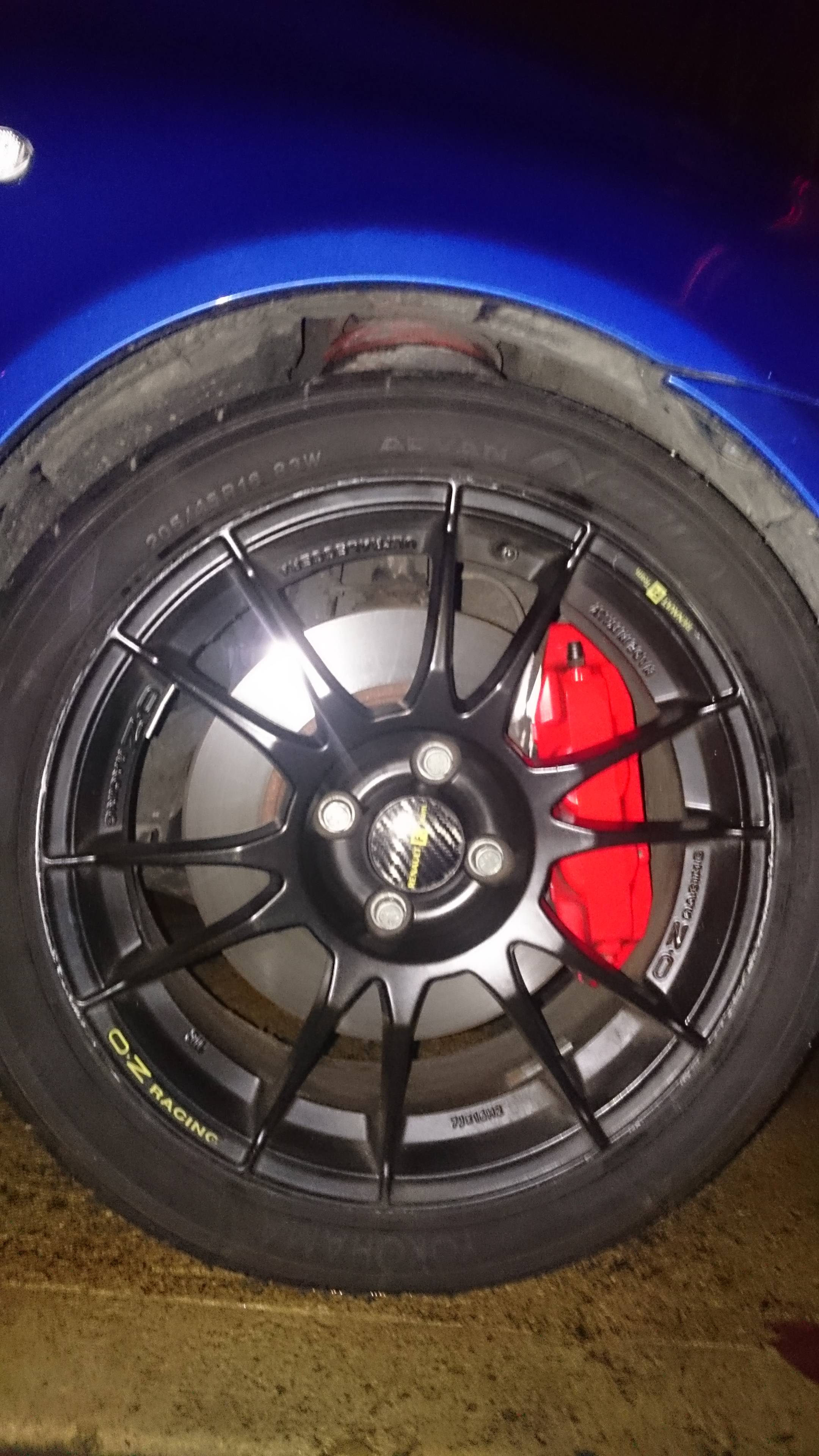

You know what ... I cant believe I have only just thought of it now but Mike from Ren Tech Portsmouth has 16" ultraleggeras and Brembos . Here is a pic I took a minute ago. I dont know if they are 300mm disks though but think they must be from the small gap between the caliper and wheel. He looks to have 15mm spacers. Will ask him tomorrow what set up he has.
Stunning wheels though.

The good news is that the OZ Ultraleggeras 16" wheels fit with 300mm discs, PMS mounted brembos . There is a good 2-3 mm clearance. The other good news is that I will be able to ditch the spacers and long wheel bolts now as the ET on the Oz wheels is 36 or 37.
NorthloopCup
Looks good mate. If only the superleggeras gave that much clearance!!

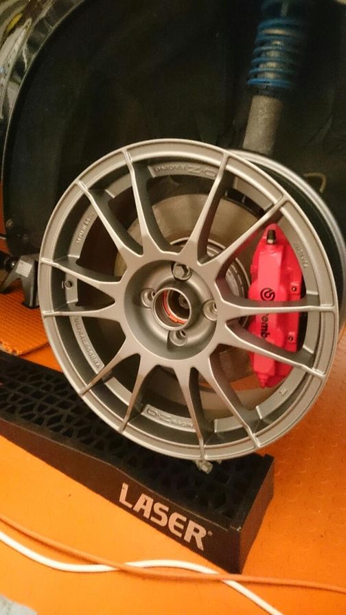

@NorthloopCup have you fitted the OZ superleggera's to your car whilst running 4 pot Brembo's? If so what brackets were you using and if using spacers what size? Thanks. Looking to run the same setup and as my car is a daily driver I would rather have everything I need before I start :wink::cool:
NorthloopCup
Yes mate I have.
That's a set of 300mm brackets and 295x28 discs on a rotor and bell setup. The calipers have been machined by 2.5mm to drop them down to suit the 295's.
You can fit 300mm scenic discs and the brembos, but you can't run any wheel weights as there's not enough clearance. There's no spacers fitted, but I'd say you will need 3mm universal spacers to be on the safe side.
That setup pictured above has a thicker bell mounting face to space the wheel out slightly anyway.
