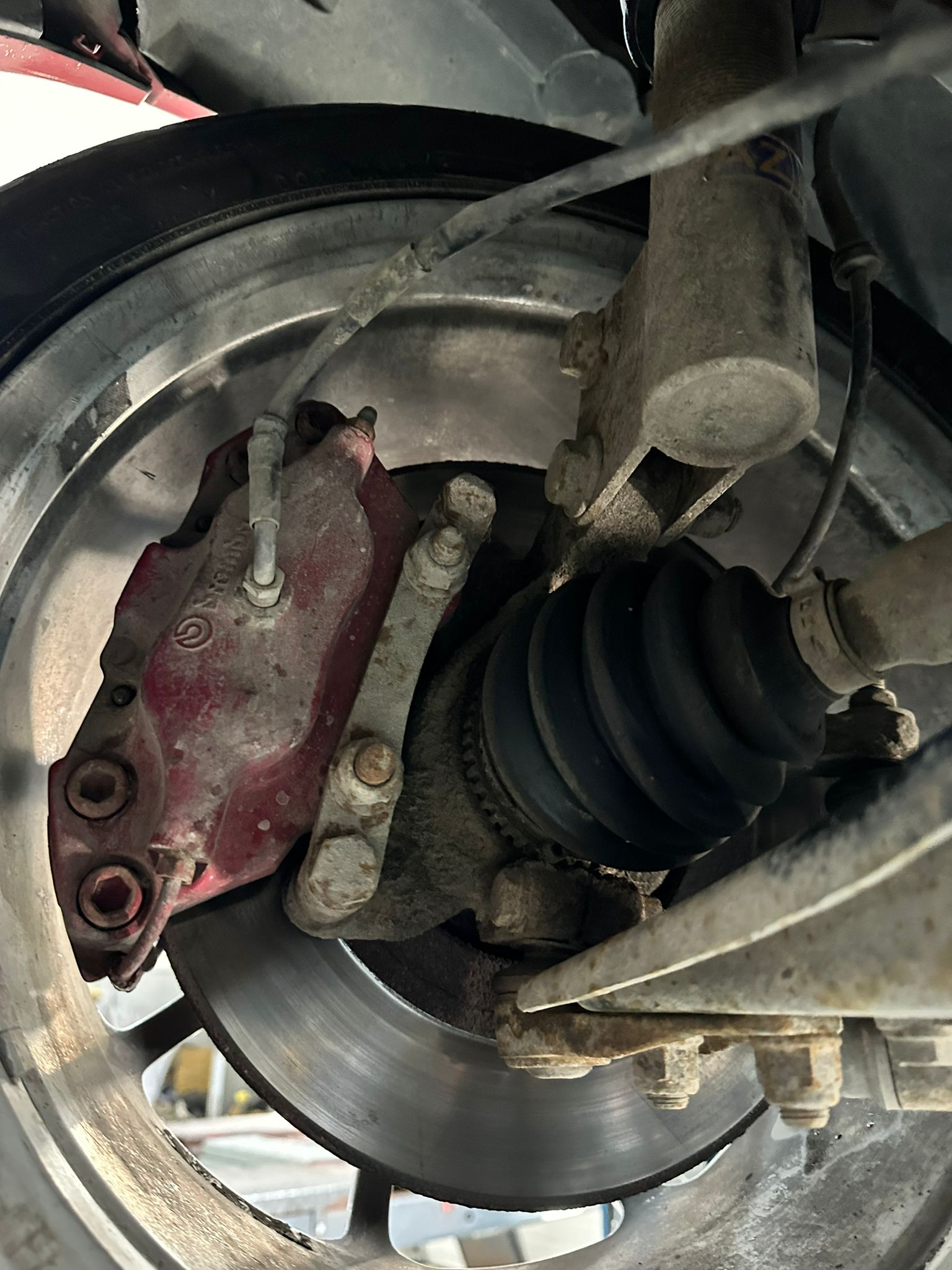

No 4 pot caliper bolts onto the clio directly. They all need some kind of bracket
they absolutely do bolt straight on, just require some longer bolts and a couple of washers so it centres the caliper onto the disc
That above is a friend's 172 with the 406 caliper conversion. What you see there is an adapter. It does not bolt straight on...
They bolt straight without modification on "non sport" hubs. Non sport hubs have different hole spacing from sport hubs.
I had those brembo calipers on some non sport hubs (they were of a k4j clio)for a while.
