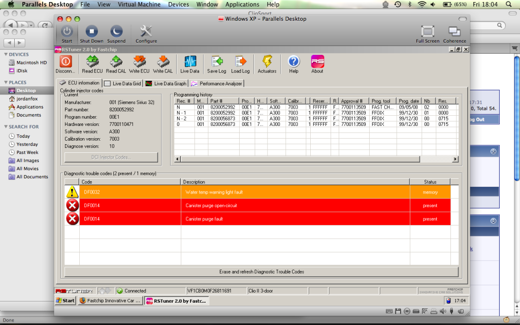

I just flashed it with the A300_35FF (grp n) using 'Write CAL', and the limiter is still at 6k, cant really feel if its much different...
As you can see the top one it flashed successfully, but I dont know what im looking for...

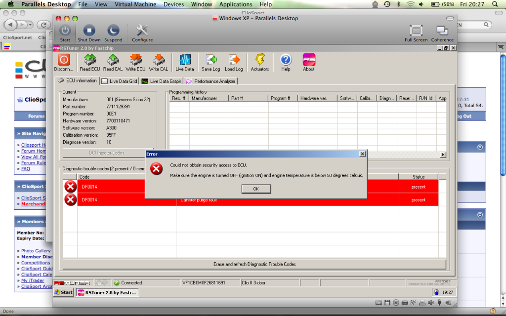

As said, fuel pump primes but I get nothing fireing up...I thought, oh, il restore my original ECU .rst (backup)....But now the software is saying 'Could not gain security access' blah blah again. So im stuck at the moment.
I also tried flashing the OEM file from the site, A300_3504.rst....But I get the 'Could not gain security....etc' again...

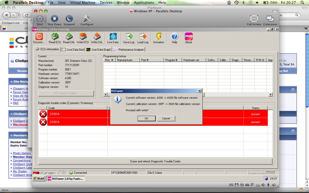

Quick screenshot of it 'connected', after the first time the flash was successful...(Why is there no programming history?)
Then...Going to flash the OEM (A300_3504.rst)...

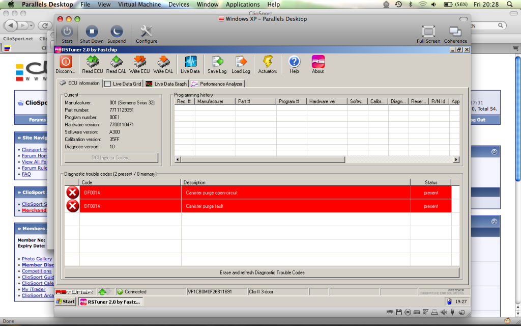

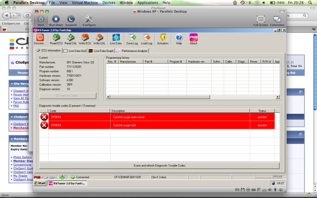

And....
Hmmmmmmm :( im not at home either, stuck now lol.
