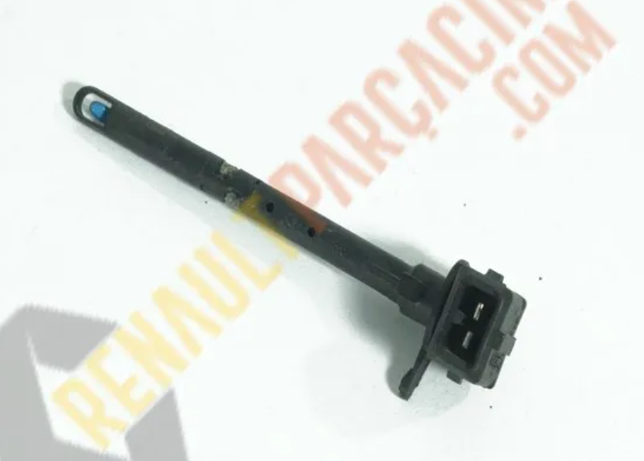

- The climate control unit receives two signals to help it make this decision. One from the interior temp sensor (in the dome light), and one from the thermistor which sits in the evaporator/mixer behind the dash. It can be accessed pretty easily from the passenger footwell. Part number 7701048391. Still available online - didn't bother checking with Renault Australia.

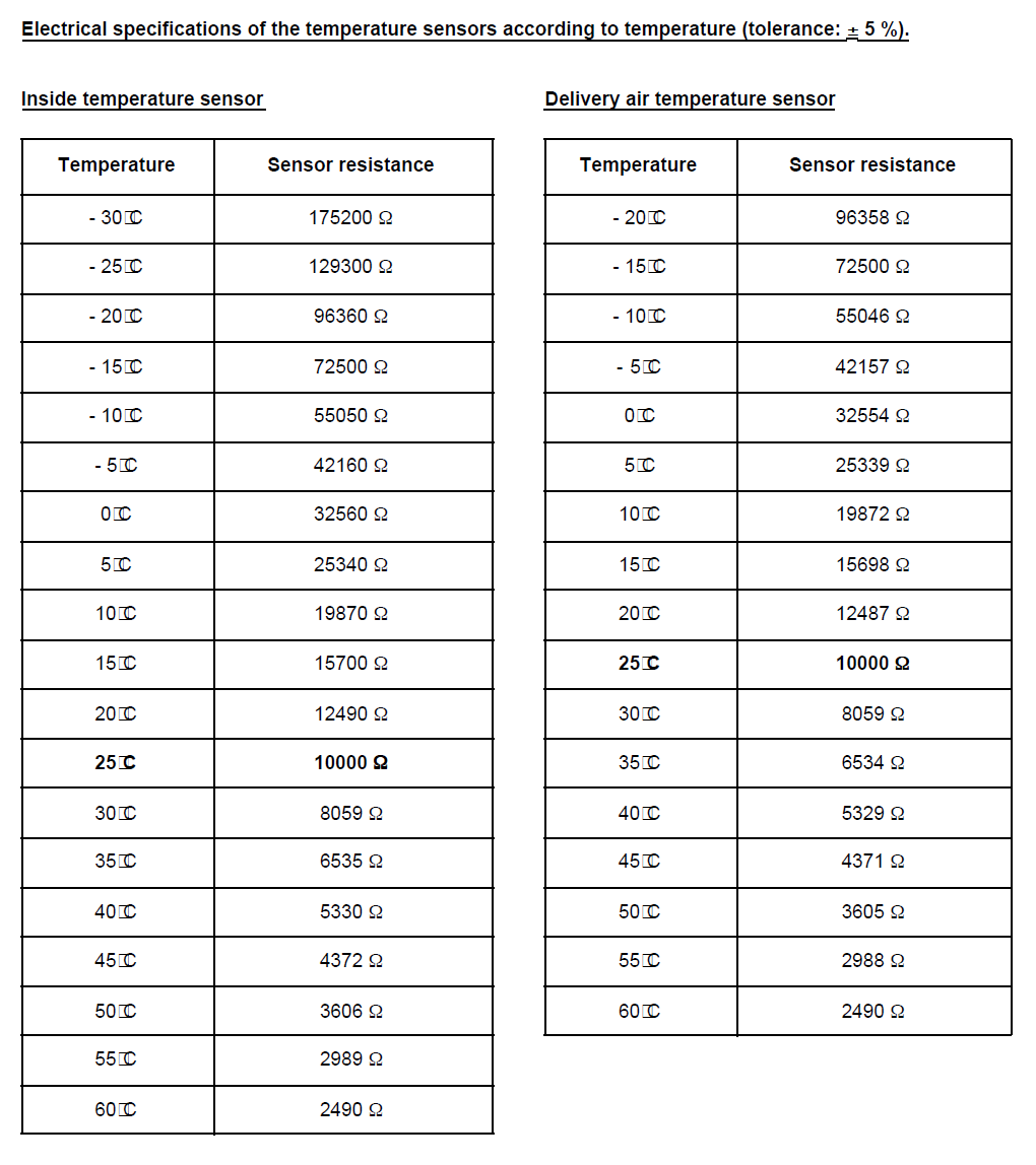

- You can test both sensors for resistance change to temperatures. This is from the workshop diagnosis manual:
The good news is that in 99% of cases, your issue is likely going to be either one of these sensors providing a bad reading. The climate control modules themselves have been known to go bad, but it's far less likely.
