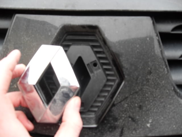

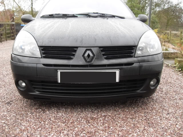

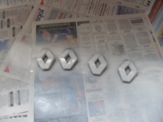

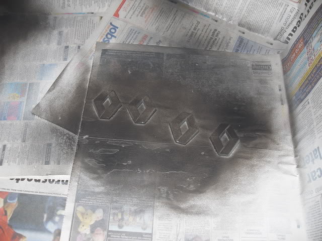

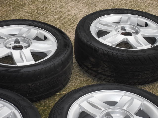

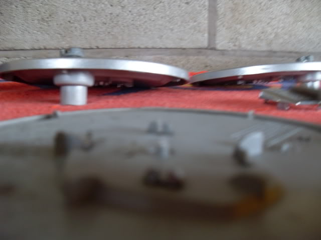

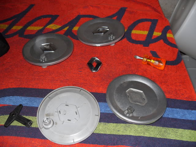

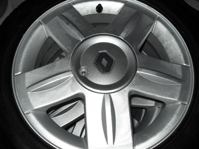

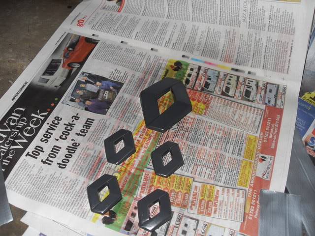

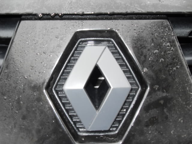

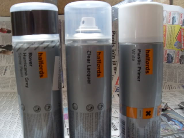

Hiya took a few pics of a bits I have sprayed and cleaned this weekend. Hope you all like :)
does the front diamond just pop off
yep m8y, i used a thin flat headed screwdriver will a cloth so i didnt scratch anything. There were three clips, 1 at the bottom and 1 either side of the diamond. Just gently prize it off m8y, nice and easy :)
