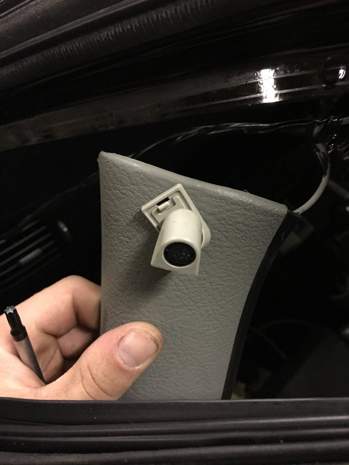

I have brought some flocked A-Pillars, but when i went to remove my original ones the alarm sensors are in the way, the wires run to the back of the dash, do i need to remove the dash aswell and unplug the alarm sensors, or is there another way around this?

The actual sensor is just clipped into the bracket, which is then screwed onto the A-post trim.
Push the sensor out of the bracket, then you can remove the trim. Unscrew bracket and fit it onto new a-pillar.
Refit trim and pop sensor back in.

No way off physically taking them off from what I can see without cutting the wire
Also does anyone know if I was to cut the wires, and just tuck them behind my new A-Pillars? And then refit and resolder them another day. Or will it cause an issue with an alarm sensor not do
Cut the cable out of the plastic and have the cable running over the top of the new ones. Iv done it to mine and screwed the sensor right up into the corner so you don't see the cable.
