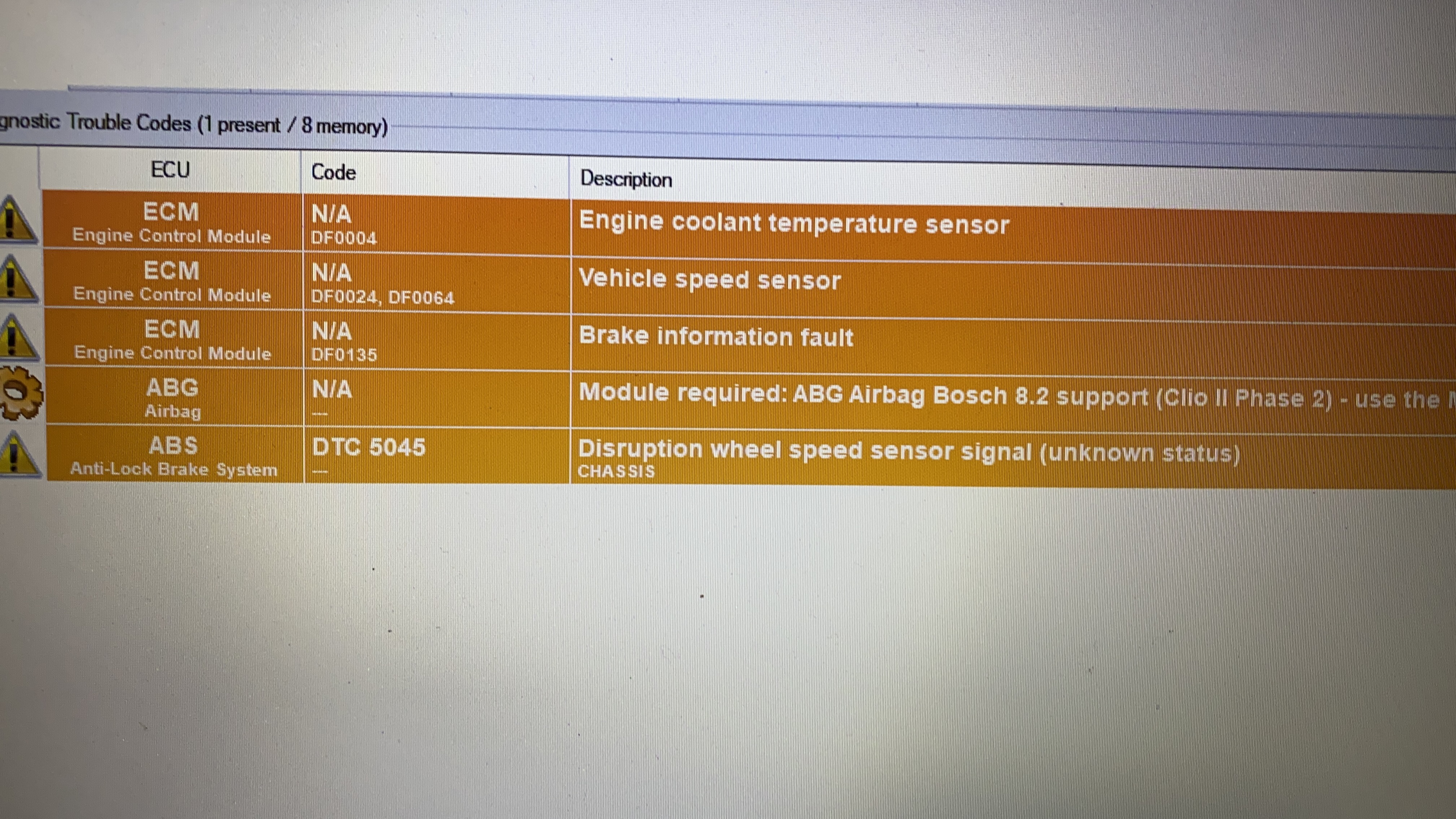

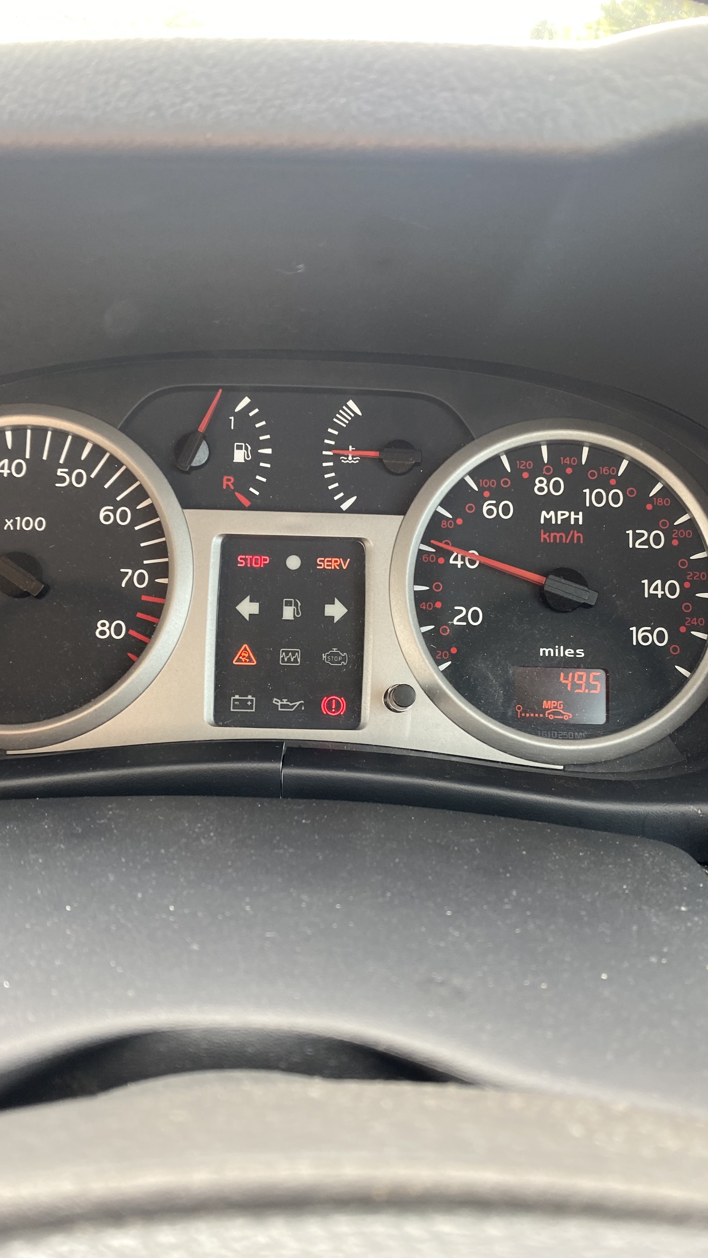

I’ve got a Christmas tree dashboard at the min due to some abs fault. It’s got a set of 4 new sensors which now means the lights aren’t on when the car starts but after a minute or so they all come on. Braking is random to say the least until the lights come on.
Excuse the poor quality pic but these are the codes from the rs tuner which aren’t really much use. Does anyone have any suggestions on where to start?
The Christmas tree

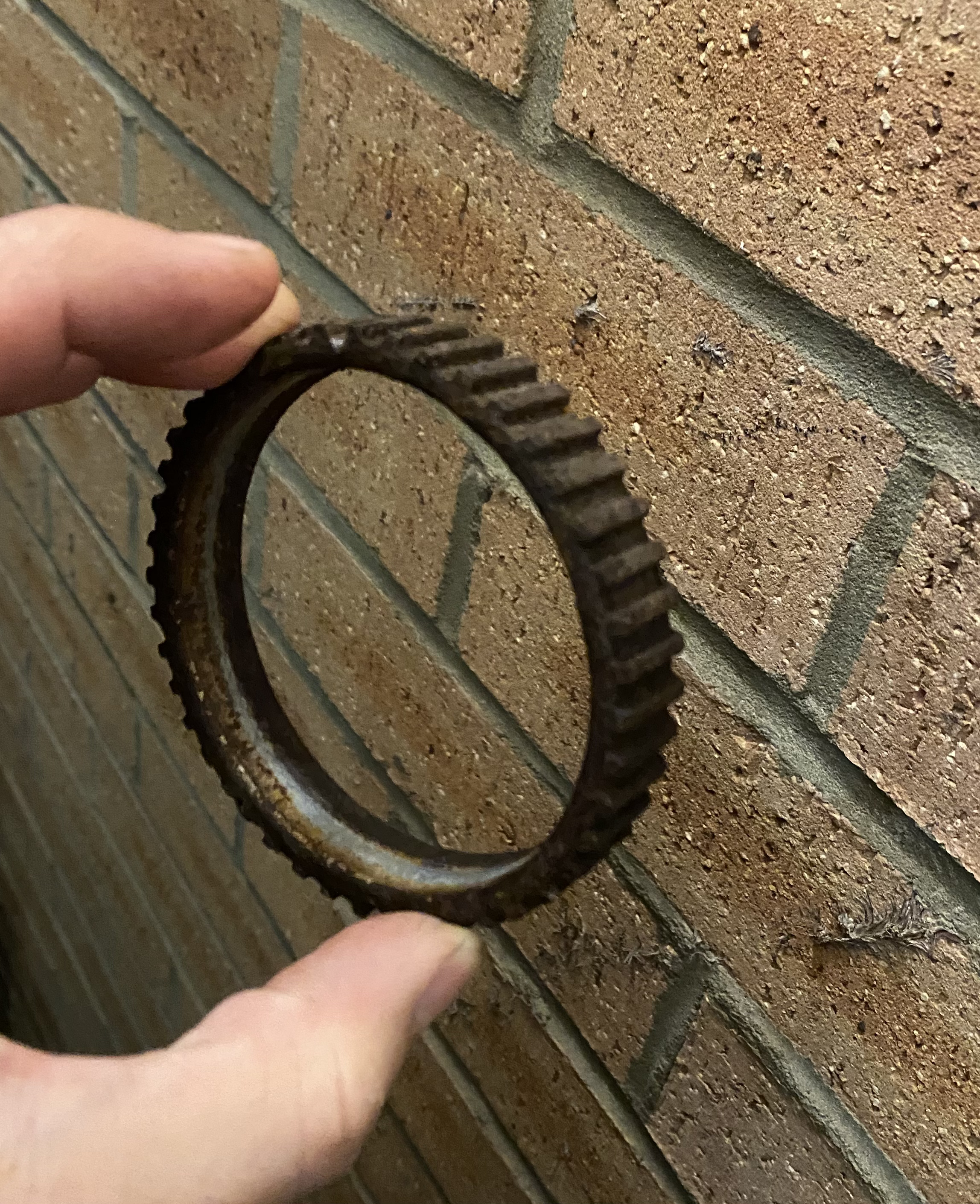

What are the rings like? And what gap do you have because you can get w**k readings if the rings are corroded and have started to get smaller teeth
The back are spankers so def couldn’t be them. The fronts are probably original so that’s not a bad shout. For the sake of £10 for a pair of new rings it wouldn’t do any harm to swap them and see if that sorts it. Cheers 👍

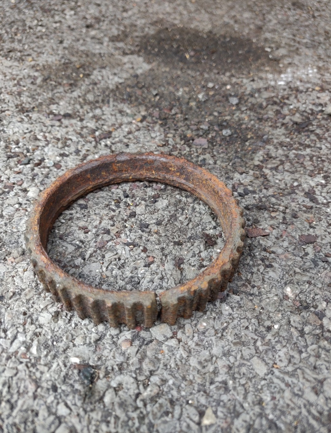

Another vote for rings. Mine were completely split giving the exact same symptoms.
ABS would also randomly fire during slow speed braking which was fun.
Swapped one today. Still no change. It was a bit shitty looking though. I’ll swap the other tomorrow but it actually looks quite new
Slight improvement 😂

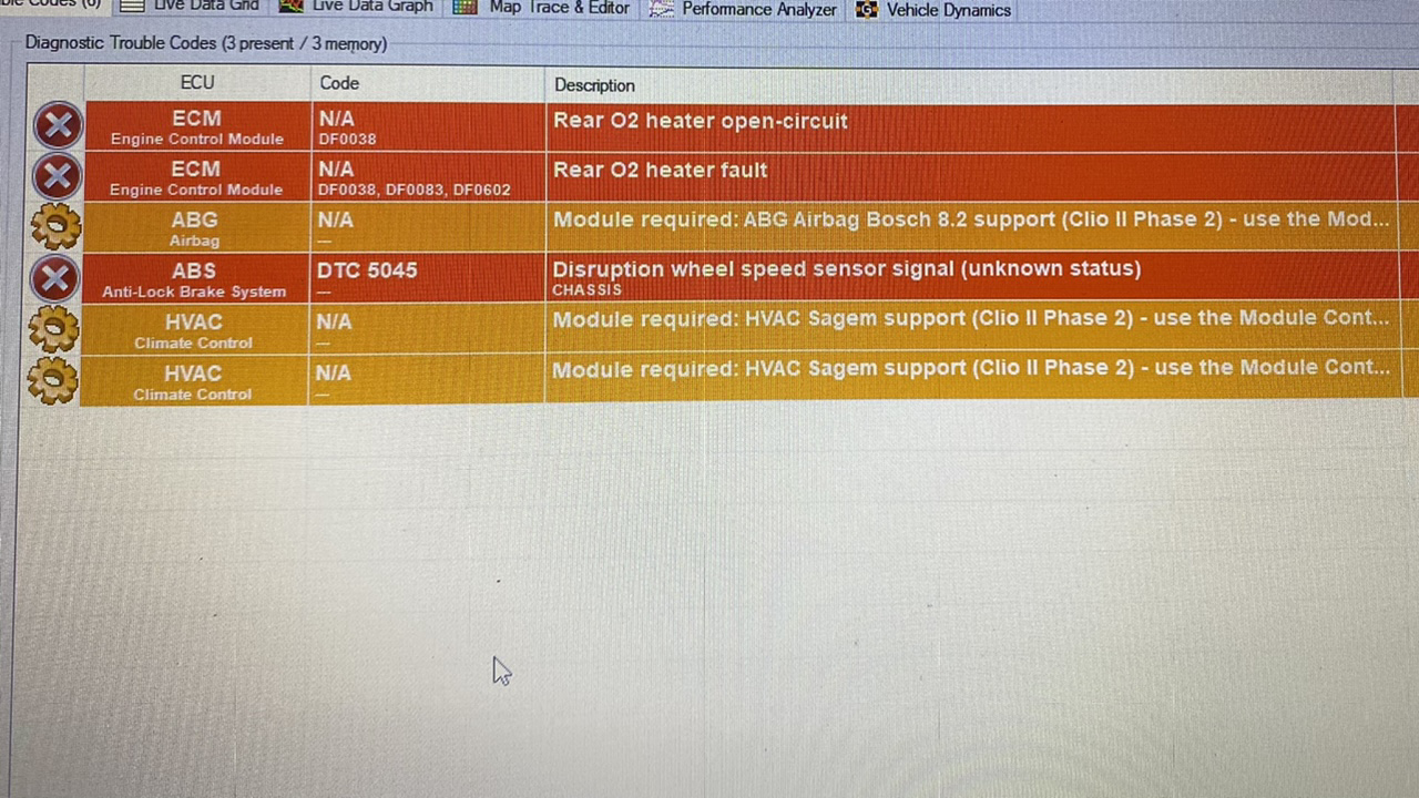

Yeah. Had none stored or showing before I set off. As soon as I did it was the same crack, drove about half a mile then the Christmas tree fired back up. I don’t care the abs doesn’t work but these lights do my head in!

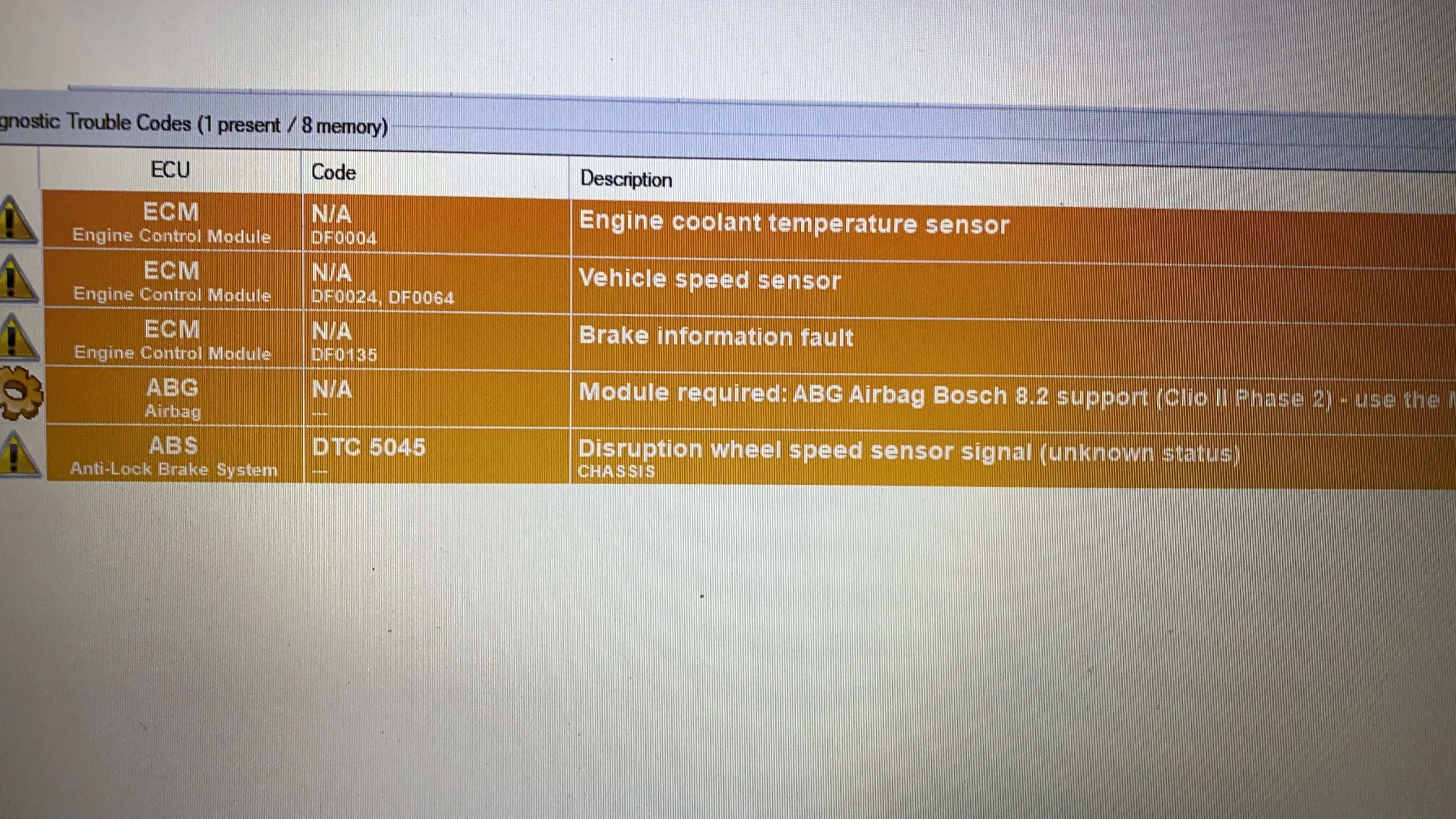

the codes are f**king helpful like, no indication as to which wheel the problem is coming from
Swap your front right ABS sensor
5045 is OSF ABS sensor
5044 is NSF ABS sensor
