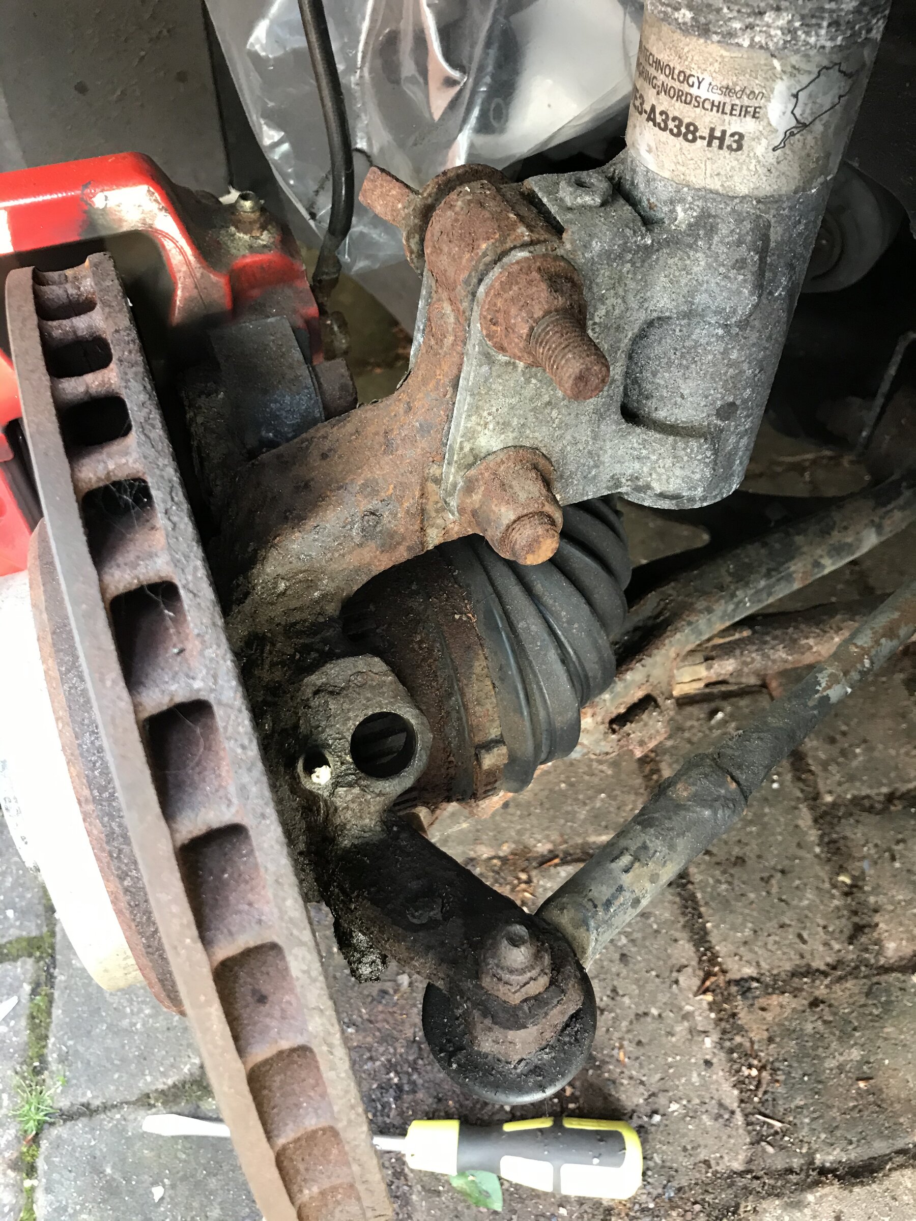

So today, I had a plan...
Try and get the bolt out. If I cant do that. Destroy the sensor.
Plan A... try and get some bite on the bolt with gaffe tape. This failed almost immediately. Swiftly moved to plan B.
Plan B... use the Dremmel to nick a groove into the bolt. I can then get some bite on a flat head with a wrench. Well I got a good bite, but the bolt wouldn’t budge and then it split anyway. Time to get serious.
Plan C... Use the Dremmel to slice the top part of the sensor away so I can drill the neck out.
Well I managed to the get it all sliced away, but the drill just wasn’t touching it. Great.
so I ended up using a hammer 😁
I say hammer but it was more of a small flat head being smashed into the plastic casing.
well after an hour of bashing I finally got it out. Copper Greeced the new one and slipped it in minus a bolt. Il have to cable tie it and get the bolt drilled out and re-tapped.
just got to do the other side now 😪
oh and thought id give the ignition a go to see if the immobiliser light would go out.
NO. Still got the flashing shifter light. But I thought as much.
